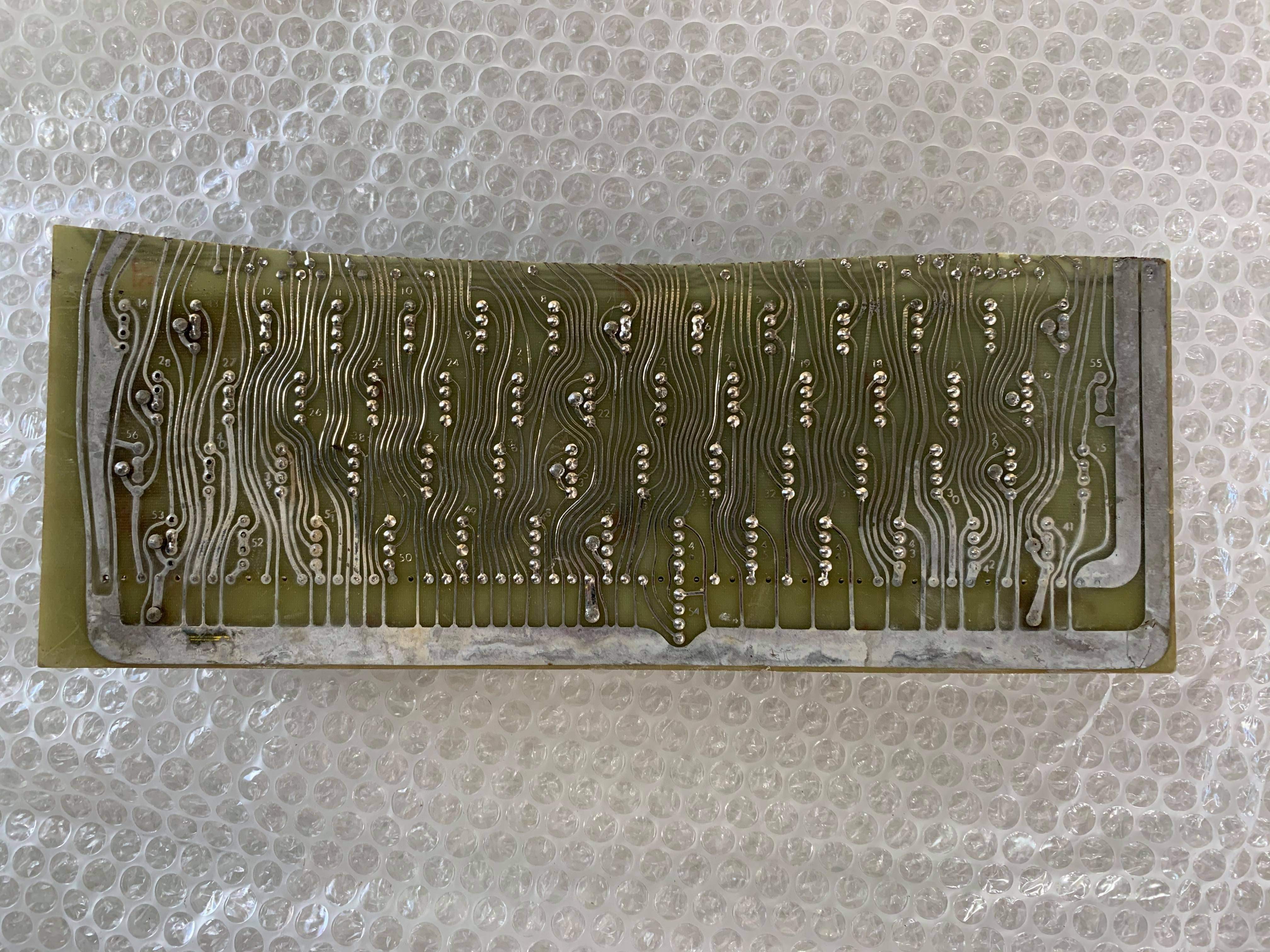

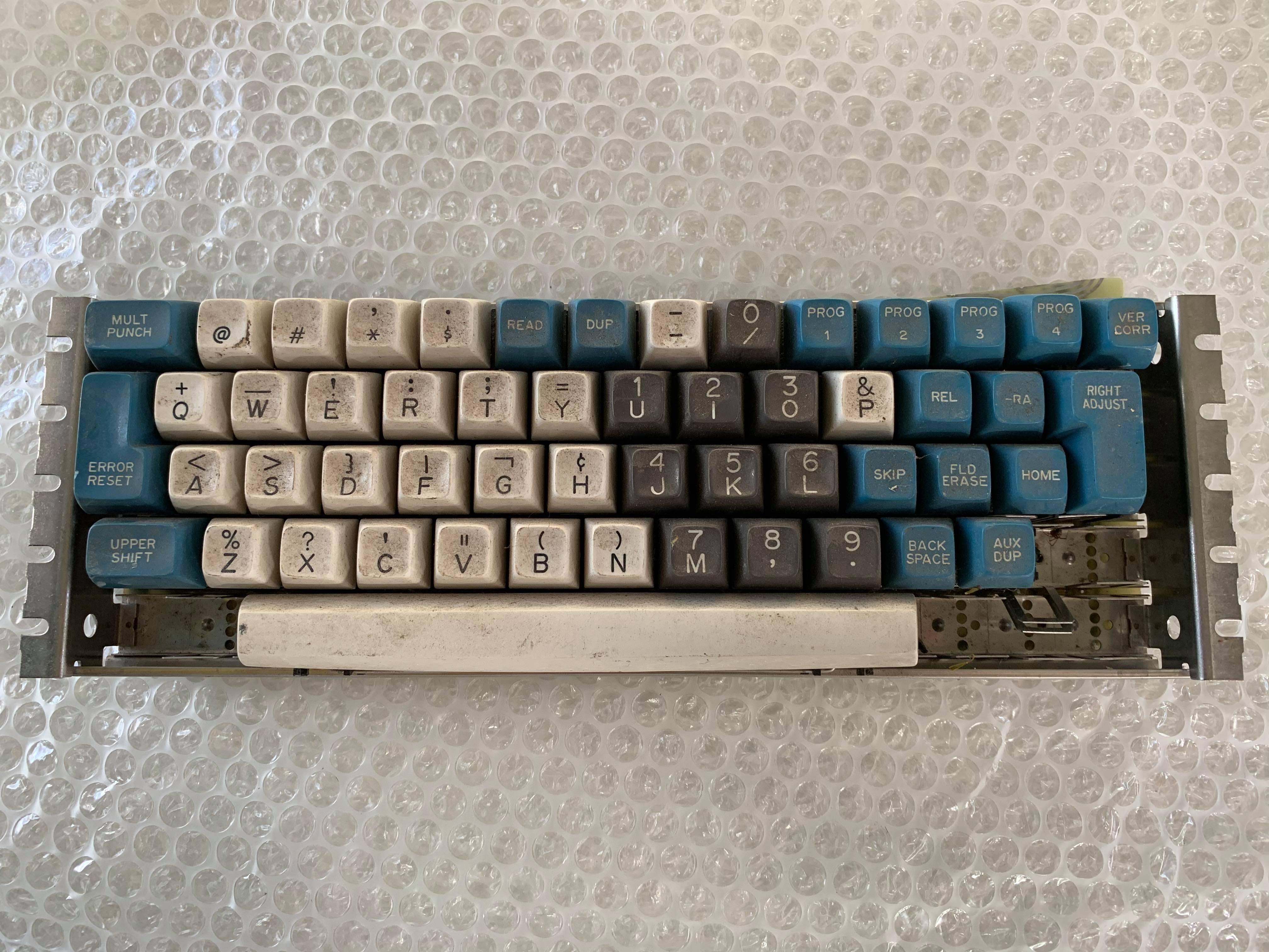

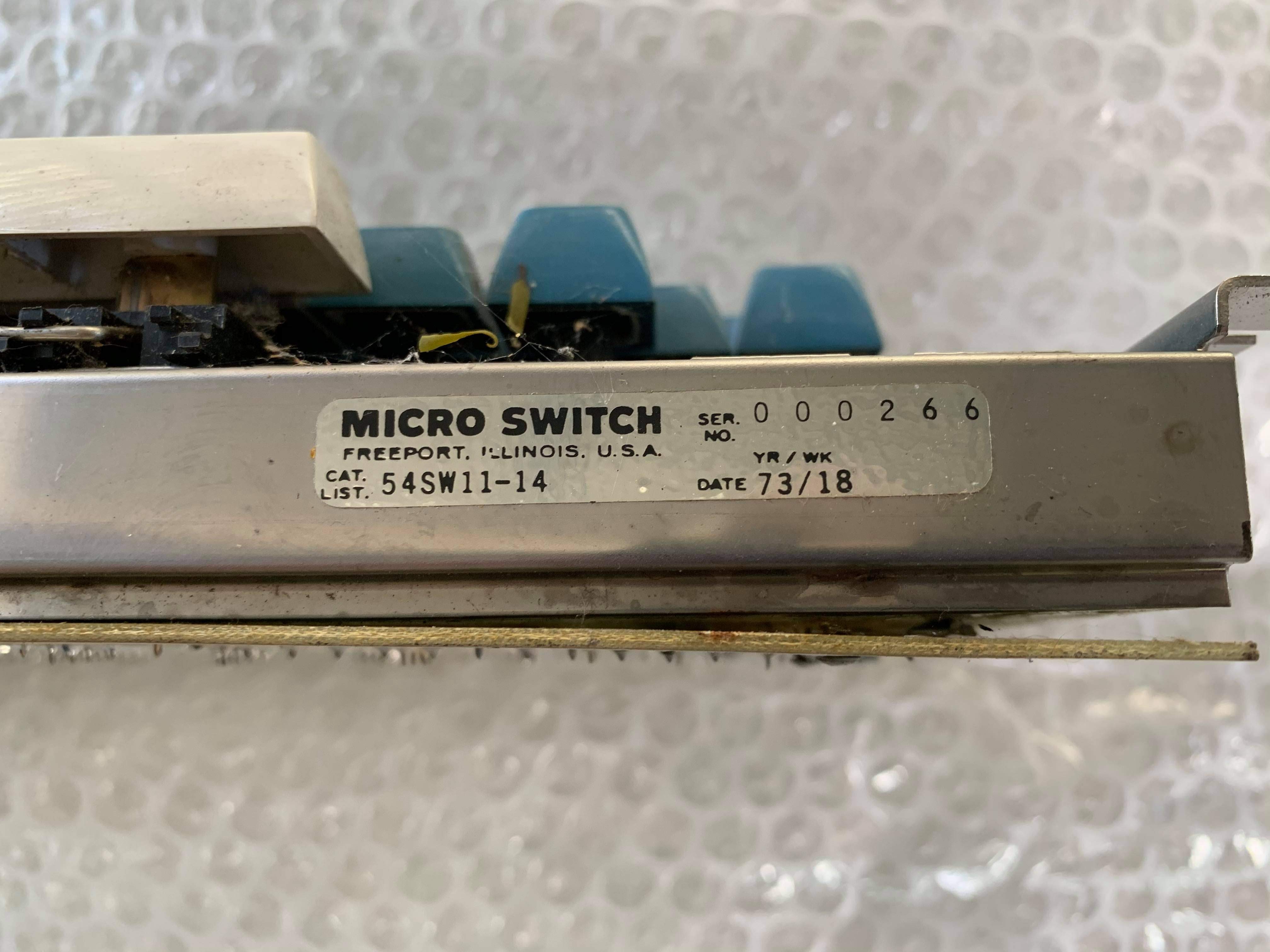

I just rescued what was left of a 1973 date Decision Data 8010 (serial 266). This board is in a pretty bad way, missing the case and the entire controller portion of the PCB, which has been roughly snapped off. The switches, Micro Switch dual magnet hall effect (SW series), feel fantastic though.
As I am missing the controller, my only option to run this thing is to use a new external controller. Has anyone driven SW series switches from a teensy or similar? This my first experience with Micro Switch, and I know SD switches have been converted before, but haven't seen any efforts for these switches. Thanks in advance.

I've read from a bunch of people that they were going to handwire their own matrix (with diodes for nkro and so on). Whatever that means in detail, should be possible. Great board!

I'd love to be able to handwire or otherwise hack together some method of interfacing this with a modern computer. This would be a great board to test it on, as it's far from original condition. From looking at the work on SD switches, hall effect parts seem to be significantly more complex than anything I've dealt with before though.

Thanks for the info. Handwiring a matrix isn't too much of an issue for me here, as the matrix is so damaged anyway due to the missing half of the PCB. This also means I have none of the original encoding hardware from the board. Unfortunately this board uses almost all pulse type sensors, which it seems no one has been able to reliably adapt yet.

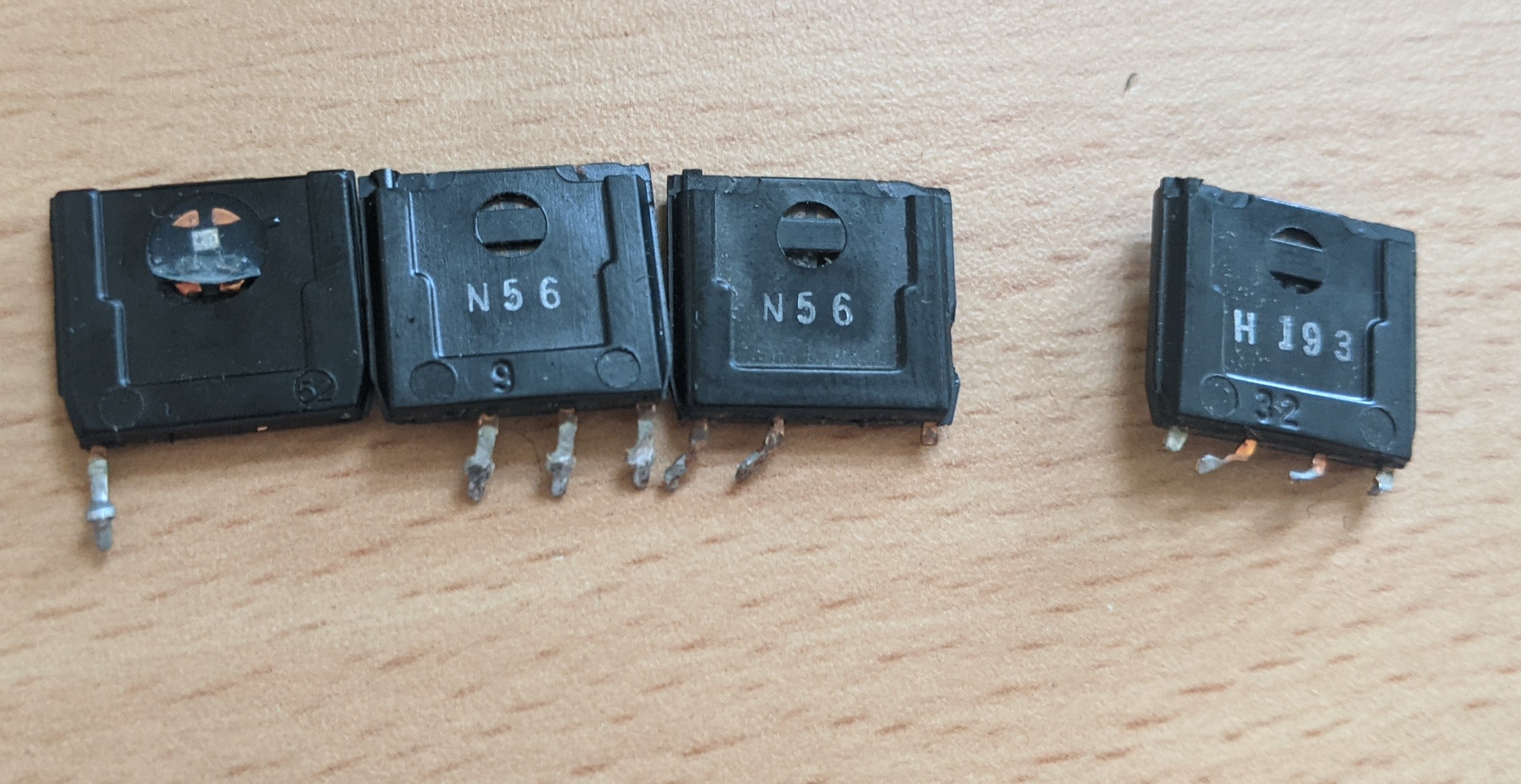

I'm in the process of cleaning the board now, and I've notice that somehow part of the PCB has pulled away from the metal cage (this can be seen in the last photo in the original post). This board must have been handled extremely roughly. Sadly, this has pulled several sensors away from the PCB, either by breaking the solder joint, or snapping the leg where it meets the sensor. Hence, I've got 4 sensors (one hold type, three pulse type) which are mechanically broken, before even testing them electrically. So does anyone have any spare SW series sensors or switches from previous projects, or know where to get some? I've seen a few on ebay, but they seem to be in lots of 1, and seem to be of different types to the ones I need. See pic for reference - N56 are pulse type from 1SW17 switches, and H193 is hold type from 1SW11 switch.

I'd also like to understand how pulse type switches work properly. I've seen some info saying they give single short pulse when pressed (with no release event), and others saying that there is a pulse for press and another for release. Obviously I haven't been able to test them myself yet, but can someone who understands the switches better than I do confirm this for me?
