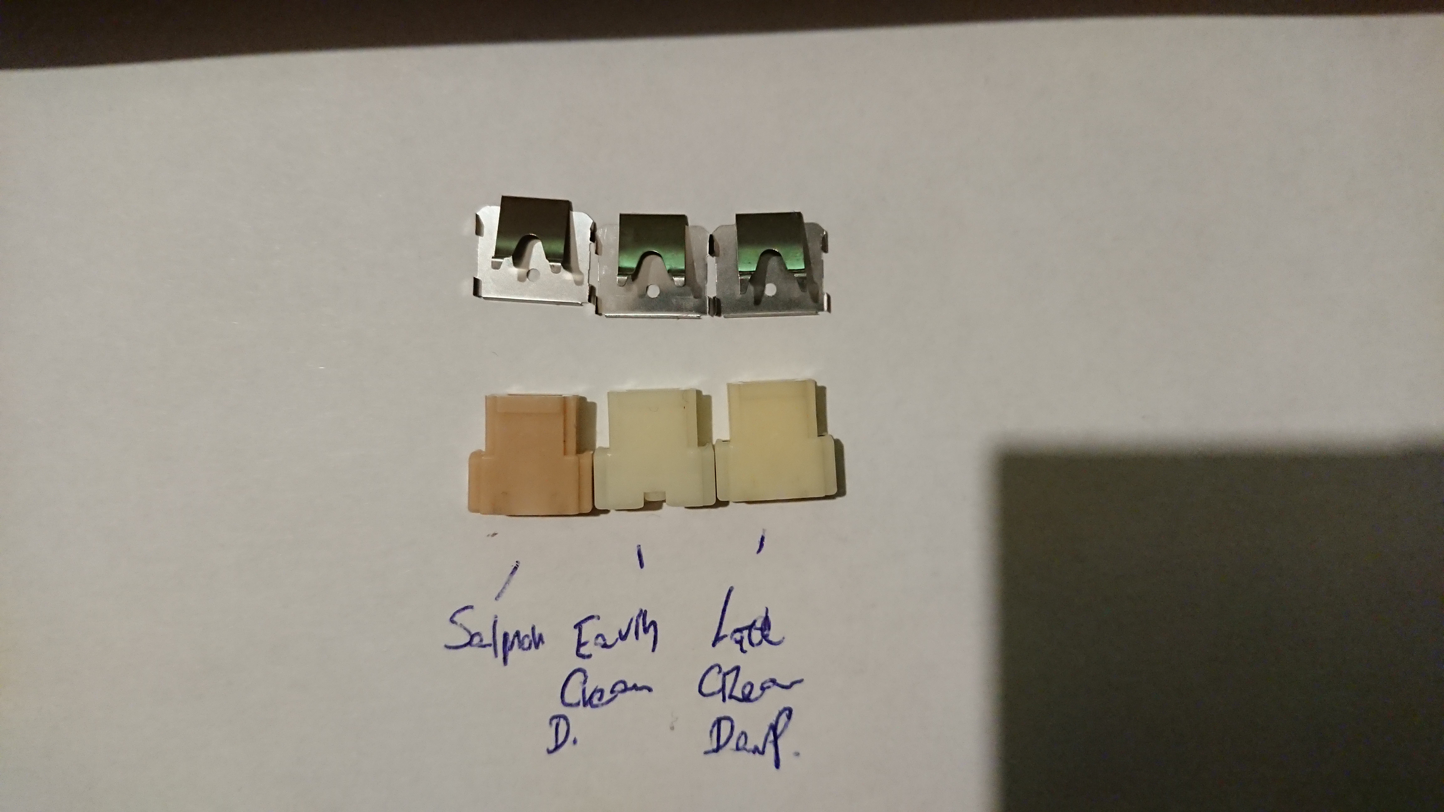

Hi there
I need some picture to make understanding the Alps timeline a bit more. The wiki is also a bit weak regarding SKCM Blacks, especially the pine variety.
What pics do I need?
A picture of an early pine Black switch, specifically the tactile leaf, from multiple angles. I want to compare them with Salmon alps.
A late pine might come in handy as well. Who knows how many versions it has...
My theory based on the SKCM Ivories are: Pine blacks came after Salmons while retaining the same tactile leaf and possibly using different plastics for the sliders. This is the theory I want to either proove, or disproove.
The best would be similar comparisons to this (this pic was uploaded by me to the wiki)
I got tangled in the Alps timeline and I want to untangle it...just a bit xD And as we know... Even a little bit helps.
Thank you very much in advance for your contributions guys! You'd help out a lot! Maybe we could even expand on the wiki just a bit by your commissions! I'll upload them if you're ok with it!

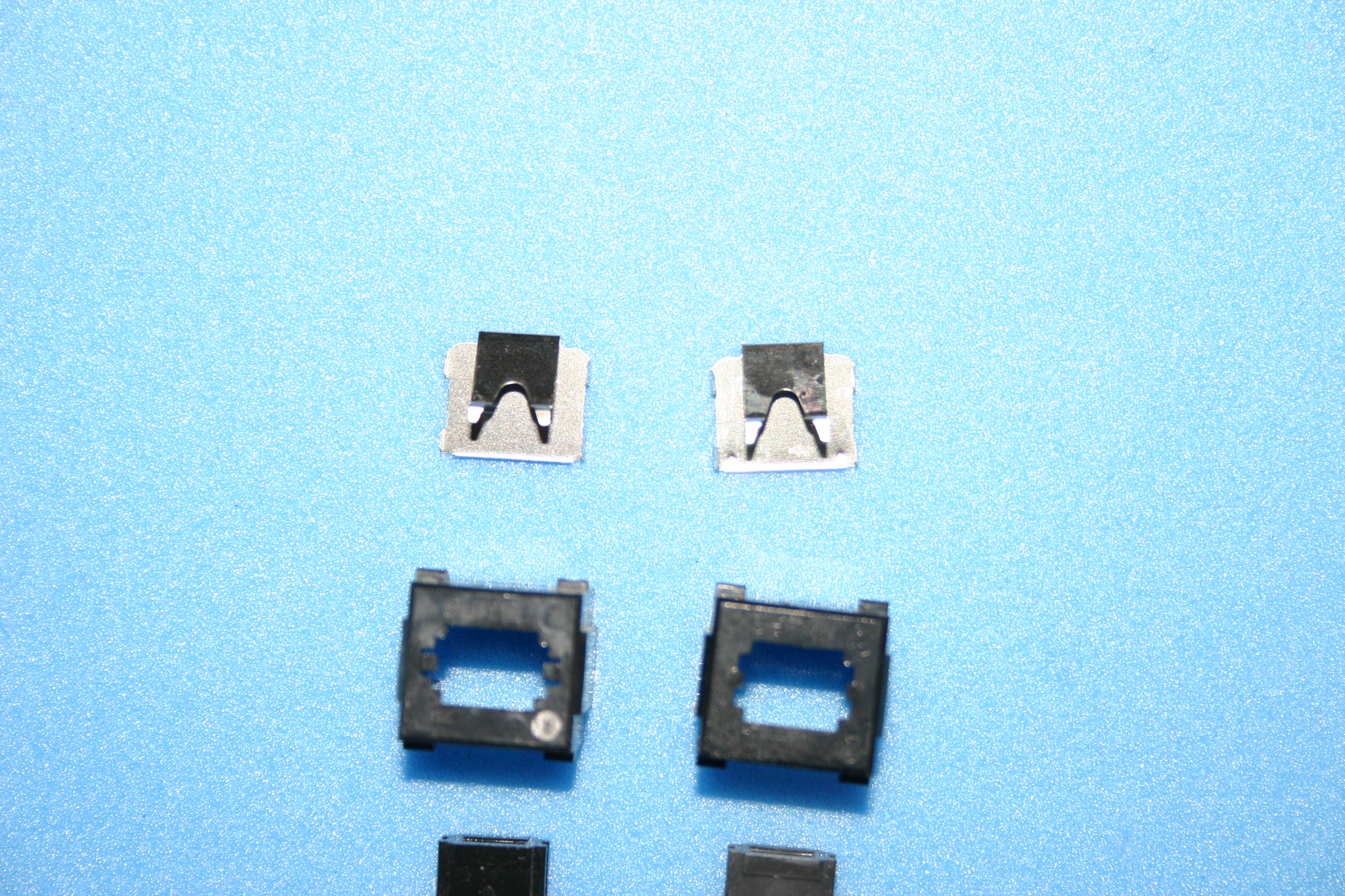

shallot
05 Feb 2021, 18:34
1989 week 14:
Lynx_Carpathica
05 Feb 2021, 18:53
it looks suspiciously like Salmon tactile leaves, and doesn't look like the later black ones. Can you please tell me if it has lubricant on the slider? It Judging by the color, it has. You can wipe it away a bit of with a finger. make sure not to wipe it on the side rails.
Even the oranges have holes... wonder what's the porpuse...
shallot
06 Feb 2021, 01:11
they're shot for shot identical to SKCM Cream 4-tab tactile leaves to the point I got them confused. I'm not sure if it's factory lube or dirt but I definitely wiped something off it
Lynx_Carpathica
06 Feb 2021, 01:53
If it is a film that covers the entirety of the slider - it was lube.
shallot
06 Feb 2021, 23:34
then yup, factory lubed
Lynx_Carpathica
07 Feb 2021, 20:27
Thank you for your contribution. I'll add it to the Wiki.

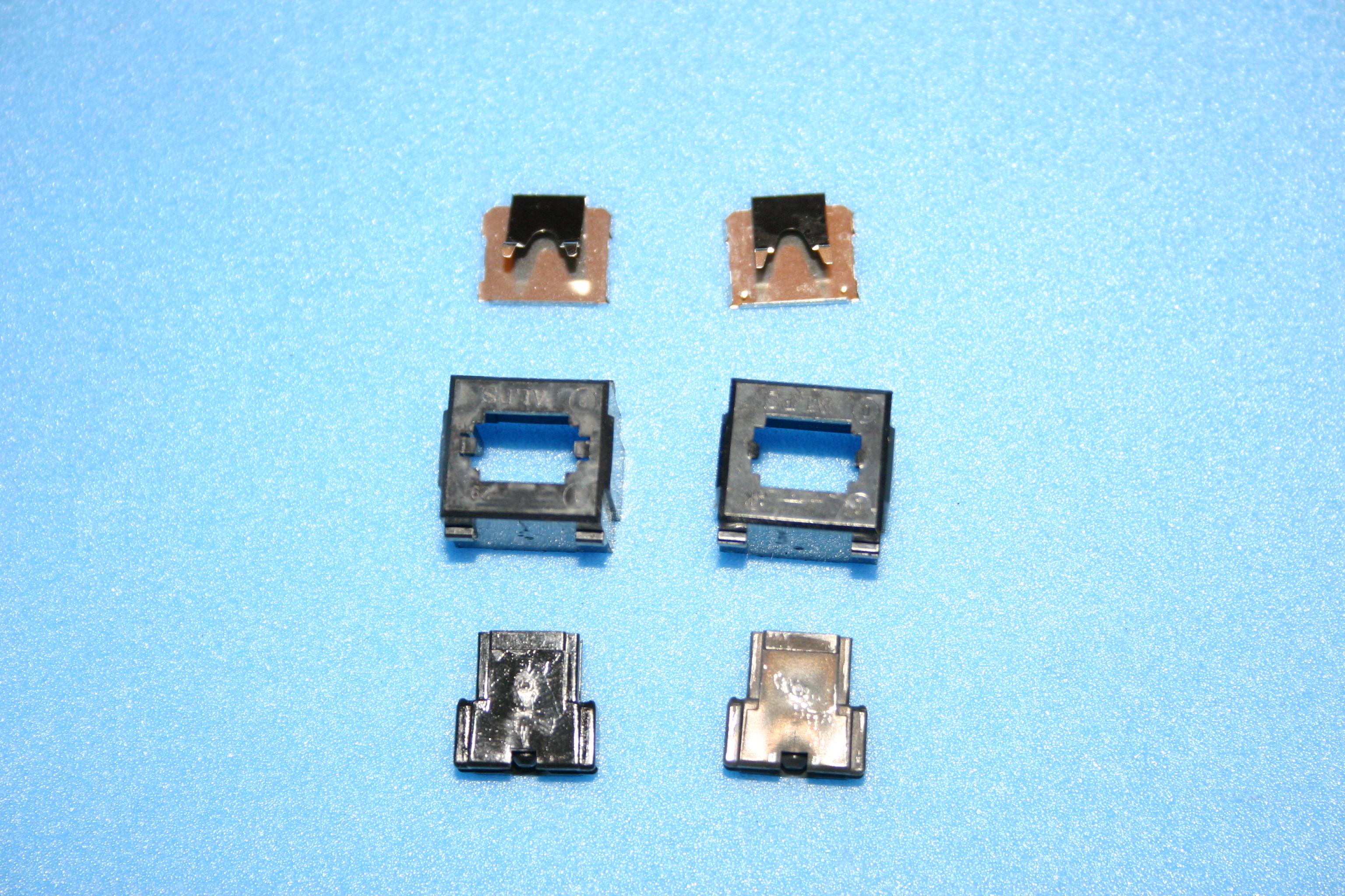

Polecat
07 Feb 2021, 23:47
Two examples from my collection. Left is NeXT ABP, circa 1992, pine black. Right is Dell AT101W, circa 2001?, bamboo black. I know it sounds too late for SKCM, but the Dell has a case date of "01", and black bamboo Alps-branded SKCM switches.
I have a couple black SKBM boards also, but those probably aren't of interest.
Left NeXT ABP, right Dell AT101W
Left NeXT, right Dell

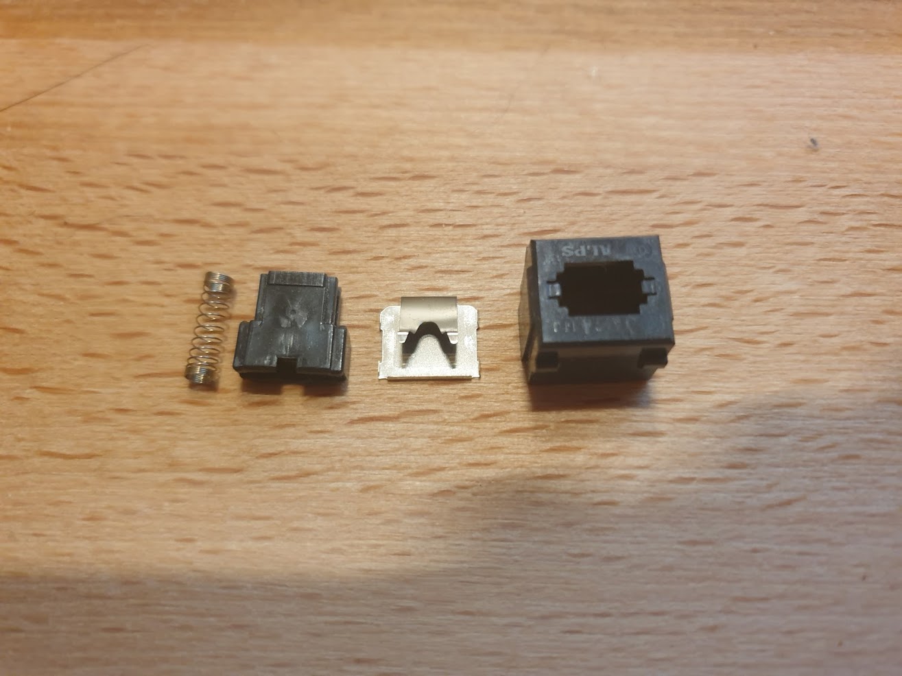

mode1ace
08 Feb 2021, 09:08
I have some much later pine blacks from a new logo dell AT102, and the slider is most definitely unlubed, I can take some pics later if you'd like?
Lynx_Carpathica
08 Feb 2021, 10:15
Sure. I'll upload them to the wiki as well if you're ok with it.
