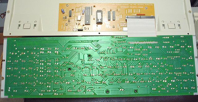

Previously on this forum someone posted a bare PC board photo of a Gen3 Northgate. As far as I can tell all the Gen3 models used the same PC board, even the 101 (which was done by breaking off the left edge where the function keys would go on the other models). Looking at that photo (attached) you'll see that many of the switch positions, including the three you're having trouble with, had two possible orientations of the actual switches, giving two possible functions for each position depending on which way the switches are installed. The legends on the PC board are clearly labelled with the two functions. I don't have a Gen2 handy at the moment, but it's possible those worked the same way, and that those switches would need to be flipped around depending on if you had a Mac or PC model. So there may indeed be more to converting a Northgate from Mac to PC than flipping dipswitches (which would explain why they were sold for one or the other and didn't share manuals).

- NorthgatePCB.jpg (621.79 KiB) Viewed 3145 times

I think you've got the wrong pic. It's got a connector for an attached cable (to the left of the GND marking). I haven't read through all your OmniKey stuff (context: Polecat has a bunch of OmniKey info and I'm slowly trying to get that into the wiki), but attached cable is only for the gold-label 102 and the 101s, right?

That photo is of a Gen3 PC board, which had a short jumper from the PC board to the rear panel PS/2 connector. (not an attached cable, but the same sort of connection on the PC board) Those are different than the Gen2, which had a separate controller board with the PS/2 (and ADB) connectors directly mounted, but I posted that as an example of how Northgate provided for two functions on some keyswitches by having two sets of pads for flipping the switches around the "other" way, which *might* also apply to the Gen2 OmniMacs. Just throwing out ideas somewhere between waking up and my first gulp of coffee (which often makes things even worse...) and running off to work. I can open up my OmniMac later this evening to see if it's made the same way.
edit - my OmniMac (Gen2) does not have the double sets of pads as in the Gen3 photo, so that idea can be tossed out.

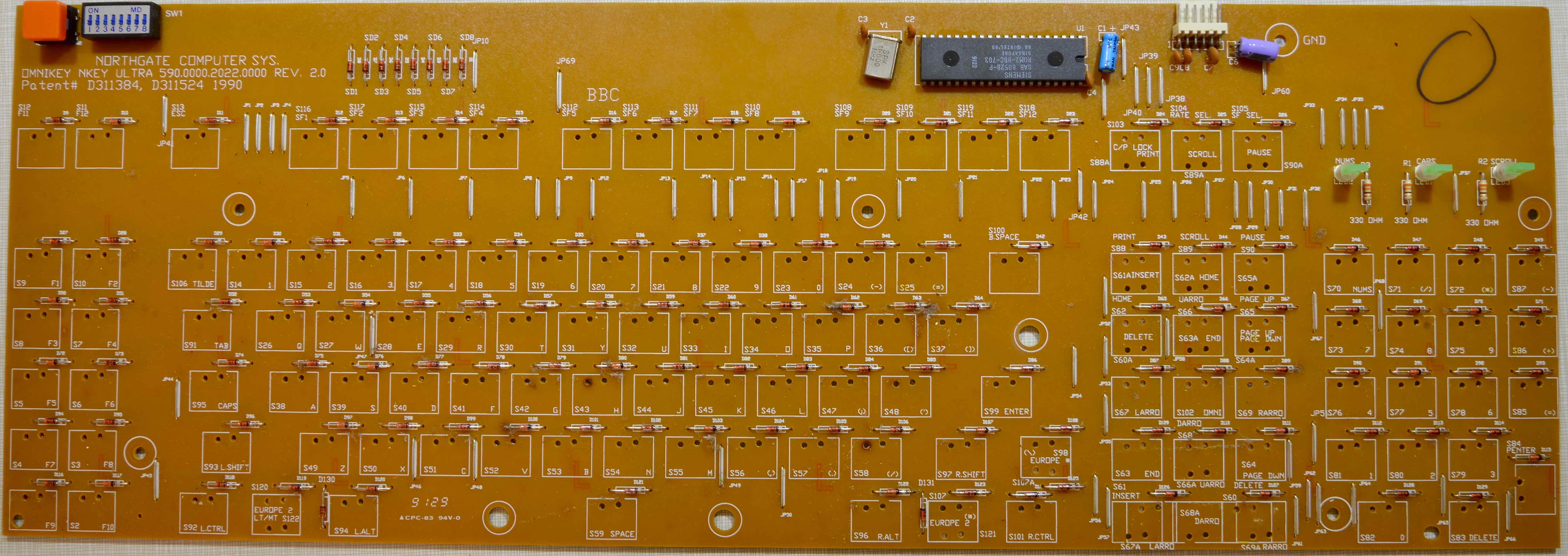

Going back to an earlier reply, I just found this photo (from Sandy's page) of a late (rev 6.04 Vendor 777) Gen2 Ultra and it indeed has the dual sets of pads (as on the Gen3 models) for many of the switches in the nav area. Glad I wasn't imagining what I thought I remembered.

- sandy0612182.jpg (97.76 KiB) Viewed 2784 times
