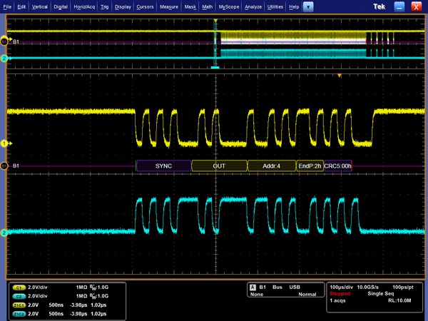

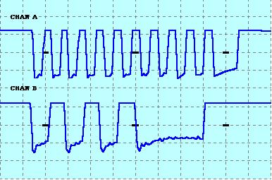

USB and PS/2 are very different protocols. USB in general is FAR more complex.
(from this site).
Basically with USB there is a lot more data encoded into a single signal. There are other hardware differences between the two but I'm not going to go into that.
You can see some of the differences between the two protocols by looking at a waveform of the signals.
USB
PS/2
Notice that with USB the two data signals are mirrors of eachother. This is what Findecanor was referring to when he said differential data lines. The signal seen by the USB device is actually difference in voltage between D+ and D-. With the PS/2 signal the two data lines are completely different signals (in the picture chan A is the clock and chan B is the Data).

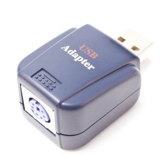

Thank you for that clarifications, I kind of figured that there had to be more going on within the PS/2 to USB converters.
I know these are no longer being made, but am I correct in assuming these are one the preferred converters?
SANOXY PS2 to USB Adapter - https://www.sanoxy.com/product/adapters ... b-adapter/
I have five of these from an old job, and wonder what they are worth?

Indeed, the blue cubes used to be very well liked around here. I've heard that they would work with some vintage keyboards that other adaptors have difficulties with.
