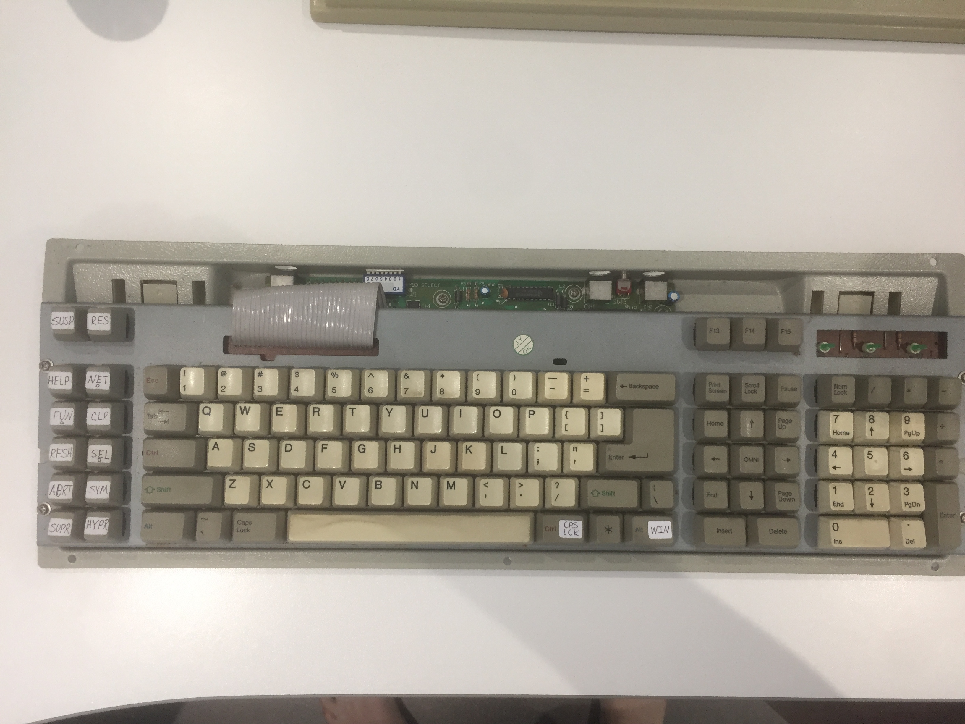

SteveN
23 Mar 2021, 06:47
Darn. No joy. It looks like there is no room for the top row of F keys. Even if I wanted to hack the metal, there's a big cable in the way.
So it looks like I'm going to have to source an Ultra-T somewhere, or perhaps something like an IBM Model F 104 or AT keyboard.

Can you please remove the keyboard and PCB assembly and post a photo of the underside of the circuit board?
SteveN
23 Mar 2021, 14:37
I can try. What is it we're trying to determine with that?
[ XMIT ]
23 Mar 2021, 14:40
We're trying to see if the PCB has accommodations for another row of switches.
To do this, remove the four screws, two on each side, holding the plate in place. Then, rotate the plate up about the top edge of the keyboard, being mindful of the ribbon cable.
It is unlikely that it has accommodations for more switches given the ribbon cable placement. If it does not, you would be looking at substantial modification to add another row, likely more than you are willing to do.

24 Mar 2021, 01:44
SteveN wrote: 23 Mar 2021, 06:47 Darn. No joy. It looks like there is no room for the top row of F keys. Even if I wanted to hack the metal, there's a big cable in the way.
Sorry that's an early Gen2 model, and the Ultra hadn't come out yet when that one was built, so no shared plates or PC boards. Gen2 and Gen3 Ultras and Ultra-Ts come up on ebay frequently, just be patient and wait for one in the condition you want for a reasonable price as some are a lot more expensive than others.
