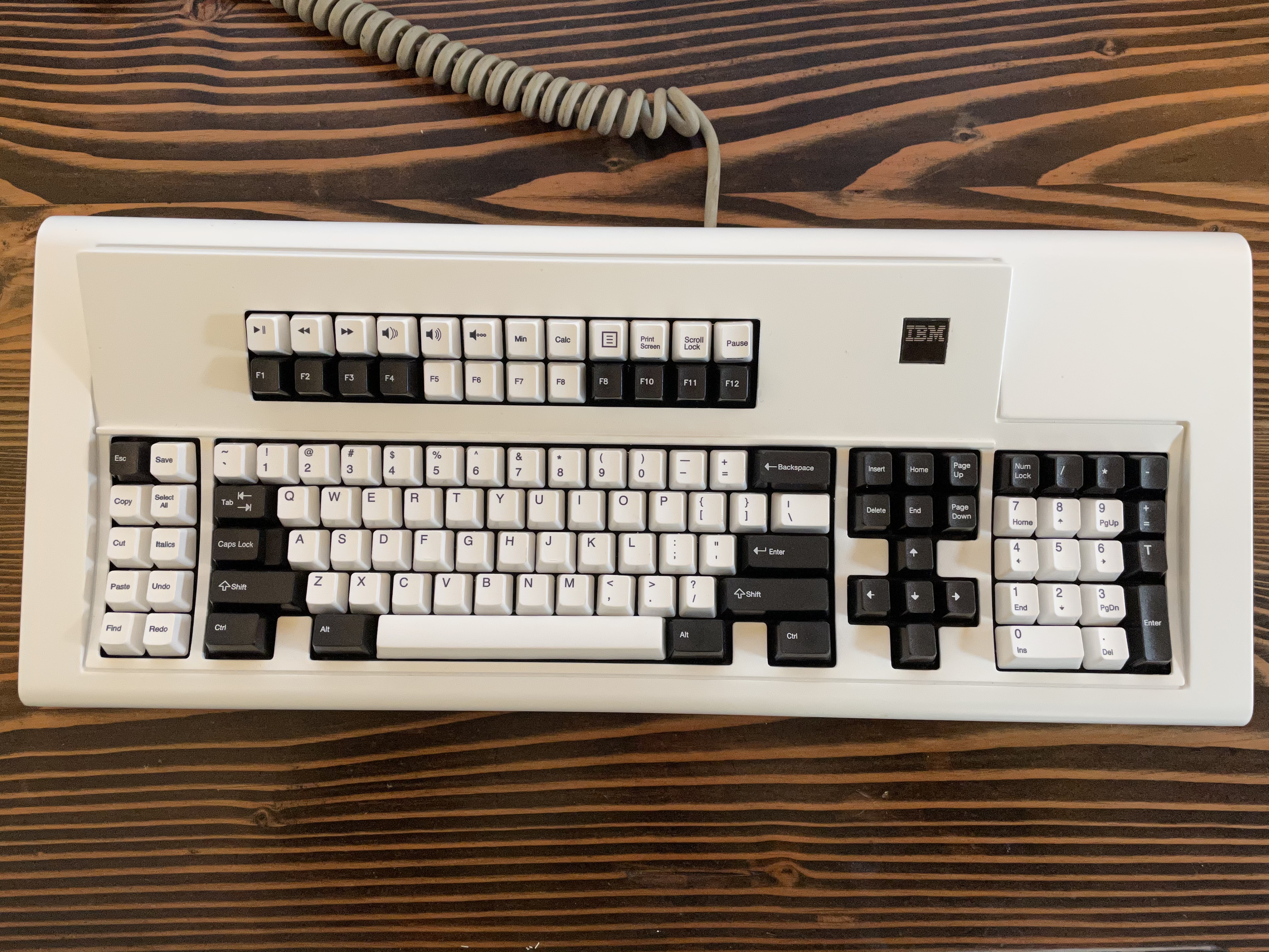

ddrfraser1
03 Apr 2021, 09:43
Yes
jacks
03 Apr 2021, 10:00
Gorgeous!
Why do Unicomp not sell their 122s like this???
Rayndalf
03 Apr 2021, 10:16
jacks wrote: 03 Apr 2021, 10:00 Gorgeous!
They don't do white on black. Given the quality of their black on white dyesubs I can see why.
They've been getting better from what I've heard, so maybe they'll bring them back. The new SSK only comes in black and would look great with WoB keycaps
