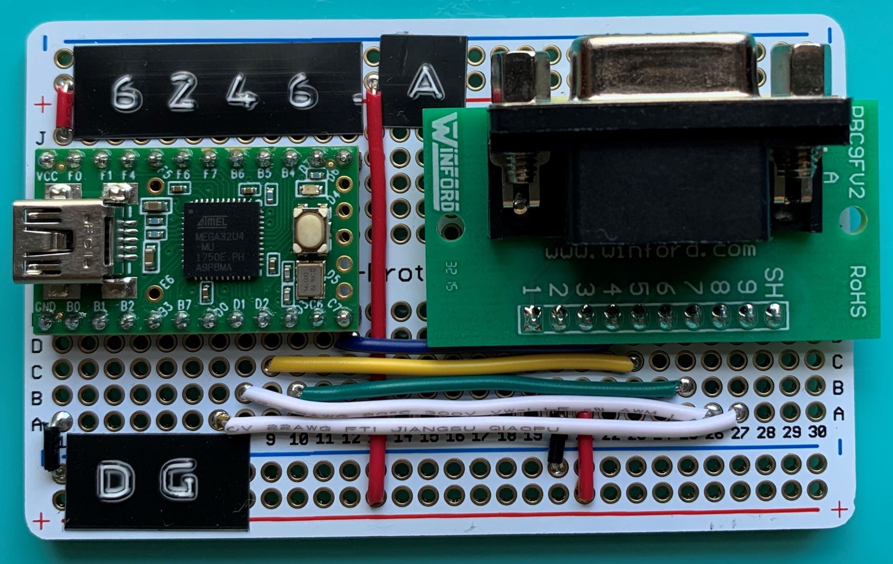

This keyboard, with FLS switches and tombstone keycaps, is from the D210/D211 terminals. There are pictures in the wiki. There are a couple topics about converting one here and here. In both cases, the existing controller was removed and the matrix wired directly. I thought I would see what could be done with the existing firmware.
The pinout of the DE-9 is given in the user manual.

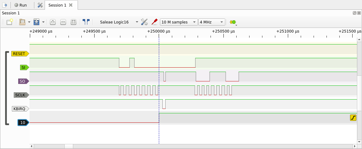

Some experimentation was required to determine the specifics of how this was implemented.
  • The initial state just from the keyboard / its pullups is RESET high, SI low, SO high, SCLK low, KBIRQ low.
  • RESET is pulled down briefly and SI, SCLK, and KBIRQ go high, which are their idle states.
  • SCLK then clocks 8 bits over SI for an identity of 3 for what seems like the normal American layout.
  • SCLK then periodically -- about every 70ms -- clocks 7F out for no key.
  • KBIRQ then goes low to signal the terminal to pick the shifted data up.
  • SO should ack this by going low itself.
  • SO staying high is a nack / lack of an ack and causes the keyboard byte to be repeated for a while before giving up.
  • SCLK then clocks the LED and buzzer states in.
  • SO should end low and then go idle high again.
  • When there is a key change, 7F is replaced by its code.

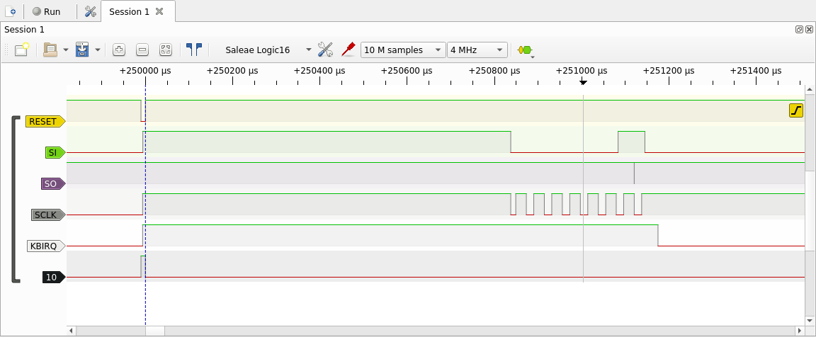

Reset sequence:

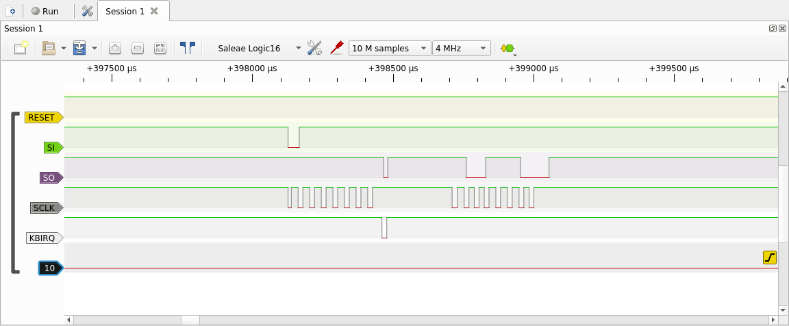

Idle key:
Space bar:
