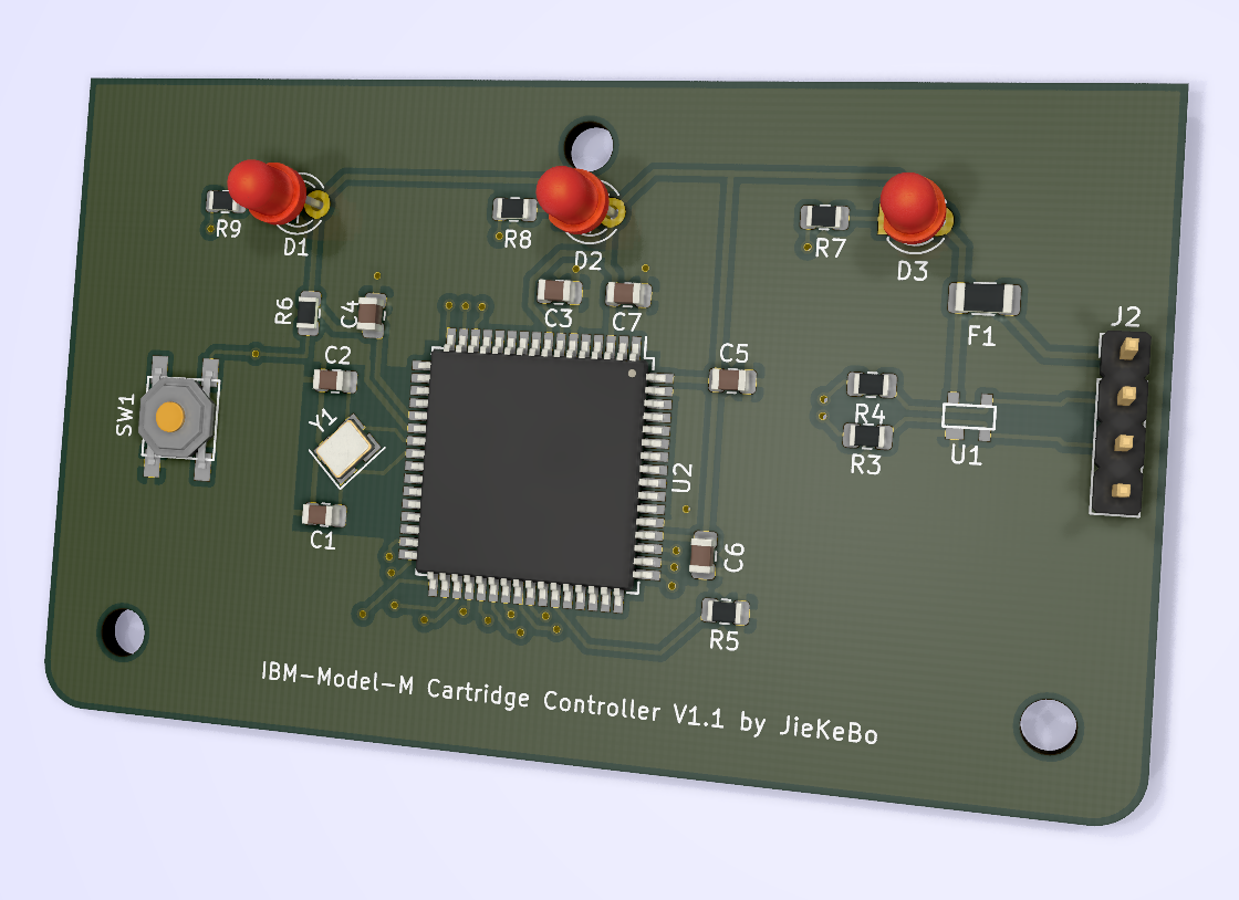

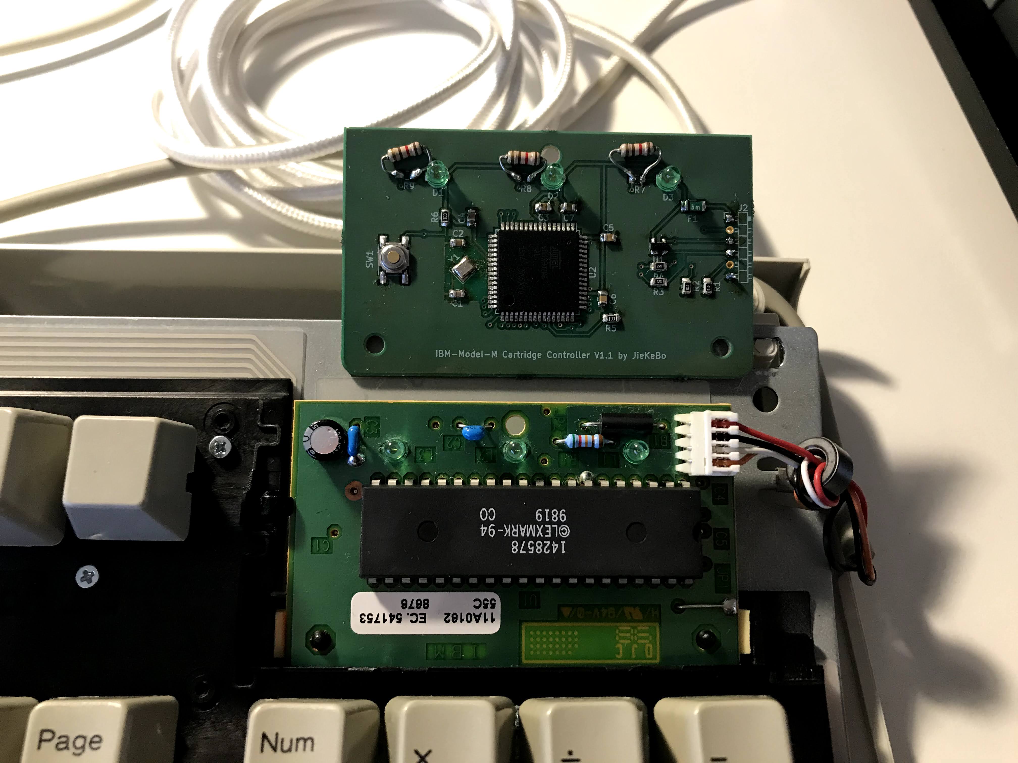

Below you can see a prototype of one of the boards that is aimed for Model M that have a small controller with integrated LEDs (mine is from 1998):

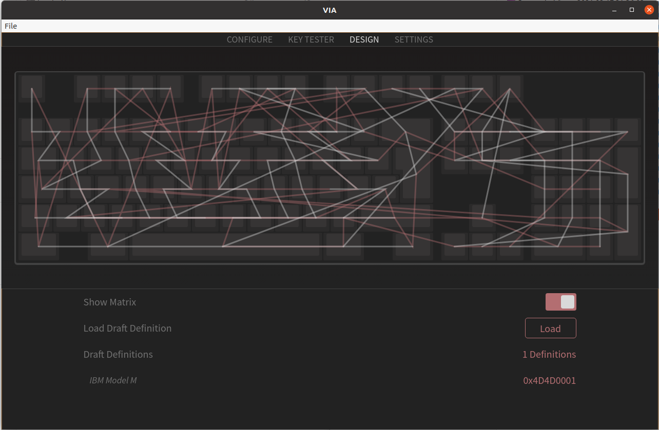

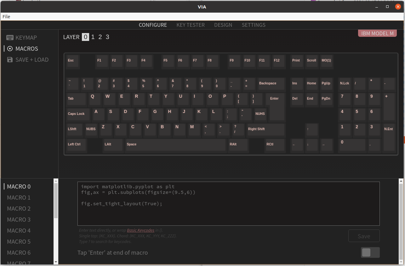

The board above is based around an Atmega AT90USB1286 MCU, and has QMK loaded. Also configuration has been made so VIA can be used to remap the keyboard without having to re-flash the MCU. Here is the Model M matrix mapped and loaded into VIA:
And resulting view when re-mapping with one of my favorite macros :)

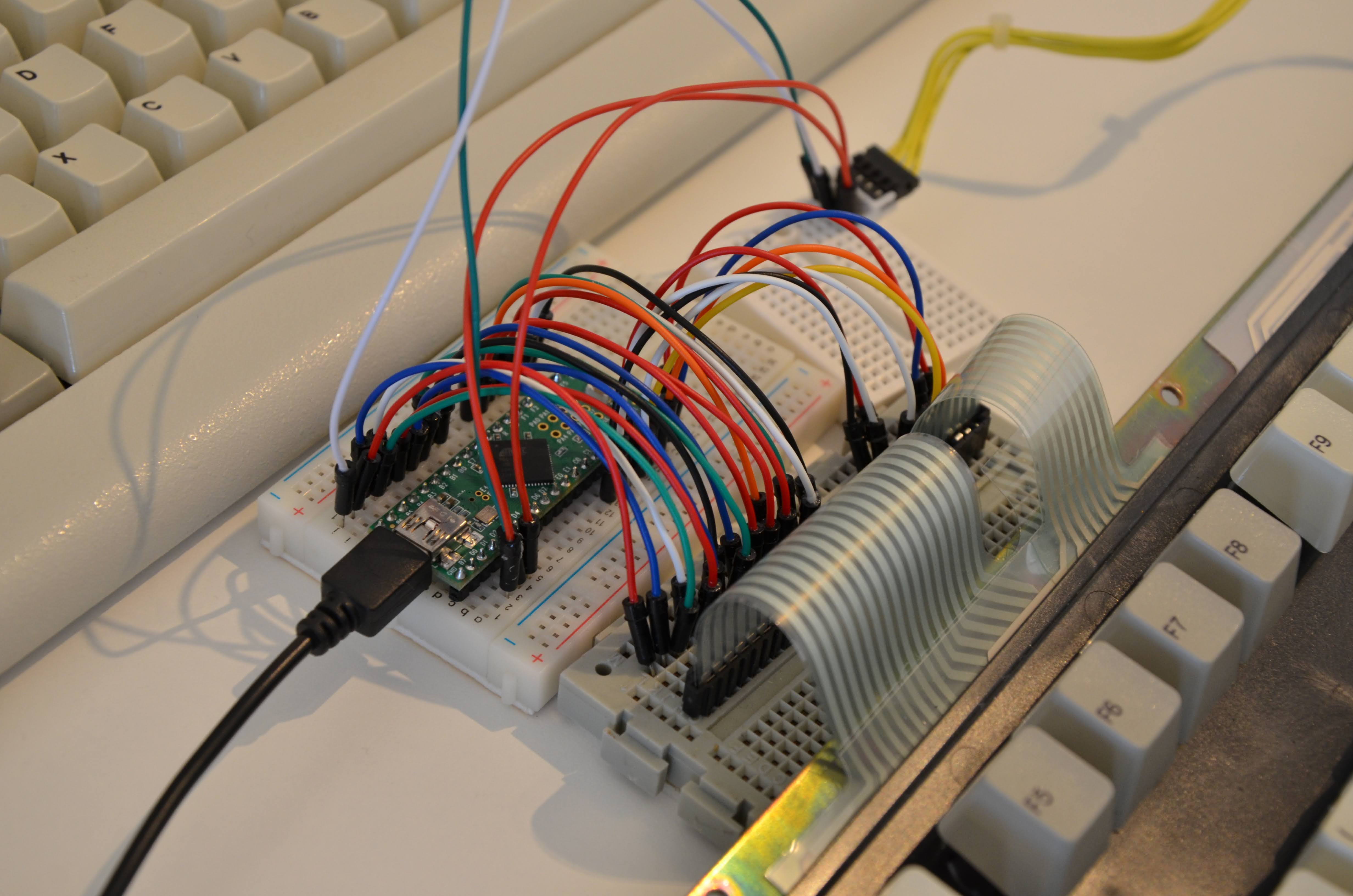

Small update from my side. I have been working on with the design of the second controller. First step was to reverse engineer the matrix behind the boards. I have released a video about my approach, here: https://youtu.be/dNqHS6UykQw

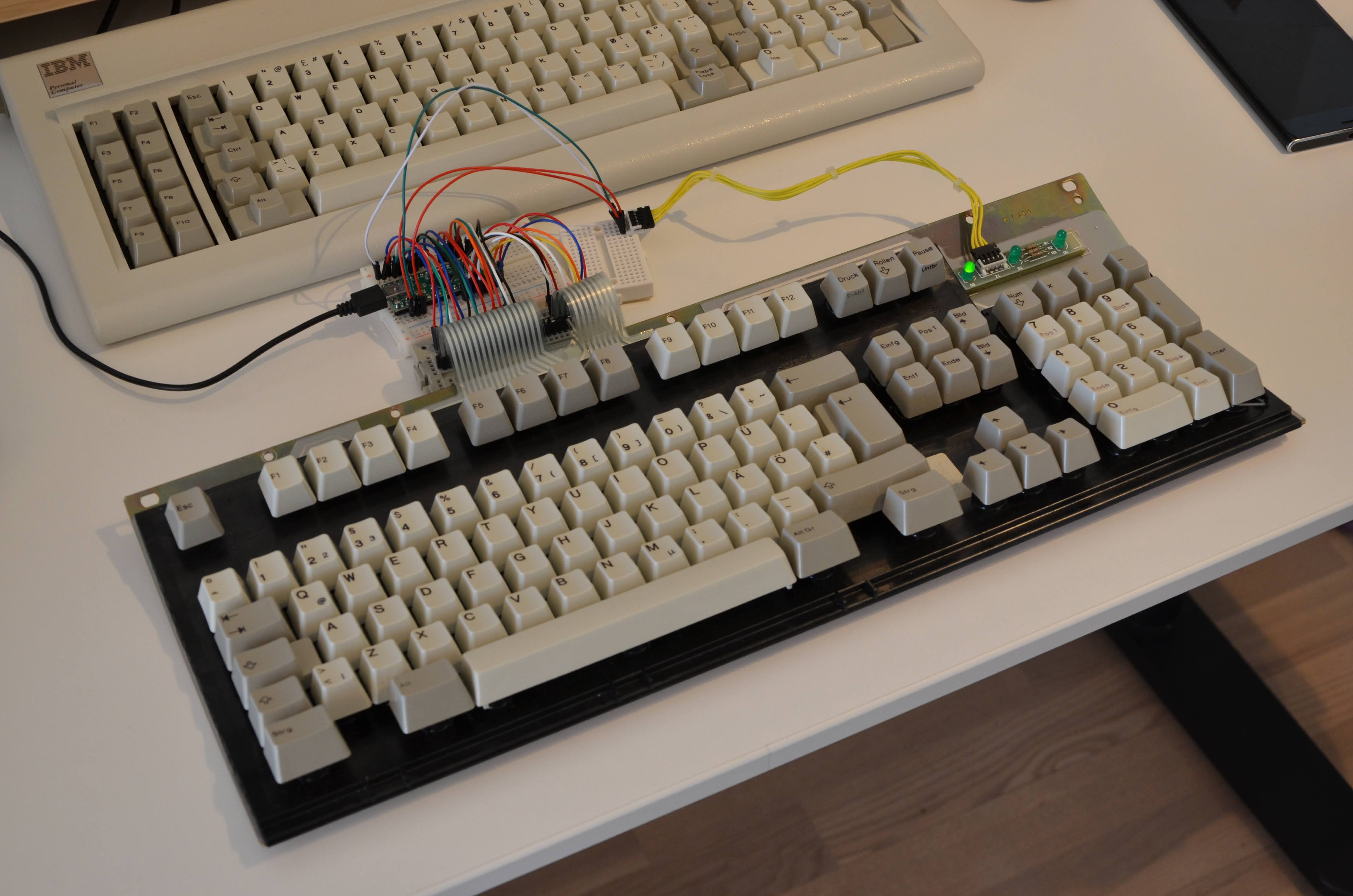

Also I have gotten hold of a few different microcontroller boards for use in prototyping and testing the matrix that I discovered with the above method. The first controller that I tested was a Teensy 2.0 ++. Below you can see it wired up according to the matrix.
Also I managed to get the leds to work:
Everything seems to work fine with this controller and it also seems to be a favorite among the people who answered the questionnaire.

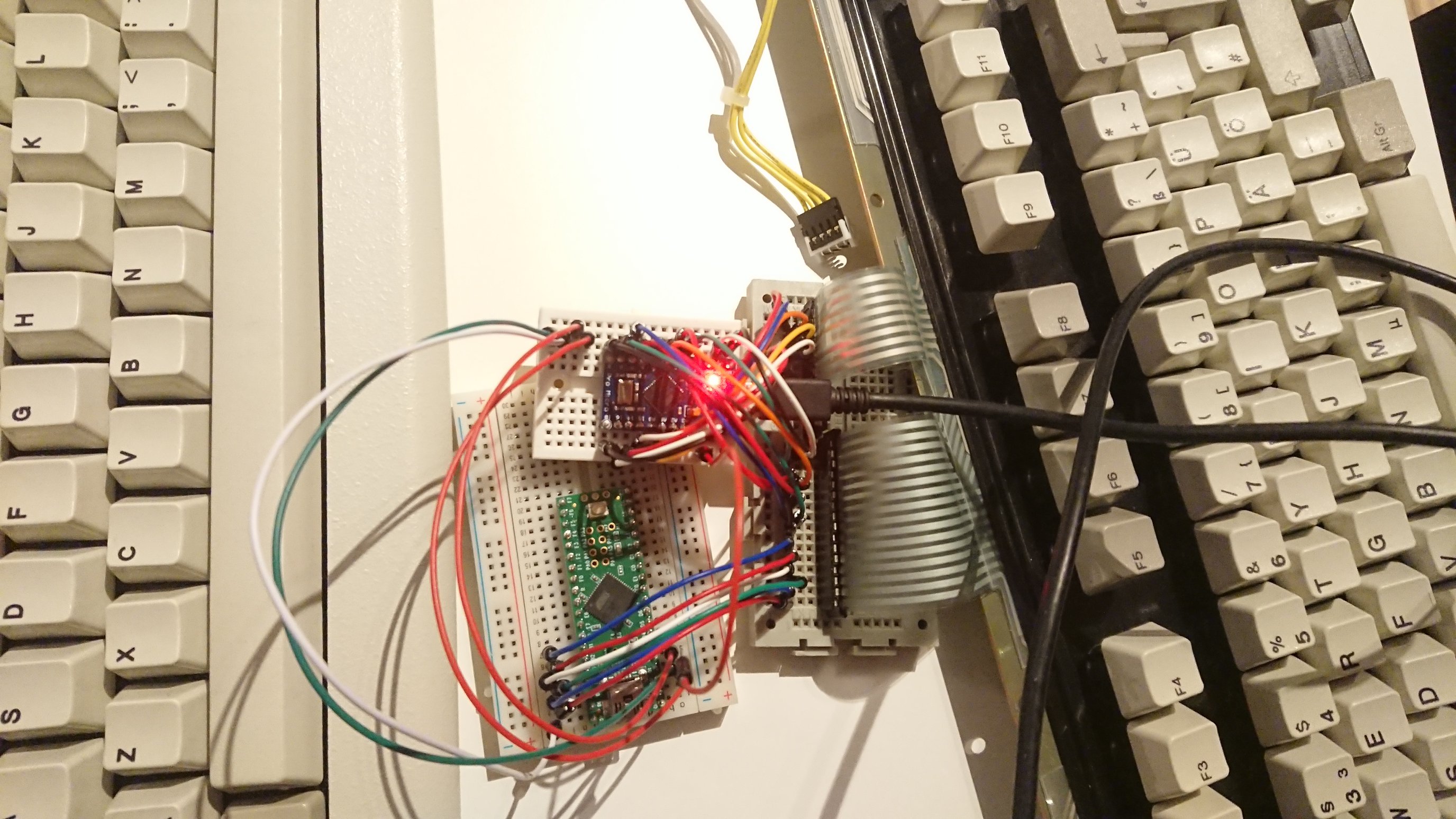

Next I tested out the pro micro board. Looks a bit messy on the picture below, and the board is really full to the brim with connections (save for the one you can hack on to at the leds). It works well here too, despite the lack of connections, something that could be solved by adding an io-expander. One thing that I did have an issue with was flashing it with VIA compatible QMK. I got an error saying the EEPROM setting was too large for the MCU. Perhaps a simple fix or an indication that the pro micro has too limited space for VIA? Maybe someone knows better than me.

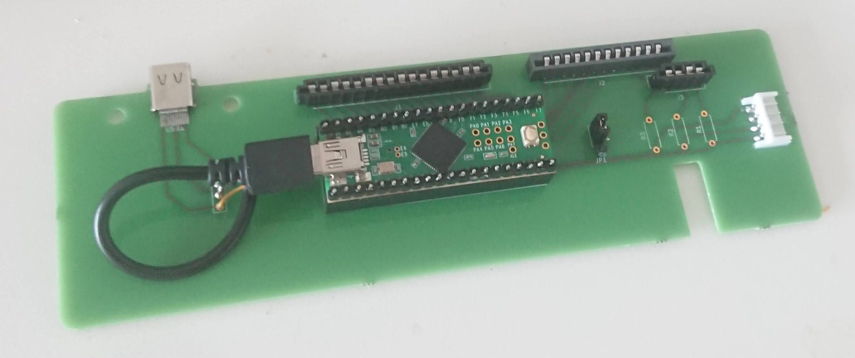

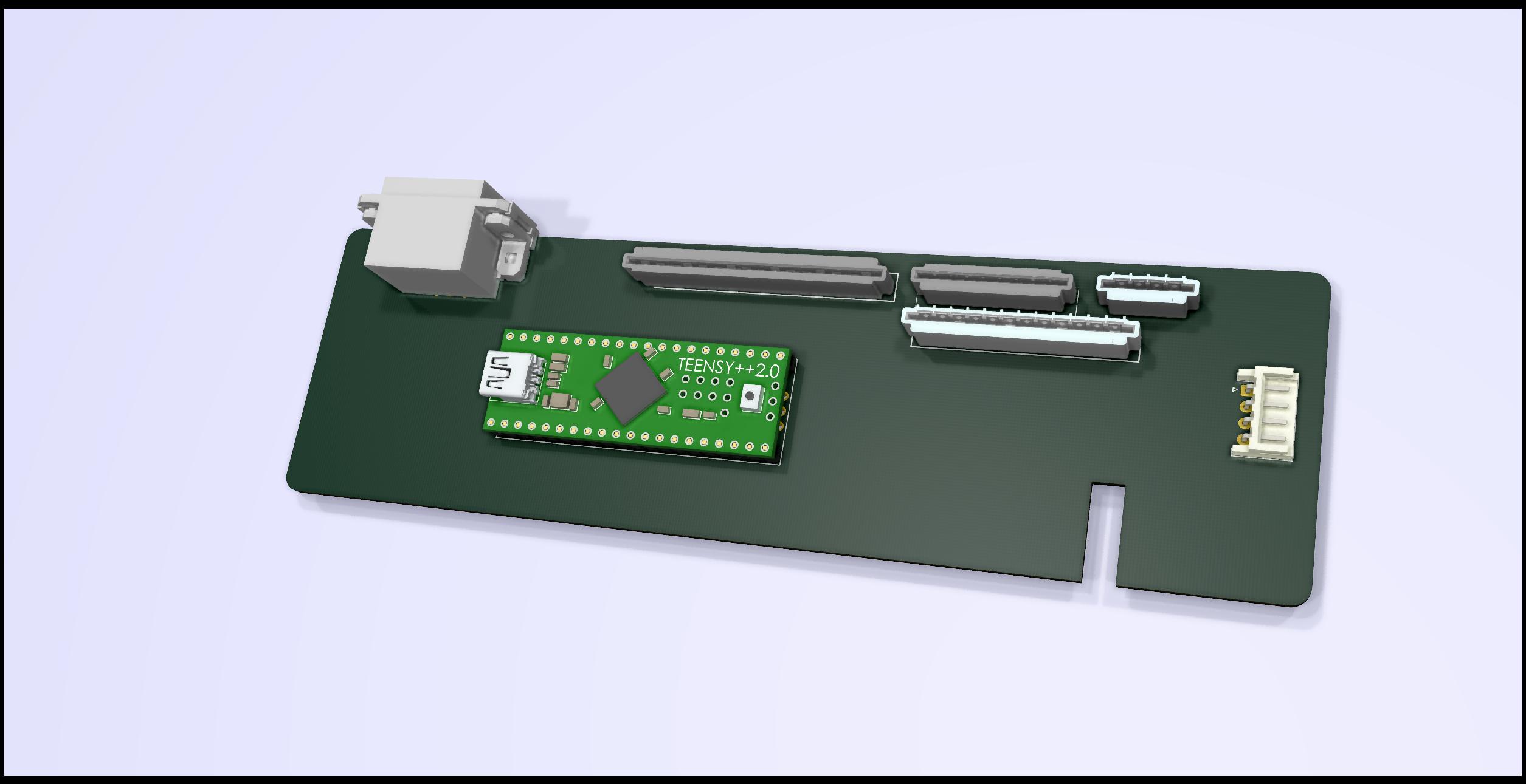

A while since last update. I thought I would bring this to a conclusion instead just leaving it open ended. Work continued on making a new controller board that would fit most models, and it got to a point where it seemed to be quite good.
So the first prototype was made that you can see in the picture below.
It as a Teensy++ 2.0 on board, placed in header pins (since I wanted to test other controllers out). On the main board there are all the needed connectors, USB type-C for connecting with the computer, FPC connectors that fits most model-m keyboards, room for resistors when needed (some model-m keyboards didn't have resistors on the led panel), and a jumper to switch between two compatible controllers (teensy and bluepill). Best of all, it works! Writing with it now :)
I realized that I have some challenges to overcome. First the link between the teensy/bluepill controller just feels bad. A cable going from the controller board to the main board is not the most elegant solution... Then there is my soldering skill which is really bad. I managed to waste a lot of components on another board because i botched the soldering job on the USB type-C connector. Feels bad...
