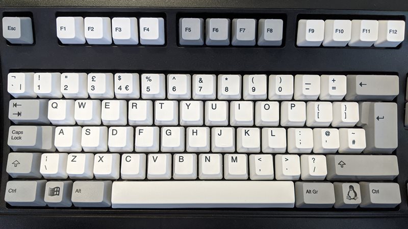

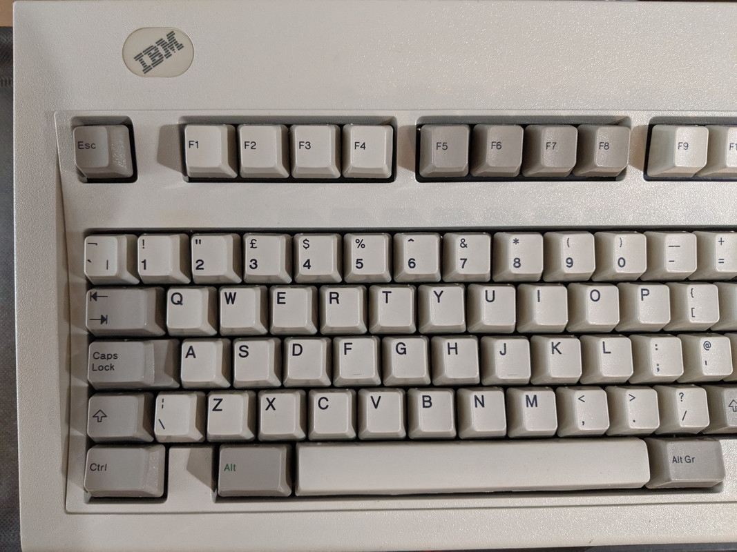

The ISO UK layout that is currently being utilised by Unicomp requires, at the very least, the following corrections:
• "Return" arrow legend on ISO Return/Enter key should be moved upwards such that the arrow points outwards to the centre of the stepped part of the key, instead of out toward the lower part of this stepped section as it is on your standard key map. I believe that whoever created the current UK legend map file simply removed the text from some other European layout which has text at the top above the arrow legend, e.g. the "Invio" on the Italian layout, without correcting the position of the arrow by moving it upwards. This is not correct.
Image Image
• On the -_ key, the "_" legend is aligned too far down and the "-" legend is aligned too far up, bringing them too close together and too far from the edges of the keycap. The very same problem occurs on the =+ key as well.
Image Image

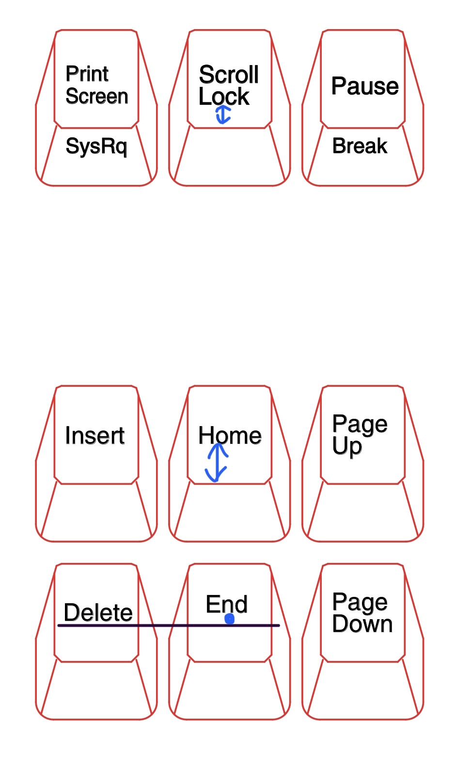

• "End" text legend on End key vertically centred on the keycap, like the neighbouring keys. On Unicomp's standard map, they for some reason have it too far up, as if there were a second line of text below it, but there isn't. Unicomp told me that this was recently corrected on their ANSI US layout, but not on the ISO UK one.
Image Image

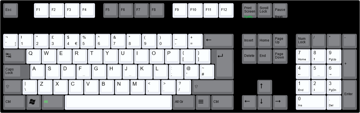

• The entire top row (the "Function" key row, Esc, etc.) seems to be off-centre, the legends being further down than they should be. It's like they're meant to be centred but they aimed wrong, so I'm not sure if this one is just a production inaccuracy or if they are actually wrong in the source file.
• Similarly, all legends across the entire layout should be more consistently and more tightly left-aligned, and in cases where a legend is near the top of a keycap as tightly aligned to the top as it is to the left. In many cases, alphanumeric keys on my New Model M had legends drifting further into the keycap than they should, either horizontally, vertically, or both. In general, the alpha keys had legends printed noticeably further from the corner of the keycap than any of the classic IBM boards in my collection (as of now, I have three of those and parts of a fourth). On some keys, it is again unclear whether the inaccuracy is a production issue or a source file issue; look at the left Shift key, for example (which I think is severe enough to be a source file issue).
Image Image
I think ideally, it would be good to approach Unicomp with this information, presented as clearly as possible on a support ticket, and try to convince them to fix it. It's something that should only really take minutes, assuming they have editable map files they can update by simply nudging elements around by a few pixels here and there. Hell, if they'd listened to me a month ago when I mentioned this as part of the wider issue of the various niggles with my New Model M order, they could probably have corrected the issue faster than I wrote this post. As it stands, the only offer they made was that I would have to place an order for a "custom" fully printed keycap set and detail the "custom graphics" I wanted. I would like some slight tweaks to get a nice layout for myself, so I am probably willing to do this for that reason, but I am dismayed that it seems to be deemed necessary for me to do the legwork and pay an extra tenner plus an undetermined customisation fee of anything up to $50 just to coax them into producing a standard UK keycap set that isn't all wonky.
Absolute worst case scenario is they basically tell me to stick it up my arse with a clockwise twist. Second-worst and probably more likely scenario is that they treat this exclusively as a "custom" keycap set, expect me to pay them a customisation fee and extra $10 for a "custom" rather than standard layout (even though this is by definition the standard layout they should be using already, if they're ostensibly producing "Model M" keyboards). Best-case scenario is they actually fix it, and this becomes the new standard UK layout for the foreseeable future.
If you spot anything else you think might be wrong in the actual source file for this layout, or in any other current Unicomp layout, do post away with your findings!

an_achronism wrote: 31 May 2021, 08:23 • On the -_ key, the "_" legend is aligned too far down and the "-" legend is aligned too far up, bringing them too close together and too far from the edges of the keycap.
I think that in this case, IBM did the underscore character wrong in the past, and Unicomp does it right.
It should be located just below the baseline.
However, the legends of this particular Unicompkey might be located slightly too high up overall. The += key definitely has the full legend too high up.
an_achronism
31 May 2021, 11:13
Findecanor wrote: 31 May 2021, 11:10 I think that in this case, IBM did the underscore character wrong in the past, and Unicomp does it right.
What makes you think that? It's like that on everything from at least Model F onwards, it looks really uneven on the Unicomp cap to me.
31 May 2021, 13:34
The character on each row should be in a straight line. The underscore should have alignment like this: _ , not like this: —.
The hyphen and the underscore is one unit. But I agree that Unicomp then does align each such unit badly.
BTW. Many other keyboards have copied IBM's bad underscore. Even Apple has an unaligned underscore on aluminium keyboards, while it had been fine on earlier keyboards. Cherry's underscore is fine also.
an_achronism
31 May 2021, 18:21
Findecanor wrote: 31 May 2021, 13:34 The character on each row should be in a straight line. The underscore should have alignment like this: _ , not like this: —.
It isn't aligned like a dash though, not on the 1990 one. It is more or less running in line with the bottom of ")" with a tiny margin for error. On the Unicomp, it's similar enough that I'm willing to call it equivalent alignment relative to other keys on the row but all the keys in general should have their legends moved closer to the keycap edges so that kinda makes sense.

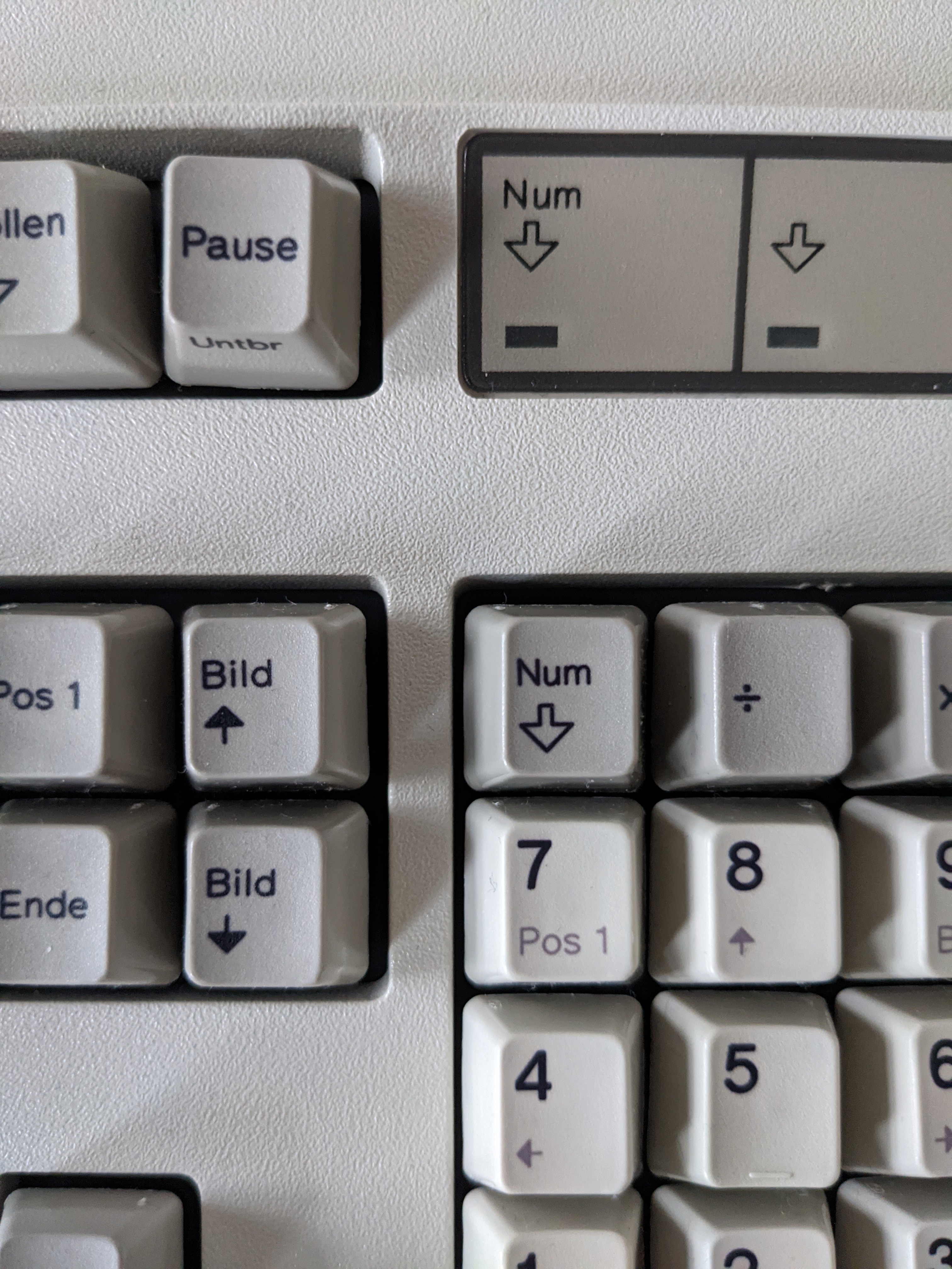

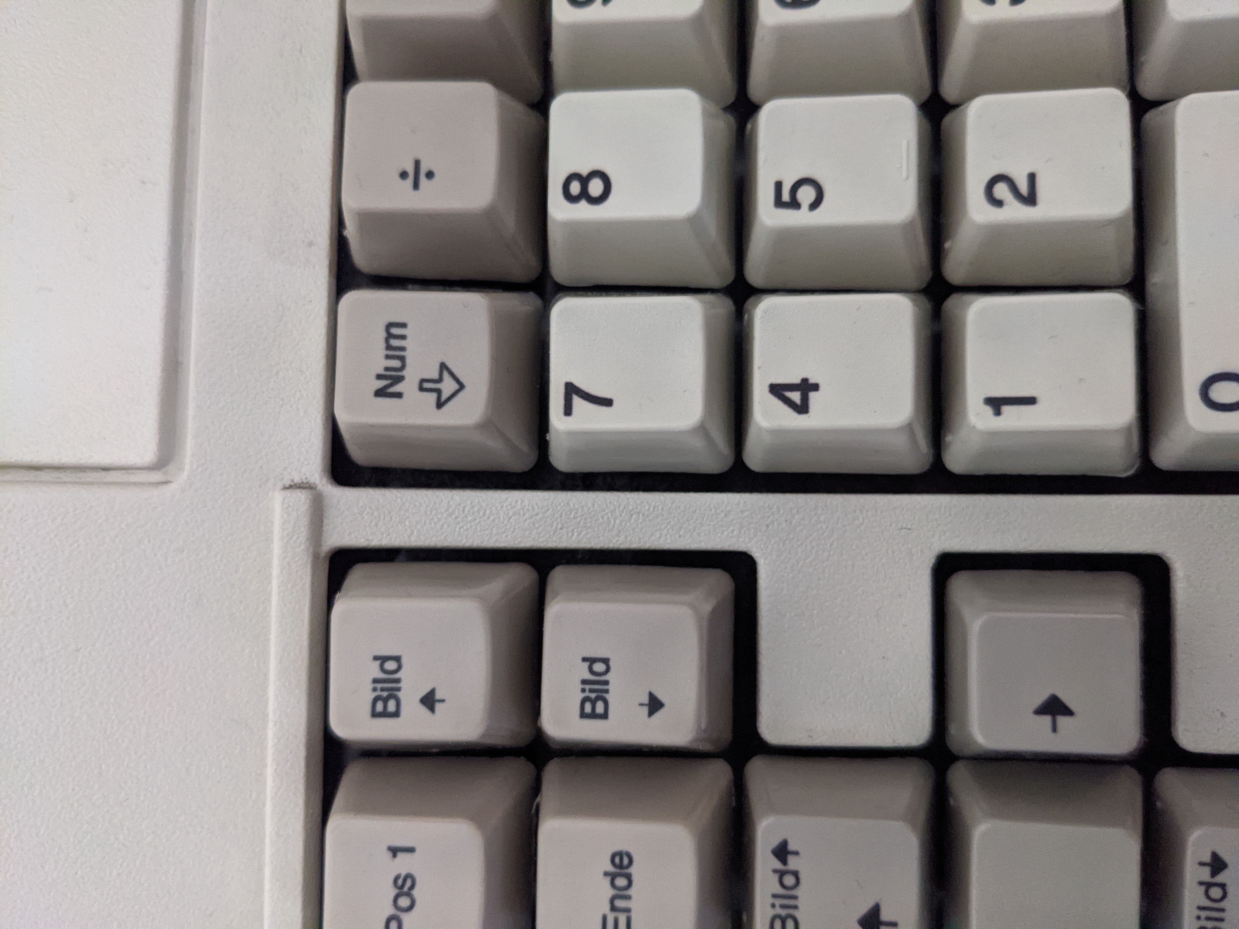

Today I got a few single keycaps for my M122. While the printing quality is much much better than a few years ago (much sharper, no more fuzzy chars anymore, even better then original ones), the alignment is questionable.
I got the PgUp/PgDn keys and the NumLock for example:
Unicomp ones; the arrow on the NumLock is shifted towards left and not in line with the text above; the arrow on PgDn is placed far more downwards then on the PgUp key:
IBM ones, made early 1990:
I`m more than happy to have the ability to buy new made keycaps for decades old keyboards for one or two dollars a piece, but a little bit more attention to details could help.

feltel wrote: 01 Jun 2021, 18:51 Today I got a few single keycaps for my M122. While the printing quality is much much better than a few years ago (much sharper, no more fuzzy chars anymore, even better then original ones), the alignment is questionable.
It's interesting that "Ende" is actually printed in the right place despite it having been wrong on both the US and UK layouts, hahah.

If at least the printing files are corrected, then it removes one element of the alignment issue, leaving only the in-the-moment inaccuracies of production, which can be handled to some extent by ordering the keycaps as a custom set because they have a more involved and longwinded approval process compared to their standard production line approach. I wish that were not necessary, but they're fairly small and seem to need to work very quickly, so I get that it's driven by necessity. Generally speaking, I don't mind paying an extra $10 if it means getting significantly better alignment and moulding compared to the stock results; if I had known the reality of the situation before ordering, I would be less annoyed by it after the fact, as I would've been better positioned to make a more informed decision on the matter rather than ordering expecting something better than I was going to get. As it stands, I feel like I spent a lot of money buying and shipping a board and a bunch of extra keycaps that all arrived in less than satisfactory shape. That sucks, because I'm disappointed as a customer, and Unicomp is having to go through this song and dance with me to try to come to some kind of compromise.
In terms of providing a guide graphic, I don't think I'm qualified to give them what they would actually need to produce something better than they have already. I can mess about with keyboard-layout-editor and tweak it slightly after the fact, but that isn't really going to be that great. For instance, you only get so much control with things like font size, and the text is either too small or too large; positioning of legends is also not as finely controllable as I would need to do things like fix the Return legend position, so I've just moved it in an editor. But here's a very rough idea of what I reckon things *should* look like, mostly just done on the layout editor site with minimal editing afterwards (note the text size is too large so the nav cluster keys are too cramped for instance). Note also that my personal preference would be for the "Windows 95" legends to be used so that's what I'll be doing on my custom map, but they don't exist on keyboard-layout-editor, so I've just used generic legends here (and the Shift arrow isn't quite right either). I've also left-aligned them, which differs from Unicomp's habit of centering them, because it seems strange to me that every other legend is left-aligned and these aren't (even if you look at the Shift arrow legend on a Model F XT for instance, the arrow is very definitely on the left, not the middle, of the 1U key top).

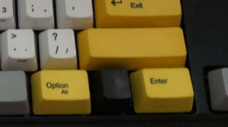

By the way, those yellow caps look pretty good moulding-wise, though the colour looks like it might be a little inconsistent. The black one looks like mine: uneven colours, bit shiny toward the middle. I'm trying to figure out which colours they seem to do better i.e. that don't have the weird moulding inconsistency shown on those black caps. I think the darker blue ones have the same issue.
Image Image
