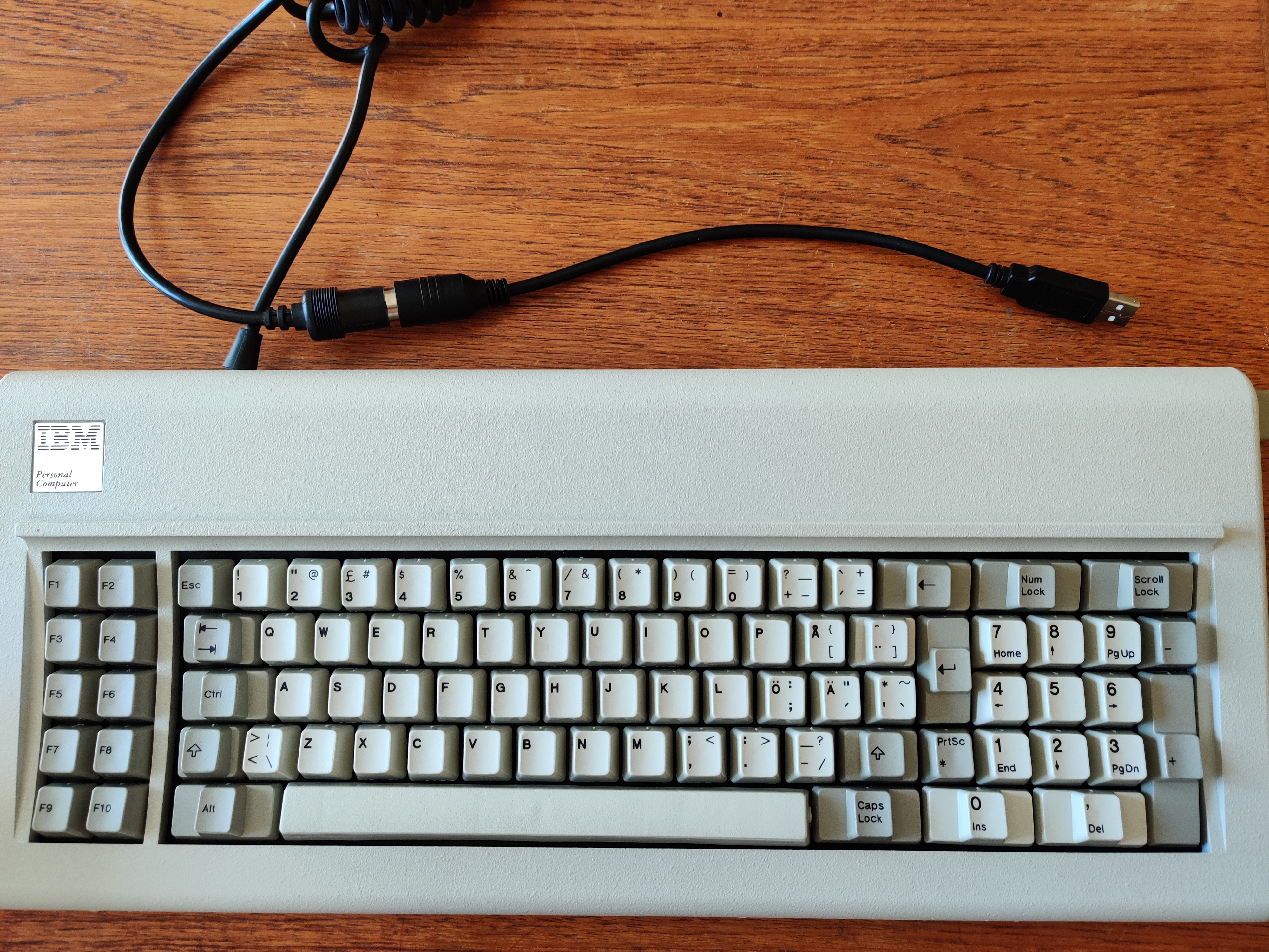

wim_board
04 Jun 2021, 12:18
Hi,
Original poster here, sorry for being away, and thanks for all your kind help.
It cleaned up nicely
2021-06-04 12.05.24.jpg (4.27 MiB) Viewed 5915 times
This board is the XT variety, and the Soarer's is of the commercial kind. Just an extension plug, no circuit board board. The layout is Swedish.
Ctrl + Alt doesn't make Alt Gr in this case. I'll be able to remap it later, but I haven't figured out how to work the converter on Linux yet. Maybe I'll need to make the hex-files from scratch.
After some testing, I've found that the third (and fourth) letters are reached by changing language settings on the computer side. That's not bad, but it's a bit of a hassle to change language just to write an @-sign.
That's where I'm at right now. Any thoughts?

Hi wim, did you read the posts above? You can absolutely map another key of your choice to AltGr.
If you need help with Soarer's on Linux, just say the word. There's lots of us using a proper operating system here :-)

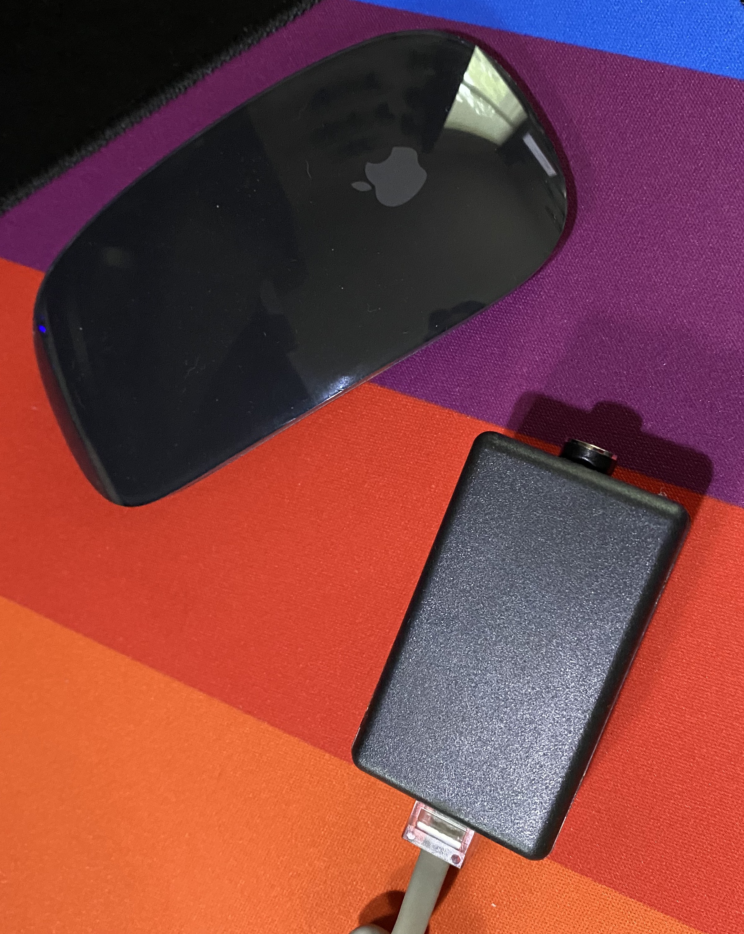

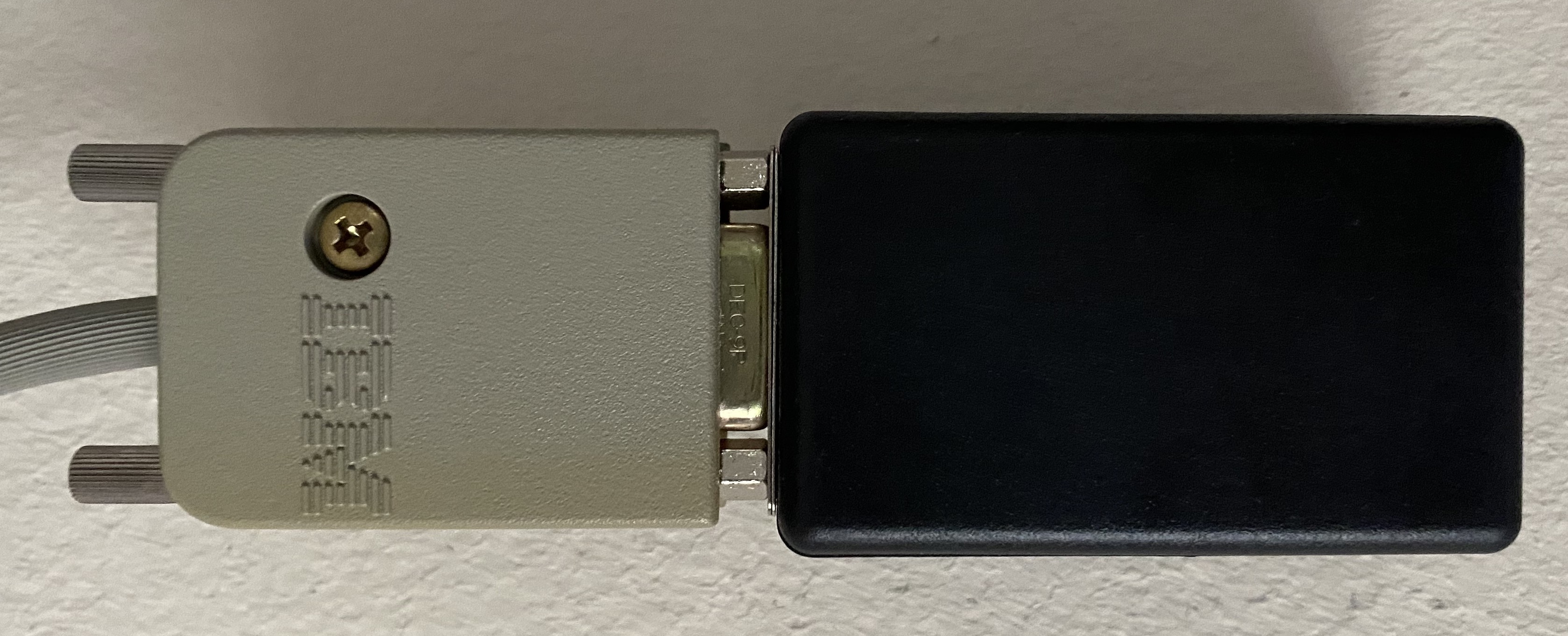

Thanks to our very own Orihalcon the Soarer's converter is by far the easiest point of entry to get folks from 0 to using an awesome classic board in a single purchase.
I'm not a big fan of the janky look either and don't have the time to invest in learning 3D modeling so here's the solution I've arrived at for my Pro Micro based converters. I use a simple project box and cut holes in it using the drill or snip method and then hot glue things down inside. Pro Micros get glued to the lid, the rest of the parts get glued to the base. I find them less janky than a bare solution or than the heat shrink editions out there, but not nearly as clean as what Orihalcon does or some of the custom 3D printed things others have done.
BOM:
Project Box
Optional magnetic cable to protect the Pro Micro's delicate socket - extra tips available separately
Pro Micro
Some flavor of breakout-style connector for what I need:
https://www.amazon.com/gp/product/B0814LTB6L/
https://www.amazon.com/gp/product/B08HGS5G8N/
https://www.amazon.com/gp/product/B083925STQ/
https://www.amazon.com/gp/product/B01HM6UBN0/
Here are some finished products:
IMG_0638 copy.jpg (915.74 KiB) Viewed 5770 times
IMG_0636 copy.jpg (1.74 MiB) Viewed 5770 times
