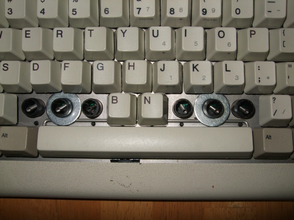

The amazing wcass had earlier dreamed up another option for stabilizing the space bar that is easier, cheaper, and can be done in seconds..
You can use 2 washers simply dropped over barrels to hold down the stabilizing wire. They need to be 7/16" SAE washers (which are larger and wider than ordinary 7/16" washers) and I don't know whether there is a metric equivalent.
The solution isn't perfect - there is an almost imperceptible rattle and those keys don't depress the last mm or so, but those complaints are pretty trivial if it gets the F-122 up and running - now.
