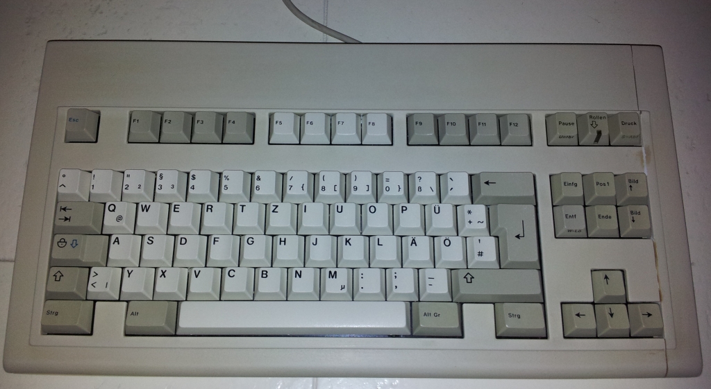

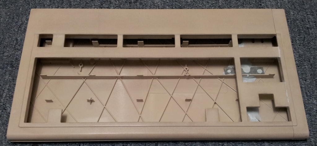

here you see a little progress in my 1501 mod.
Tarkoon brings up the idea to make a 1501 a tenkeyless.
Controller is in the right position, the case is screwed and easy to mod.
NKRO and all the old DS sets fits without moogle kit.
This time i use some little metal pieces (instead of plastic) as stabilizers. So i am able to bring up more pressure during the "gluing".
The PS/2 cable is atm not detachable. Tarkoon plans to do it. So i maybe change this before i spray the housing.
Maybe a USB converter find it's way...
The keycaps are mixed. Many 2551, few 1501.
I will update this the next days / weeks.
I am not shure about the color i should use. Any proposals?
- 1501 ssk.jpg (376.9 KiB) Viewed 10732 times
- 1501 case open.jpg (633.07 KiB) Viewed 10732 times

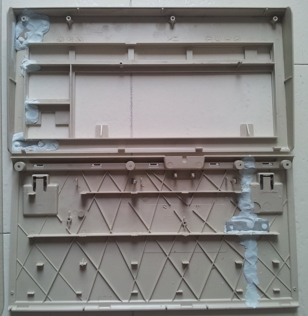

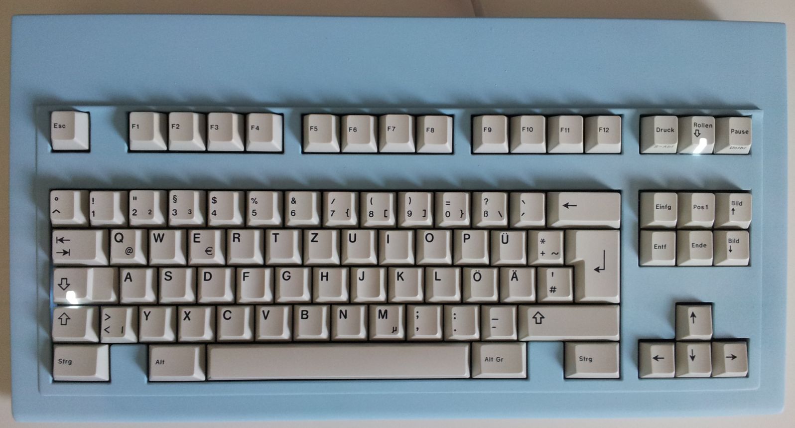

this is an optical illusion
in the 3rd pic, the fine glue (brown) fills all the litlle holes. the sanding is also done.

So you're saying it's physically near perfect (when feeling) just needs a lick of paint? Awesome, grats, have at it!
*edit to take back any doubt of you/ceesa making this one niiiiiiiiiice after having done sixty's, somehow remembered that reversed, that sixty made yours xD

After Sixty's keyboard this is your best mod I think
I love it!
I love it!

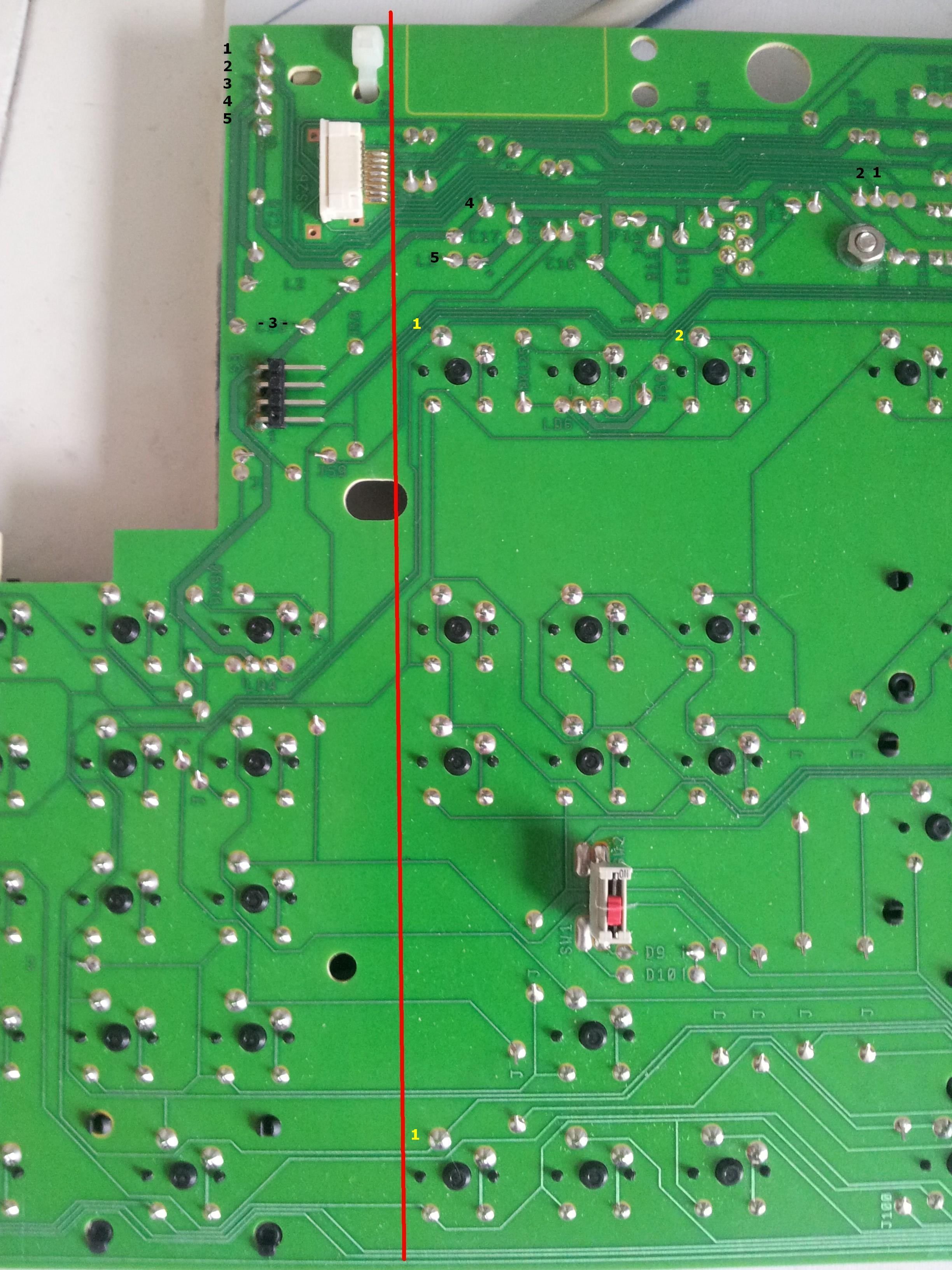

not like it should be...
- Acanthophis
Do you have more photos? Maybe of the sawed PCB or the general 'modding into TKL'-process?
I am about to try a TKL mod myself when the keyboard arrives.

if you need a better one (i think so) give me a hint. I would upload it later.

I'd think it's just the top left and bottom right that are needed in more detail; top left is unclear where the two/three black wires connect, and bottom right it's unclear if that long white cable is split into two and connecting on the row above space or if that's just tape blurring the vision there.CeeSA wrote:if you need a better one (i think so) give me a hint. I would upload it later.
Don't have the board though, but just noticed

no, there was no metal bar. There was a copper film underneath the PCB separated by a plastic sheet.
@off i have to upload a better pic in the evening, if not pls remind me.
*EDIT* better pic
there is no splitting cable lower right (more shadow).
*EDIT* better pic

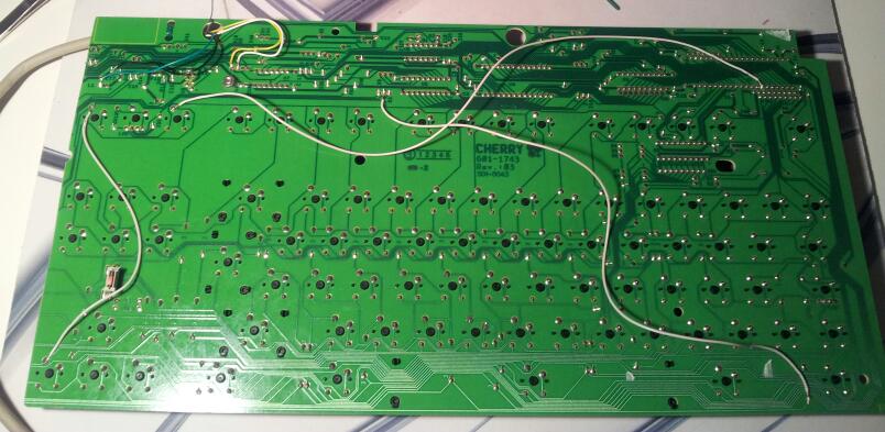

Someone who wants to cut his PCB should trace his own PCB for the leads to cut/jumper as those can vary and you may find yourself in trouble otherwise.
my 1501 is just open due to me spilling tea over it yesterday...
Looking at my PCB I don't see any sense in connectiong the lowest right solder to the switch in the lowest right anyhow - that one ("Y" on DE layout) has direct traces to the ICs between F and num Row as well as to the IC above the ESC.
CeeSA were did you connect the cables shielding ? Seems you bend the wires just outside the pic on that.
- CeeSA
- Location: Westerwald, Germany
- Main keyboard: Deck 82 modded
- Main mouse: MM711
- DT Pro Member: 0016
i did not connect cable shielding. in my research it should be nr. 3 at the pic.
there was a resistor from point 3 to the lane of point 4.
hope the pic explain it better than the words
(the yellow numbers are not for the ps/2 connector)

yeah looks like mine (an DIN one) also with the resistor. That's why I was wondering. So no Shielding on your Mod. Any thoughts on the resistor/ missing shield ?

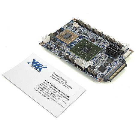

I'm considering using the space of the card-reader for something like this : 10cm x 7.2cm
EPIA-P900-10 1.0GHz Eden X2
Pico-ITX Board with 1.0GHz Eden X2 CPU, MPEG-2, WMV9, H.264,
1 x LVDS, 1 x HDMI, 7 x USB, 1 x IDE, 2 x SATA, 1 x GigaLAN, on-board DC-in
http://www.viaembedded.com/en/products/ ... serialNo=6
- off
- Location: the crapper, NL, EU
That's 4 rows you'll be needing (provided that the hdd doesn't extend past that), doubt you could sqeeze that in that top portion... But GL/HF, it IS a nice idea!Peter wrote:I'm considering using the space of the card-reader
10cm x 7.2cm
Never noticed it had a concealed cardreader on the side!

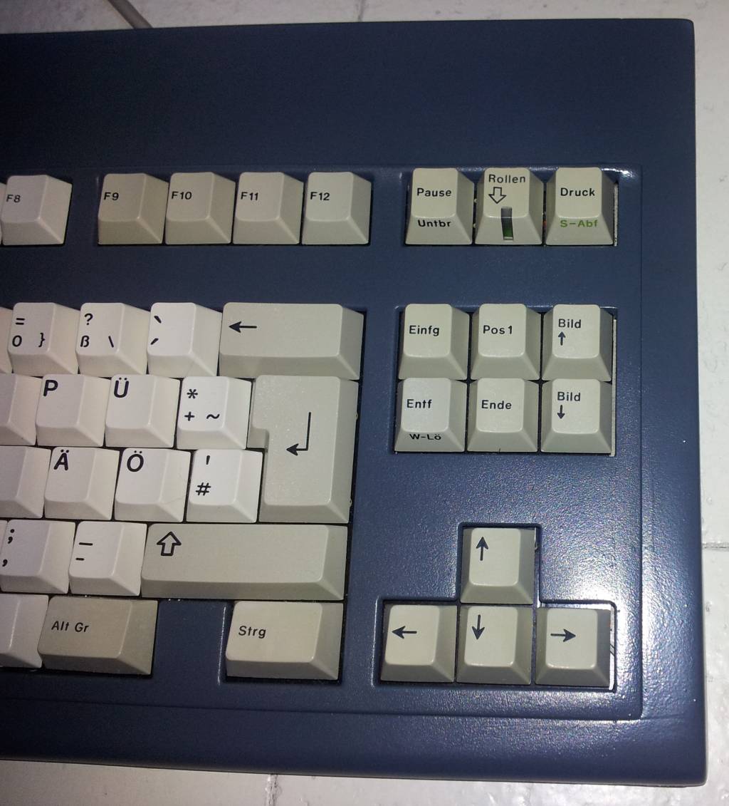

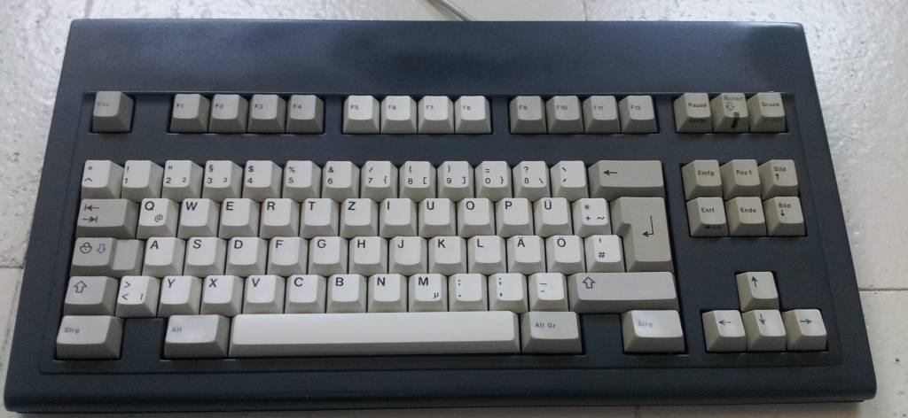

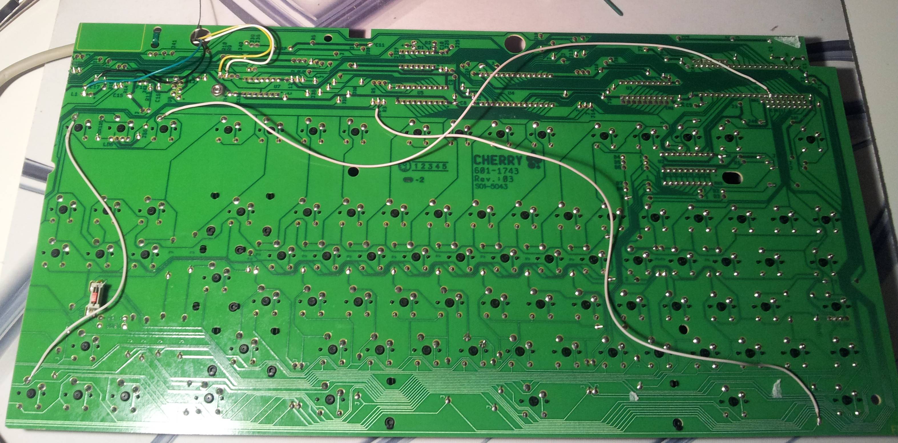

here is another ssk known from the keyboard party in Best.
it is in full function.
Beside the "making it a ssk" i change the switches to MX Blue and the LED's to white.
Open points:
- PS/2 to USB
- Detachable Mini USB
I am still thinking about the caps (color).
And should i add a gold Cherry Sticker?
Open points:
- PS/2 to USB
- off
That one.
Perhaps either a slightly darker tint for the case (slightly more grey added to the blue), or slightly lighter keys- try some 'pure' whites from an 11800?
And personally, at least from the pic, perhaps less 'sharp' leds; you could just take a marker and put a stripe on the led itself.

What's that white stuff on the inside of the case?
