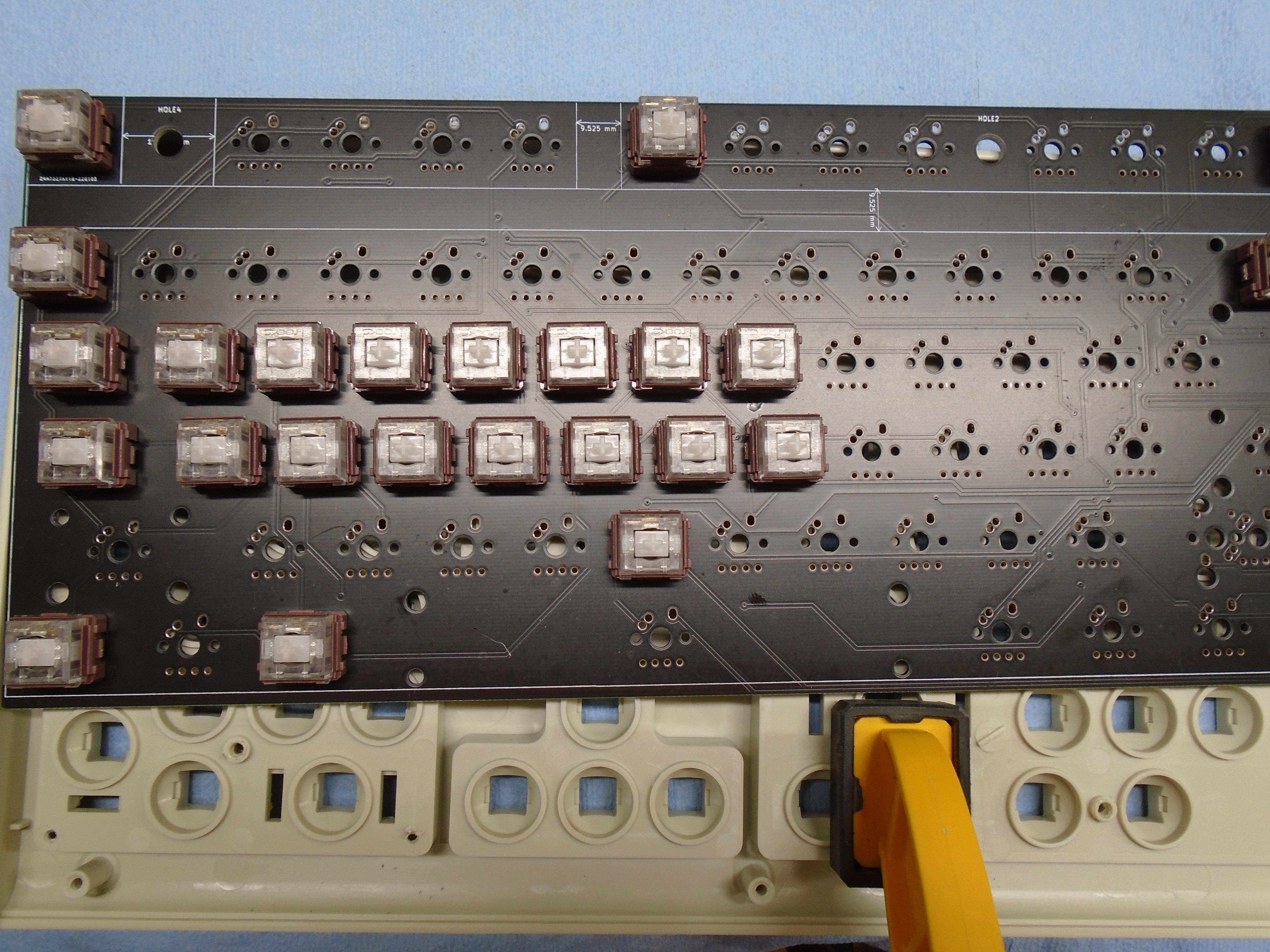

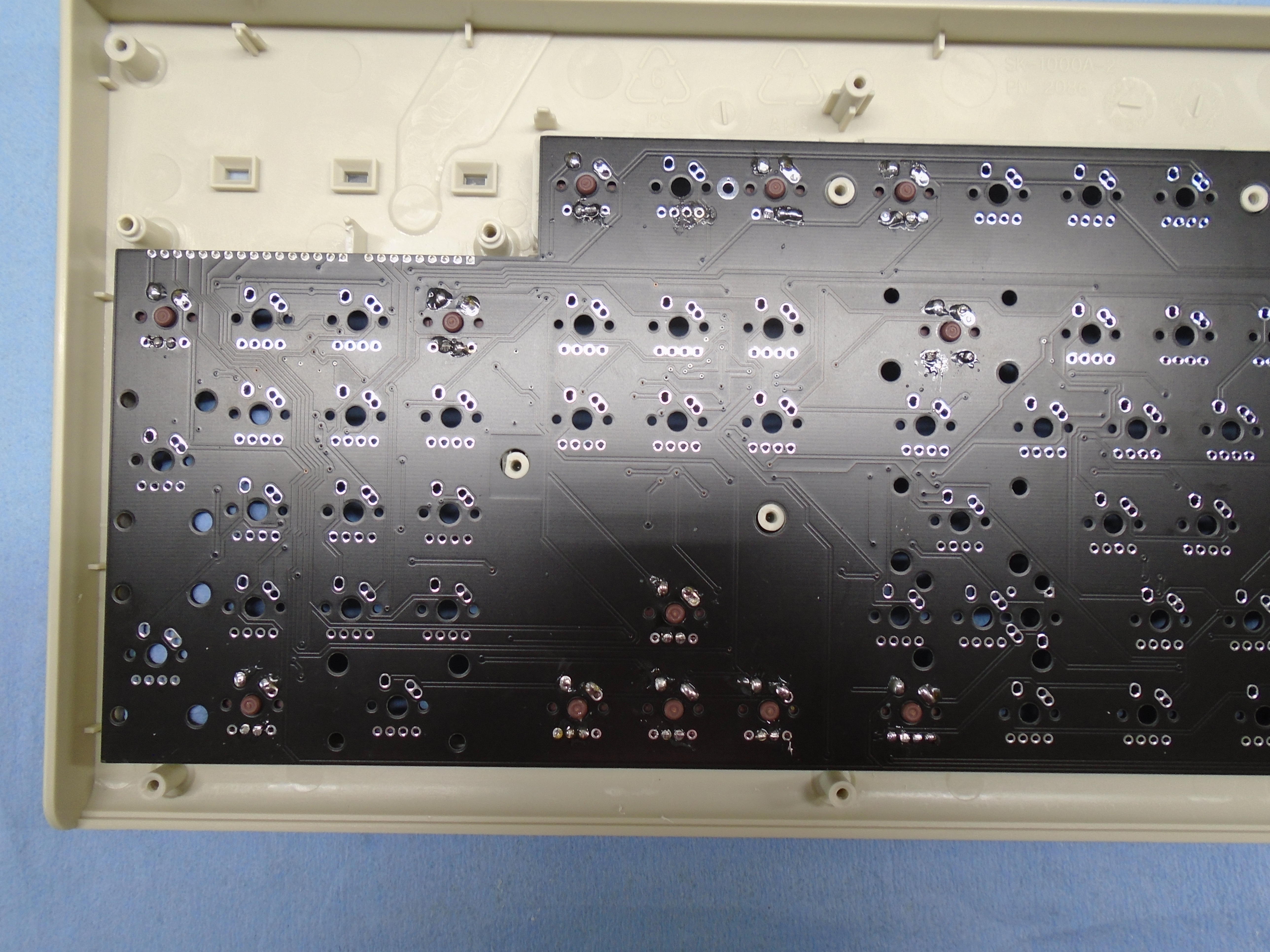

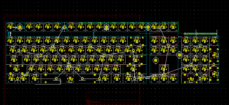

I am working on this idea I had, I got a Dell Quietkey SK-8000 and I am trying to convert it into a mechanical keyboard.
I modified the case with a dremel tool and now I am working on a PCB to replace the original membrane circuits:
sk-800 pcb.PNG (32.61 KiB) Viewed 16285 times
The PCB will bolt to the original backplate of the keyboard with M2 fasteners. There will be a sheet of kapton to insulate it from the PCB.
It is a slow process to probe the contacts of the membrane.
Any tips and tricks are appreciated.

I can't use an existing PCB there is a 7.05 mm island between the key groups which isn't standard.
An ALPS version is possible in the future but it would require special plate design and more modifications to the top case. I used an ALPS/Cherry hybrid footprint on this PCB

05 Sep 2021, 02:19
PCB is now in production, hopefully I did everything right.
SK-8K
05 Sep 2021, 02:21
I decided to do Cherry only for now to save on drill costs. In the future I may just make my own controller board because tracing out the matrix was very stressful to do. Maybe I will use this controller:

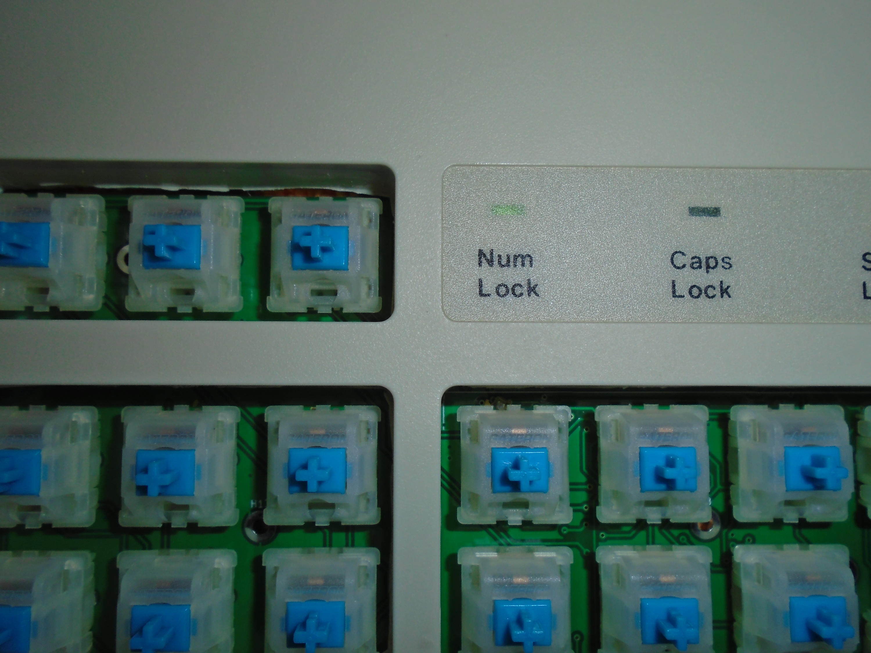

10 Sep 2021, 01:55
PCB test:
SK-8K

SK-8K
18 Sep 2021, 18:27
I have 3 extras which I will use. I am making a Revision 2 PCB which I will release to the public. It will correct some misallignment issues and hole placement and will have support for ALPS and I-Rocks switches.
On Ebay I have found some 0.6mm plastic pieces that I will use instead of the backplate.This prototype just has foam there.

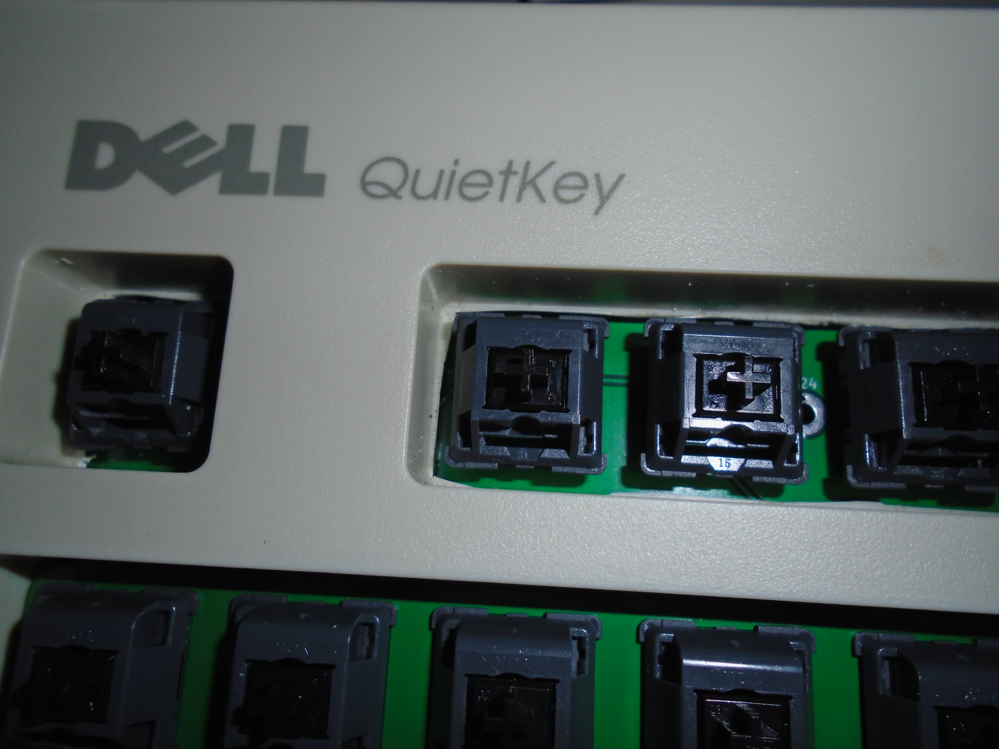

SK-8K
26 Sep 2021, 03:45

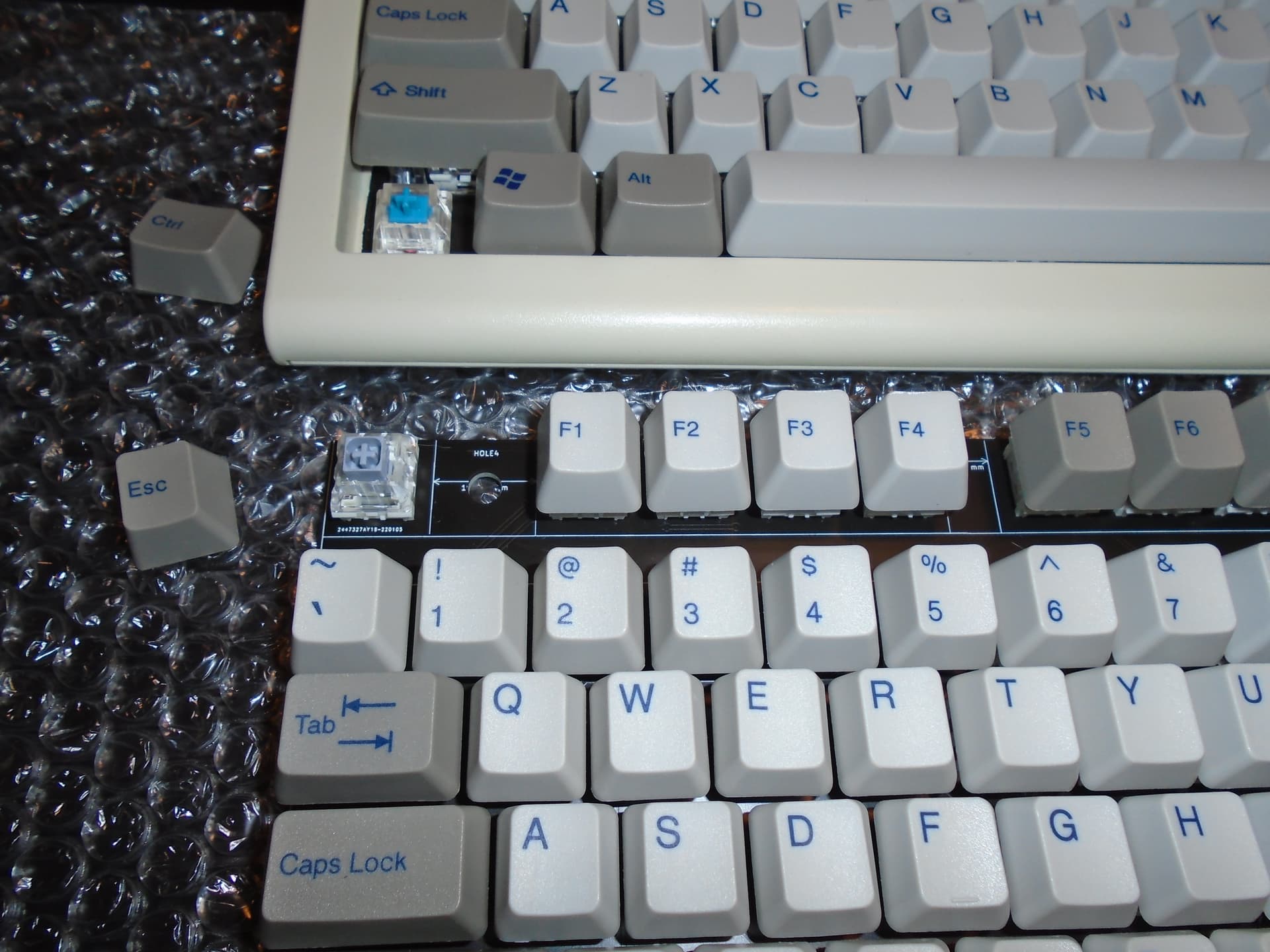

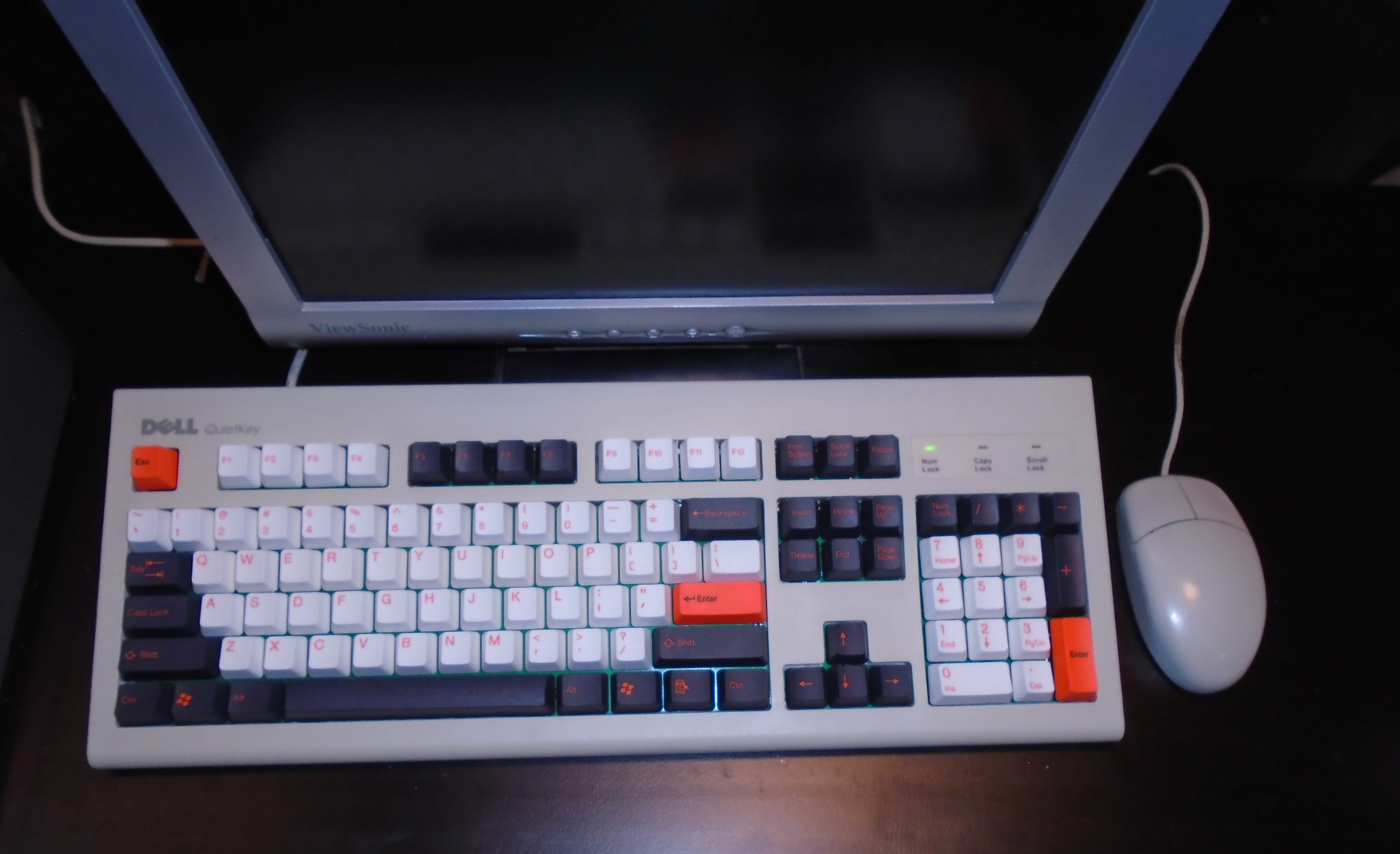

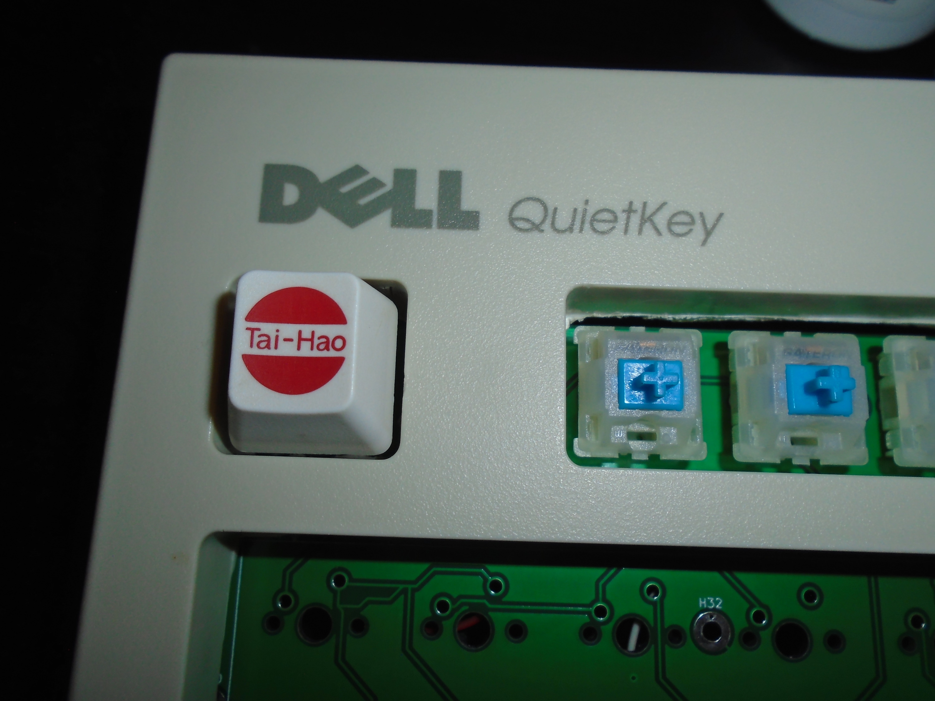

2nd build started,the Dremel cuts are much cleaner this time. Switches: YOK trash pandas switches.
SK-8K
29 Sep 2021, 02:00
Without any lubrication, foam, etc. these switches have quite a deep sound in the QuietKey chassis! It may sound better when I install the plastic sheets I got to support the PCB.

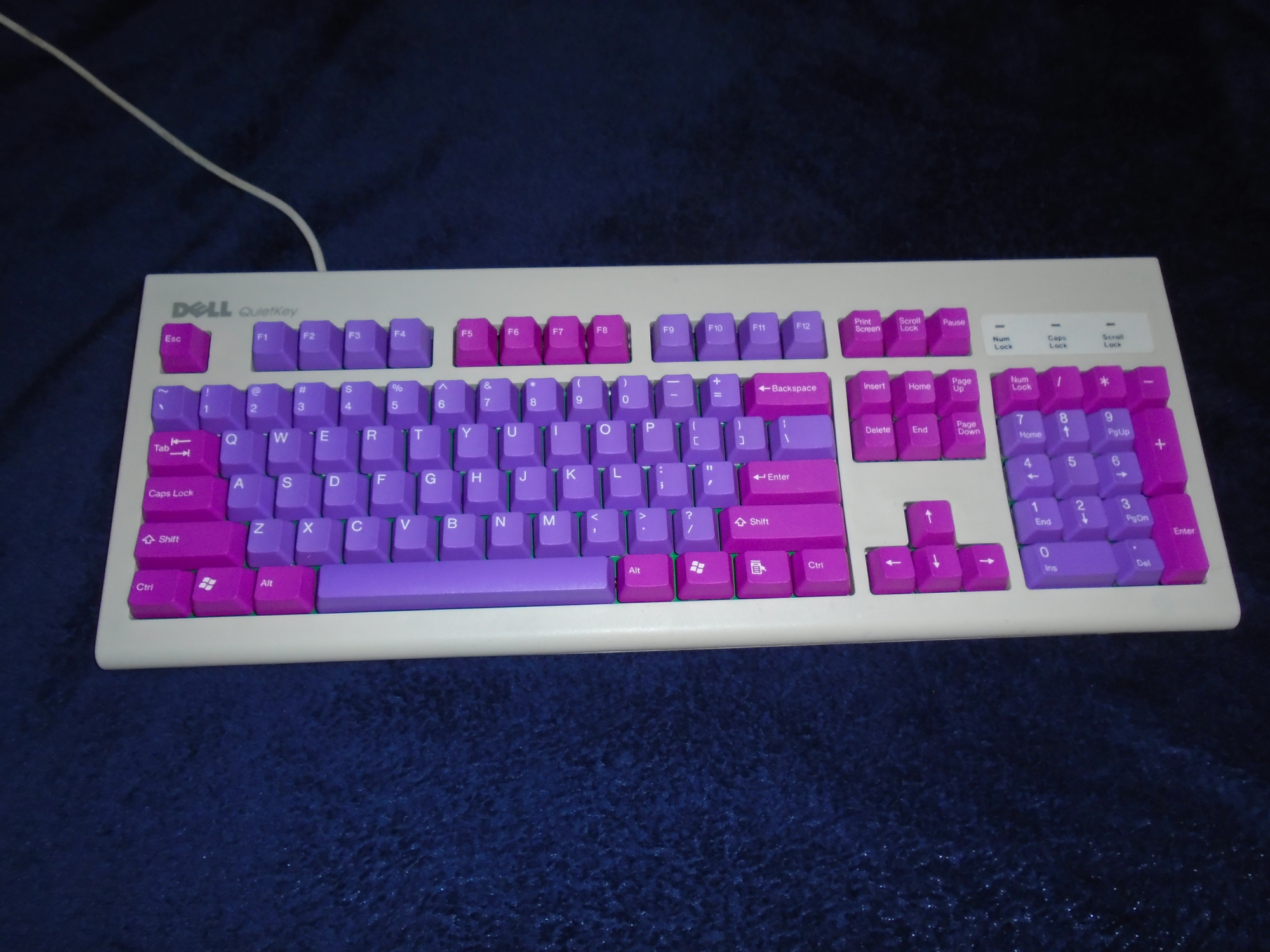

SK-8K
03 Oct 2021, 03:15
This one will be my new daily driver. Too bad the Geekhack scumbag moderators won't see it.

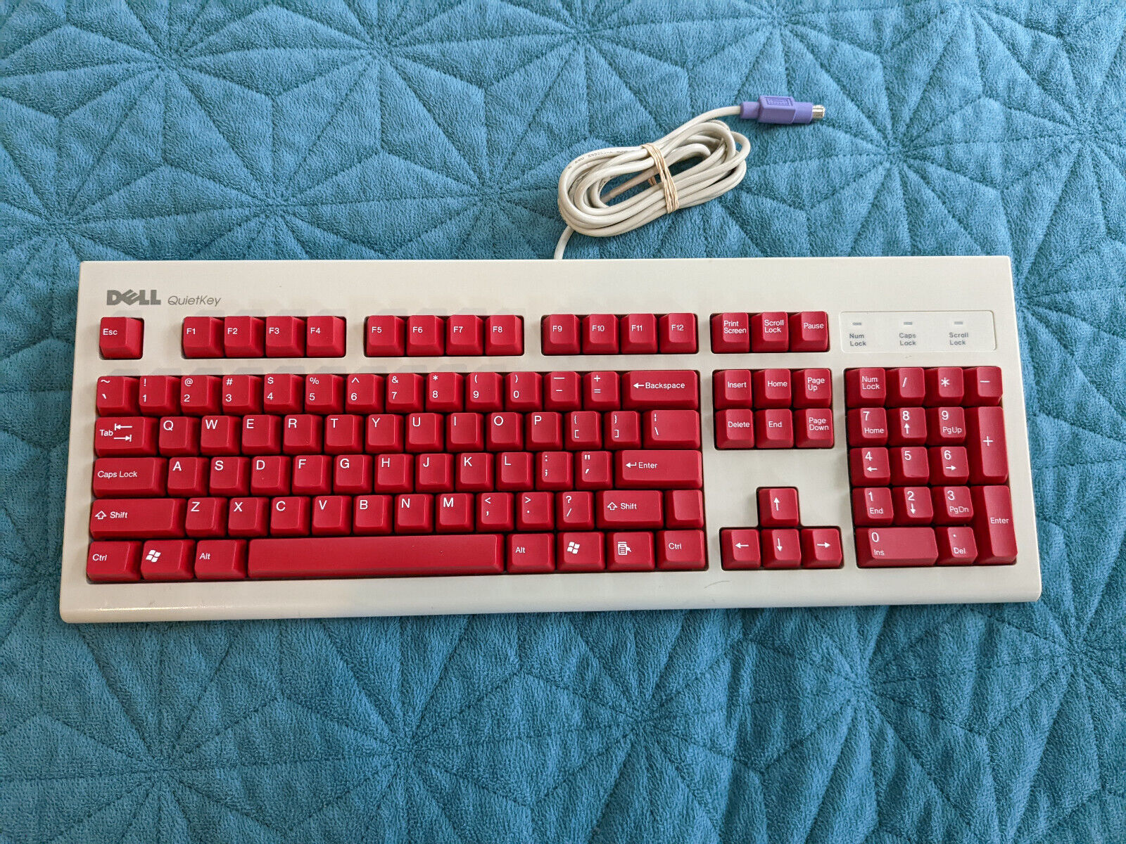

SK-8K
22 Sep 2022, 16:54

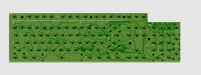

Yeah I made Rev. 2 which supports BAE and corrected some measurement errors from the first one.
Random pics of the Rev 2. boards:
