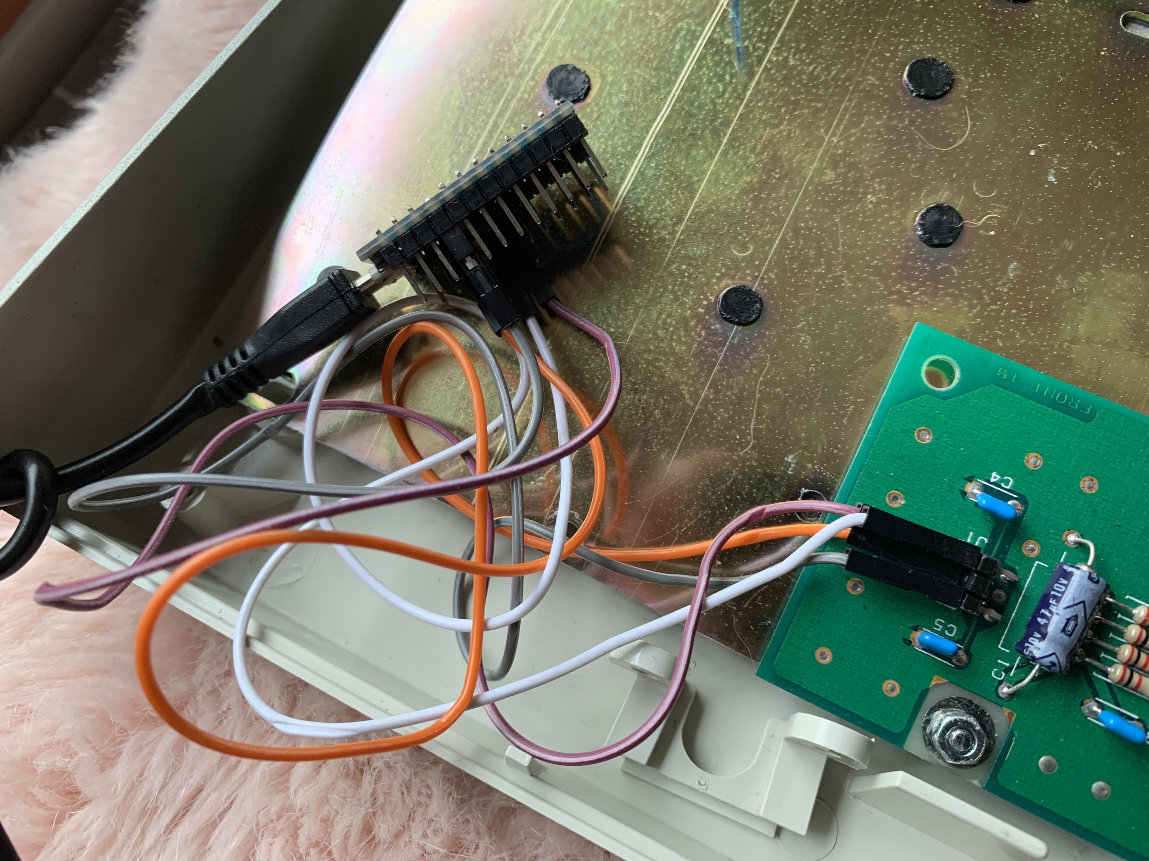

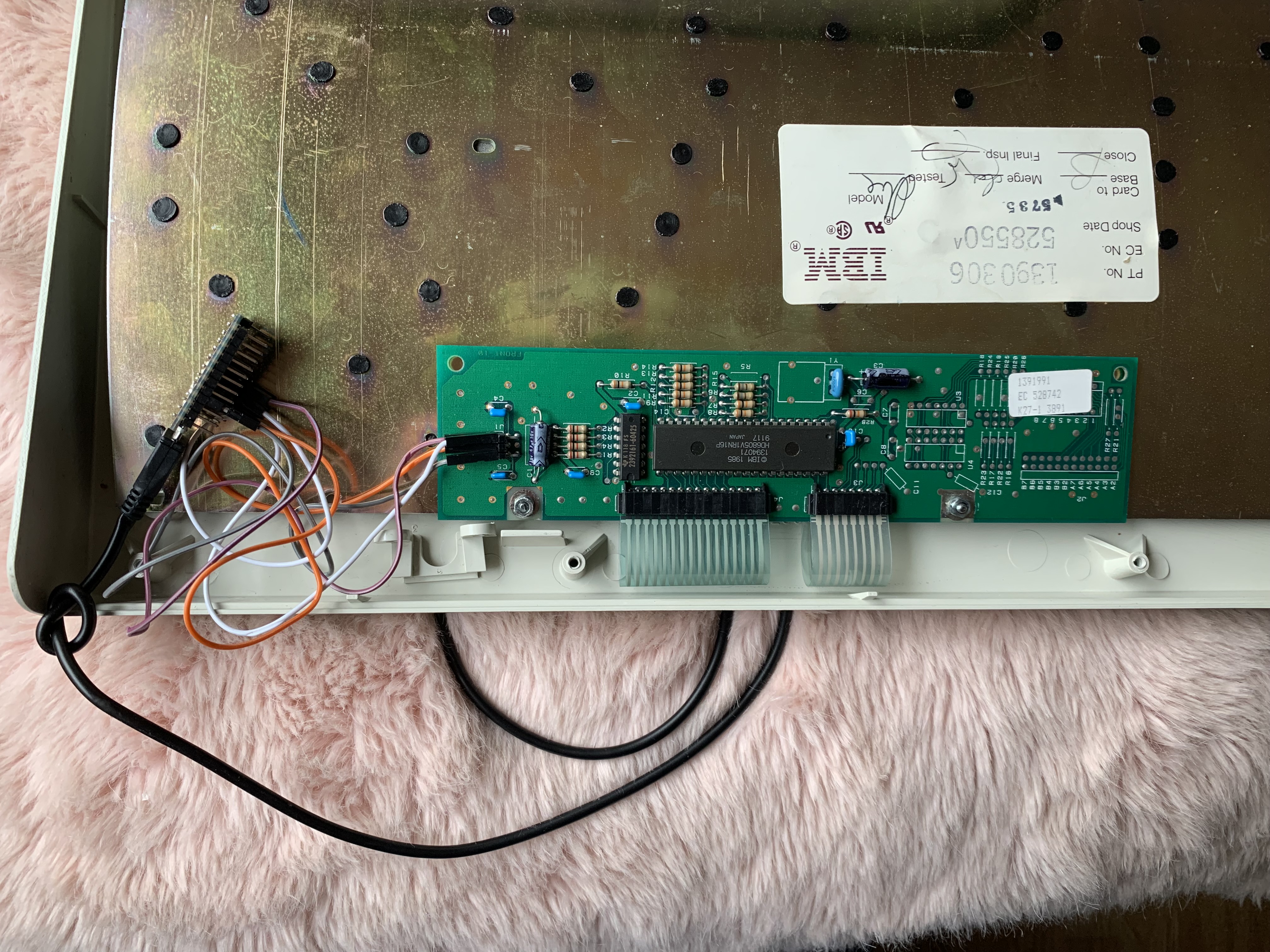

Of course, sorry I should have posted photos - I've attached them here. I don't have the original cable.fohat wrote: 31 Aug 2021, 15:18 Without a proper description of the problem and/or a picture it is very hard to make suggestions.
Specifically, what original parts, if any, were removed? We have to know the starting point to formulate a path forward.
When I opened it to see what the problem was, I saw that the pins of that little board were just sat on top of and touching the metal base so I thought that could have been the problem. But when I put the keyboard back together with insulation around the board & pins, the problem was still there. Now it's not working at all. I'm just looking for the easiest, most reliable solution.

Not going to lie, I was shitting myself thinking this thread was about the RT Model M and the janky converter I made for it. I sold it to a very friendly UK buyer (like yourself), but thankfully I'm not responsible for this!
Anyway, on a more serious note, I'm sorry to hear you're experiencing issues and I hope it will be resolved soon. Sorry I can't be of more use.

Nice backplate- shit converter. Those Dupont connectors aren't great for permanent installations, especially if cheap ones are used because they lose their grip.
If it were ME (because I like keeping keyboards as original as possible) - I would order a replacement fixed cable from Unicomp and make a new inline converter using Hasu's TMK ibmpc_usb firmware and a Pro M1cro. Since you want to have an easy solution and would pay more, you could order the cable from Unicomp and order a fully-made converter from Hasu. Then everything will be external from your board and easier to access/reprogram.

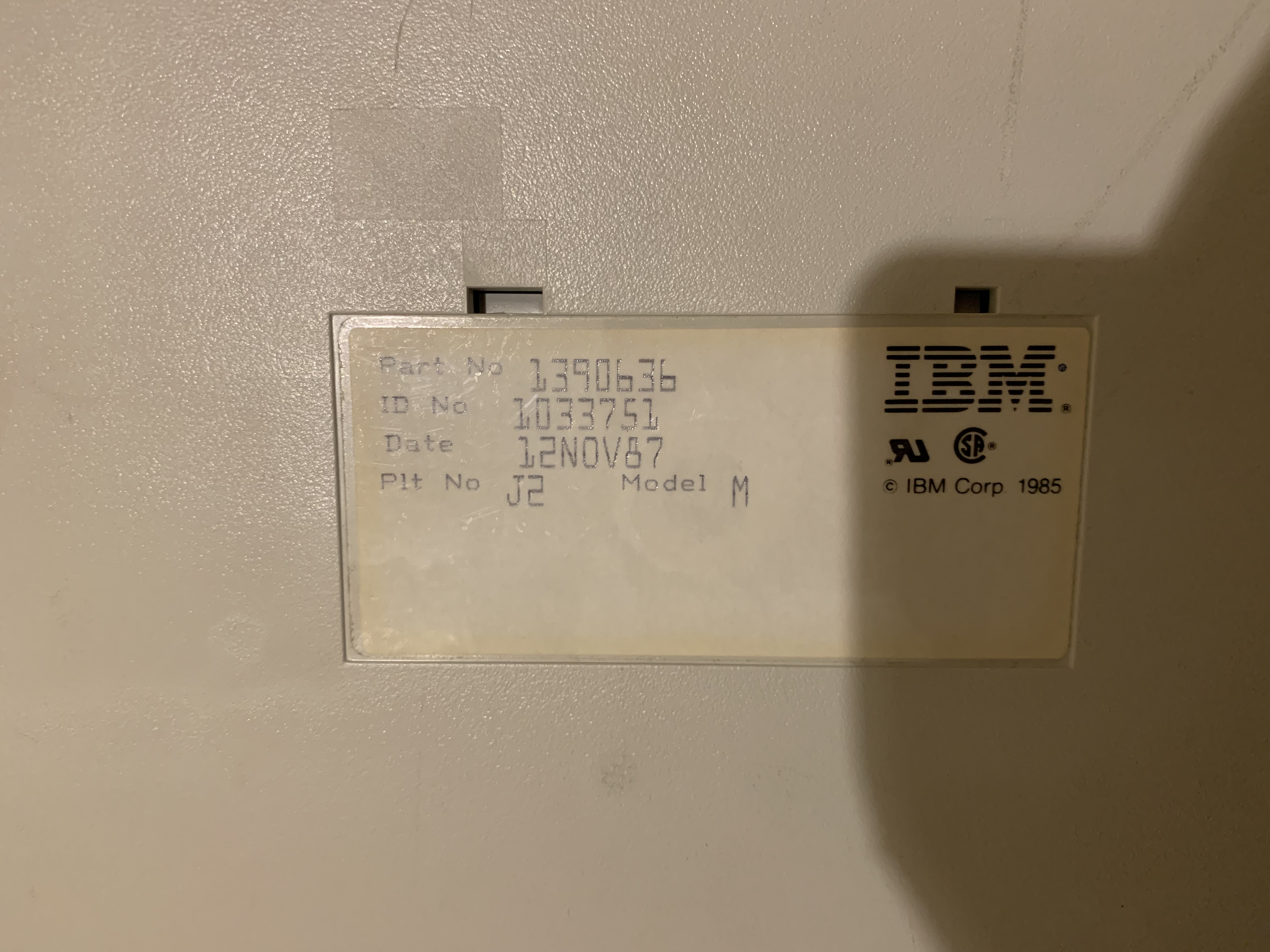

What's the model number on your case bottom? I was trying to look up which cable (5-pin DIN or PS/2) your keyboard originally came with but the number on your plate sticker isn't in the DB.
retrofitit
- Main keyboard: laptop (subject to change)
- Main mouse: MX Ergo Plus
Looked it up, that came with an 8P8C connector (many call it an RJ45 but it is not) cable.
