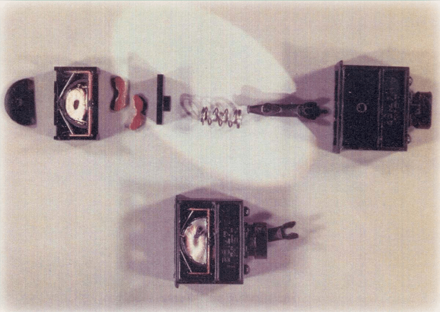

Also you might want to ensure that your machine is not bugged by the KGB.
https://qz.com/932448/forget-smart-tvs- ... pewriters/
:lol: :lol: :lol:
“When I saw those x-rays, my response was, ‘holy fuck.’ They really were bugging our equipment. I was very excited, but no one was around to tell the news. My wife was an NSA employee, but I couldn’t even tell her because of the level of classification.”
