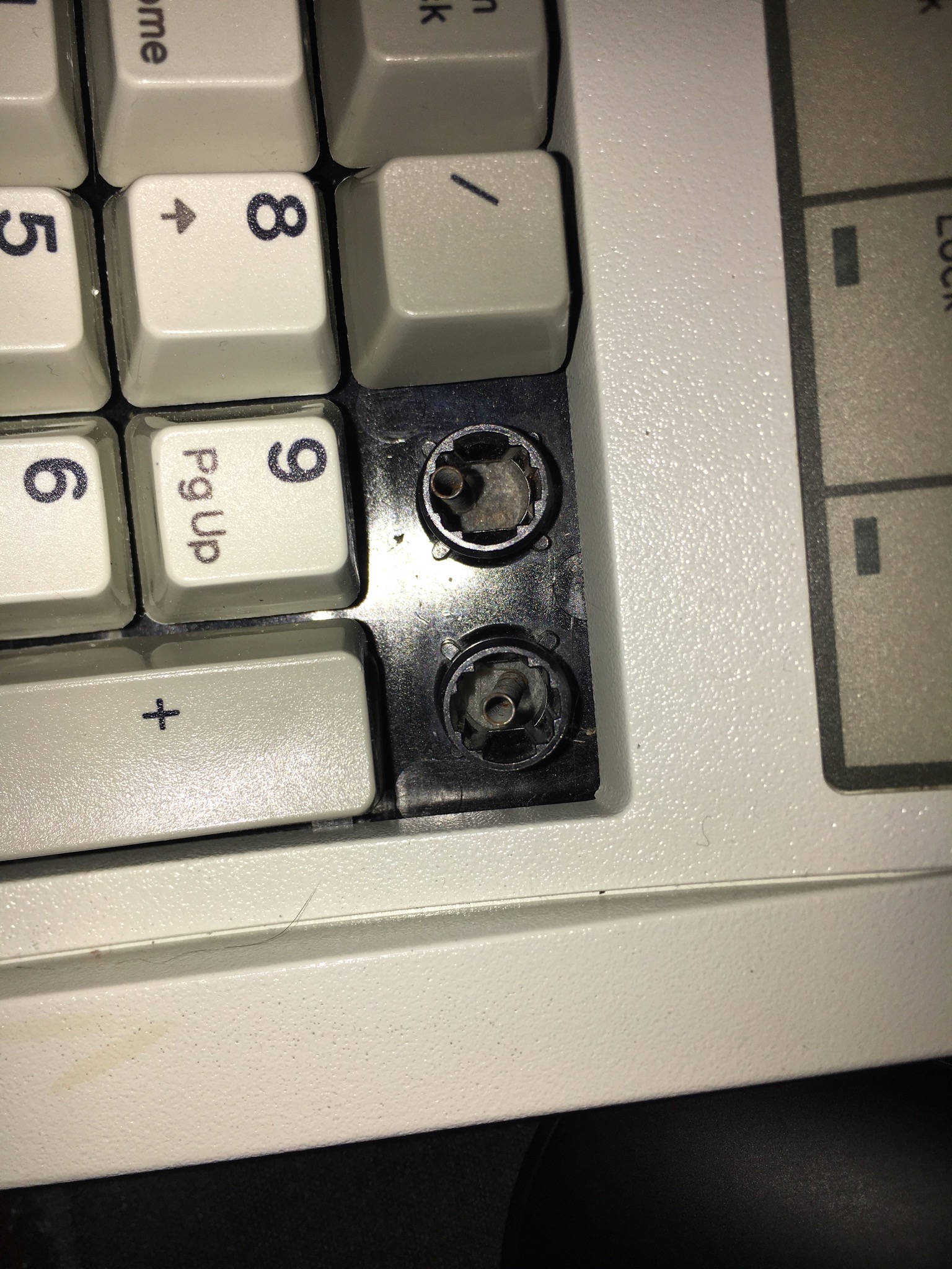

So I have a 1987 IBM Model M 1391401 that I've been using daily for over 10 years. I've always taken great care of it. It has recently developed 2 seemingly related problems on the numpad block.
The first trouble is that the minus - key often gets stuck. I checked the spring, everything seems to be in proper alignment. And the second problem which I believe is causing the first problem is that the flipper that holds the spring for the adjacent * key has somehow worked itself loose and it rattles around inside the barrel. I tried to resposition it with tweezers and then the key registers, but it ulimately gets out of alignment again causing the * key to not work and also I believe it's what causing the - key to act like it's stuck.
The keyboard has most of it's plastic rivets intact, but this issue is not only annoying but hampers the usefulness of this keyboard. Do I have to break off all the rivets and do a screw/bolt mod to fix this? I tried searching around online I've never found anyone talking about a loose flipper, could it be broken?
Photo included

Unfortunately, I don't know if there's a way to take out the flipper itself without taking apart the whole board. That being said...
ZHENYA wrote: 13 Sep 2021, 21:49 I tried to resposition it with tweezers and then the key registers, but it ulimately gets out of alignment
I'm wondering if you could realign it, then do a "Partial Screw-mod" where you can restore the tension without taking the whole board apart. I have a guide with pictures here. The Partial Screw-mod part is right at the end!

I had a Model F with a similar problem. This guy was the culprit:
Perhaps your M's flipper is broken in the same way?
Because mine was an F, all I had to do was tweeze open the tabs and go take a look. A Model M makes such repairs a hell of a lot more involved. Bitteneite's tip might be worth a shot. But if your flipper is snapped like mine was, then it will need replaced, and that means a full bolt mod.
Bolt mods are a lot of bother, I won't deny that! But they're not impossible or the realm of experts. Even I pulled one off! Plenty of folk swear by them as an essential long term maintenance technique for all Model Ms. I'm in no hurry to embark upon a second, however… :roll:

Muirium wrote: 18 Sep 2021, 11:37 Bolt mods are a lot of bother, I won't deny that! But they're not impossible or the realm of experts. Even I pulled one off! Plenty of folk swear by them as an essential long term maintenance technique for all Model Ms. I'm in no hurry to embark upon a second, however… :roll:
I'd agree with that. If it's the flipper that's broken, a full rebuild is probably the only way.
That being said, as long as OP has the right basic tools, it should be a walk in the park!
If OP wants to do it just once and forget about it, I'd actually suggest a screw-mod. It's much easier and faster. (Especially for beginners)
And as long as OP doesn't go crazy on the screw tension, the plastic threads should hold up surprisingly well!

To the OP, I've had this same issue with the R key on a model M and it resolved itself upon reassembly. The flipper wasn't broken, so I assume it became crooked or misaligned somehow.
