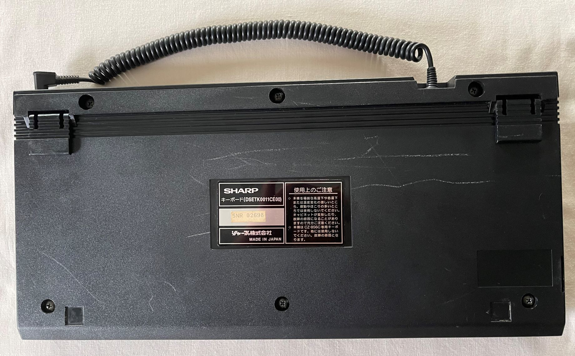

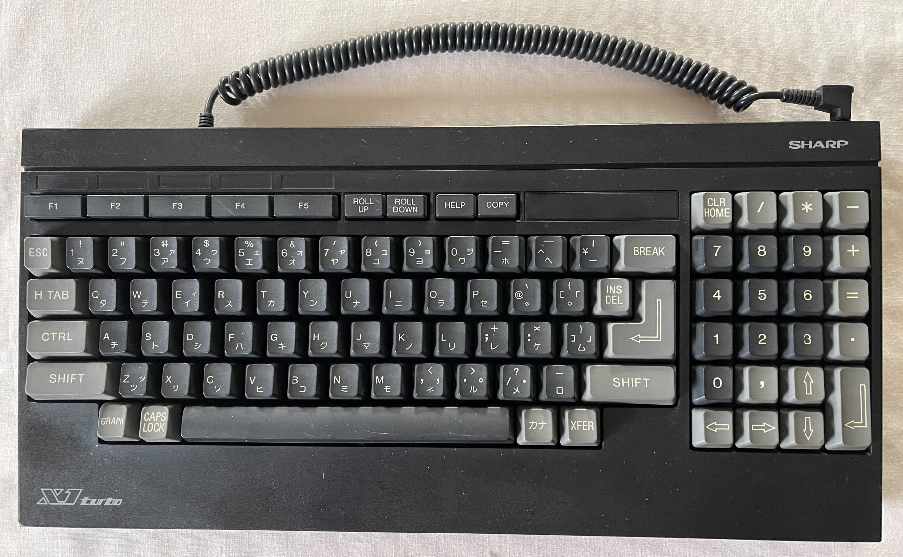

This keyboard is for a Sharp X1 Turbo.
This particular model, DSETK0011CE00, has green Alps, so it is nice enough to type on, but thankfully not yet a target for those harvesting switches. The lock keys are physically locking; there are no indicators.
The cable terminates in a 3.5mm audio plug. There is a clever hole in the back of the case for holding this when not plugged into the computer, so that it doesn't just flop around.

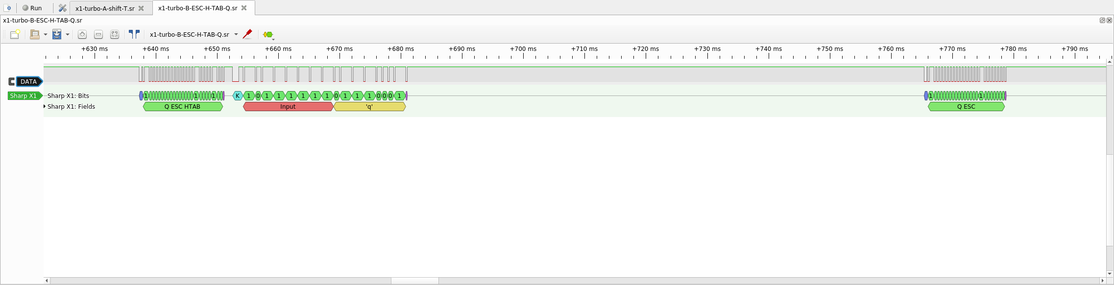

Additionally, the keyboard has a slider switch on the side labelled A - B. When in B mode, which was designed for games, the keyboard sends an additional report on the exact state of 24 of the keys (Q W E A D Z X C 7 4 1 8 2 9 6 3 ESC 1 - + * HTAB SP RET) as a bitmask.

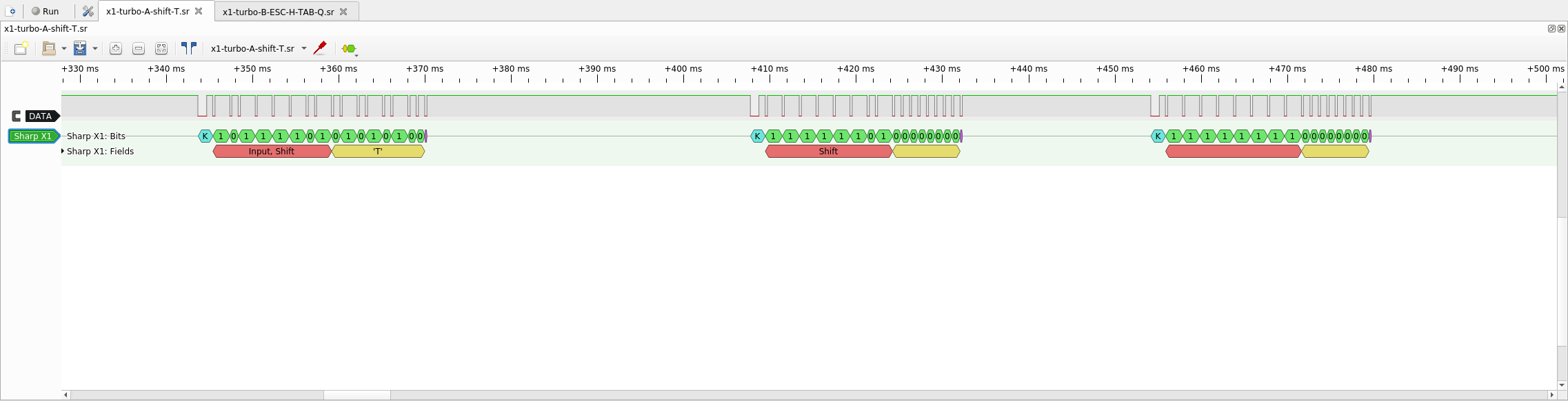

Here are normal key reports:
Here are game mode reports interleaved with them:

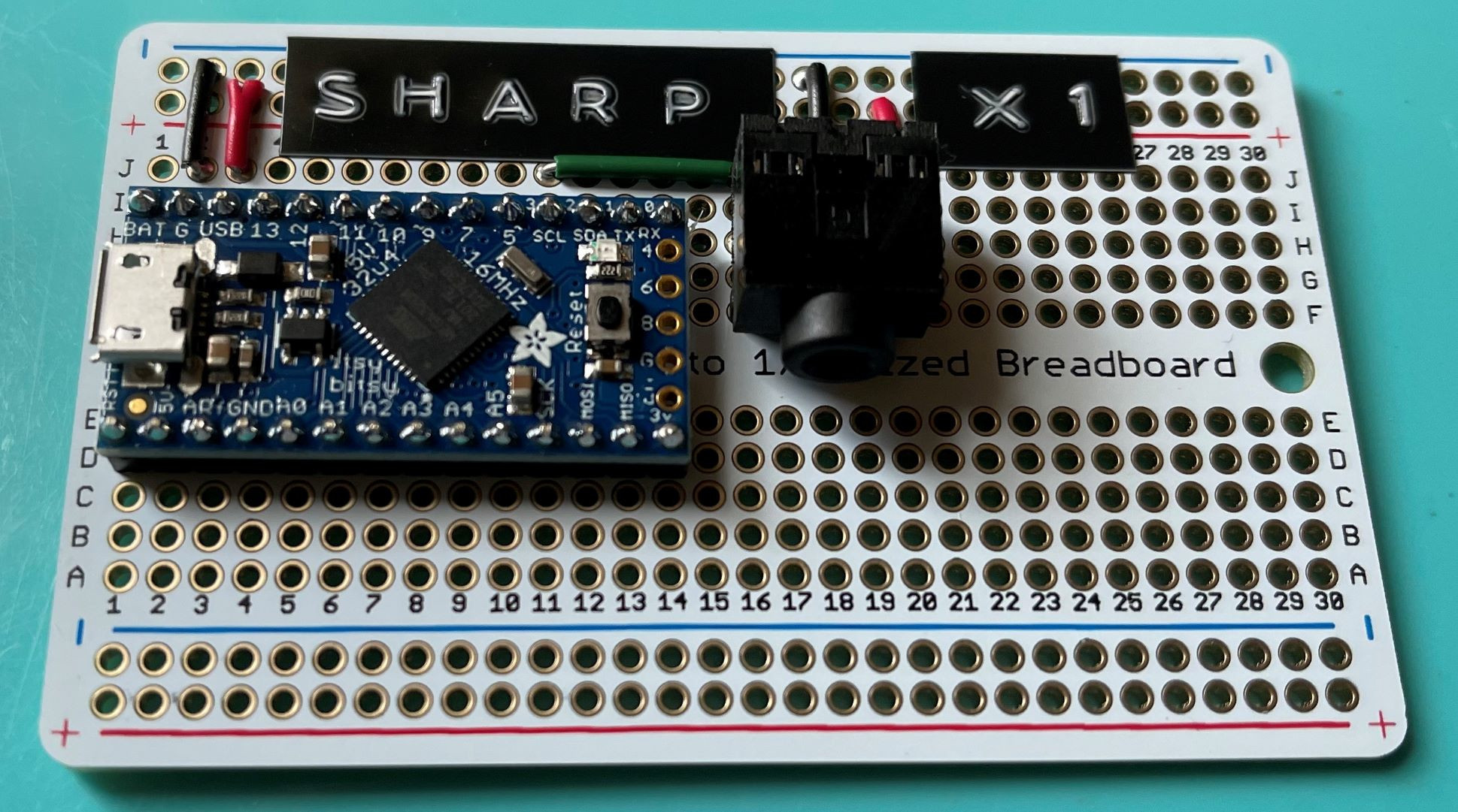

This is enough to build a converter implementing a USB keyboard.
The non-trivial part of the conversion is inferring the key that was pressed from the ASCII code in the key event.
  • The character set is normally JIS X 0201.
  • 7-bit characters are ASCII, except ¥ for \ and ‾ for ~.
  • The number pad keys proper send the same characters as the number row, but with a "ten-key" bit to distinguish.
  • The F keys are ten-key versions of some top-row letters, with F6-F10 being SHIFT F1-F5.
  • The arrow keys are ten-key characters in the ASCII control character range.
  • Other command keys like HELP and COPY have the eighth bit set.
  • In B mode, the kana codes are shuffled around in a way that I do not recognize. For example, the L リ key sends D2 and not D8. Perhaps this is for compatibility with the encoding of some other system.
  • Keys like INS DEL and CLR HOME, which have two legends, send different ten-key control characters when SHIFT is pressed.
  • BREAK and SHIFT BREAK are also distinguished (SHIFT BREAK is ten-key CTRL-C).
  • The GRAPH key with normal keys sends characters with the eighth bit set, but in the unused part of the JIS codepage. Presumably these were suitable drawing shapes in the default font, as in most early PCs.
