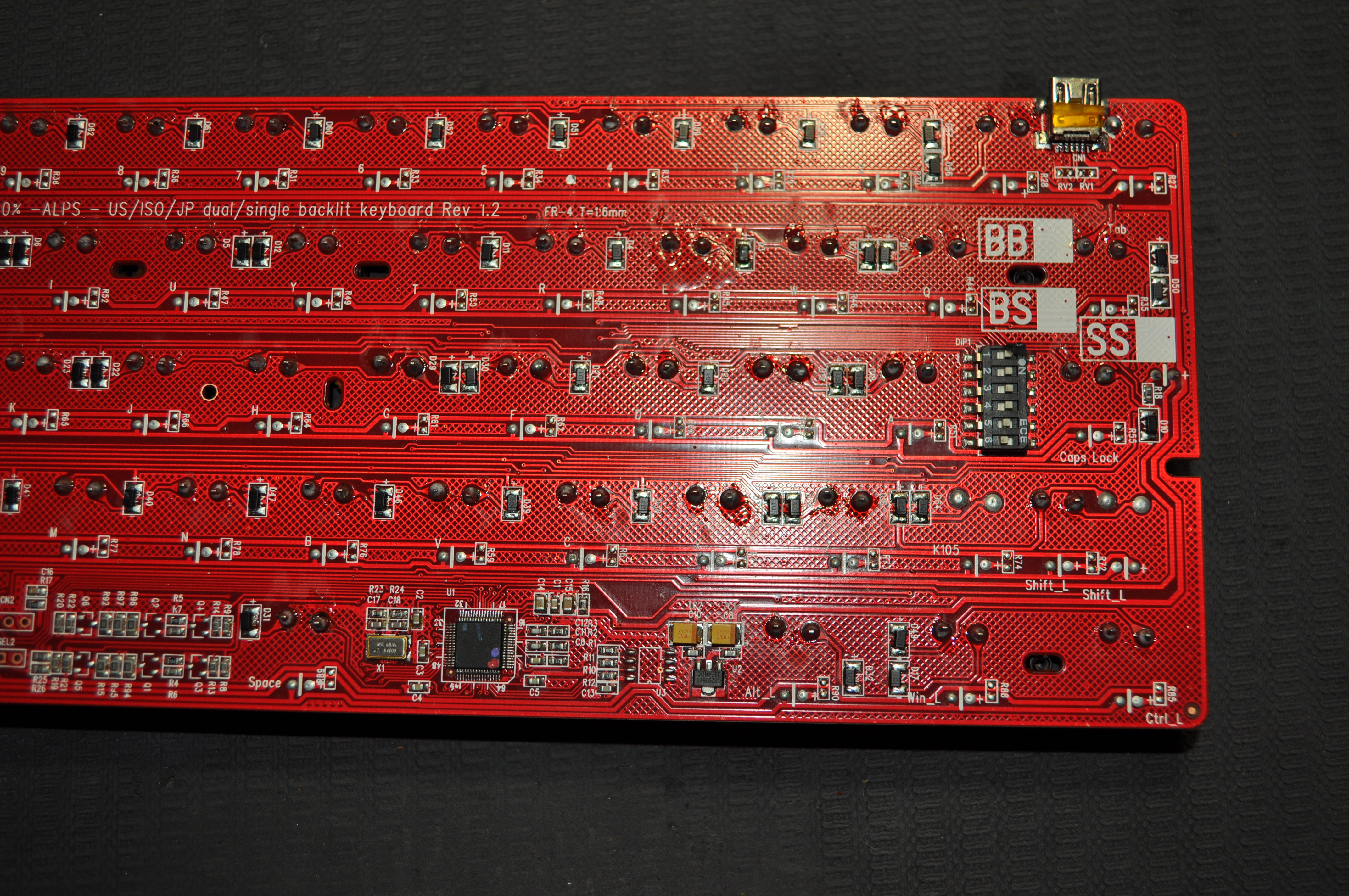

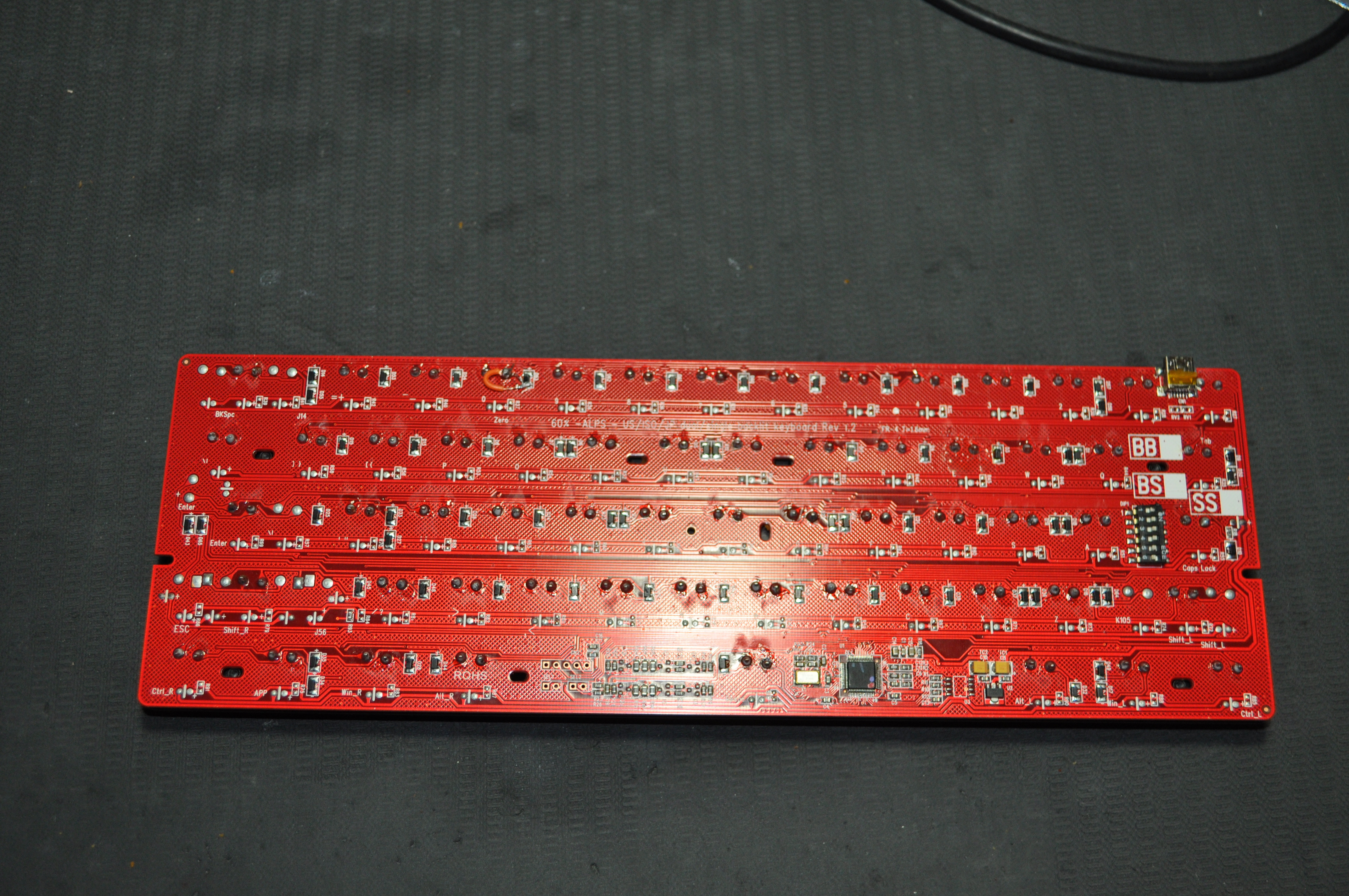

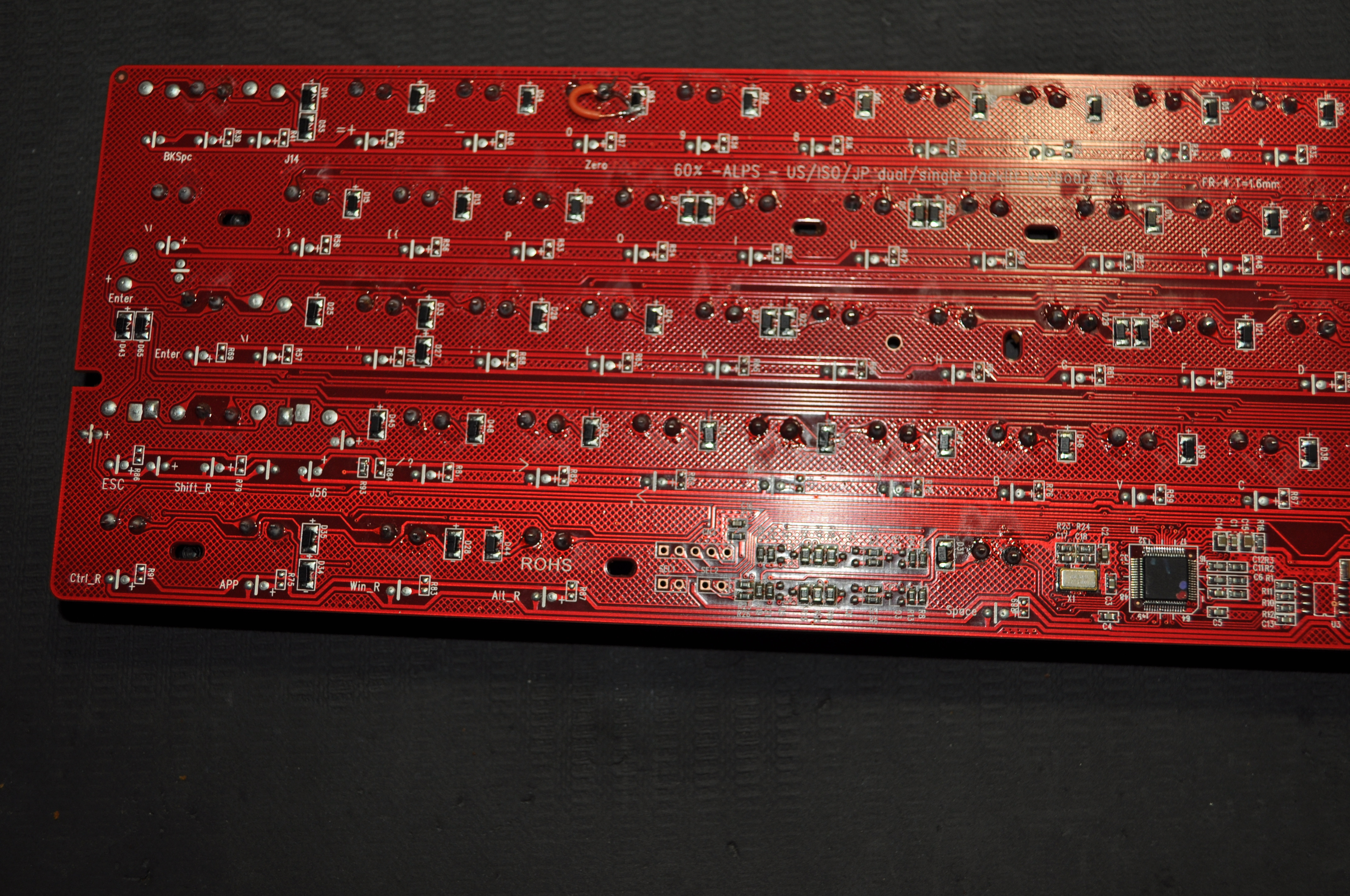

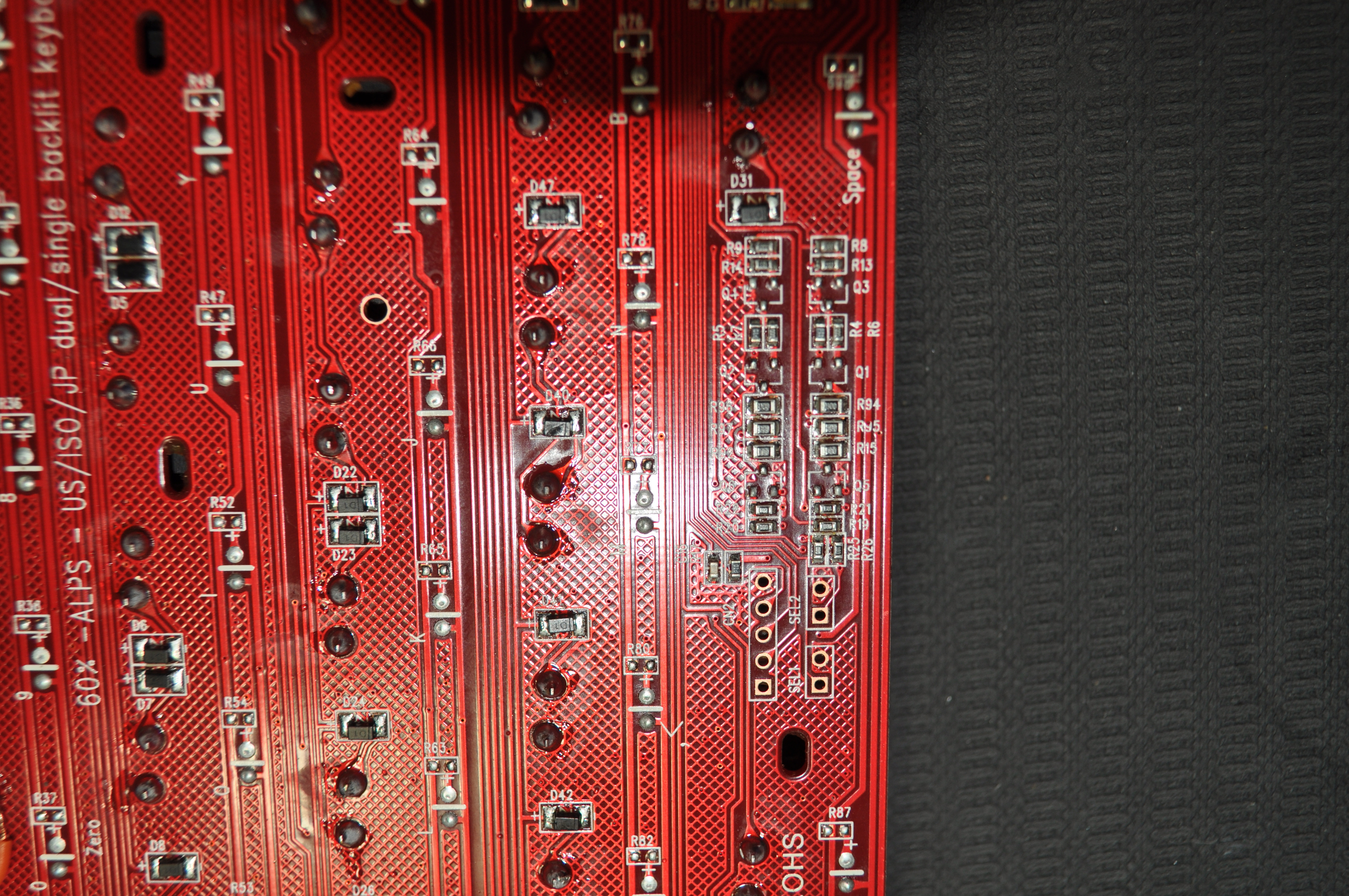

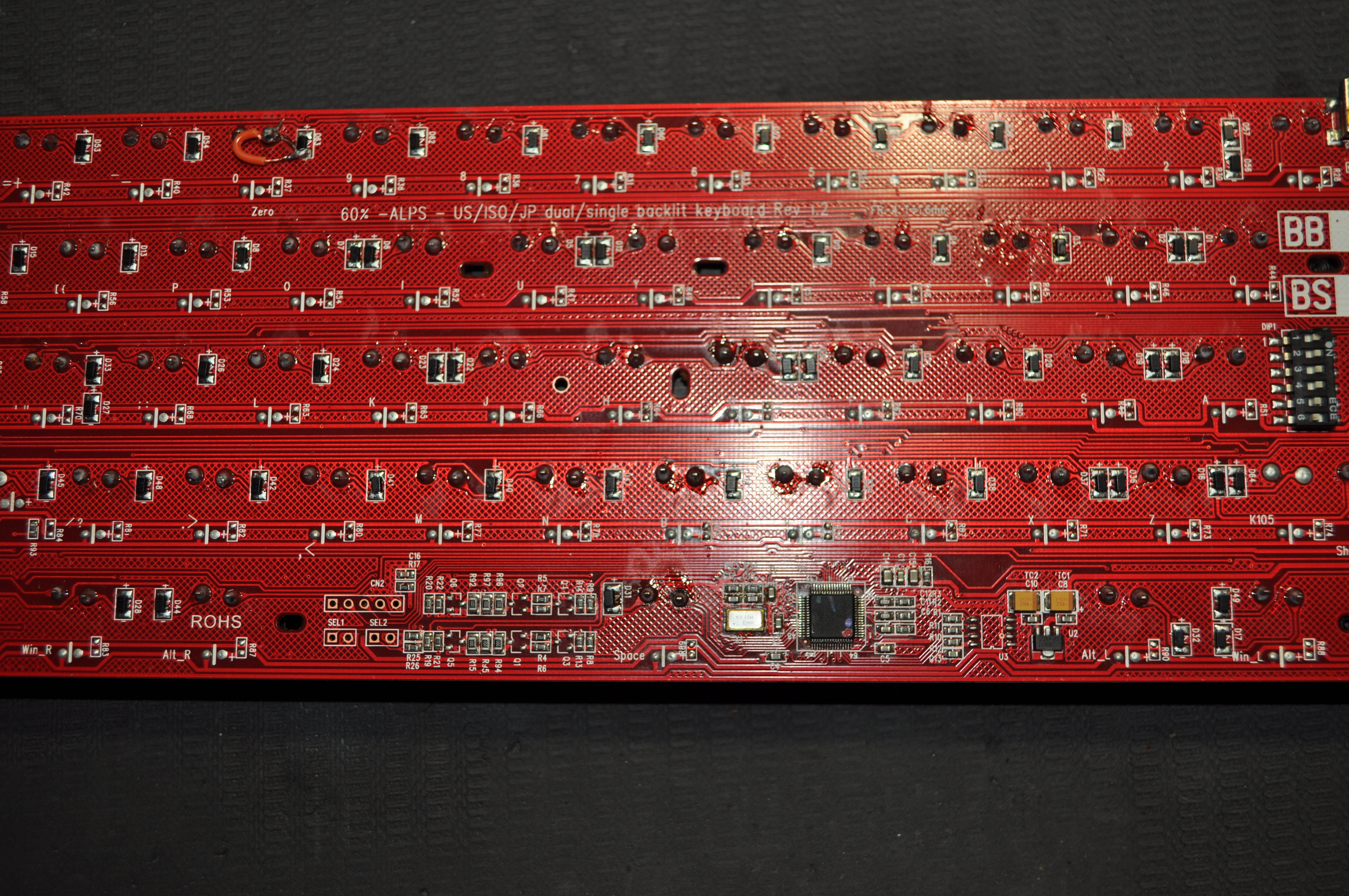

Yes. Send gory pics of your PCB! A good overall plan shot should let us see.
hellothere
24 Jan 2022, 16:32
Just adjusted for file size. They're big pics.
* That grey work mat is anti-static. I also haven't fried a circuit board with static electricity since the 1990s.

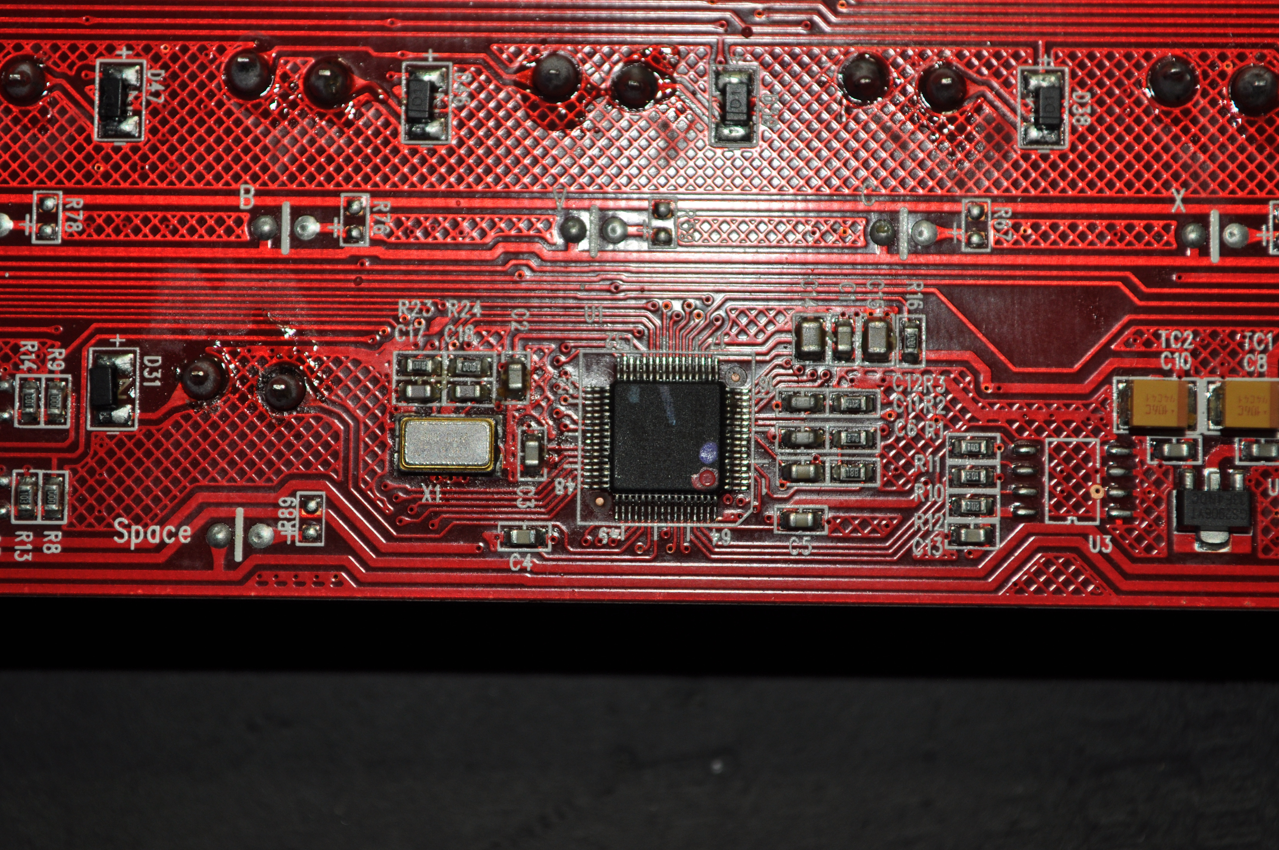

* That microcontroller looks bad, but I didn't do any work even close to it.
* It's not clean.

Dipswitch #5 and maybe #6 look to be somewhere between off and on, just for grins you might try playing with those a bit.
24 Jan 2022, 17:40
Seconded. They might be all that’s wrong.

Hard to tell from the photos but it looks like there's a good amount of flux and glitter around the controller area. It's almost like it was shoddily reflowed. Might be worth taking a heat gun to it to make sure all the joints are sound. Also, definitely give it a scrub with a toothbrush and some iso in case something's shorting out.

Says to me your attention should turn to the intimidating black box that is the controller. This board was working fine before you worked on it, right?

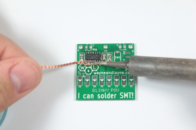

My bet's still on dodgy controller connections. You can try the lazy wick technique on it maybe:
Basically add a caterpillar of solder across all the legs and make sure it's well tinned. Then use some solder wick to remove the excess.
Also might be worth checking the diodes for the switches. The solder joints in general look pretty sad on that board.

jsheradin wrote: 29 Jan 2022, 20:50 My bet's still on dodgy controller connections. You can try the lazy wick technique on it maybe:
Got another pic? I'm a little confused on the instruction. Also remember that the controller is a microcontroller. I wouldn't be terribly surprised if it was the same chip used in a Teensy. I posted a big pic earlier in the thread.
While I'm definitely not a fan of the appx. 3mm long diodes, I was able to test them for continuity and that's OK. I briefly Googled and I saw some info on how to test a diode using the "diode test mode" on a multimeter. I'll look into it.

Once you're done watching the modified Bond film, try following the traces from one of the switches that doesn't work back to the controller with an ohmmeter. I bet you'll find a break somewhere along the way. The ohmmeter is your friend, trust me on this!
