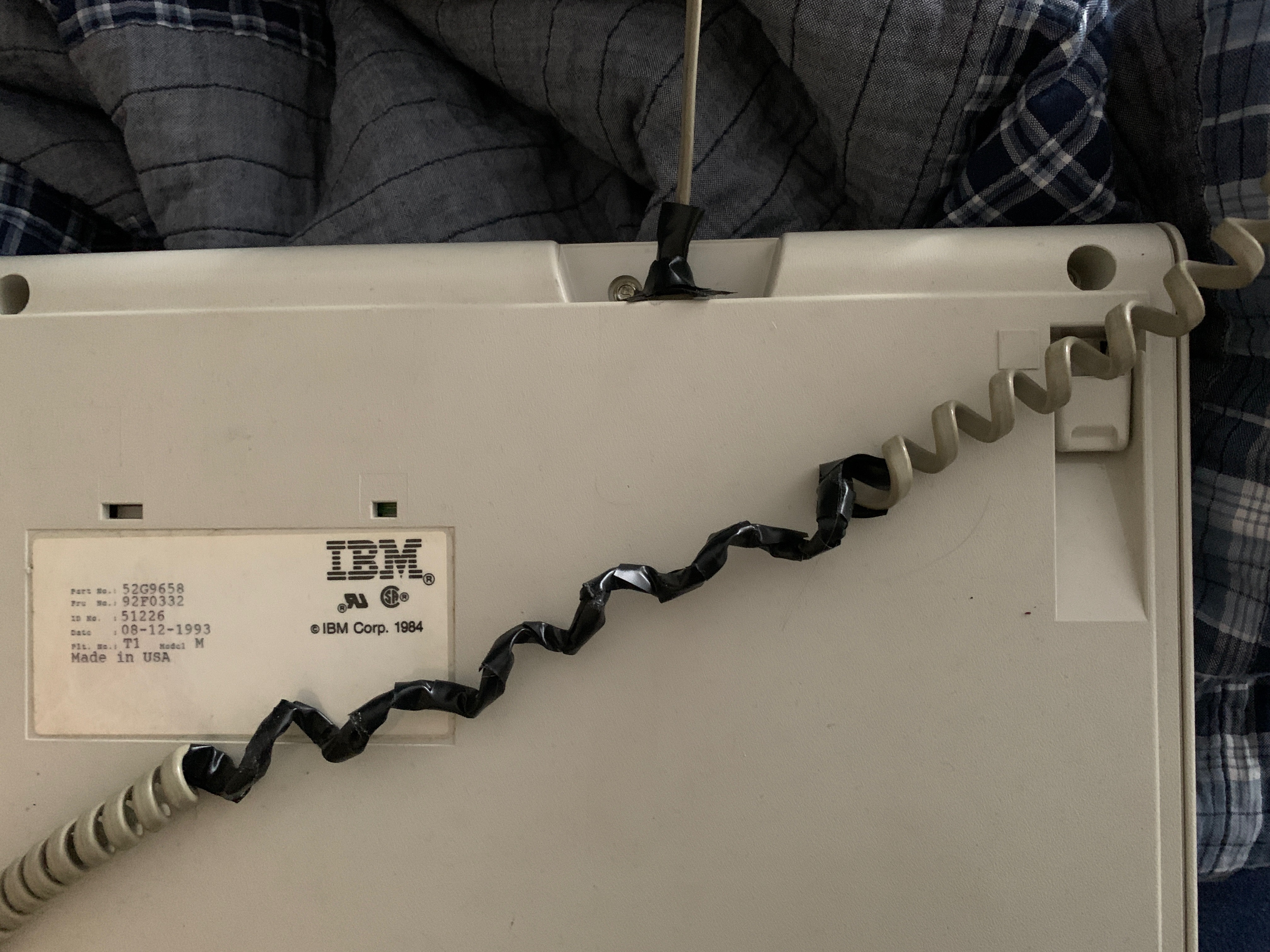

Hi, recently I came across an IBM model M for free, from my town's E-Waste centre, dated 8 December 1993. The case and keys are in great condition with only some dust, crumbs, and scratches. The cable is an absolute disaster though, being as brittle as homemade cast-iron and tan in colour, and a large section broke off like glass as the cable bent. I searched on E-Bay for a replacement cable, with no success. Does anyone here know where I can buy a new cable?

25 Jan 2022, 15:58
You're in America, so it's easy. Here:
https://www.pckeyboard.com/page/category/Cables
Unicomp's even have IBM logos on them. Sure did when I bought some, years ago.

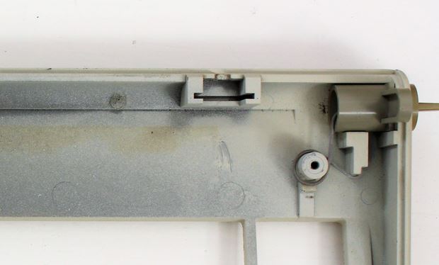

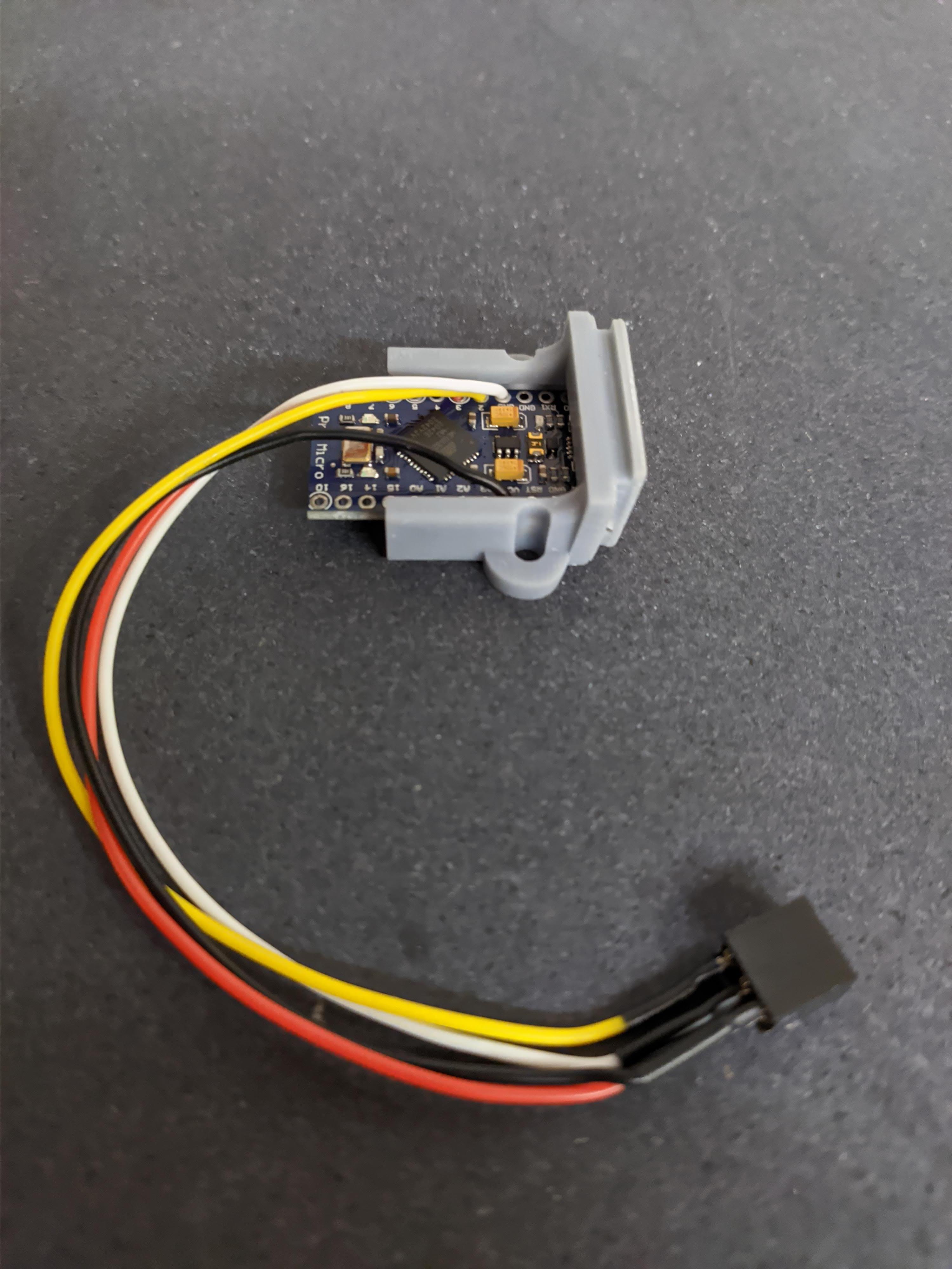

Another option might be removing the cable altogether and doing an internal USB converter.
Here's some CAD files if you have a 3D printer.

Muirium wrote: 25 Jan 2022, 16:07 Ooh, that's sneaky! Could you do something like that (with an internal Soarer converter) for the XT?
The M lets you butt the controller right up to the outside of the case since the slot is nice and large. I'll need to crack open my XT to be sure but I don't think there's a hole big enough even if you use a USB extension cable.

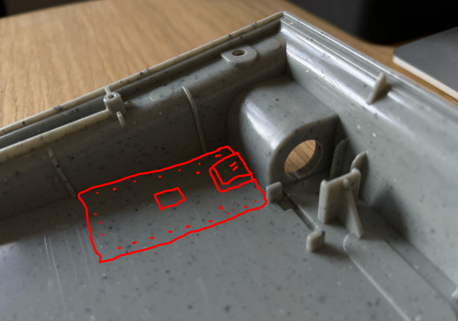

25 Jan 2022, 17:10
Hmm… maybe a 3D printed port holder would be the most elegant solution to my SGI conundrum.
Wanting to avoid hacking up a cable, it looks like I’m out of luck with the original ports. Don’t mind swapping the left one for a mini USB socket I have spare, but mounting the thing well enough for realistic physical use is the hard part. Your technique could be just the trick I need.

I used an internal converter on my XT, but had to use a small extension cable. The case opening is not big enough for a female usb-c port, but I widened it a bit with the use of a file.

Muirium wrote: 25 Jan 2022, 17:10 Hmm… maybe a 3D printed port holder would be the most elegant solution to my SGI conundrum.
Those plastic supports will probably get in the way unless you can find something like this which is shallow enough. A 3D printed holder would be pretty easy to whip up.
You could always just trim them out and double sided tape something like this:
There might also be a good spot to file out a rear exit depending on your devotion to purity:
