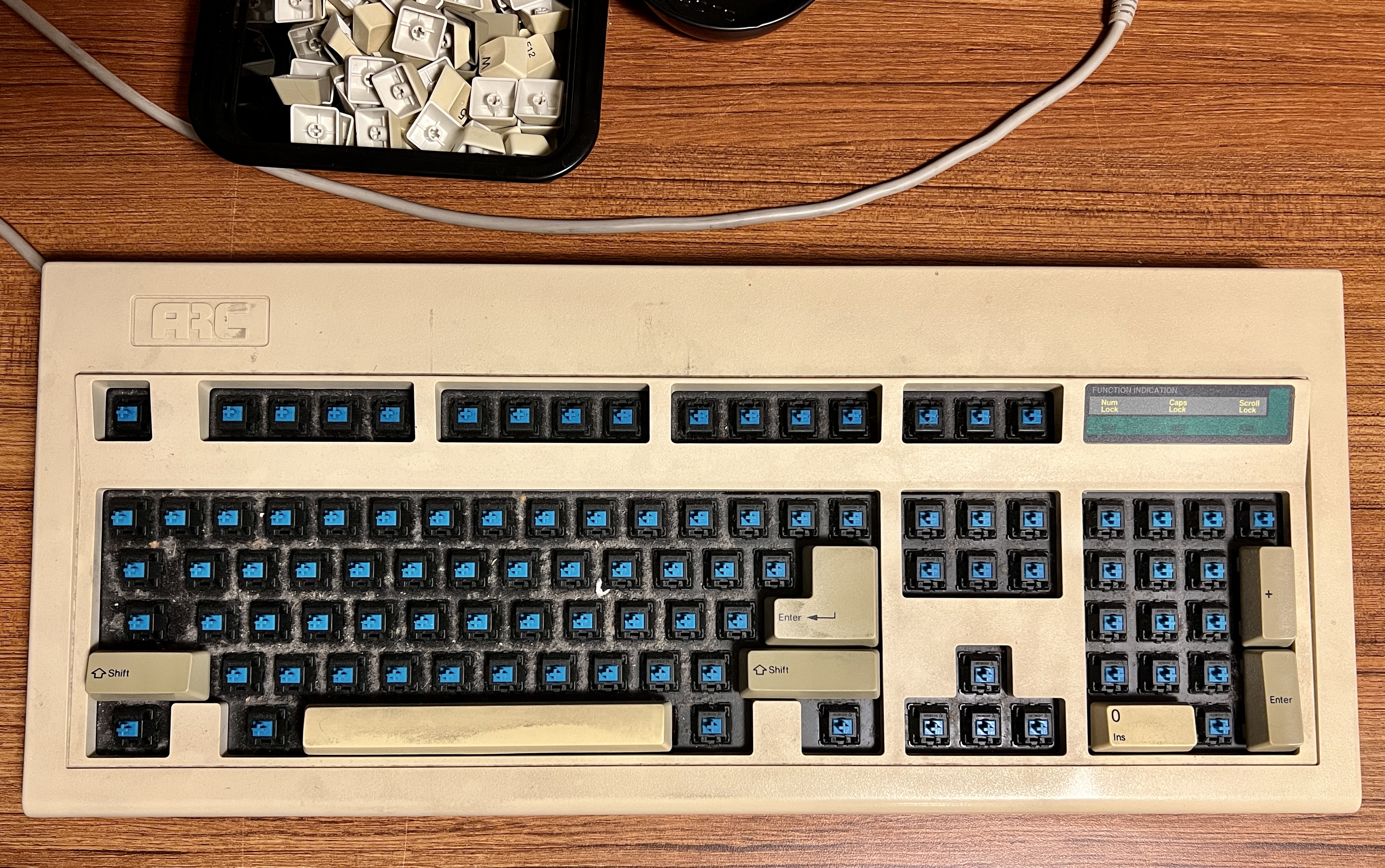

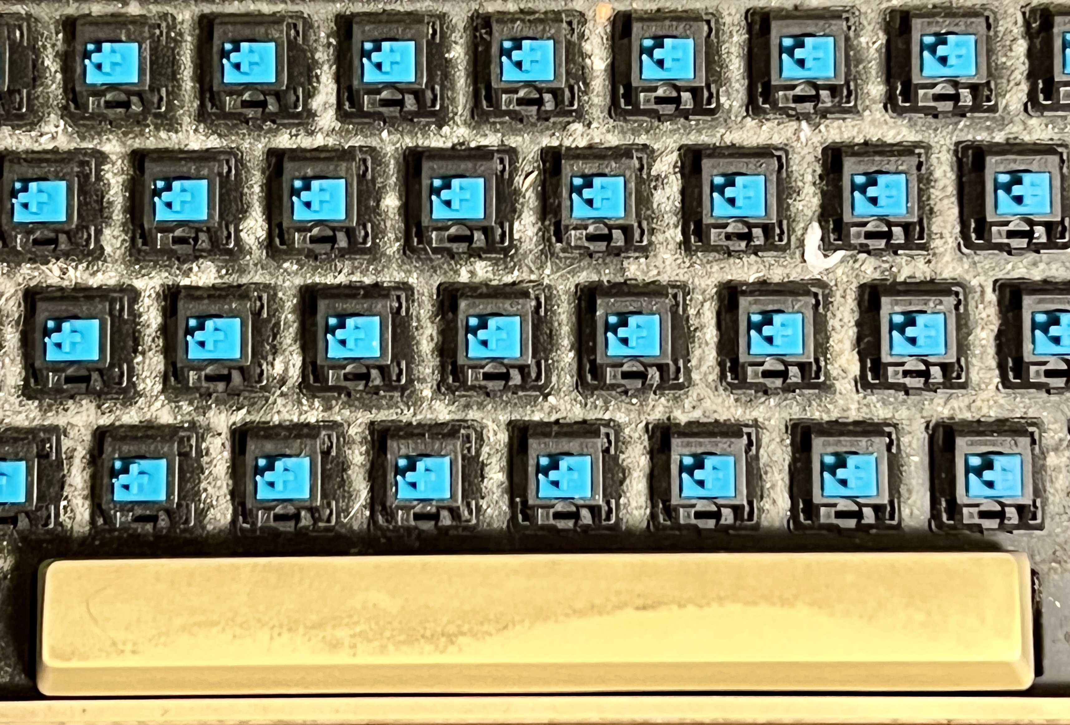

I saved a Chicony 5181 from the trash that has Cherry MX blues. I’m disassembling the board to clean and retrobright and wanted to ask if there’s anything that is typically done to Cherry switches.
They switches seem fine. They feel tactile and click although the sound has a rattle and higher pitch than I’m used to in my alps and IBM boards.
My plan was to gently wipe the dust and dirt off the switch plate with alcohol and a small sponge. My philosophy is to leave switches alone if they don’t have a problem, but if there’s anything that’s typically done during a cleaning/restoration I’d appreciate any advice.
Board with most keys removed:
Closeup of the switches:

If they still click and feel smooth you should be fine to leave them as is. If possible I always give stuff a soapy water soak and ultrasonic clean for peace of mind that dust isn't wearing them out.
With MX blues specifically, I've come across a few very worn boards that lost their click. The internal mechanism is totally free but the bump on the slider has simply worn down to the point that they're nearly linear. I don't think there's any way to bring the click back once they reach that point.

thefarside wrote: 01 Mar 2022, 12:31 They switches seem fine. They feel tactile and click although the sound has a rattle and higher pitch than I’m used to in my alps and IBM boards.
Maybe try adding some lube to the switches as suggested by photekq.
photekq wrote: 05 Feb 2022, 01:57 2) Vintage MX blues lubricated with a very minute amount of GPL 103 on the legs. Really, I'm not joking. It makes the click much more low pitched and makes the tactility incredibly pleasant for use.

You're looking for something really low viscosity. GPL 103 is an oil (!)
Nyogel 767A is at the opposite end of the spectrum, essentially.

Bjerrk wrote: 02 Mar 2022, 07:14 You're looking for something really low viscosity. GPL 103 is an oil (!)
Yup. You don't want to slow down the mechanism, or you'll end up with MX Whites instead of blues. Not to mention Cherries are a pain in the arrrs to fix. The contacts are sensitive, if you bend them in any way, it'll interfere with the tactility. Lubed it in the wrong way? already said what'd happen. Not to mention you'll have to desolder _everything_

thefarside wrote: 02 Mar 2022, 04:18 Thanks I might give that a shot. I don’t have GPL 103 but I have Nyogel 767A and 760A and Max-Pro lubricant. I’ll see how they compare.
Don't!
GPL 103 only. Even GPL 105 is too thick for MX blues, I think. It absolutely has to be a thin oil, I wouldn't recommend you even search for alternatives.

photekq wrote: 02 Mar 2022, 18:12
Don't!
Thanks I won’t try anything else. I might just clean the board and try it with the switches as is and see how I like it.
