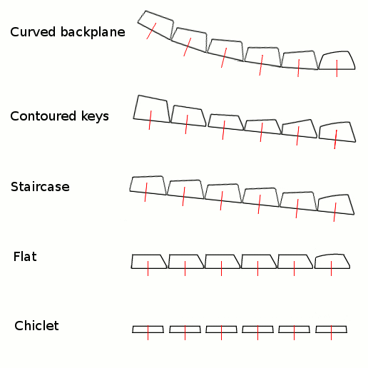

The thing to bear in mind is that in buckling spring, the cap is itself a moving component of the switch. You aren’t just adding something on top of the mechanism. You are adding an integral part of the mechanism. So the plastic will really matter.
Also bear in mind that two-piece caps will need to be far too thin for double shot.

For mixing with existing caps, you'd need to match that paper-thin top profile.
For more costly complete replacement keysets, sure, you've more room to manoeuvre. You're still dealing with a curved backplate, though, which puts the squeeze on taller caps.
Flat backplate Cherry can take extra tall caps like SA and Matteo's beamspring homage profile. Buckling spring's curve does not support unlimited extension like that. Though we have a far easier time with language kits due to all rows being interchangeable at least!
