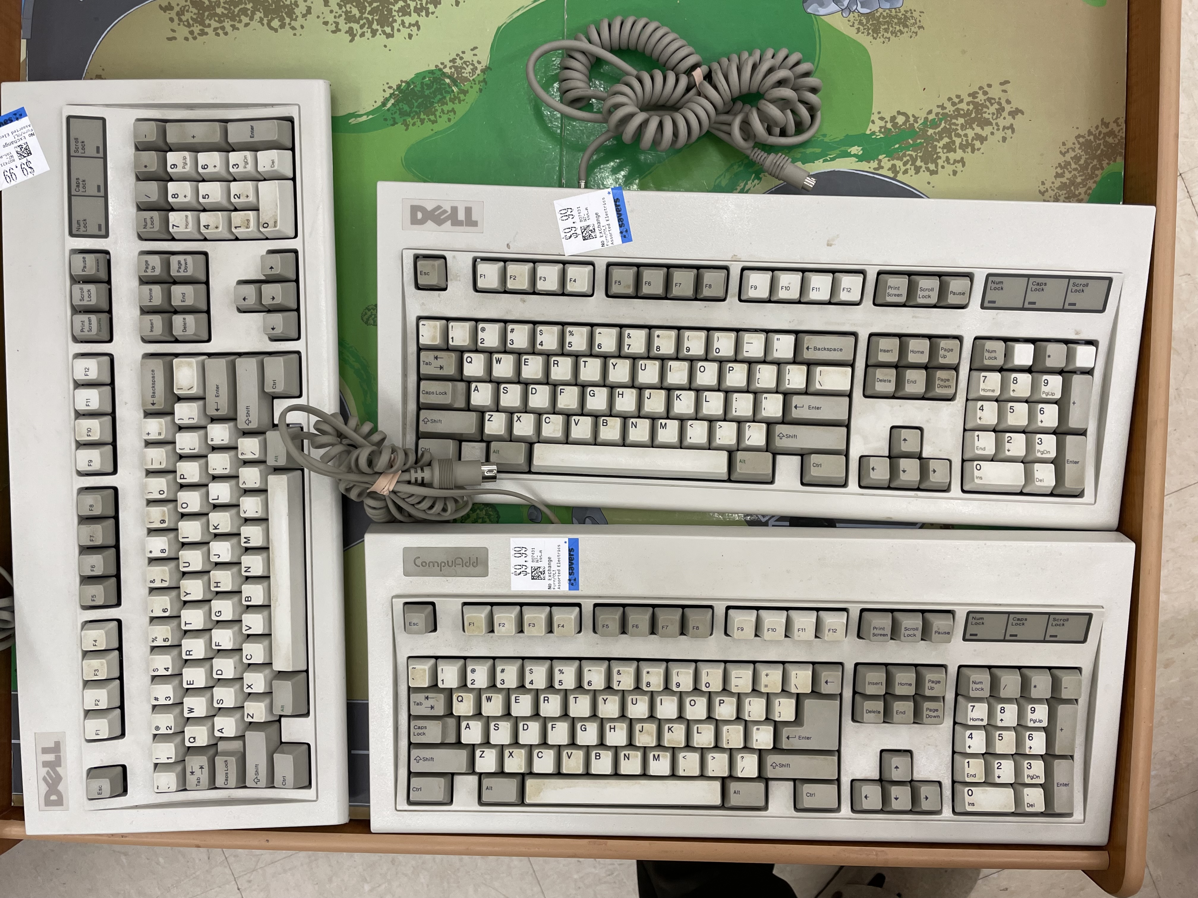

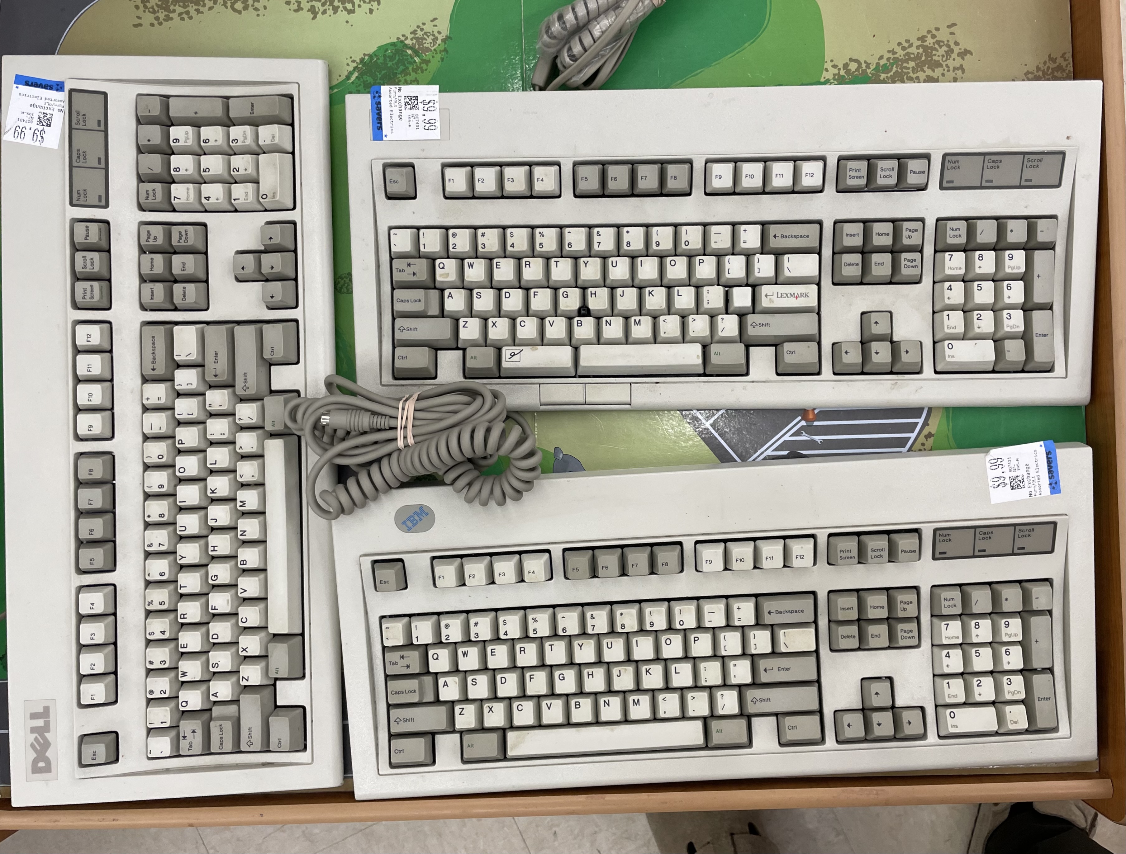

Pics of the total haul:

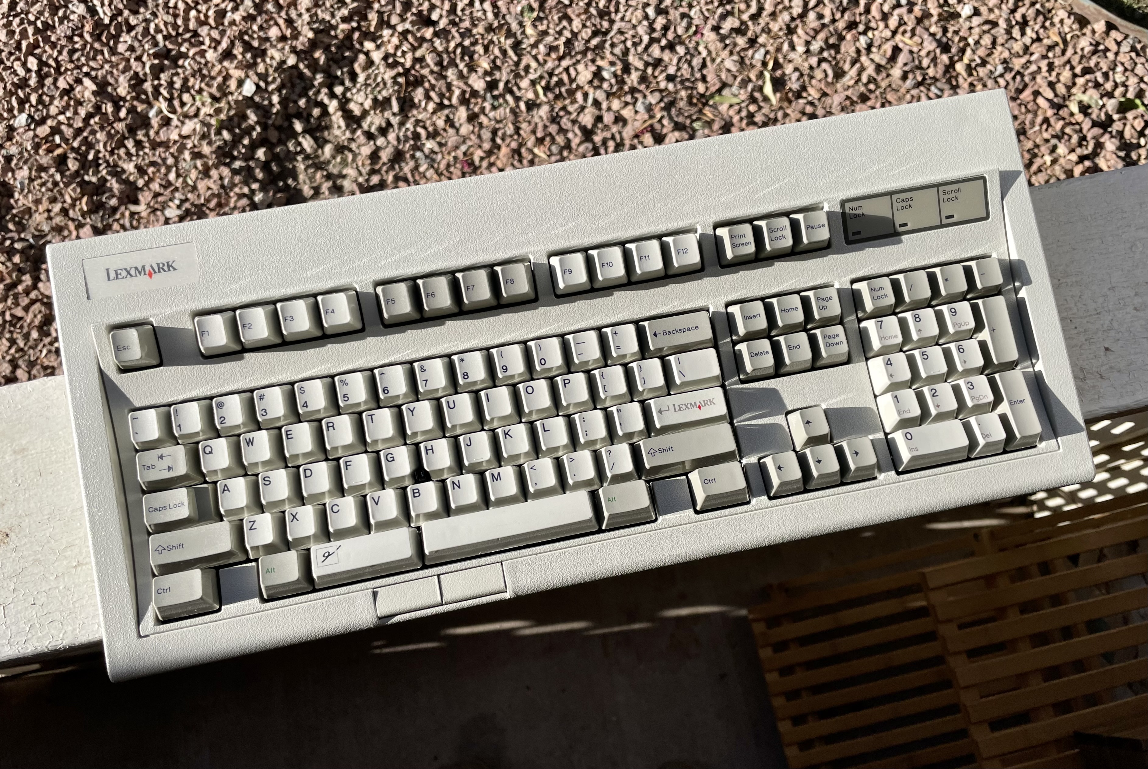

Here's a pic of the M13 after a nice little cleaning

That's not just a trackpoint M but an Erase-Eaze, well worth the $9.99!
I think the whole trackpoint module is on its own ribbon cable going into the controller board. I'd say give it a good wiggle and double check that your converter is compatible with mice.

Congratulations on the haul!
Woah, a "CompuAdd" branded computer. It's the... second one I've seen so far during these years.
Can we ask you to take pictures of each keyboards on its back side, too? (mostly to document the part numbers)
