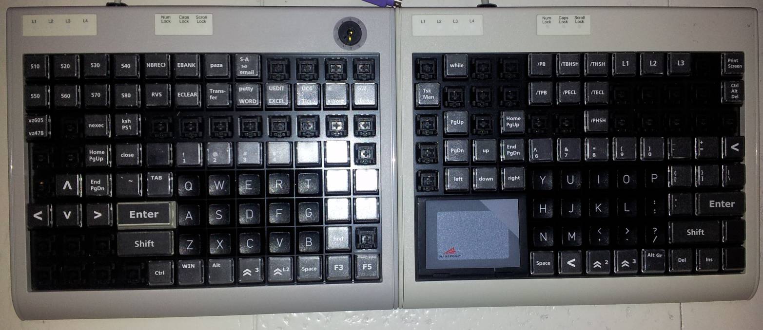

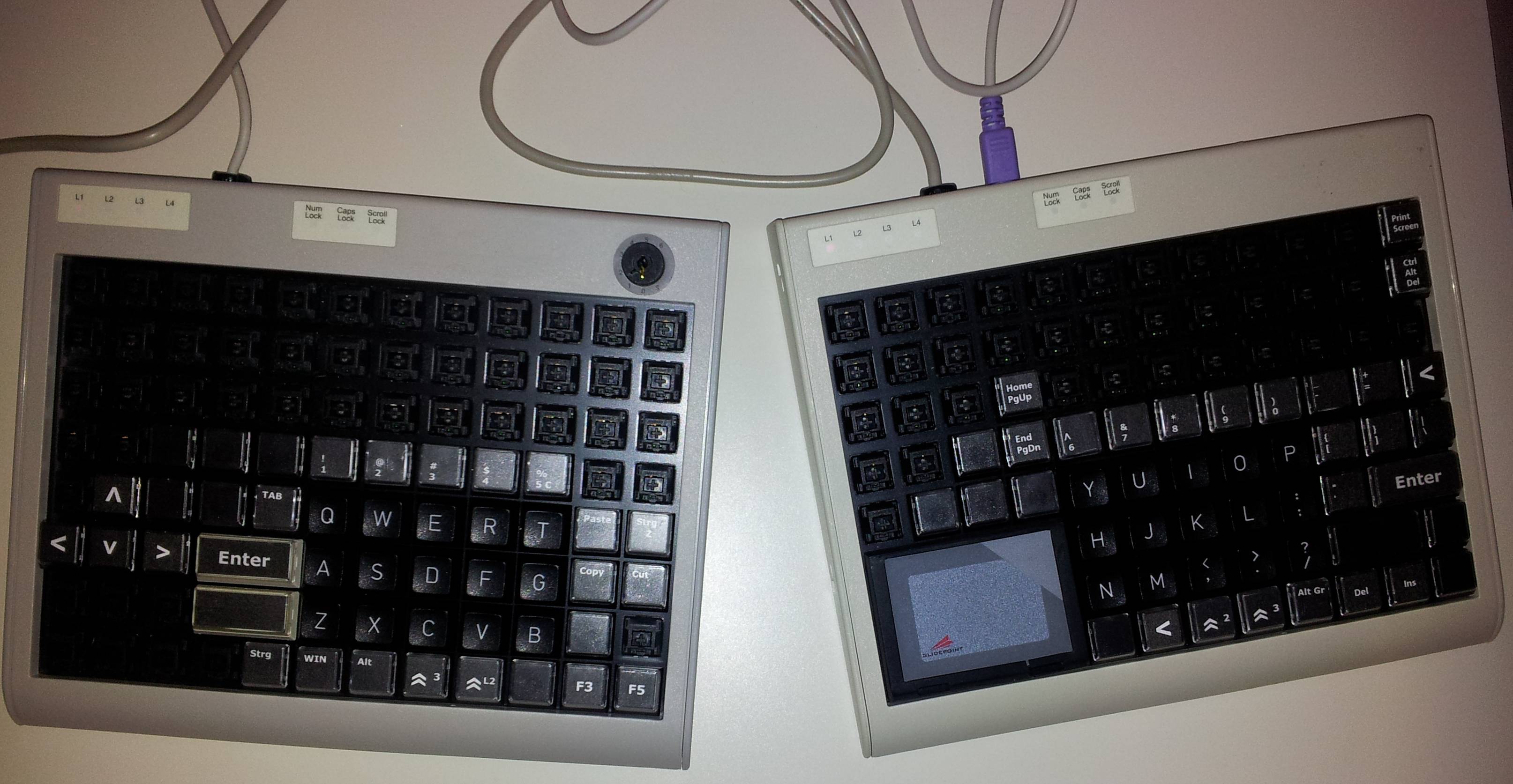

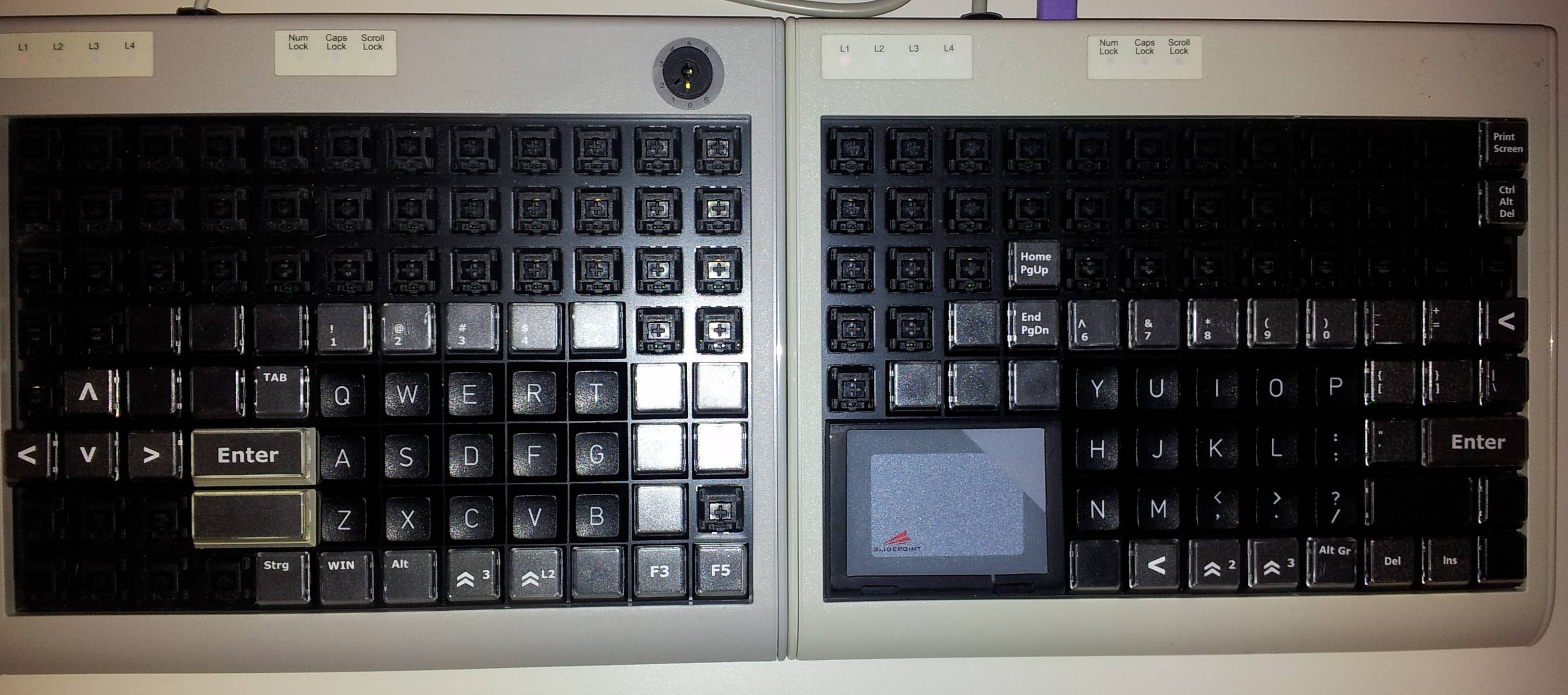

Building my new Workplace Keyboards.
Originally the touchpad was 2 columns more right, but i moved it to columns to the left.
For the cable connector i drilled a new hole in the pcb.
Only one key is not working right know, but i will fix it.
Tipro connect to a Tipro is no problem. I program one unit after the other and of course shift plus key from left to right and the other way, is no problem.
As before, I will use the top 3 rows for phrases and shortcuts i need often at work. The arrow cluster is doubled, because i have the space (otherone is above the touchpad).
The space key is under 'B' and 'N', backspace is under 'M'. This works very good for me already. Enter for the lefthand is already one of my favorites.
The F keys i often use, are 'F3' and 'F5', so i make a direct input. Over 'F3' is 'STRG+F' for searching.
As you see at the pics, not all labels are complete. I did not change the QWERTY Layout because i will not spend any time to learn a new one.
The color setup is not finished. Thinking about using the keylock, so i could put my pwd (and history) to one key ;)
Totally new is the touchpad for me. I will see wether i could put the IE 3.0 away.
Also i could now adjust the angle and distance for the boards.
Hope you enjoy the pics and the layout. I could never ever work without a Tipro again.

Kommst du gut mit dem Matrix-Layout der Tasten klar?
"How do you find the matrix layout of the keys? As they arent shifted as on normal keyboards."
Also curious about the touchpad. Which one is it? Does it work properly?
BTW: Your creations are always enjoyable.

i tried the matrix layout before, and i get used to it. It takes not so long. I hope this time it will be a short time too.
The problem is, at home i use my small deck 82 keyboards. Maybe i should use the "matrix" everywhere.

Nice job you've done here, CeeSA.
Having an additional Enter key and arrow cluster on the left side of the keyboard is definitely an asset. Before having that, I was not even aware how much the right hand moves from and to these keys in between.
(Same for an additional Delete key, by the way.)
The fantastic thing about Tipros is that everybody can adapt them to their own needs.
For example, as I do a lot of editing work on texts, I have a (left-hand) Cut/Copy/Paste cluster
and a (right-hand) cluster of keys to move to the beginning/end of a word/line/paragraph.
I think programmers would appreciate to have to press just one key to get opening and closing brackets and position the cursor between them. Gamers will surely have some complicated shortcuts they'd like to get at a fingertip.
Is the touchpad directly connected to the computer or does it somehow use the Tipro connection?
And by the way, didn't the left unit initially have two "dead" keys?

Touchpad brand: Slidepoint
It's not connected to the Tipro connection:

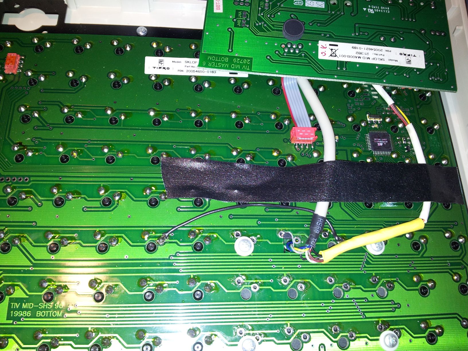

tipro 96 touchpad backside.jpg (514.53 KiB) Viewed 10653 times
As you see (or not really), the touchpad has his own PS/2 connection.
The pic shows the touchpad in the original position, before moving it to 2 columns left.
No dead keys for the left unit.

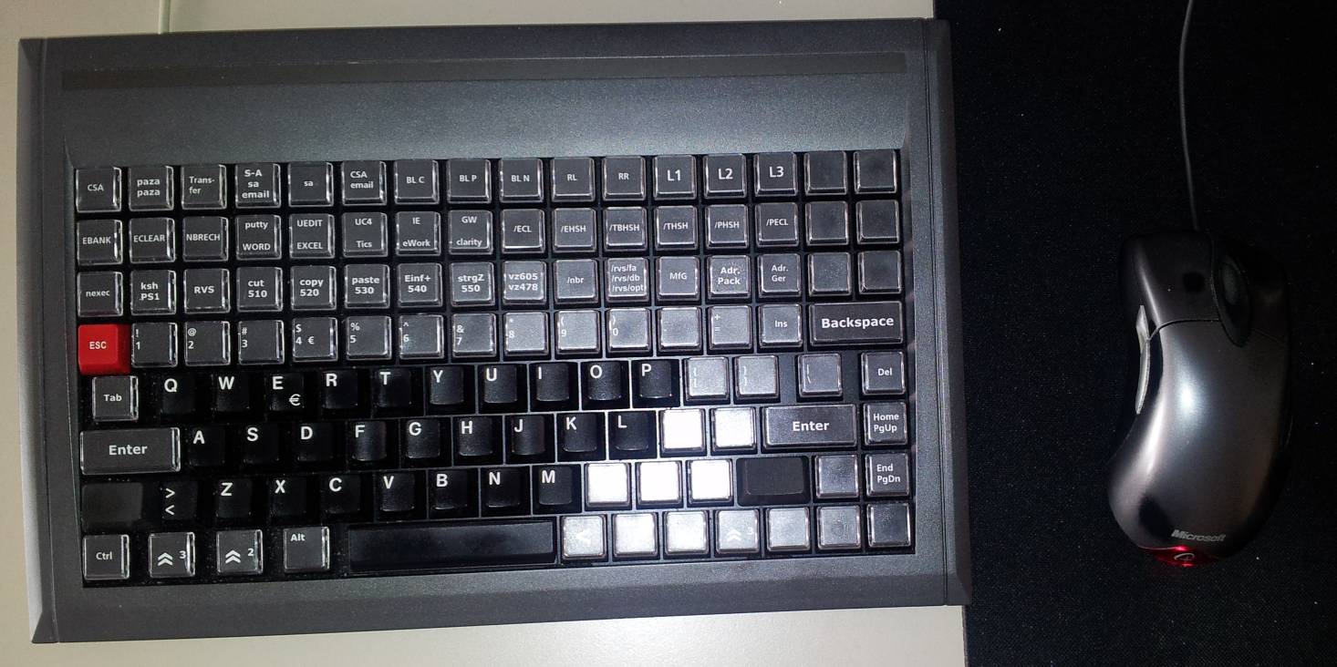

ok, more pics.
my setup now:
new setup, adding more keys (makros, phrases and so on)

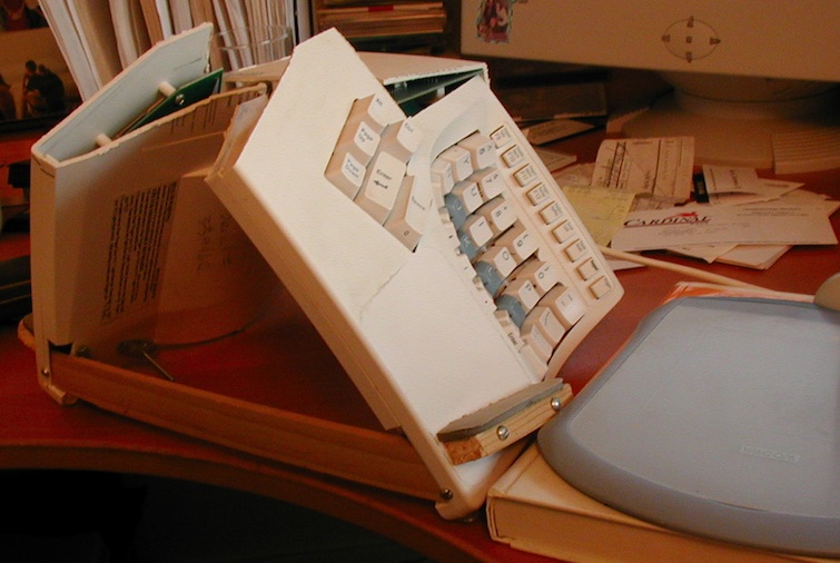

Icarium
01 Jun 2012, 09:36
I keep putting doing the same thing off all the time.
I have the boards already I just keep thinking I want them tilted and then I would need some kind of special armrest and then I just don't do anything. It's just sad.
Does anybody have a good idea on how to make a board tilted and add armrests? Sort of like the Kinesis Pyramid a bit?
Picture taken from input nirvana's wiki over at GH. No idea where he got it from or what the license might be.
Kinesis Pyramid.jpg (111.28 KiB) Viewed 10507 times
But I think the armrests should be closer to the user I doubt that the ones in the picture actually work well.
off
01 Jun 2012, 13:19
Icarium wrote:I keep putting doing the same thing off all the time.
I know what you mean ;)
Icarium wrote:But I think the armrests should be closer to the user I doubt that the ones in the picture actually work well.
I think they'd work nicely; resting the thick side of your hand on it..

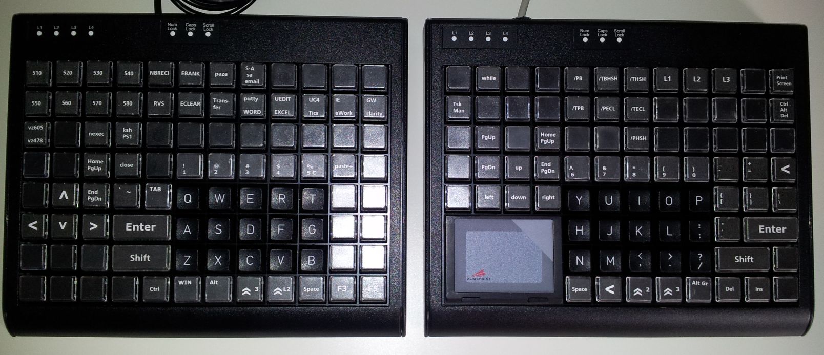

CeeSA
09 Jun 2012, 13:26
now in final black. shift works only one :o :(
so i take off the controller from the left board.
to make the boards detachable i use some parts of the cardreaders.
