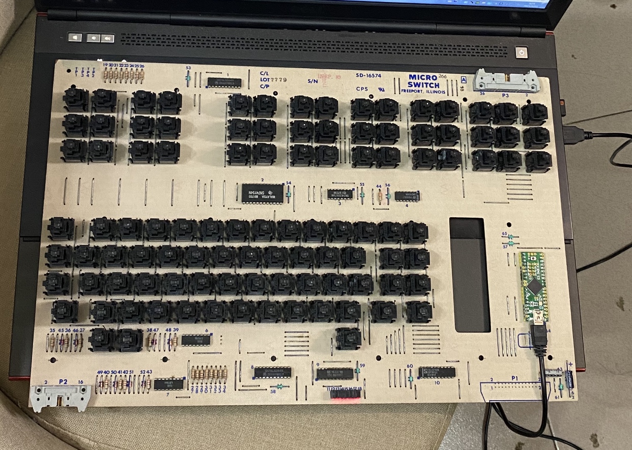

08 Jul 2022, 16:13
What do you make of these?
This board's been waiting for a wee while. I'm still none the wiser, mind. :roll:
jsheradin
08 Jul 2022, 16:41
Muirium wrote: 08 Jul 2022, 16:13 What do you make of these?
E code is also somewhat easy to convert but not quite as cleanly. They're again inherently NKRO and all that fun stuff but the scan logic requires significantly higher current as it's what actually powers the hall sensors. You need around 3.5mA to drive a single switch. On a 32u4 the absolute max I/O current is 40mA which limits your driven line to ~11 switches if you're daring. You should really pair the controller with a line driver chip to make sure there's no issues. Depending on chip choice you'd then be able to run a full sized NKRO matrix to your heart's content.
08 Jul 2022, 16:54
Ooh, that's better than I've heard before. I don't mind sourcing the appropriate chips to do the job well instead of kludging it. But could I get away with the original PCB? Micro Switch made them classy looking. Don't want to have to tear it out.
jsheradin
08 Jul 2022, 17:04
You'd need to desolder the existing scan logic and wire in the new controller but the PCB should be totally reusable. You might get lucky in that one of the existing chips is the requisite line driver in which case it could be reused.
08 Jul 2022, 17:10
Poetry to my ears! I'll open it up and take some new pictures and try to map it out.
That board's weakness is its flimsy white plastic outer case. I'm not at all bothered about keeping that, but the PCB and plate are thicc in all the right ways!

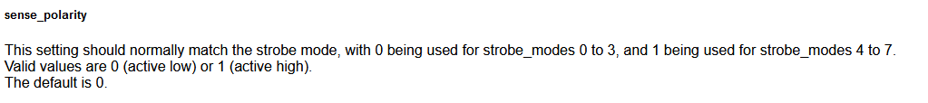

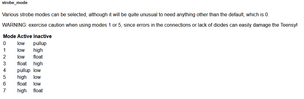

John Doe wrote: 08 Jul 2022, 17:47 I highly doubt for some type sensors Soarer firmware will work flawlessly as the output is inverse sigbal compared to normal contact switches, unless you could mod its source code, sadly looks impossible.
Soarer's controller supports it:
John Doe
08 Jul 2022, 18:02
OMG, Soarer also supportes such options, sure it will work if so, kind.
