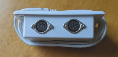

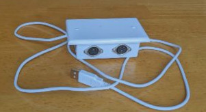

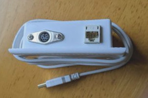

How exactly did you make the big ol switch on the top work? Is it a physical switch (as in each wire of the PS2 and DIN port respectively is connected there and turning the knob changes inbetween)?
19 Oct 2022, 00:11
It’s a 4 pole 3 position rotary switch. I wired all 4 lines (GND VCC DATA CLOCK) to the rotor and the 3 sockets (there’s terminal RJ45 on the hidden side) to the corresponding outputs. Works great so long as you don’t hotswap keyboards. For that it could use a power switch.
