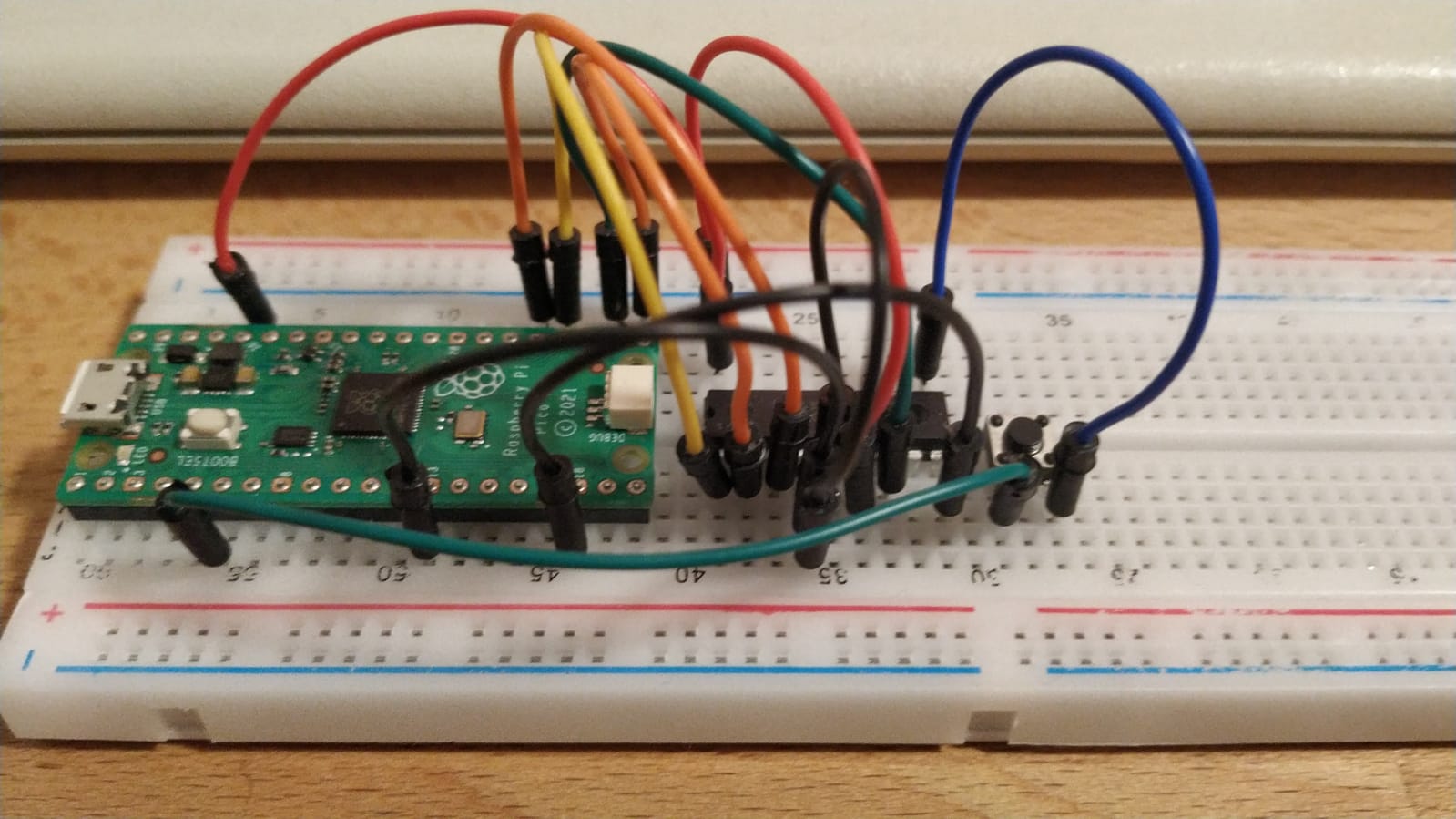

I'm trying to program a keyboard controller with a raspberry pi pico board and a MCP23S08 expander; I want to make an alternative controller for a Model M, something like this (or this). I need 27 pins, 16 for the columns, 8 for the rows and 3 led. The pico only has 26. The idea is to connect the columns and led directly to the pins on the board, and the rows to the expander[*]. Currently the "keyboard" looks like this:
I've seen a few examples of keyboards using expanders, but almost none with RP2040, and none with the MCP30S08 (although it should be pretty close to the MCP23017, which is relatively common in keyboards). On the other hand, it seems to be more common to connect via I2C than SPI.
For testing purposes, I'm starting from Raspberry Pi 2040 onekey configuration. I've included (correctly, I think) the SPI configuration; at least it compiles without errors. What I'm not clear about, before I start programming matrix.c, is the initialisation of the MCP23S08.

caberolo
13 Nov 2022, 22:54
MMcM wrote: 13 Nov 2022, 04:45 I assume you are following https://github.com/qmk/qmk_firmware/blo ... _driver.md and https://ww1.microchip.com/downloads/aem ... 001919.pdf.
Overall, I would expect:
  • Two address pins are hardwired to fix SPI address.
  • SCK, SI, and SO connected to corresponding pins on RP2020.
  • CS connected to some other GPIO.
  • Call spi_init in matrix_init.
  • I suppose for simplicity call spi_start once here, too, and keep the only connected device selected.
  • Use spi_write to set one side (rows or columns) to outputs in IODIR.
  • Set GPPU on the other side to keep them at a known state.
  • In matrix_scan, set exactly one output low by spi_write to OLAT (or GPIO, they are equivalent).
  • Use spi_write and spi_read to read GPIO; low means pressed.
The connections between the MCP and the pico are as follows:
| pin | MCP23S08 | Raspberry pi pico | pin |
|   1 | SCK      | GP18              |  24 |
|   2 | SI       | GP16              |  21 |
|   3 | SO       | GP19              |  25 |
|   4 | A0       | GND               |     |
|   5 | A1       | GND               |     |
|   6 | RESET    | 3V3               |  36 |
|   7 | CS       | GP17              |  22 |
|   8 | INT      |                   |     |
|   9 | Vss      | GND               |     |
|  10 | GP0      | 3V3               |     |
|  11 | GP1      |                   |     |
|  12 | GP2      |                   |     |
|  13 | GP3      |                   |     |
|  14 | GP4      |                   |     |
|  15 | GP5      |                   |     |
|  16 | GP6      |                   |     |
|  17 | GP7      |                   |     |
|  18 | VDD      | 3V3               |  36 |
Grounded pins A0 and A1, set the expander ID to 0. GP0 is connected to 3v3 to simulate a key press, and see if it is able to read a 1. Raspberry pi pico pinout is described here.

I'm not programming an actual scan of the matrix yet; I first want to check that the configuration is correct, that communication is established between the MCP23 and the pico, and that I am able to correctly read the values from the expander.
I must be doing something (very) wrong. The result variable (returned by spi_start()) takes a value of 1 even though the MCP is disconnected.

caberolo
13 Nov 2022, 23:46
Rereading the MCP32S08 documentation, I have noticed an important detail. To read from the SPI bus, the CS pin must be set to low. I've changed the startup functions, and included some debugging code, but it still doesn't work.
void matrix_init_custom(void) {
    // SPI Matrix
    setPinOutput(SPI_MATRIX_CHIP_SELECT_PIN);
    //writePinHigh(SPI_MATRIX_CHIP_SELECT_PIN);
    writePinLow(SPI_MATRIX_CHIP_SELECT_PIN);
    spi_init();
bool matrix_scan_custom(matrix_row_t current_matrix[]) {
    bool matrix_has_changed = false;
    static matrix_row_t temp_matrix[MATRIX_ROWS] = {0};
    // Read from SPI the matrix
    spi_start(SPI_MATRIX_CHIP_SELECT_PIN, false, 0, SPI_MATRIX_DIVISOR);
    spi_receive((uint8_t*)temp_matrix, MATRIX_ROWS * sizeof(matrix_row_t));
    spi_stop();
    print("Content of temp_matrix: ");
    for (int i = 0; i < MATRIX_ROWS; i++){
      uprintf("%d ",temp_matrix[i]);
    print("\n");
    return matrix_has_changed;
MMcM
13 Nov 2022, 23:54
spi_start doesn't actually communicate with the external device; it just configures the internal SPI to talk to it. So success just means no internal pin conflicts.
You should look at the return value from spi_receive. If I am not mistaken, the only time this device will send you anything is when you write a register that you want to read.
I think the next thing to do is write some subroutines to read and write the MCP registers. You can do that without the MCP being connected to the matrix at all. If you pick a read/write one, like the pull-up register, you can verify that you read back what you wrote. Then you can proceed to configure them for the actual scan.
It might be profitable to google around for some Arduino code that talks to one of these devices via SPI. The SPI routines are similar enough that you can probably crib off it.

On the one hand, I've found [1] a keyboard driver among the qmk ones, which does something very similar to what I'm trying to do; it controls the rows from the pins of a promicro and reads the column values from three shift-registers (SN74HC165). It reads the shift-registers via SPI, as I want to do. The code in matrix.c is quite simple, almost to copy it directly.
On the other hand, following this advice:
MMcM wrote: 13 Nov 2022, 23:54 It might be profitable to google around for some Arduino code that talks to one of these devices via SPI. The SPI routines are similar enough that you can probably crib off it.
I found a page where it explains how to control a MCP23S08 like the one I have, from arduino [2].
Now for the bad news. Although everything seems to be well configured, I still don't have a correct reading of the MCP23S08 values. The code I have now is the following:
    // init SPI
    spi_init();
    bool changed = false;
    static matrix_row_t current_row_value = 0;
    wait_ms(20); // delay needed (?)
    //matrix_output_select_delay();
    spi_status_t read_result = spi_read();
    if (read_result >= 0) {
      /* only if SPI read successful: populate the matrix row with the
	 state of the 8 consecutive column bits */
      uprintf("read_result = %i\n",(uint8_t)read_result);
    return changed;
Whether the pins have signal or not, it always reads the same values; 0 or 127, with some values in between (120,64,96) if I pass a high enough value to wait_ms() (20ms seems correct.). Also, I've noticed that if I don't include a slight delay, it always reads 0. But as I said, it's independent of whether the GPx pins have a signal or not.
MMcM wrote: 13 Nov 2022, 23:54 You should look at the return value from spi_receive. If I am not mistaken, the only time this device will send you anything is when you write a register that you want to read.
And another thing that has surprised me is that, with the spi functions of qmk (spi_master.h), it is not clear how to select which io expander to read from in case of having several in series, nor how to control the registers... It may also be something above my level.
Thanks in advance
[1] https://github.com/qmk/qmk_firmware/tre ... d/dqz11n1g
[2] https://www.instructables.com/MCP23S08-With-Arduino/
caberolo
21 Nov 2022, 00:01
In I finally solved it. I have not yet programmed a complete matrix processing routine, but I have managed to read and write correctly from the MCP23S08.
I started from the scratch, with an arduino, to check that everything was working, and then passed it to qmk. The main problem was that I wasn't quite understanding how to control the spi devices with qmk. The documentation is not very newbie-friendly, but it is true that you must know well how to control each device, as each one is different from the others. Also, although this wasn't what was going wrong, I had an error in the pin assignment for MOSI and MISO (corrected in above post).
At the moment, the matrix.h code looks like this:
/*matrix.c */
#include <stdint.h>
#include <stdbool.h>
#include "wait.h"
#include "action_layer.h"
#include "print.h"
#include "debug.h"
#include "util.h"
#include "matrix.h"
#include "debounce.h"
#include QMK_KEYBOARD_H
#include "analog.h"
#include "spi_master.h"
#define CHIP 0x40       // The chip's address (set by pins 4 & 5)
#define IO_DIR_REG 0x00 // The Input/Output Register
#define GPIO_REG 0x09   // The GPIO Register
void mcp_write(uint8_t device, uint8_t spiRegister, uint8_t value){
  /* This function sends data to the chip */
  /* It's a 5 step process */
  /* 1) Pull the Slave/Chip select LOW */
  /* 2) Send the chip's address to the chip */
  spi_write(0b01000000 | (device << 1)); // taken from jhawthorn
  /* 3) Send the register to the chip */
  spi_write(spiRegister);
  /* 4) Send the value to the chip */
  spi_write(value);
  /* 5) Pull the Slave/Chip select HIGH */
  //wait_ms(20);
matrix_row_t mcp_read(uint8_t device, uint8_t addr){
  spi_write(0b01000001 | ((device) << 1));
  spi_write(addr);
  matrix_row_t result = spi_read();
  return result;
  wait_ms(100); /* really needed? */
  spi_init();
  wait_ms(20); /* really needed? */
  /* mcp_write(IO_DIR_REG,0x00); // Set all pins to OUTPUT */
  mcp_write(0,IO_DIR_REG,0xff); // Set all pins to INPUT
  mcp_write(0,GPIO_REG,0x00);   // Set all pins LOW
    matrix_row_t read_result =  mcp_read(0,GPIO_REG);
    return changed;
A minor problem that has appeared is that the GPIO pins of the MCP give a slight input voltage (0.07v), even if nothing is connected to them, which ends up in false input readings. I don't know if it's because you don't have the actual matrix connected, because it's all mounted on a breadboard, or for some other reason that I don't know. It can be easily solved with some pull-down resistors (10k), but I don't know if they are really necessary. In some cases they are and in others they are not.
Thank you all for your help and interest.
MMcM
21 Nov 2022, 01:37
The data sheet seems to say that max output low (D080) is 0.6V, max input low (D031) is 0.2 Vdd = 0.6V @ 3V, min input high (D041) is 0.8 Vdd = 2.4V @3V. So it doesn't seem that 0.07V should be confusing anything.
Maybe just go ahead and code up the matrix to set input pullups and one output low and see whether that detects reliably.
