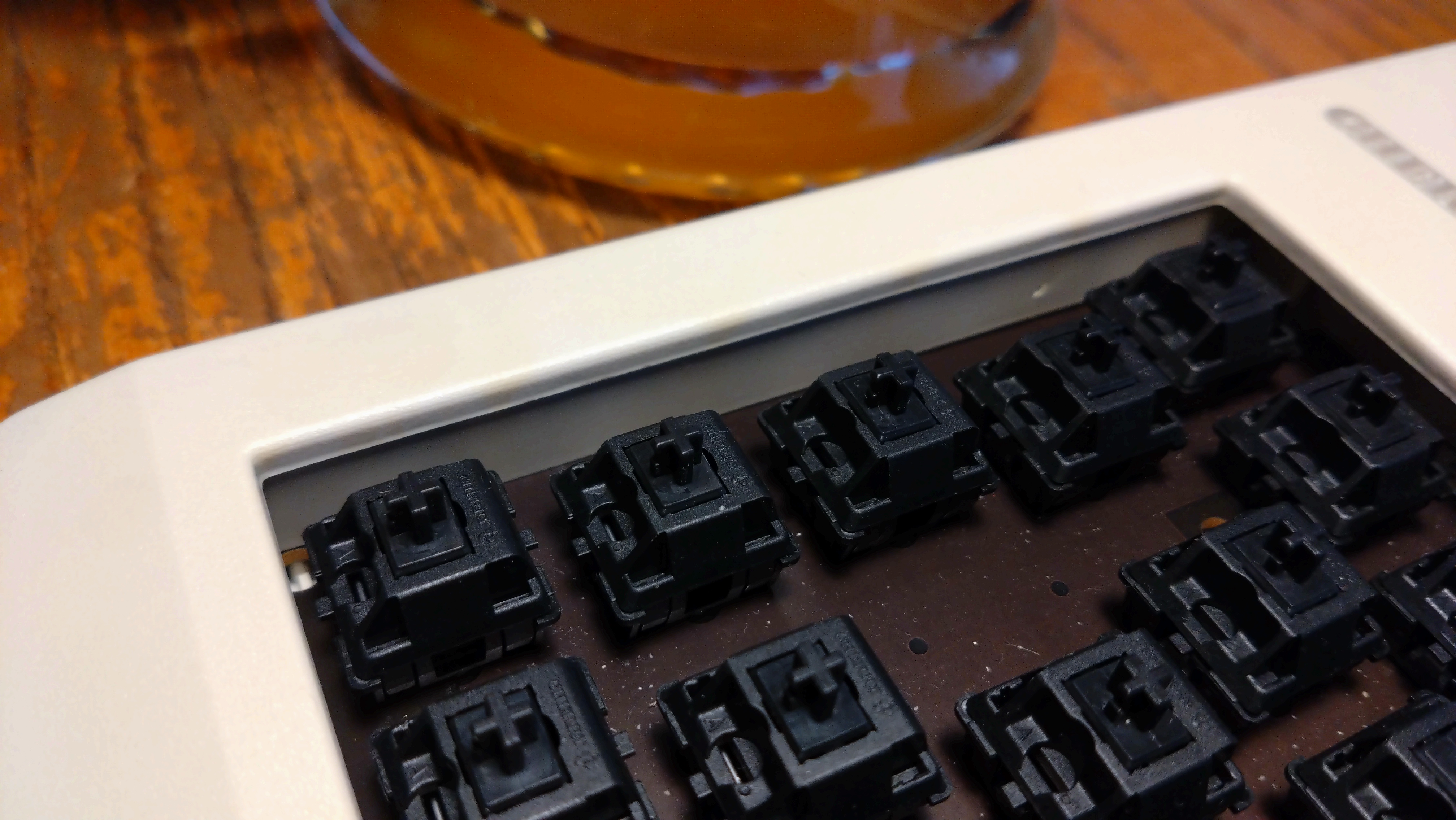

Hey there. I recently got my hands on one of these cherry G80 boards with built in touchpad. Except the switches which i don't like, the reason i went for this board is to use it in a couch-computer situation because of the touchpad. However the ps/2 interface for this use is less than ideal. I want to convert this board to some sort of wireless interface, be it bluetooth or some other wireless radio.
I figured a slim li-po battery would fit inside the board in one place. Because cherry doesnt use a switchplate, instead, the PCB is supported on plastic extrusions that go along the entire bottom of the case, space is limited! So the electronics would have to be compact. something like a pro micro would fit. I plan to replace the original cable with a charging jack, not to modify the case in any way. How would you guys go about such a ps2>wireless conversion? Hardware and software wise, i am completely new to this. Any ideas will be helpful! :roll:

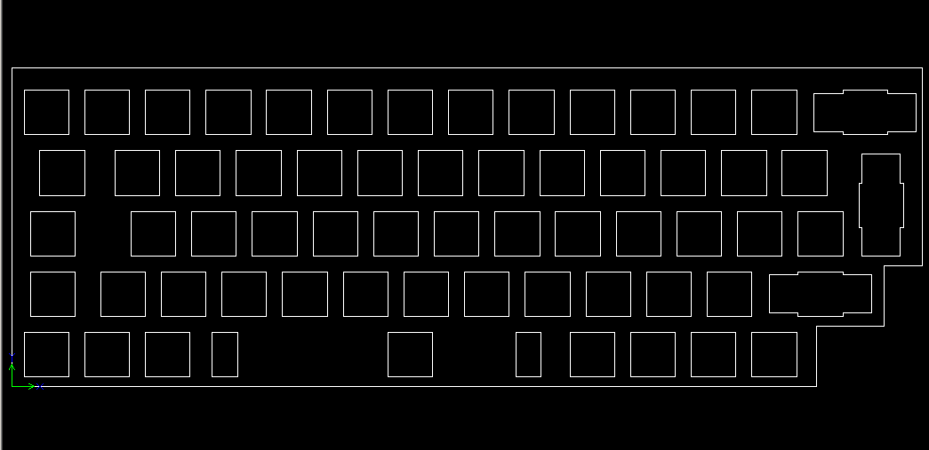

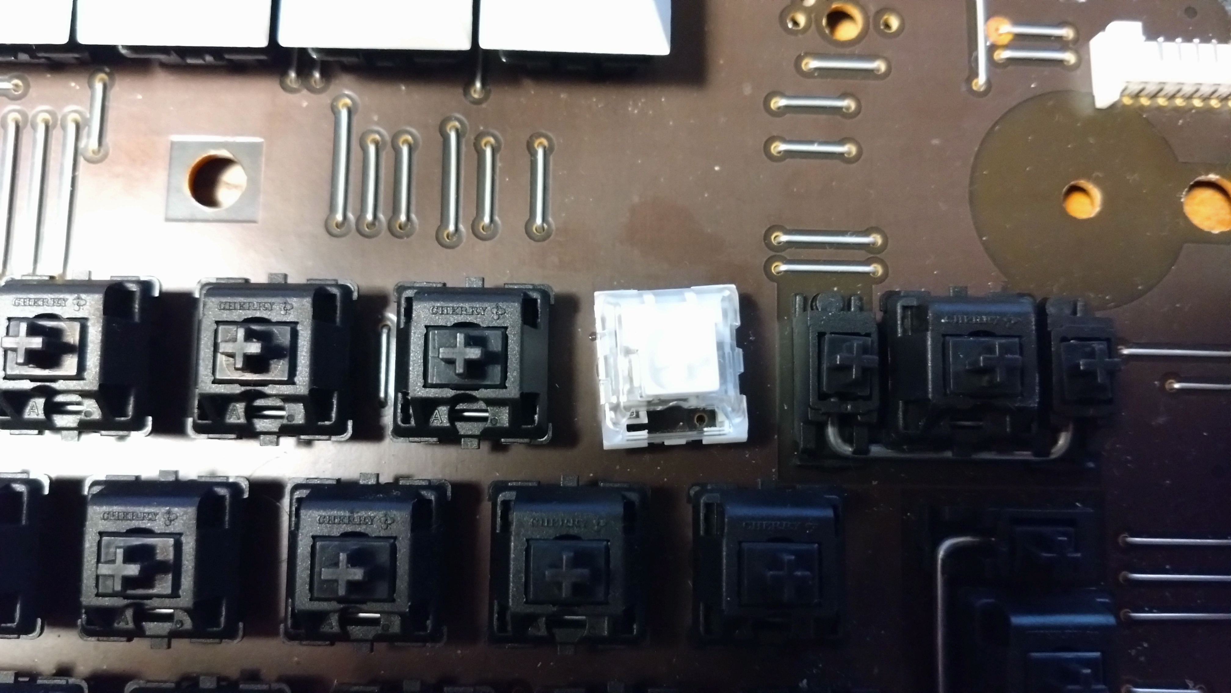

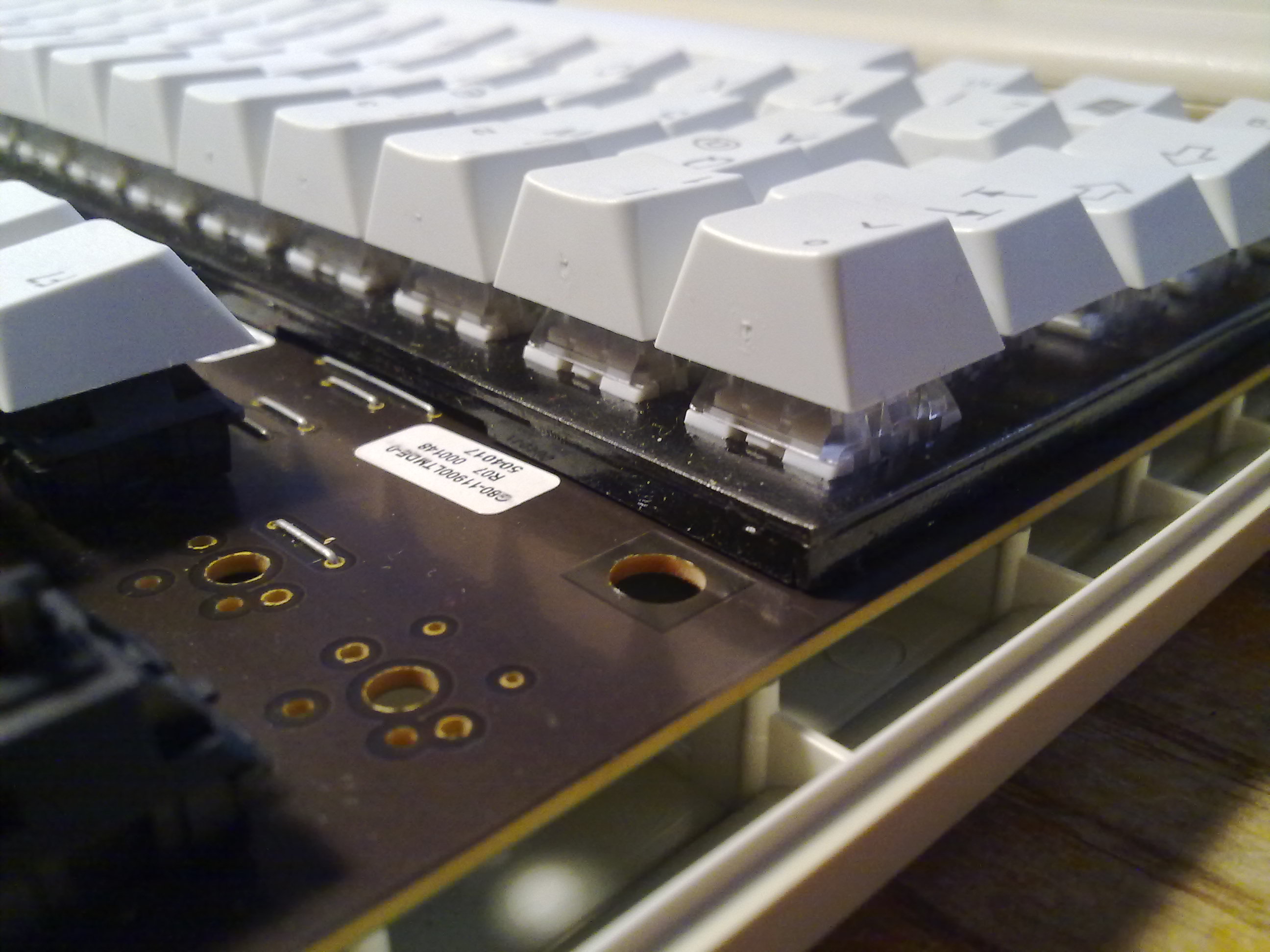

While waiting for the electronic components to get shipped, i was looking for replacement switches because i'm not a big fan of cherry blacks. I found a good deal on kailh box white (i would prefer jades but these were at a good price locally so i went for it.) First time testing click-bar switches and i have to say i am pleased :D However, there are two problems. First one is fairly simple to solve. the original cherry switches have jumpers in them that this board seems to use as part of the matrix. Kailhua doesn't have those. So i will just have to solder some jumpers separately. Other problem is more severe:
Kailh switches do not have the two plastic pegs which align the switch in the pcb. To add on that, the switch legs are so small that you can twist it like that and it's really hard to set it straight for soldering. This would make the process super tedious...
So i started to sketch out a solution to the switch alignment problem. :D
I will report soon how that went about. 1,5mm steel is my choice of material.

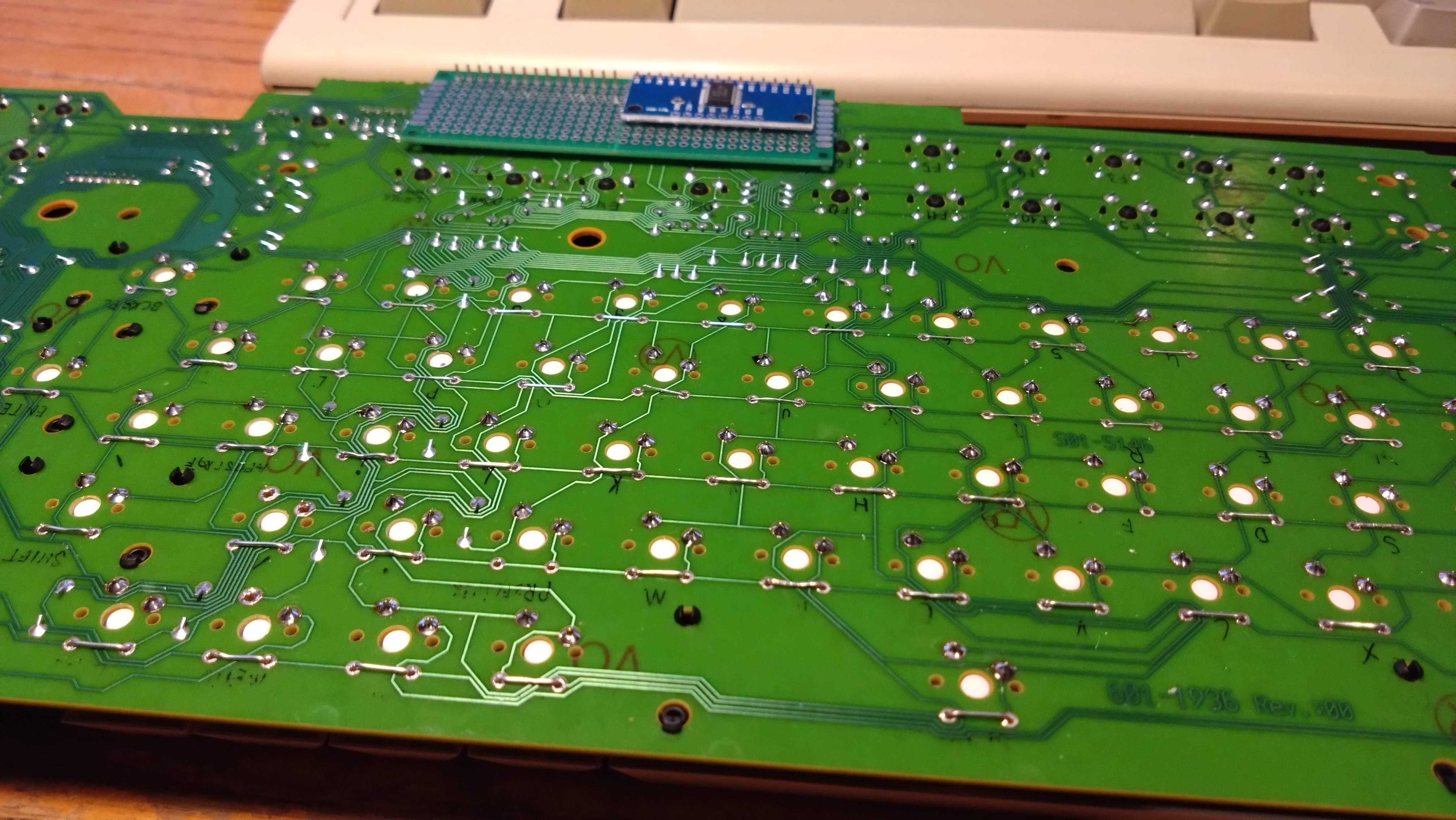

So far quick summary: The multiplexers have arrived, got the keyboard matrix worked out. Touchpad works smoothly with the 32u4 at 16mhz. The trick was to use the (least advertised) BUSYWAIT mode. Ordered a 3,7V lipo battery that will fit in the case (almost), i will have to cut off a little bit of the plastic extrusion inside and some unused plastic standoffs. (this board has a TON of unused things in the moulding) :lol: Also there are pads and holes for three additional keys around the escape key. I wonder what they would be?

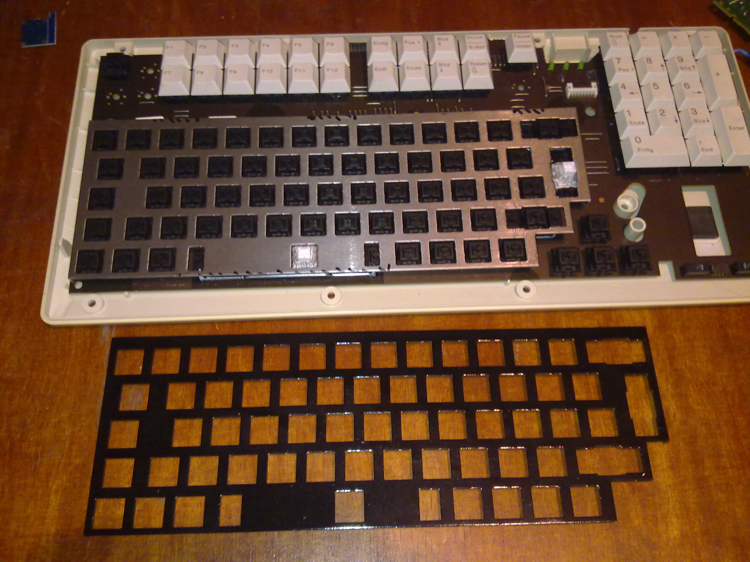

Progress so far:

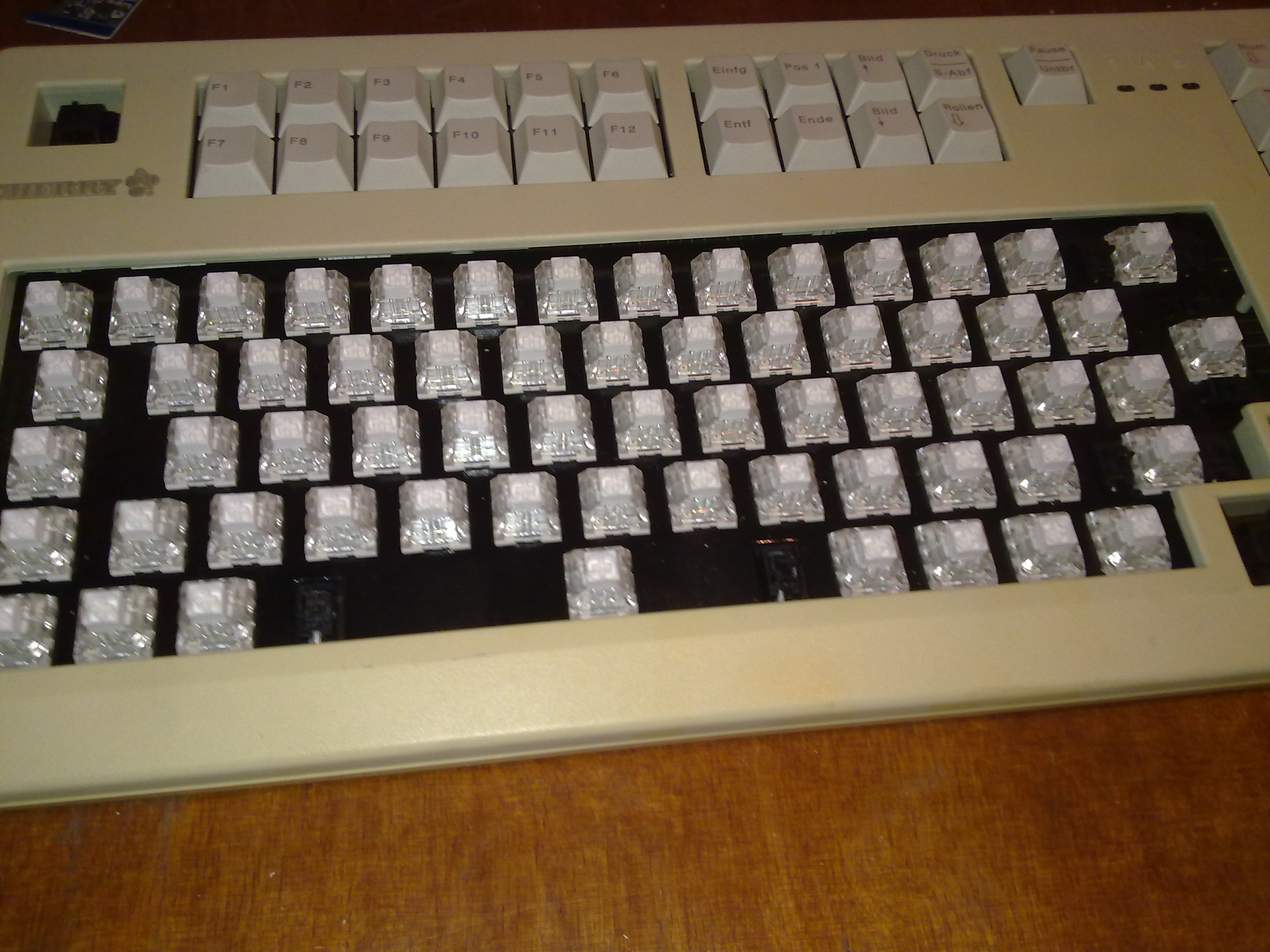

I've managed to cut (and weld because i didn't have a way to bend it at the time and i didn't exactly trust my calculations to be right in such tight space) the plate, got it right second time.
plate prototype.jpg (726.18 KiB) Viewed 73524 times

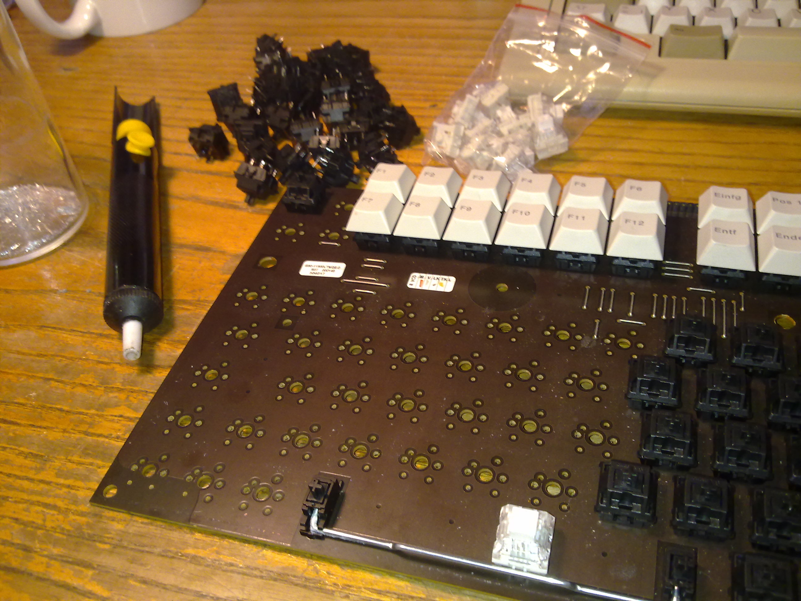

Top: first plate i cut in free time at work. Enter key and holes for spacebar stabs are a bit too much to the left side. i Had to fix that in the second try that's on the bottom. I work on a cnc turret punch machine, these have few advantages over the lasers actually!

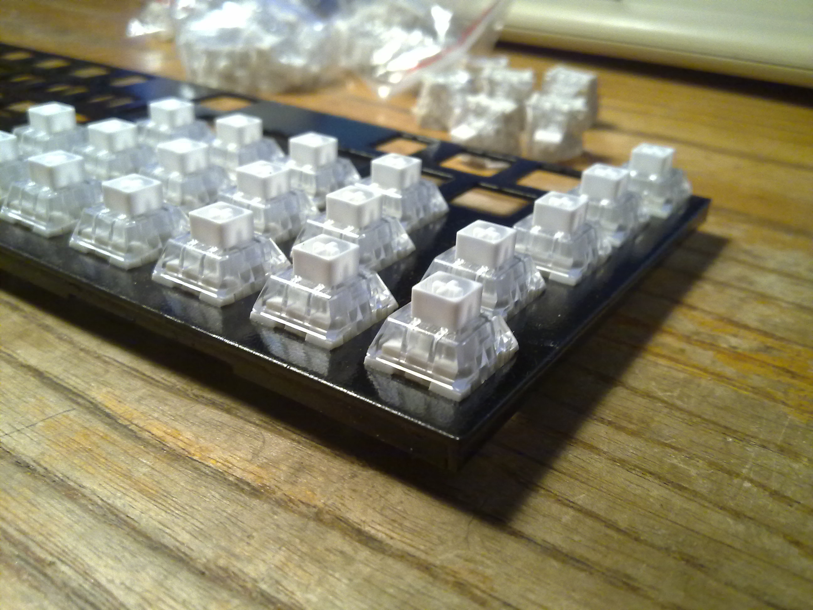

Desoldered all the cherries for the alphanumeric cluster. I decide to leave them on the arrow keys (for playing oldschool racing games on my TV i prefer linear switches.) :lol:
fitting plate with switches.jpg (629.58 KiB) Viewed 73524 times
Switches fit into the plate neatly. In my infinite wisdom though, i assumed Cherry's spacing between keys is 19,00mm. However, it turned out to be something about 19,10mm, which made it a very tight fit later on :cry: i will have to fix that if i want to make the plate again. it was such a small misalignment i've managed to make it fit though.

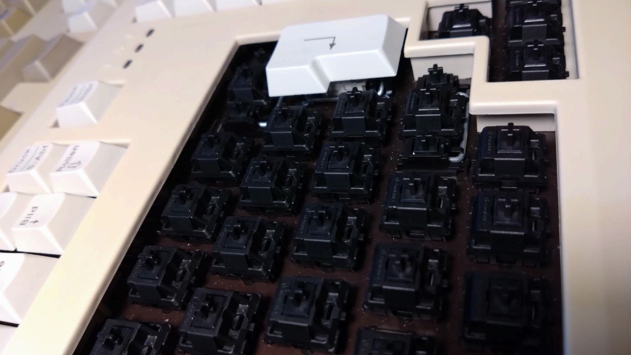

plate and switches in case.jpg (633.76 KiB) Viewed 73524 times
All the switches and plate in place, test fitting before soldering.

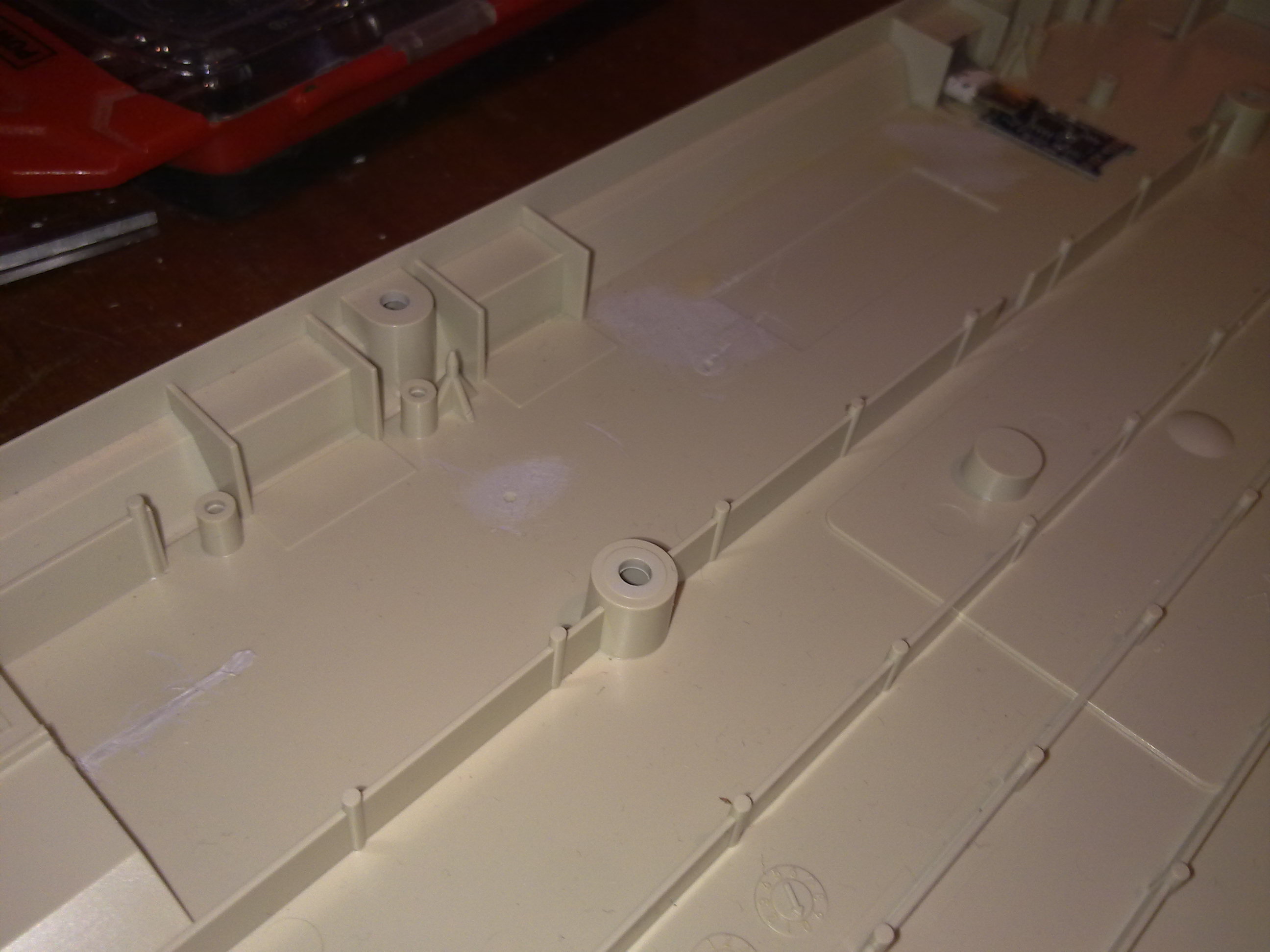

Curious detail of the reliefs in the plate side i had to make to clear the jumpers in the pcb. one of 5 such reliefs. :lol:
case .jpg (383.35 KiB) Viewed 73524 times
I cut out few of plastic bits in the case that were taking up the space for the new stuff. Few standoffs that didnt do anything, and four that provided support for the original controller. Also i've accidently ordered a USB type C battery charger. Turned out, a type C to micro usb adapter, served as a perfect charging port for the board, it will be much harder to break it accidentally and i can easily replace the battery charger pcb if i need to.

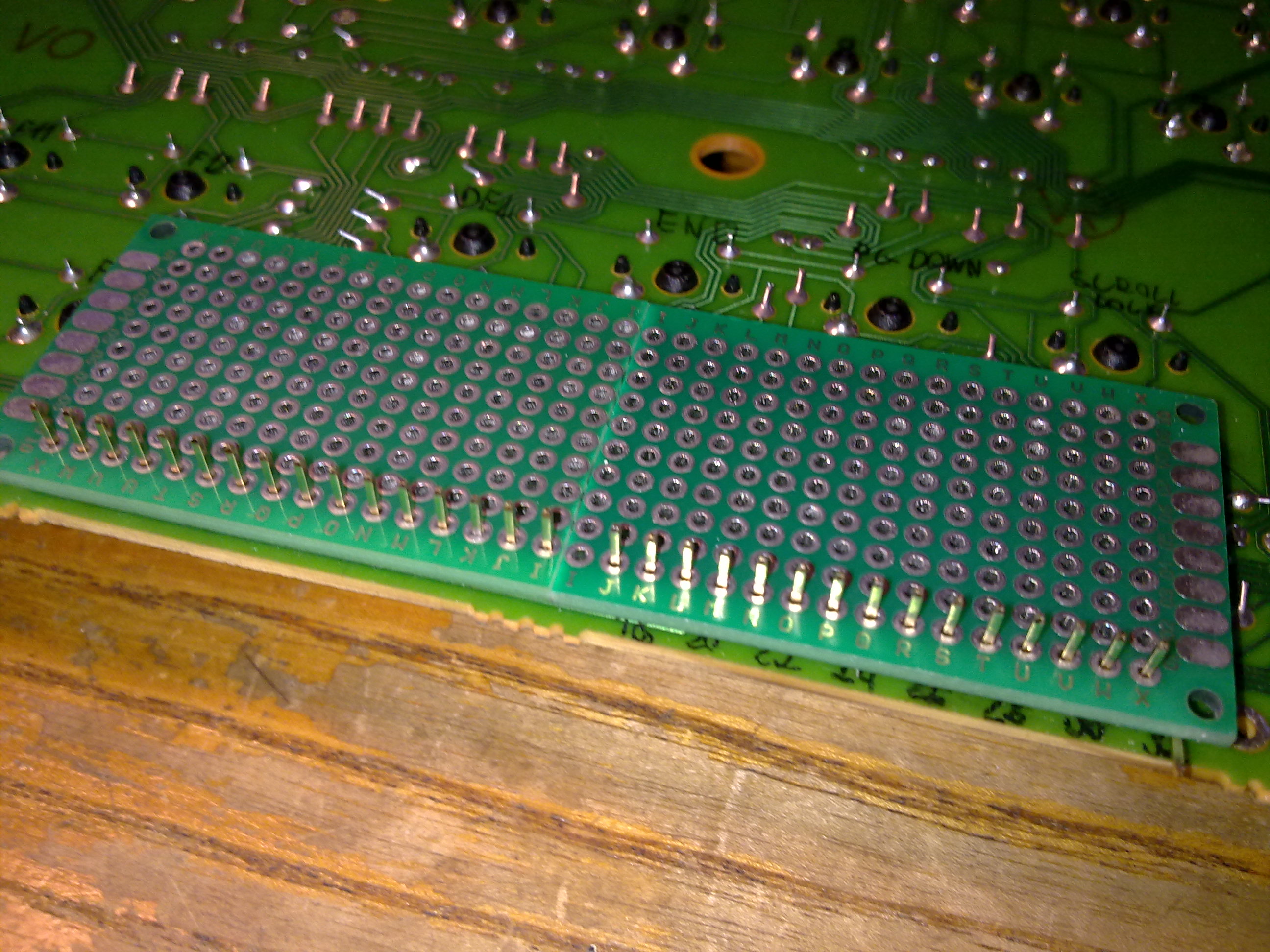

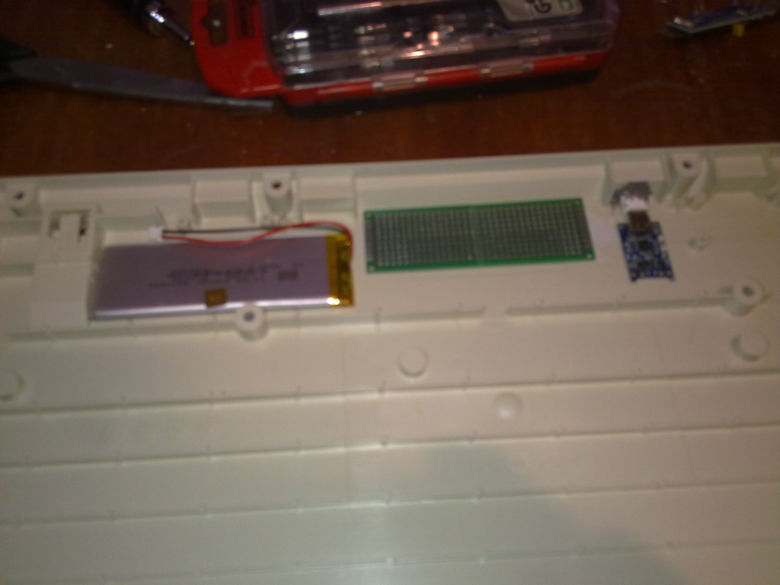

Layout of the electronics, pro micro and the multiplexer will be on the green proto boards, soldered to the keyboard pcb.
proto board.jpg (864.96 KiB) Viewed 73524 times
I couldn't order a correct length proto board for my use (it can't be larger because it will interfere with the case) so i've cut two smaller ones and joined them together with super glue. Should be good enough to hold the controller and multiplexer.

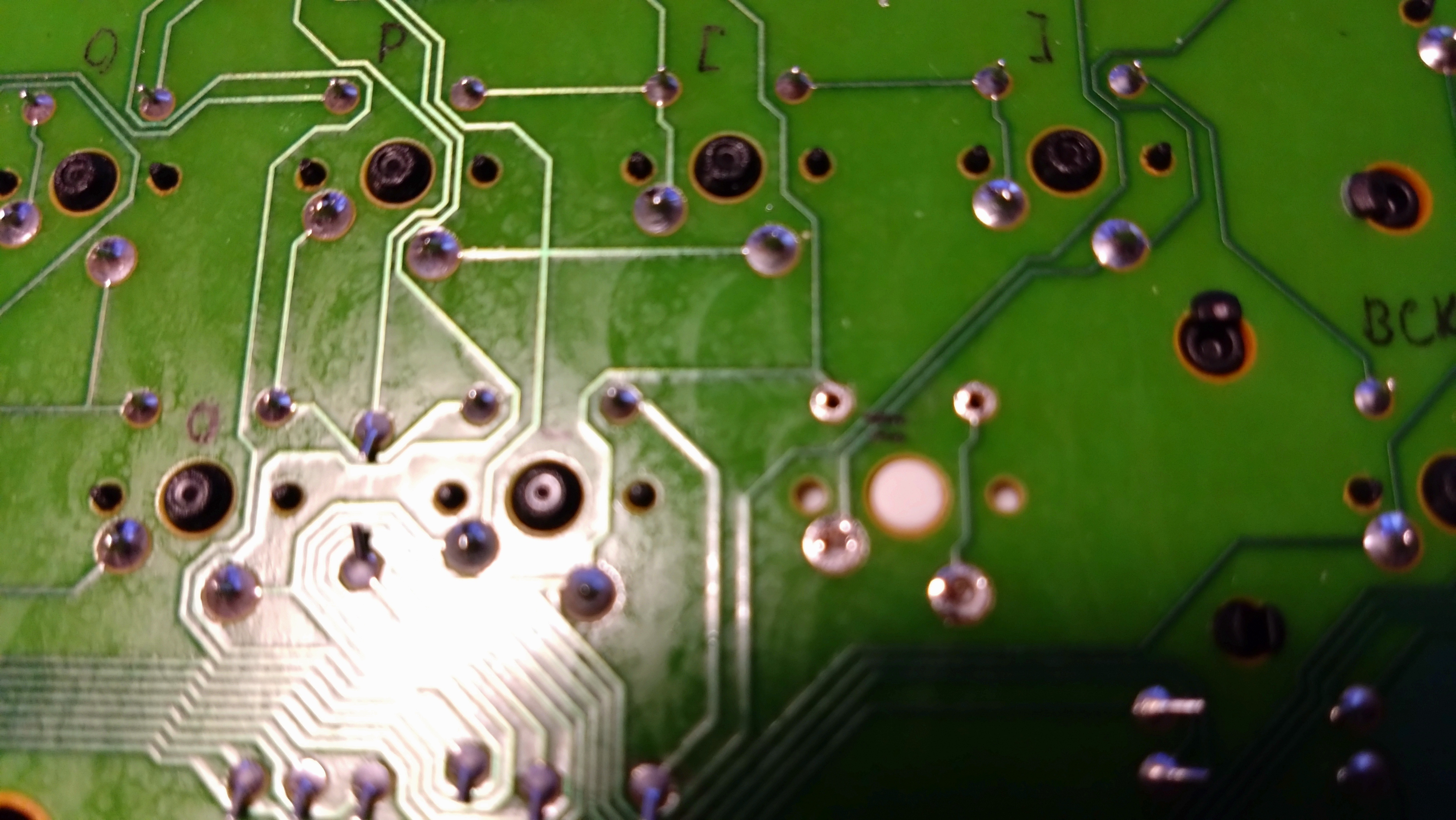

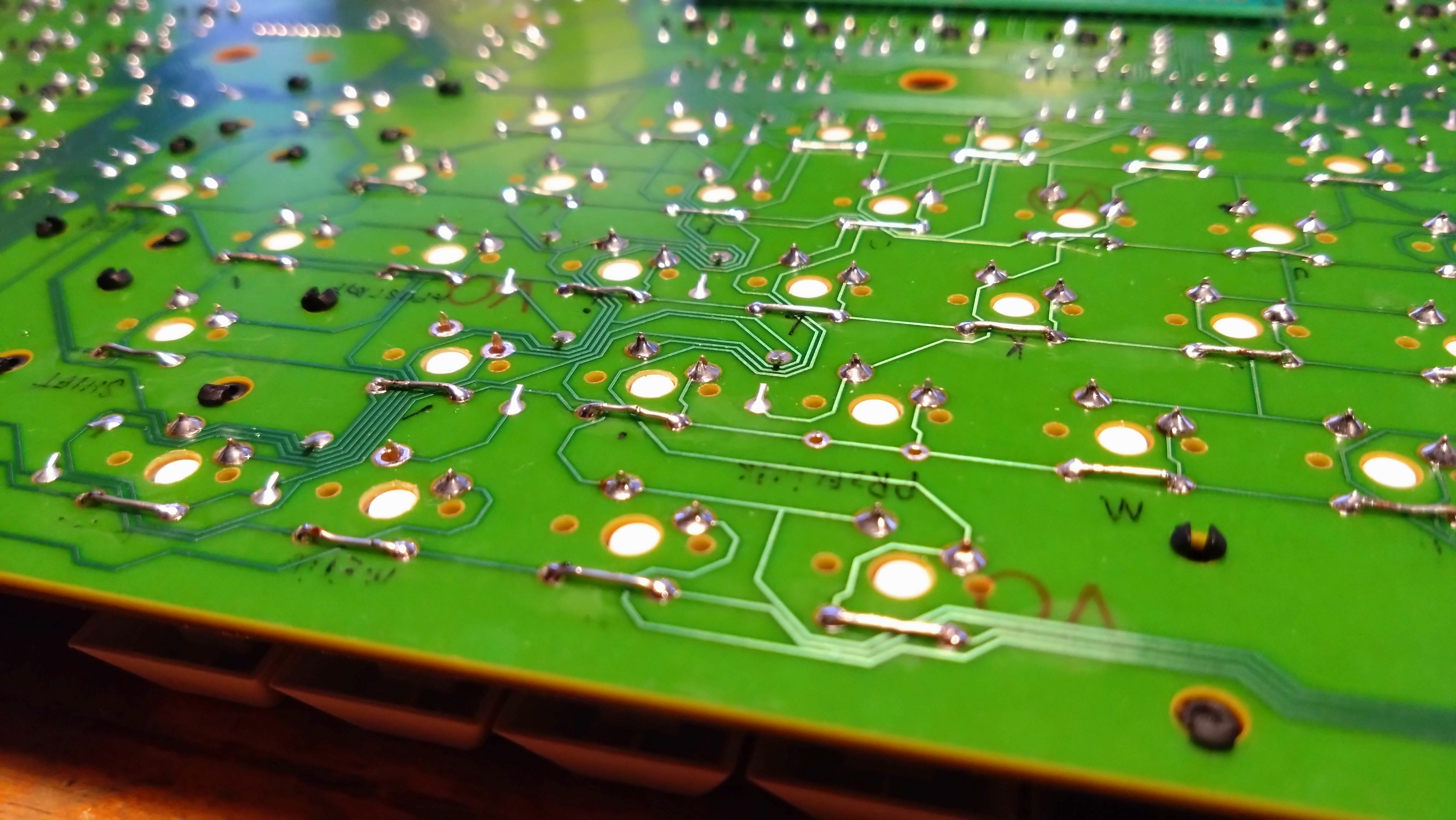

Kailhua box switches do not have the integrated jumpers Cherries have, so i had to replicate that with some bent wire.
JUMPERS 2.JPG (3.35 MiB) Viewed 73524 times
All the replacement jumpers soldered. Not every holes needed to have them as there are redundant traces in the pcb.

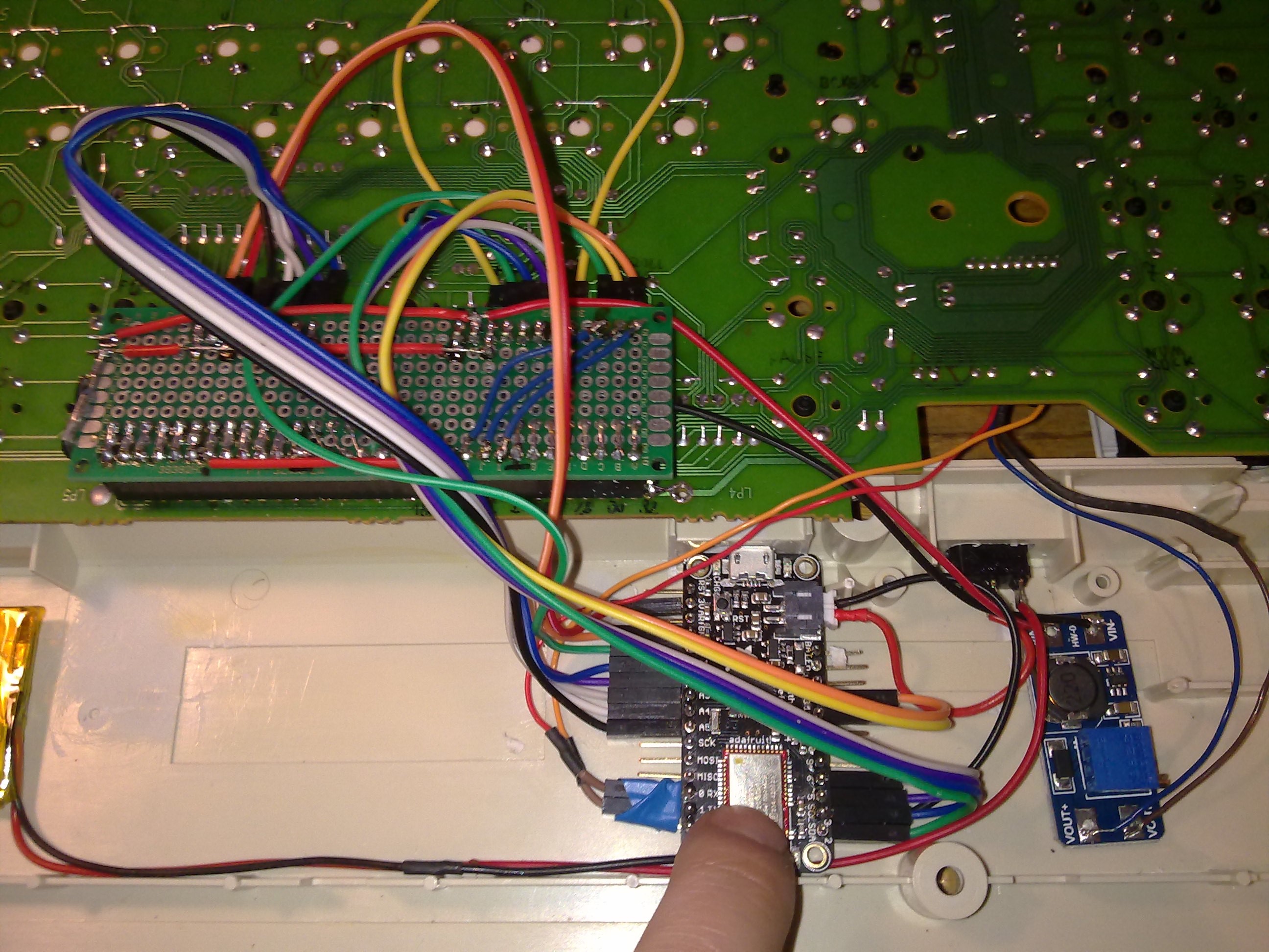

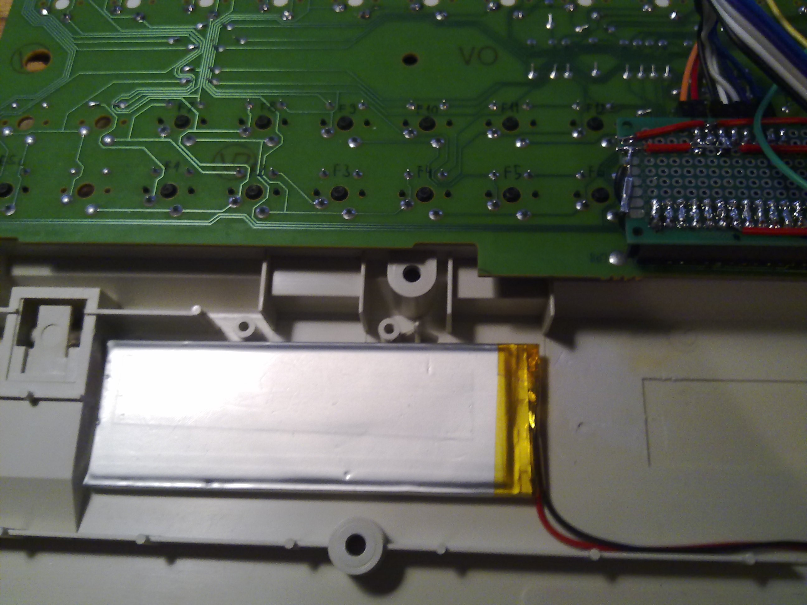

Long overdue update because this is a very "in the meantime" project.
It works ^^ I will record some video soon to show how the touchpad works. Right now it looks like this:

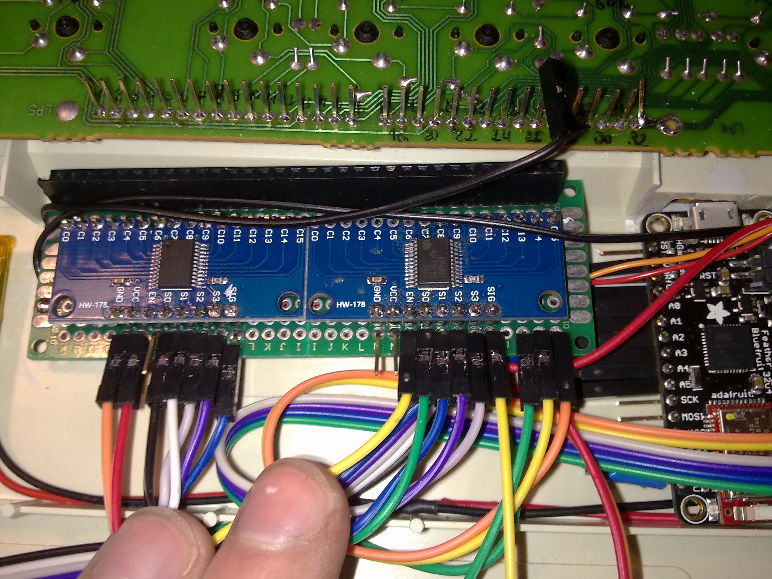

The proto board with two multiplexers is using female goldpin connectors for ease of removal. I figured i will have to do that many times during testing. On the right side there is a step up buck converter for powering the ps/2 OEM touchpad controller with 5V.

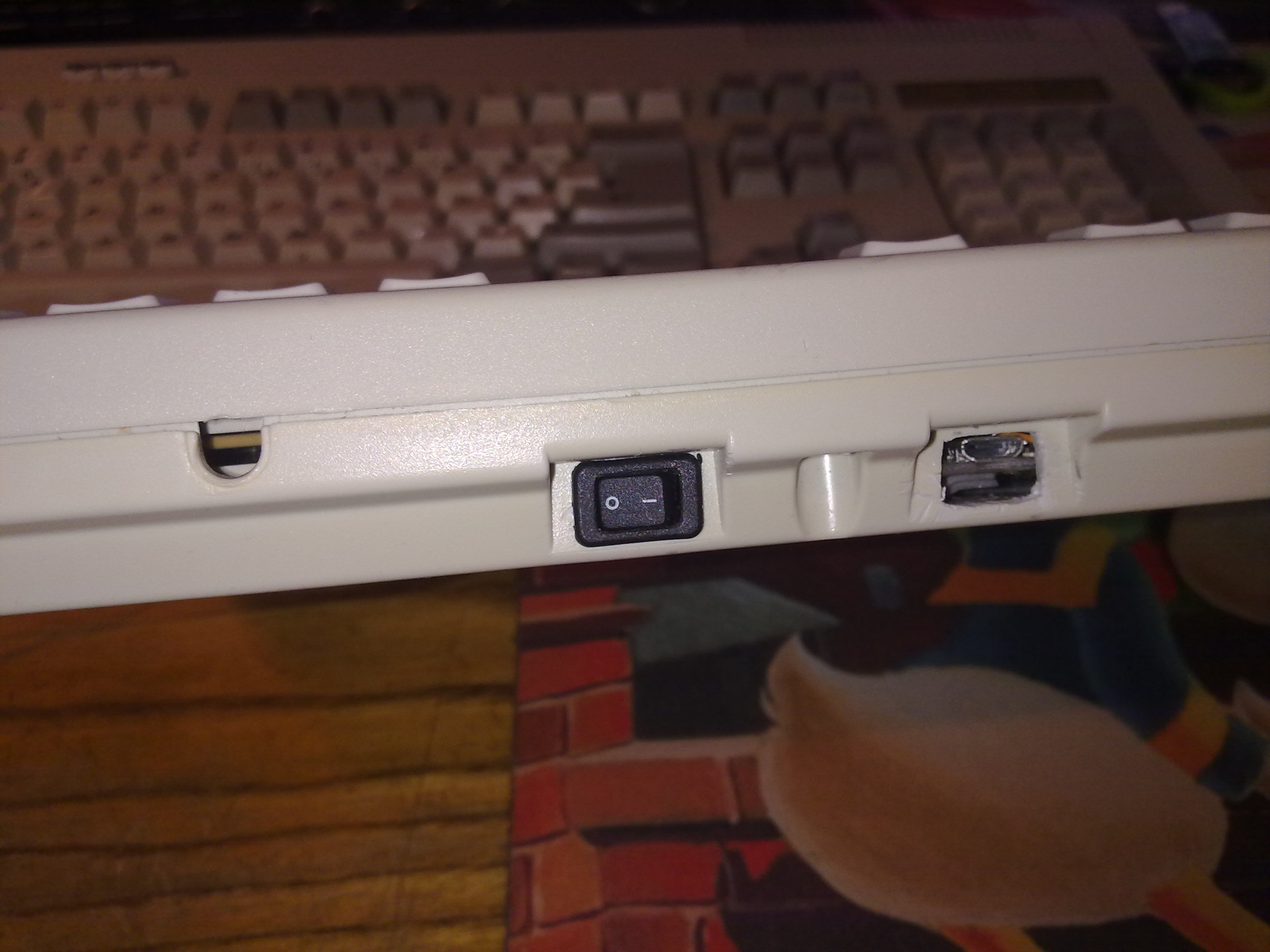

Plenty of space left for a big battery. I ended up using the same adafruit feather board as jsheradin (thanks for tips) because after buying HC05 bluetooth modules and trying to flash them with firmware i got fed up with them as they really didn't want to get flashed :roll:
Other side of the multiplexer board. Everything barley fits, but it does fit. :lol:
Battery lives on the left. Another advantage of the adafruit feather (Albeit pricey) it comes with a LiPo charger circuit built in.
From the back it looks rather obvious, i have to cover up the way too big hole for the usb connector with something, because at some point i swapped the switch and controller around. (didn't fit that way because of some plastic bits inside the case.)
So Far: Keyboard works, except the lock lights. Probably something is connected wrongly, i must have just messed it up during assembly. Trackpad works, and it's rather snappy and smooth, key to that was to use the BUSYWAIT (least reccomended :lol: ) mode in the QMK settings. It only gets a bit laggy when i move a bit further from the reciever, but i think that's just a crappy bluetooth usb dongle i got.

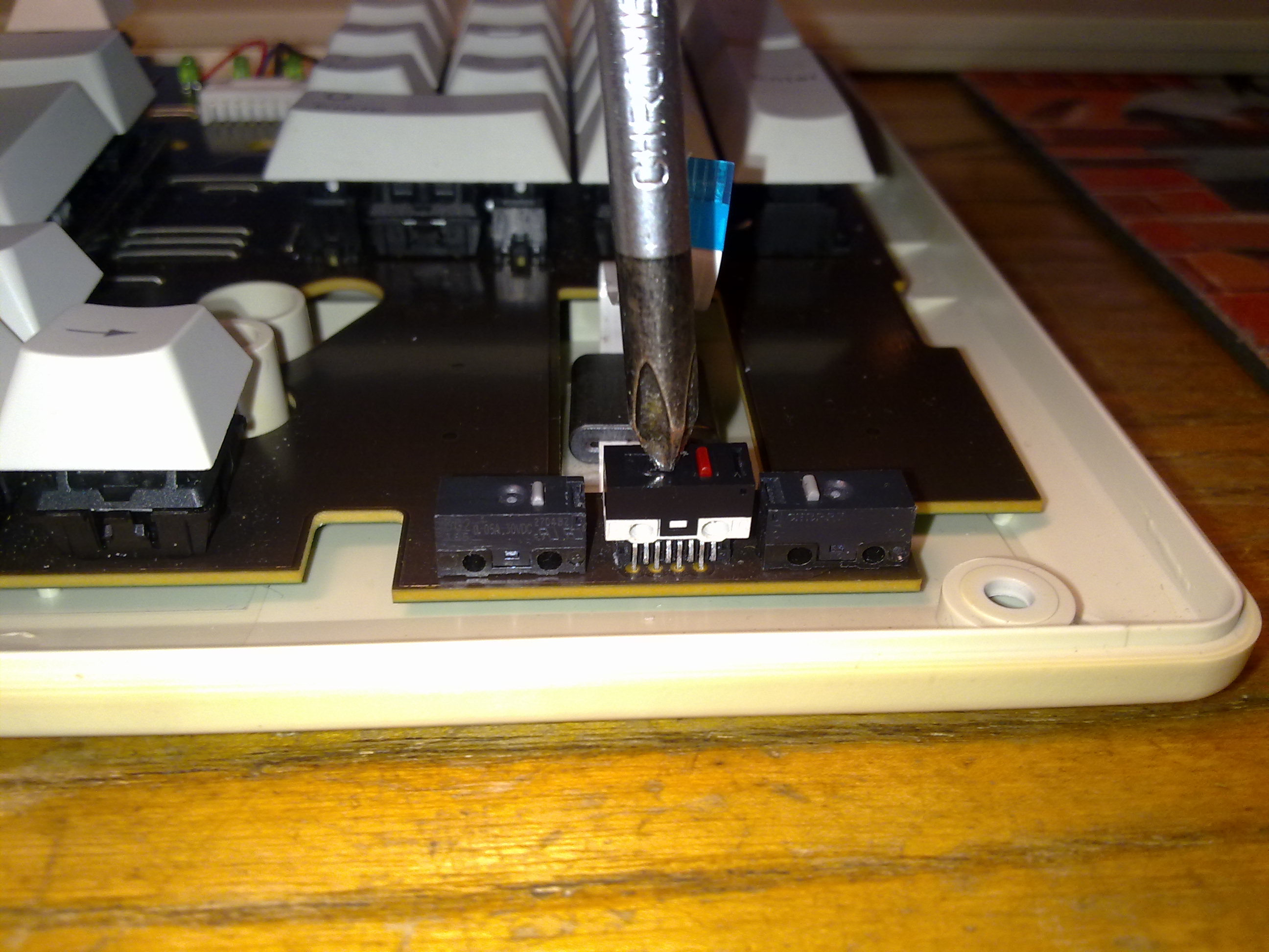

-Add 3rd mouse button for scrolling. (this is something i really wanted to do!)

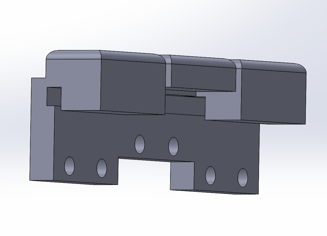

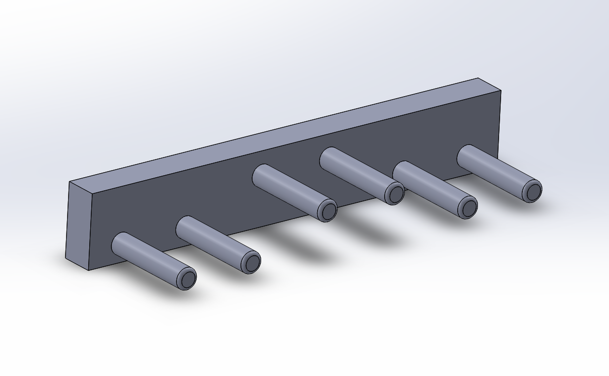

Sourced a mouse switch from some crappy mouse. So far so good, but how the heck would i mount it? i don't want to remove the two switches that are already there, and in the middle between them, there is that connector for the touchpad ribbon cable:
Only reasonable way to do this i think is to have the 3rd switch above it. So i got to drawing a mount i could have my friend 3D print for me. It utilises the holes that are already in the switches. Very convenient that those are here :D
first piece would go through the holes with those pegs.
and second piece, also doubling as the keys themselves. Then the 3rd switch will just be added as another key in the matrix outputting the 3RD mouse button scancode. Thanks for sticking around if you did and all the help! ^^
