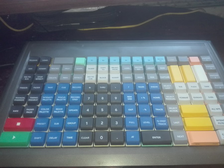

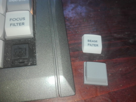

I`don`t know how the different parts are called.Actually I use the original "base" with my lids,so it`s a bit colourfull,wich is ok but not nice.

kbdfr wrote: 07 Feb 2023, 08:12But first you should make sure that under each of the 2u (="double size") keycaps, both switches have a spring, i.e. the cross-shaped part moves up by itself when you press it down. Simply remove the 2u keycap by gently lifting it and check both switches.
Yes,both keys are working "alone",so there should be springs.
What is a good keyword for my search?Or what do you mean with "You can help"?

The "open place" on the picture in my last posting is the switch,right?
The grey button on this pic is the keycap?
And the white button is the lid?

07 Feb 2023, 19:24
bibone wrote: 07 Feb 2023, 16:46 Hy,
probably I don`t understand the whole thing.
Exactly.

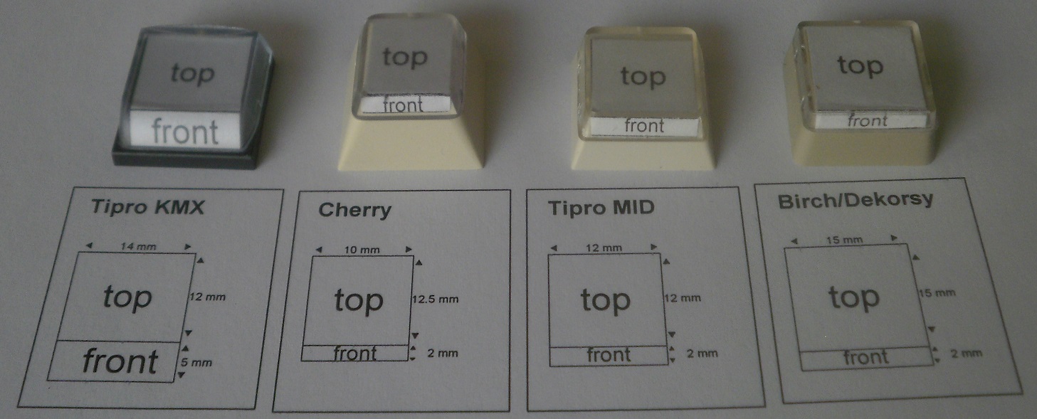

There are so-called "relegendable" keycaps, consisting of 2 parts, the base and the lid. Here a few examples:
In your keyboard, the lids are not transparent, but are opaque and have been pre-printed by Tipro for their customer. In usual relegendables, you can insert a piece of paper between the base and the lid. As the lids are interchangeable, you could replace yours with transparent ones.
But the ones you have are difficult to get (at the left in my pic). I just have one or two dozens of them.
