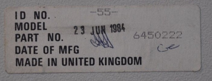

Pulled from my database ;) , an early production Model F AT. I was wondering what this particular ID meant. I didn't believe it to be the 55th unit produced.

JP! wrote: 18 May 2023, 23:15 Pulled from my database ;) , an early production Model F AT. I was wondering what this particular ID meant. I didn't believe it to be the 55th unit produced.

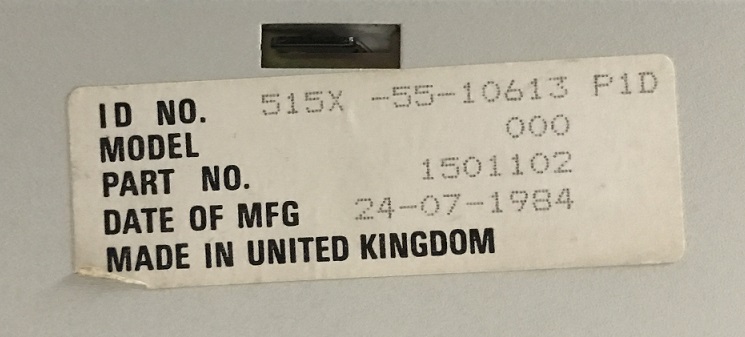

Looks like the folks at Greenock forgot the rest of the ID! For reference, he's some completed Model F IBM U.K. birth certs:
F/XT:
3104/3178:
F122:
F/AT:
For anyone interested, I'm building up an archive of IBM and family rear labels on my site! :)

sharktastica wrote: 18 May 2023, 23:24 Looks like the folks at Greenock forgot the rest of the ID! For reference, he's some completed Model F IBM U.K. birth certs:
Indeed! Here is an example of my UK XT. Btw, both of my UK F's are the German variants.
Ah this one is interesting.
