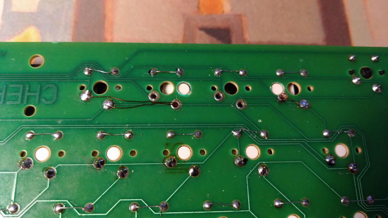

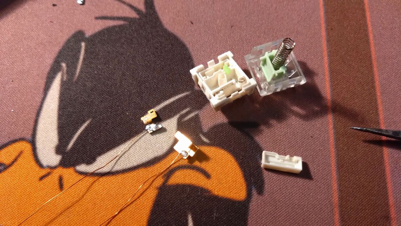

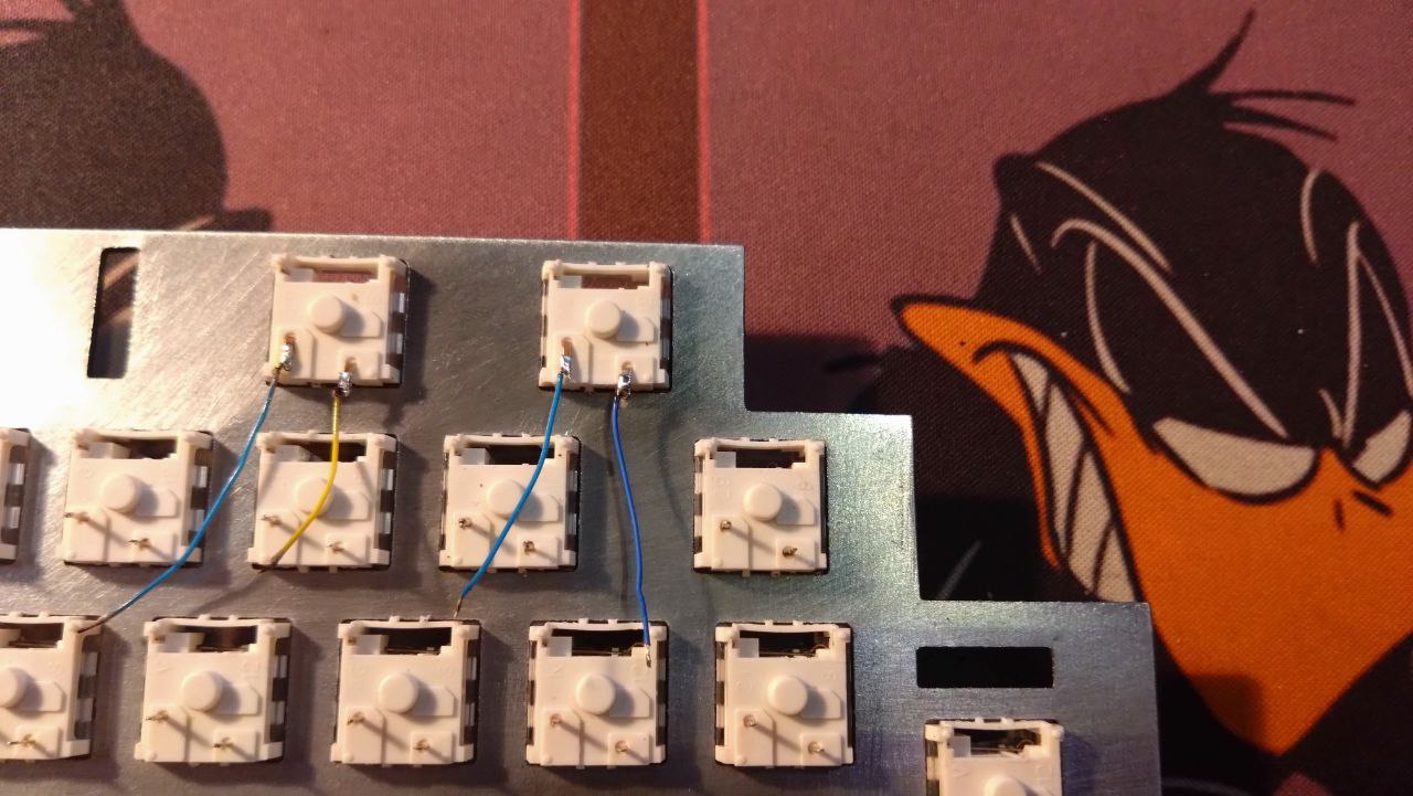

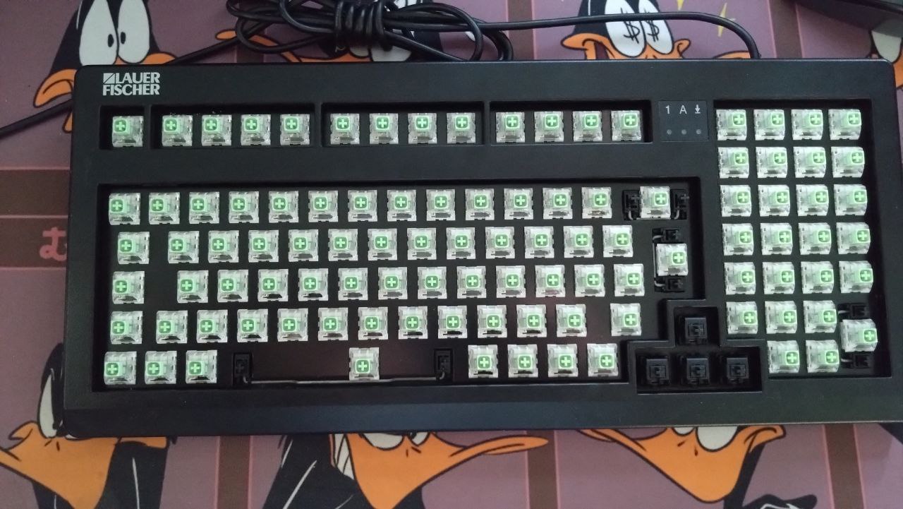

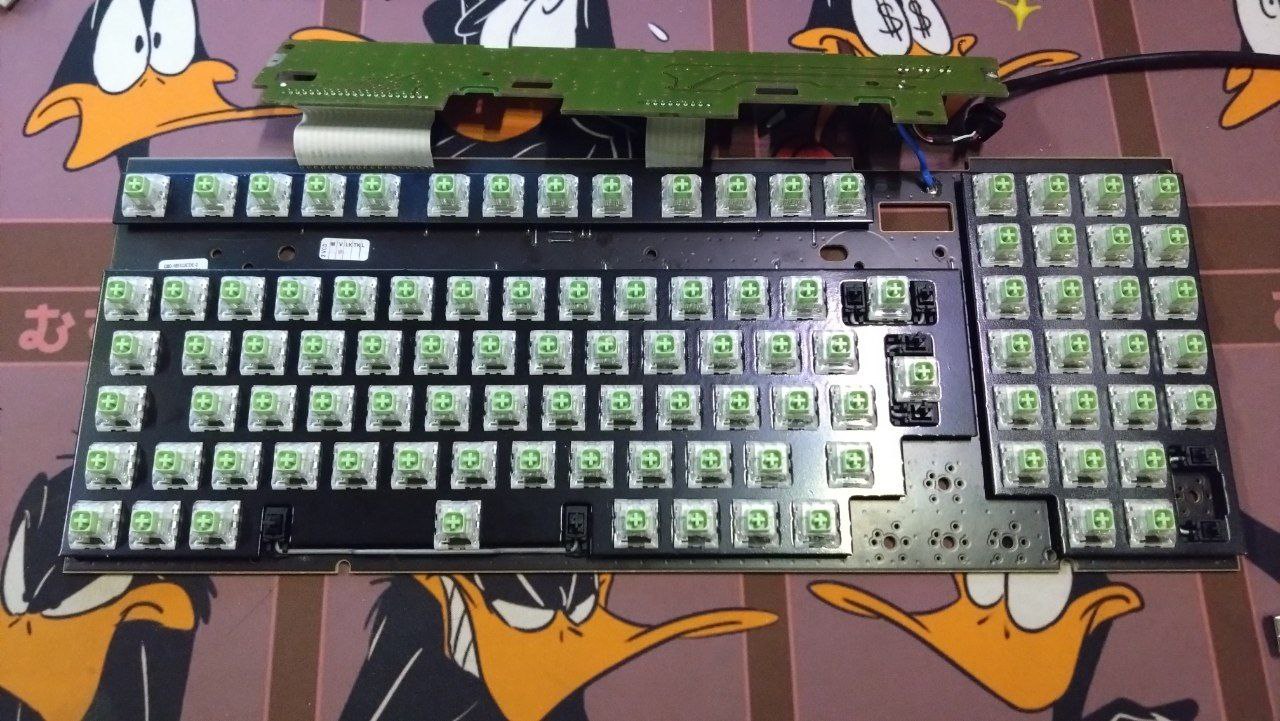

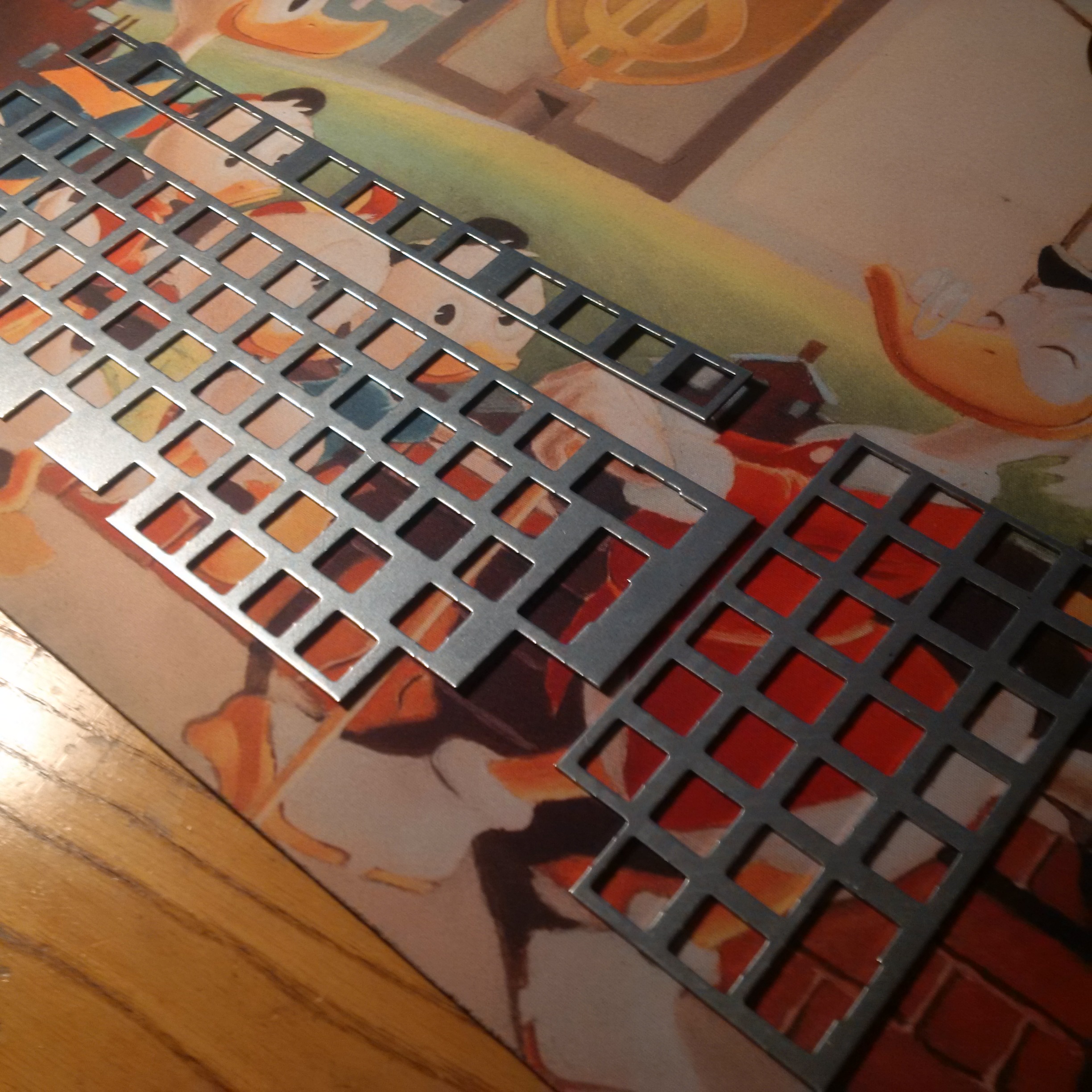

Hello fellow keyboard tinkerers.

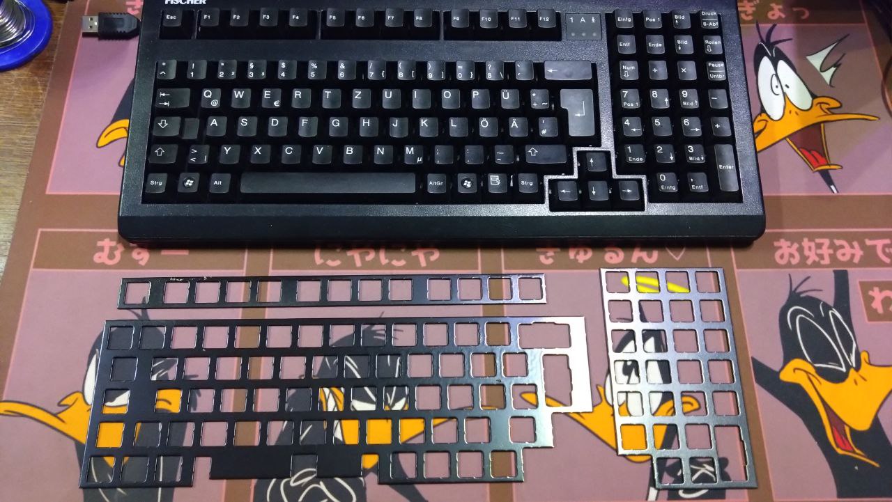

I have luckily bought three G80-1800 of the non-winkeyless variety unfortunetely, but they were quite cheap so i couldn't let them pass. I'm much of a clicky person myself so i have ordered some kailhua box jade switches to go along with them, i have only tried white version before so i really wanted to test these next. However the kailhua switches do not have the aligning pegs that are present on cherry black switches, and fit into the PCB's holes, so it is really tedious to align the switches correctly for soldering... if not impossible. Without a switch mounting plate that is. So i've drawn and made some, simmilar to what i made for my cherry touchboard.
There are three parts, because of how the case clamps on the PCB, there is no way to make a single monolithic plate for the whole keyboard. I had to experiment a bit to make them fit into those funky-shaped cavities that the case creates but this is a second try and this time they fit nicely. This made soldering the switches a blast. (apart from the part where i have to solder a jumper wire under every switch, because of how the PCB is designed. Original black switches have this jumper built into the switch.
I left about 1mm of a safety margin around the plates so that when you assemble the case, you don't run into issue when the halves are at an angle and have to clear the plates. It all clamps down nicely. The keys that have stabilizers aren't held from both sides with the plate, so you have to hold down those four switches for soldering. I found that my plate was interfering with the stabilizers a little bit otherwise, so i had to make room for them here. It's not a big deal though. I also didn't make the plate for the nav keys, because i like to keep those linear, for playing lots of older PC racing games. Plates are 1,5mm thick zinc-plated steel, painted. Keyboard feels a lot stiffer too after adding these. If anybody would be interested in those feel free to PM me, i could make a few more.

Really cool ! always wanted to mod on of those boards. They are probably the most common mechanical board in germany, so you can get them really cheap. The jade stems with the black case looks so good, what a shame you cant really see them :D

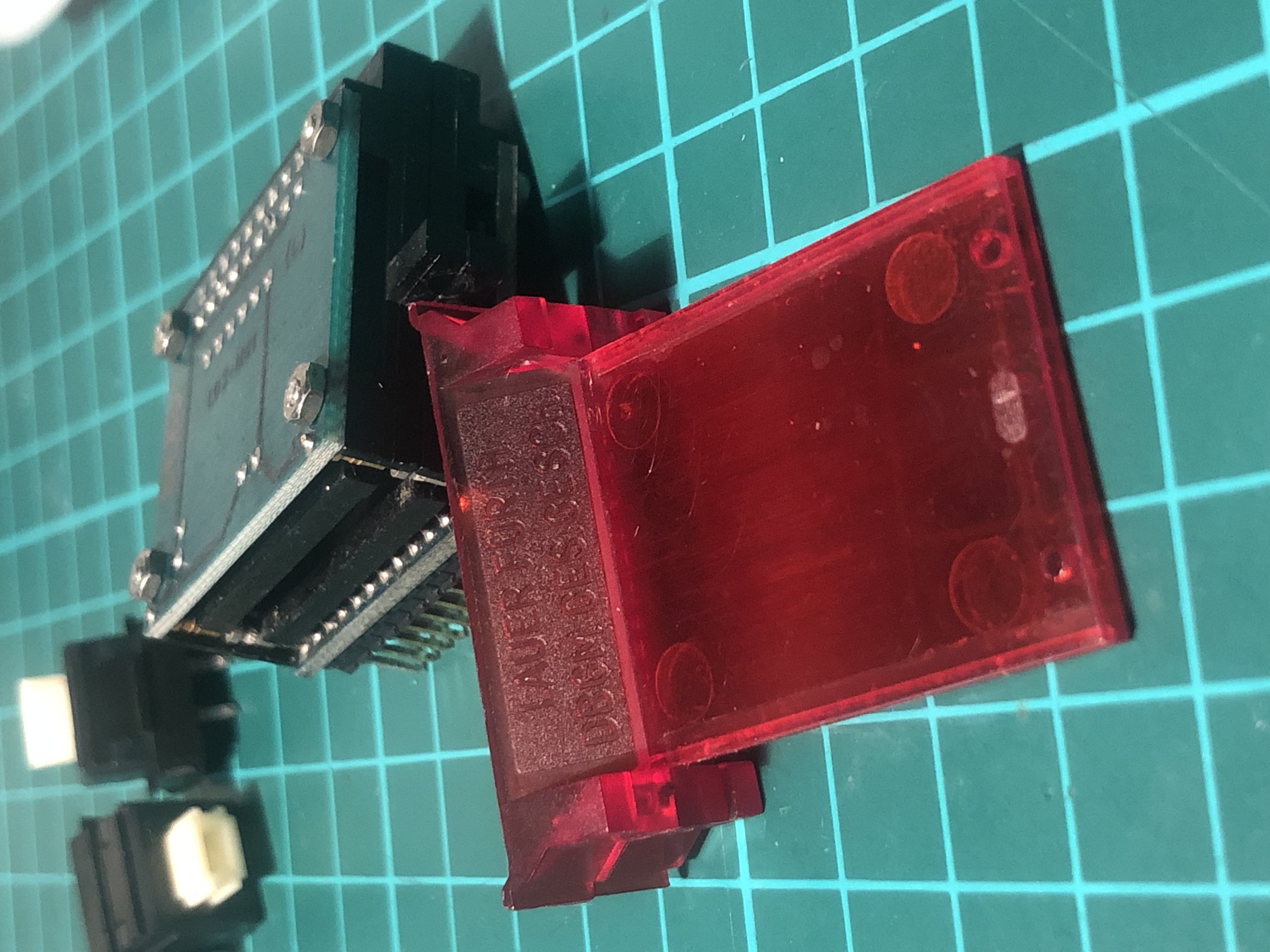

Bought those from germany :) I didn't get the version with the funky paper card reader they used in chemist's i guess, which i hoped for as the seller had pictures of these. I have to say i'm super satisfied with these switches, and the plates fix the creakyness of the case quite much :D

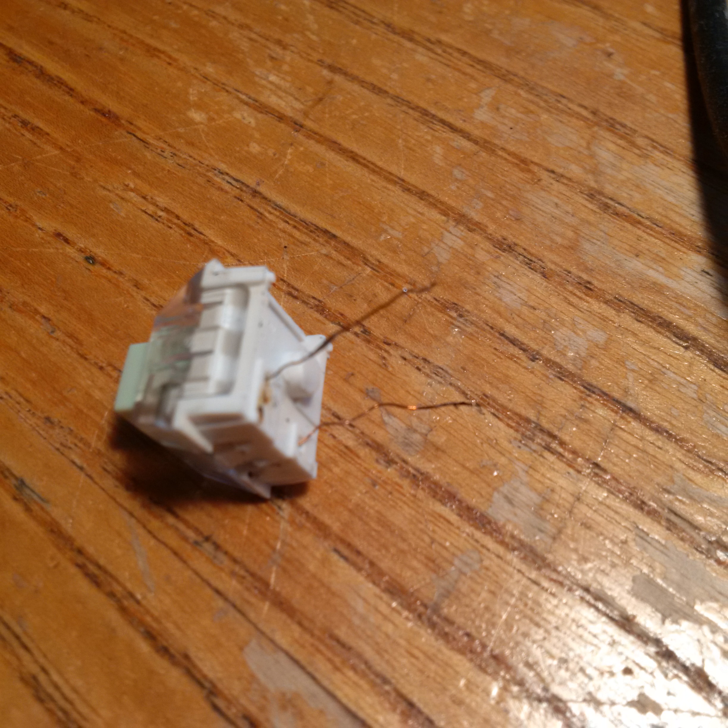

It ended up being desoldered, as I needed a stock of mx blacks to repair the various gaming boards all of my friends use & after I took the HAD Keycaps.
4 people at the same time in my friend group had spilled something onto their keyboards, all of them being steelseries 6gv2´s
A great gaming board, even to this day. Nothing fancy, no backlight, fixed cable, MX Blacks and a BAE.

Aw shucks, even desoldered, would've spared me half the work. I was just curious about this reader thingy. If you are ever interested in one of my plates let me know :) I also have a box of spare mx black's now :lol: wondering what to do with those, repairing gaming boards is a good idea, but i don't really have much friends who use boards like this. few of my friend's i've gifted some of my vintage boards. That steelseries board looks solid, i like how it isn't all over the top with the design and has an actual case of some sort.
Yeah, and that was before I had my Hakko, so all manual. Since the mx blacks had the diodes inside of the switch, it were 4 solder points per switch :?
If you are still curious about the reader thingy, it might be possible I still have the one that came with the board in the picture.

Yup i am curious and if it's able to work under normal pc. I find the layout very nice except those two keys, but i like numpads.

You seem to be in luck today, since I not only remembered I had it somewhere but also found it haha :)
You can have it if you pay the shipping.

PM me if you're interested. I cut and weld sheetmetal for living so cutting few of these isn't a big issue for me. ;)

Firstly, I notice that you’ve left a gap around the stabilized keys because the plate was interfering with the stabilizers. I’m wondering whether it might have been better to have added cutouts to the plate to enable Cherry plate mounted stabilizers to be fitted, and used them instead of the original PCB mounted stabilizers.
Or better still, you could have added cutouts to the plate to enable Costar style stabilizers to be fitted. In my opinion, Costar stabilizers feel a lot nicer than the Cherry equivalents. But for some reason, they’ve fallen out of fashion.
viewtopic.php?t=5872
Also, If I was going to the trouble of desoldering over 100 switches, I think I would take the opportunity to convert the keyboard to use hot-pluggable switches, by fitting some of the hot-pluggable sockets you can buy on Aliexpress and elsewhere:
https://www.aliexpress.com/item/1005004 ... h%21UK%210
I think I would also fit a separate plate to the cursor keys to ensure that all the keys have a uniform look and feel.

Those sockets are interesting, however i am not sure how would it work in this case, because here, there is no way to screw in the plate to the pcb. So you need some sort of strong mechanical connection to hold everything in place.
You are correct about the stabilizers! i might try to make a version for different stabilizers. actually i had in mind making a version with winkeyless layout, so i can modify my board. The arrow keys plate i didn't do because i like to keep my arrow keys linear (for playing older PC racing games) but it's not a problem for me to make it.

Well, a bit of an update:
photo_2023-09-17_17-18-20 (5).jpg (174.63 KiB) Viewed 78669 times
Here's a new version of the plate i designed with costar style stabilizers in mind.
photo_2023-09-17_17-18-20 (4).jpg (170.33 KiB) Viewed 78669 times

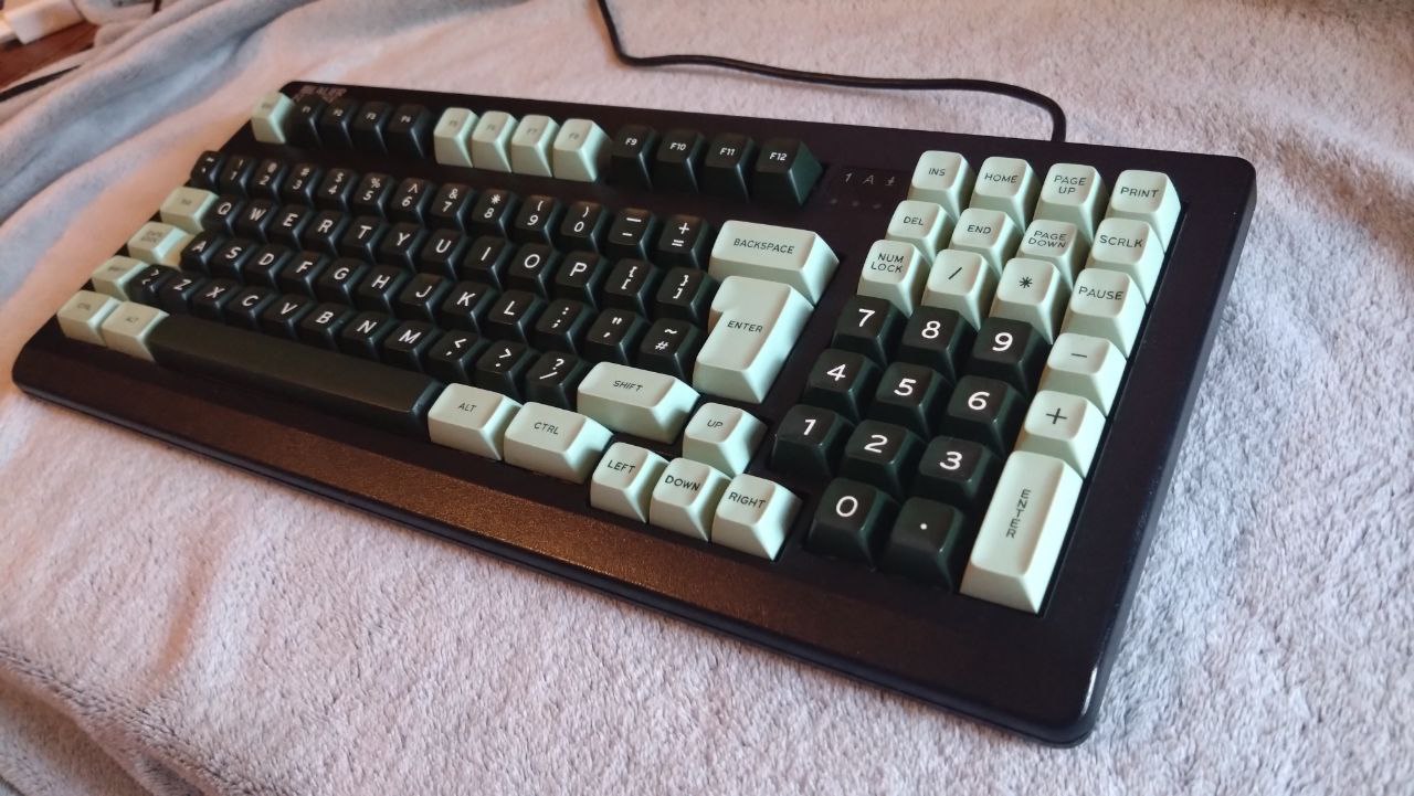

Also the key layout, i decided to change it a bit ;)
photo_2023-09-17_17-18-20 (3).jpg (156.06 KiB) Viewed 78669 times

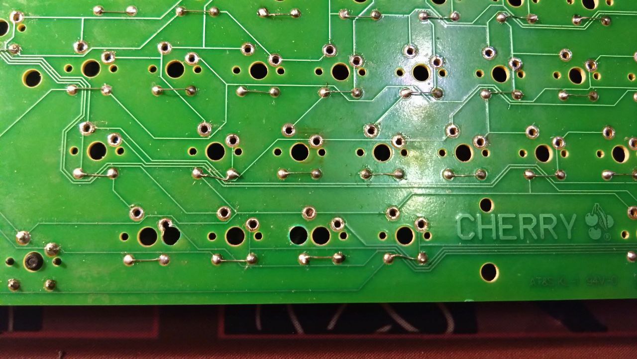

First i thought this would be good enough, but even those thin wires were interfering with properly assembling the plate with the pcb. So i had to figure out something else, Drilling in new holes for the contacts was a no-go as they would go right trough few traces in the pcb (i almost did when drilling extra holes for the centering pegs.) So...
photo_2023-09-17_17-18-23 (2).jpg (110.34 KiB) Viewed 78669 times

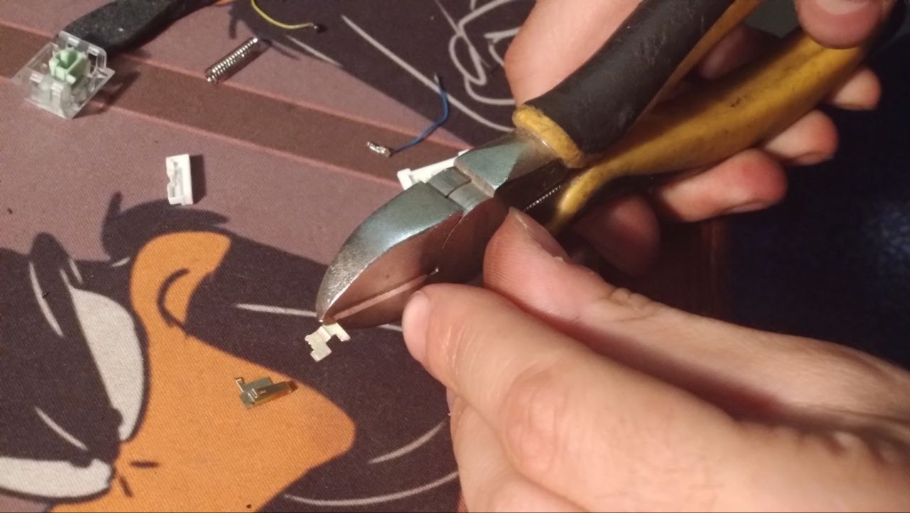

And some transistor core wire:
Behold! an extra-terrestial edition of kailh box jade switch with some spooky sensing appendages:
With that done i could properly reassemble the board like this:
The result is worth it i think, but i'll let You guys judge.

browncow
28 Sep 2023, 12:02
inozenz wrote: 28 Sep 2023, 08:24 really great work, good job. looks amazing!
Thank you! i'm sure you could do the layout mod a bit more elegant but this way was easiest for me
