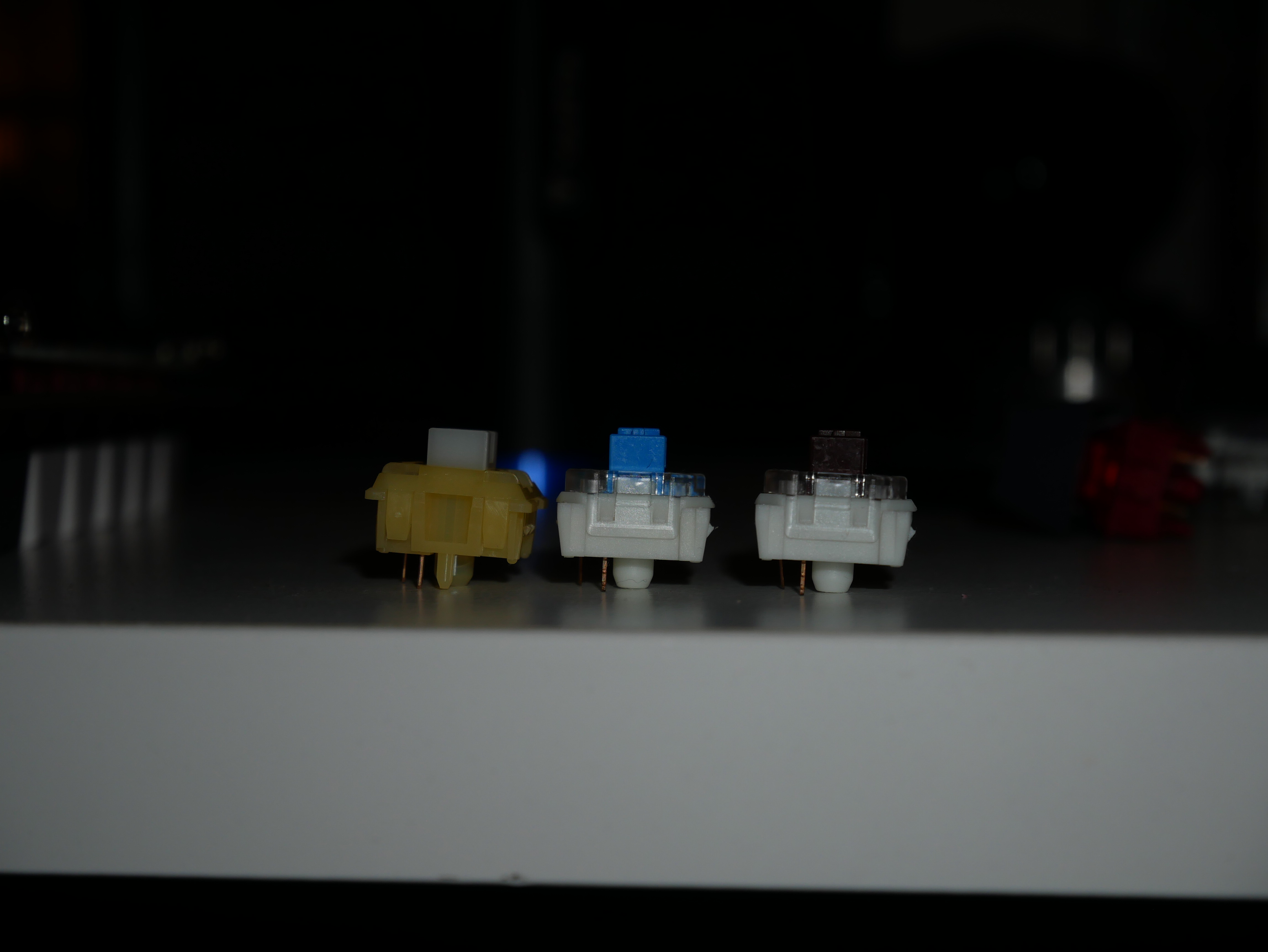

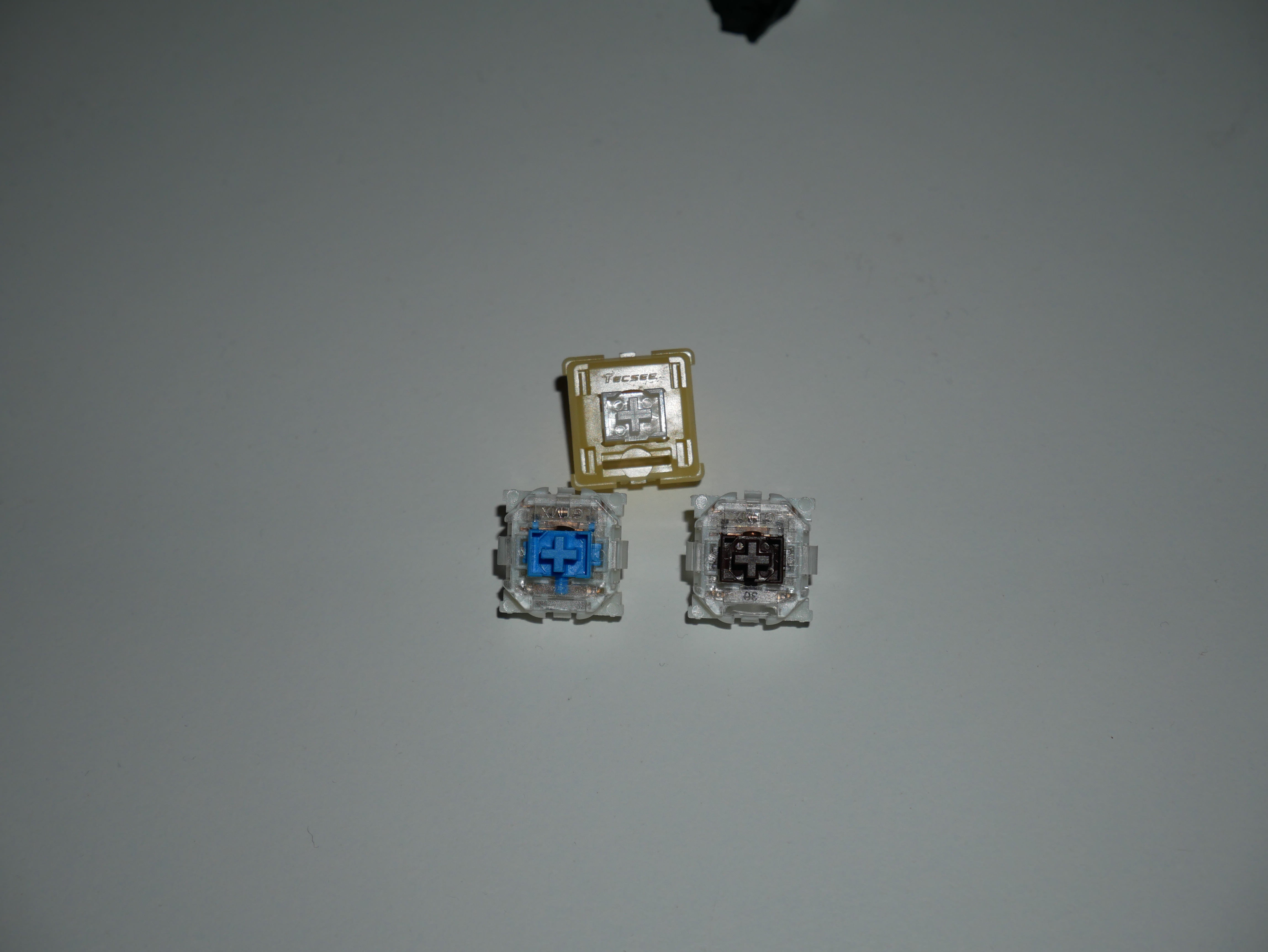

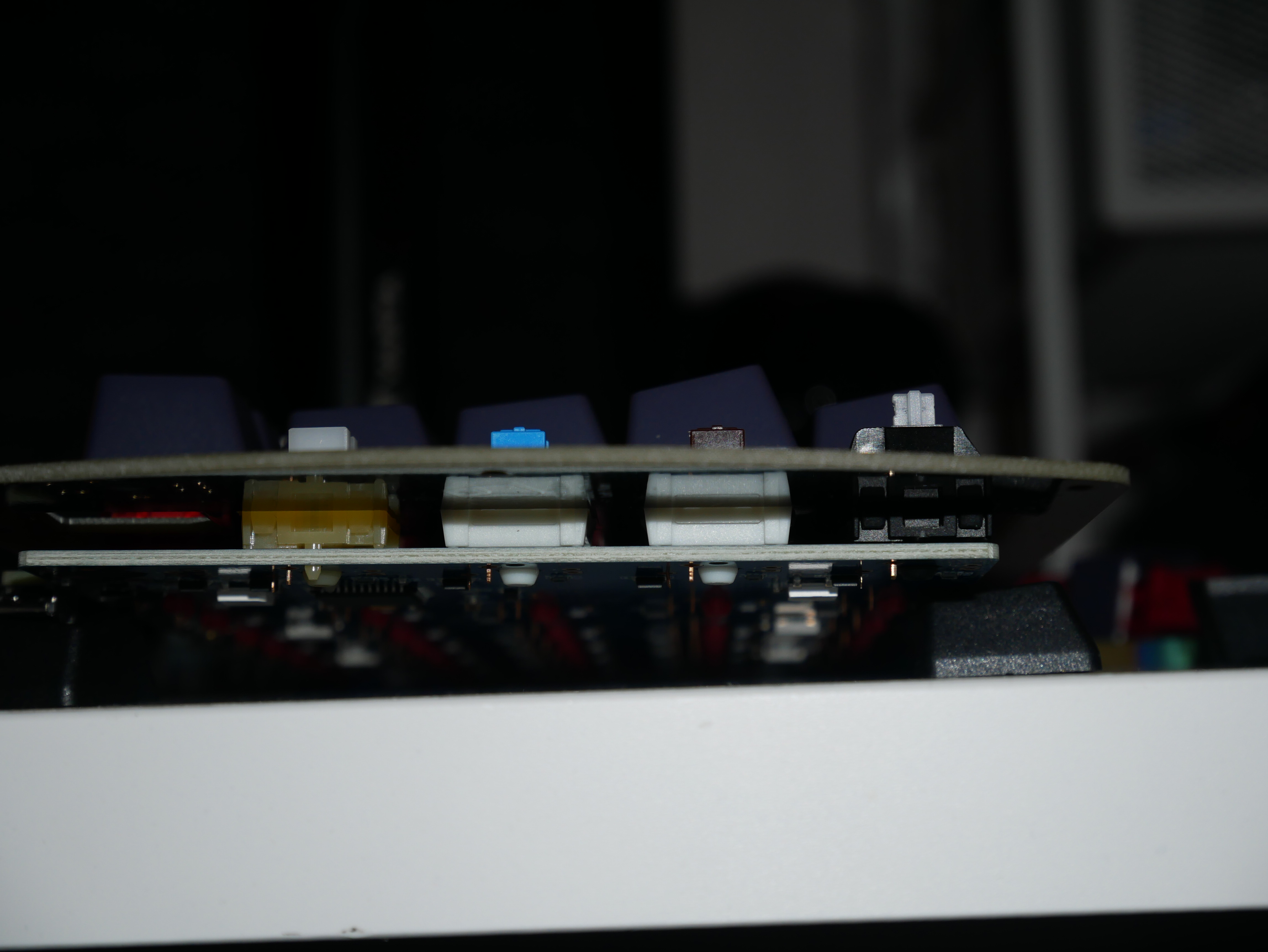

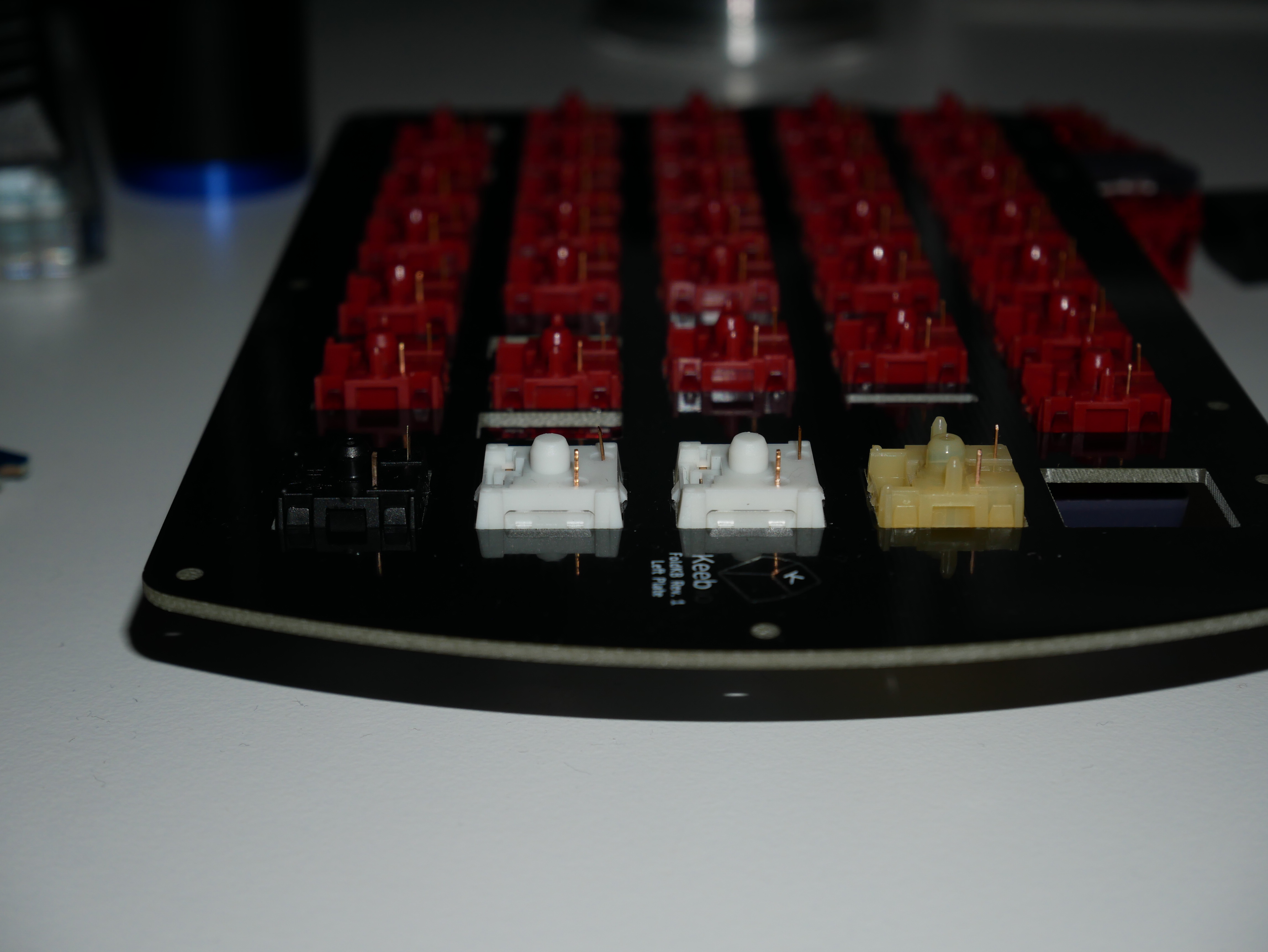

29 Jul 2024, 00:37
Findecanor wrote: 28 Jul 2024, 16:54 The Outemu switches seem to need the plate closer to the PCB (at 3.75 mm). (Or have you seen a variation I have not?)
Just checked, and as a matter of fact...
...these ones here do actually use a regular plate height!
wjrii
30 Jul 2024, 16:43
Tecsee medium, GTMX, or outemu half height are all roughly the same thing, with normal MX bottom halves. You can also shave a few mm off by using lower profile keycaps than the OEM on that macropad.
