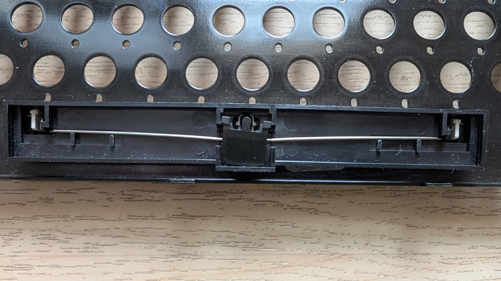

Just another question before I start another try in assembling an F-XT. The flipper of the spacebar goes on top of the metal bar, correct? Like on this photo?
DMA
11 Apr 2025, 03:49
I guess so - no other place to go, really. You should, however, remove all keycaps before attempting reassembly.

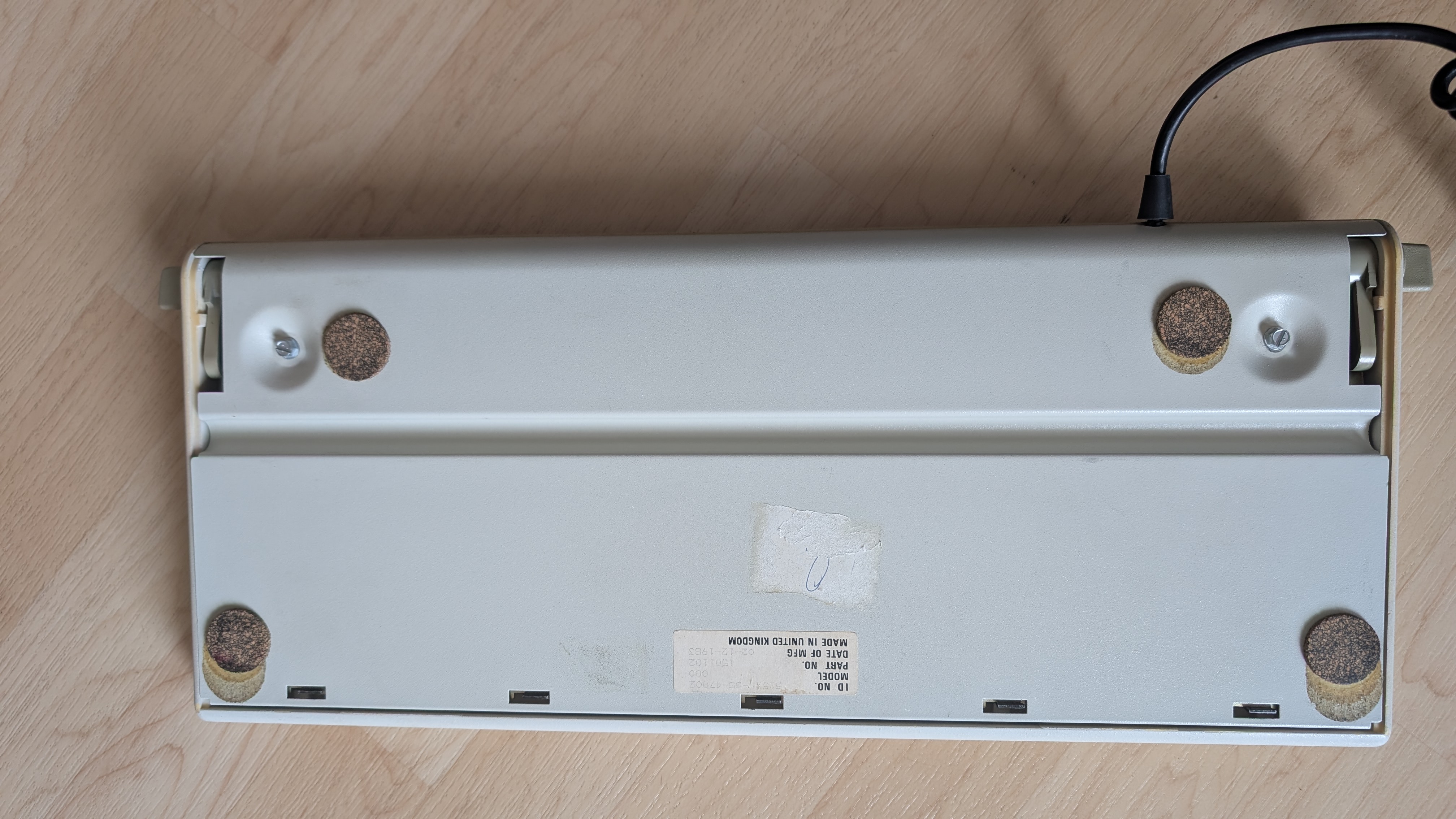

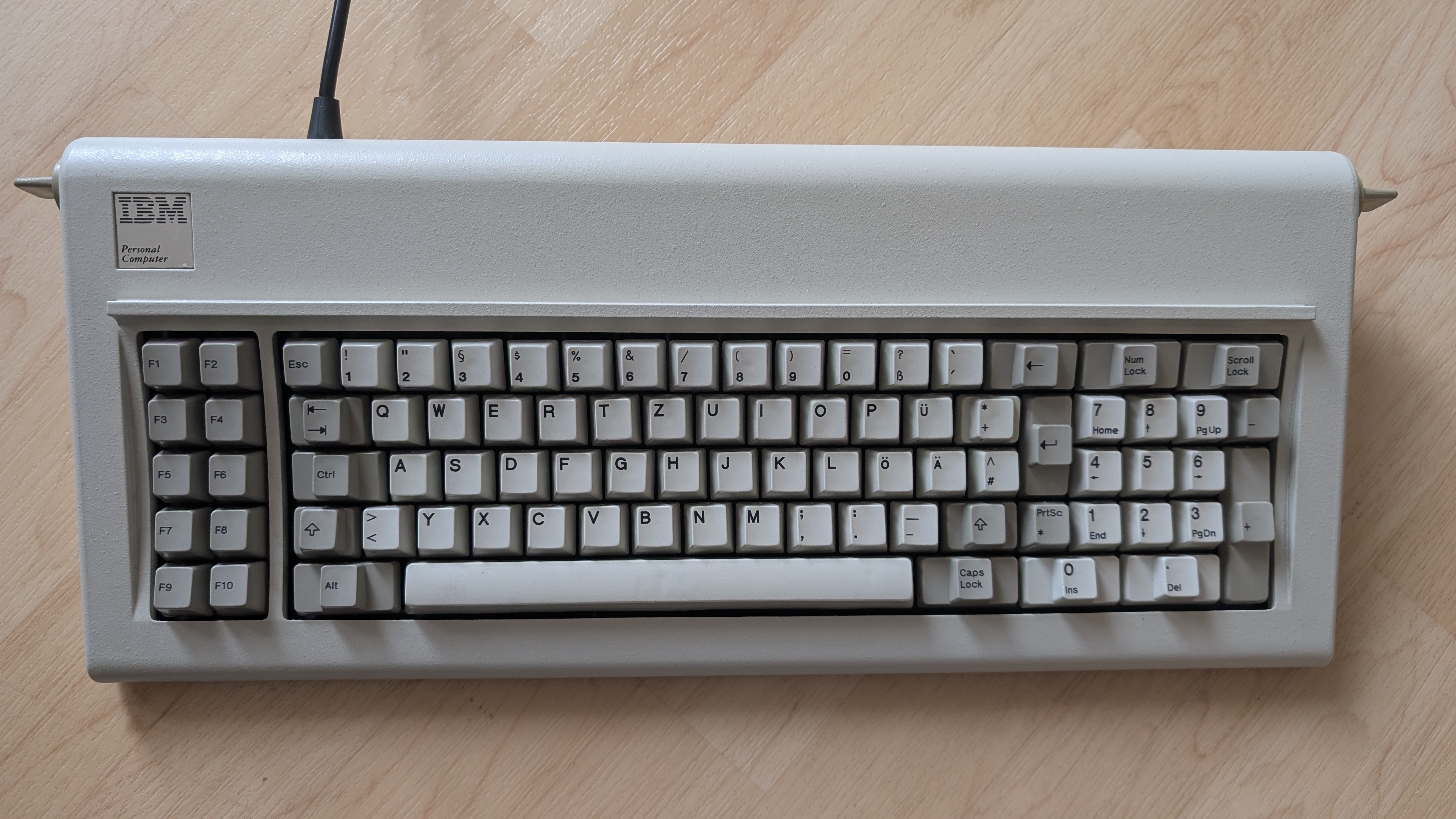

After postponing this project I gave this keyboard another shot today. Suprisingly the second try went without problems and in short time. Also after placing the keycaps the key test shows that all keys register including the spacebar. :P
Now this F is nice and shiny again. Admittedly I have to address the cork feets but for now I call this project finished.

JBert
28 May 2025, 00:31
DMA wrote: 11 Apr 2025, 03:49 I guess so - no other place to go, really. You should, however, remove all keycaps before attempting reassembly.
Keep the spacebar cap on though. Clipping in the stabilizer is next to impossible when the PCB assembly is closed up.
