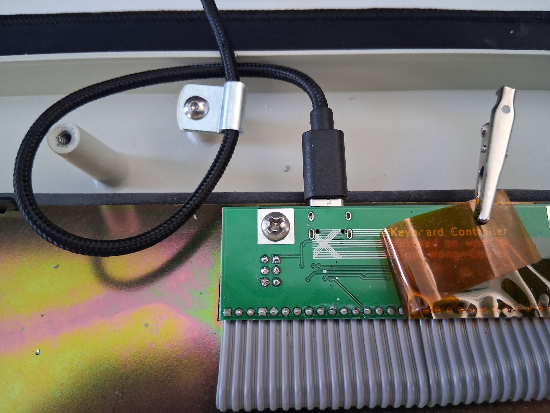

Another issue to check could be the grounding of the controller. Make sure both bolts are tight. I've seen odd behavior when these bolts are not tight enough.

I think we figured it out.... you are close, but doing the opposite ended up fixing it: loosening the 2 screws on the controller will cause the symptoms to go in and out.. so there is also a bad solder on the controller somewhere; All of the solders on the ribbon's appear to look good. The solder in question is one of the 6 solders right under the screw that holds the controller in place; I bet that is the weak point and the reason why loosening the screw fixes it as it unflexes the board and reconnects the short somewhere.
I have a really good solder sucker so I should be able to redo this without an issue.
HOPEFULLY this fixes it. It took me a minute to figure it out because 1 of the screws holding the controller was actually alittle bit loose, and now i see why. And when I was putting it back together for the first time I screwed the controller in so it was flush (which wasn't even that tight.. maybe finger tight at best). And after i plugged it in and started loosing the screws the keyboard worked again and I realized that screw couldn't be on too tight or too loose.

As I mentioned in the manual, on some keyboards the controller was not aligned correctly with the bottom inner assembly's ears and so it produced a short. The manual shows how you can push the controller back into place so that the ground plane square on the controller lines up with the square of the bottom inner assembly ears.

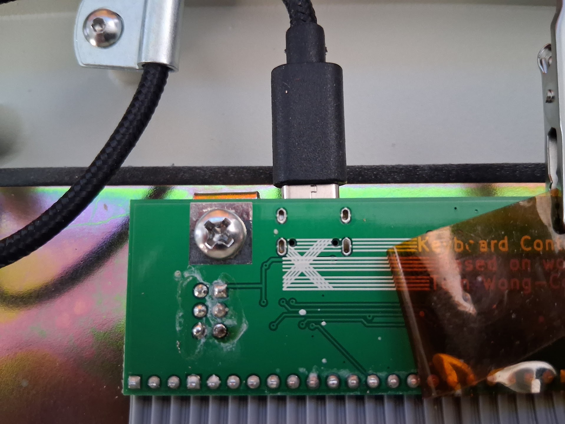

I did the right bottom hand corner already before I saw your message to take pictures, but the bottom right hand corner originally looked to not have enough solder in it before i added more to it: However it may have not been the problem because it was still having the same issues even after i put solder into it:
I am not 100% sure which one was causing the issue so I just redid the solder to all 6 of those pins and cleaned it up with some alcohol afterwards and it seems to have done trick with fixing the issues to a point to where it didn't matter how tight or loose I screwed in the controller.
So it might be fixed for good now (hopefully):
