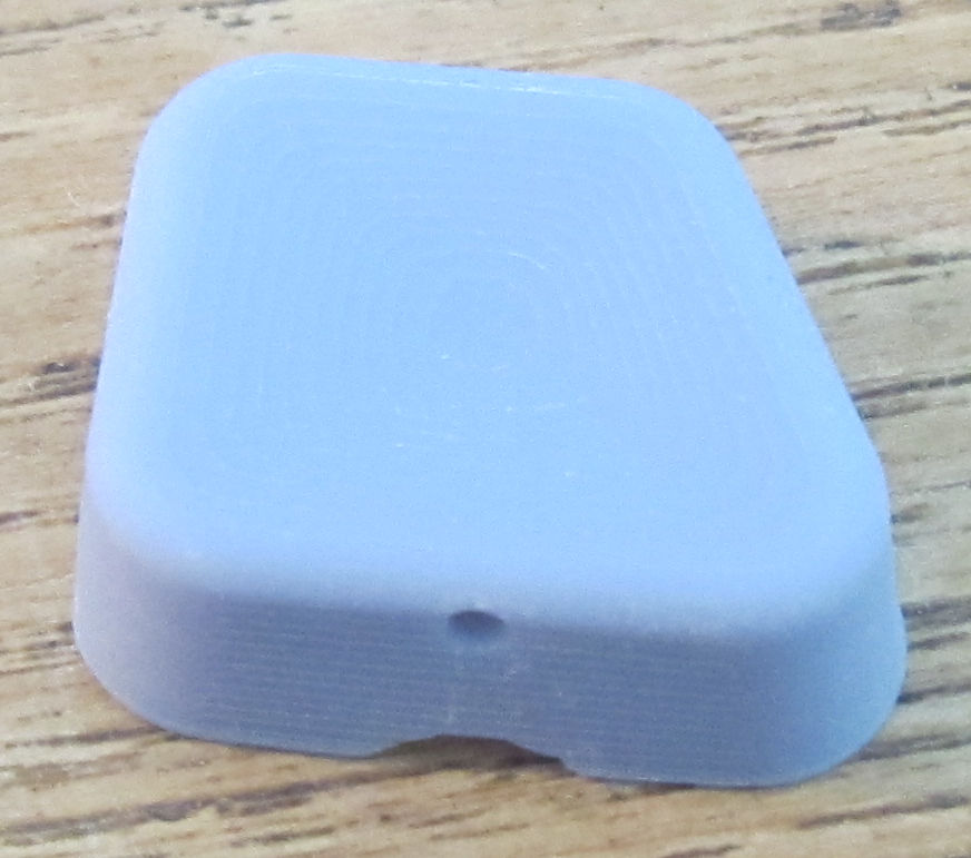

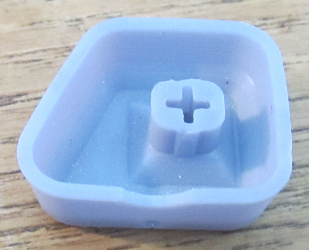

Resin casting needs a mold. That is often 3D printed. In such a case, one can just 3D print the keycap itself. FDM/FFF 3D printed keycaps do not look that well but mSLA 3D printers are cheap and provide a good result.
Here is a sample mSLA 3d printed keycap. Resolution 50 µm. No antialiasing, i.e. you can see layers in the prints. If you mind the quantization to 50 µm then just use antialiasing.
