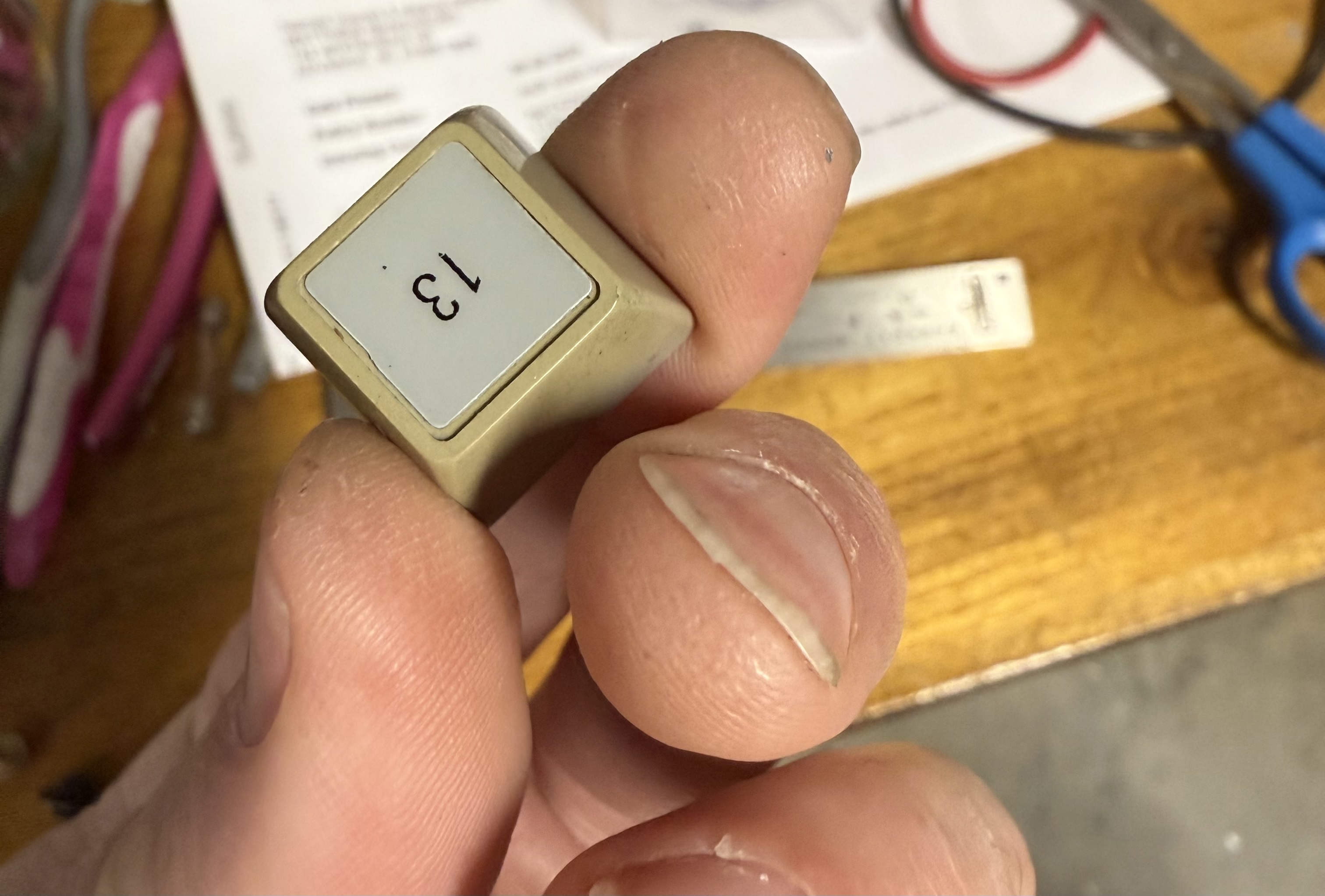

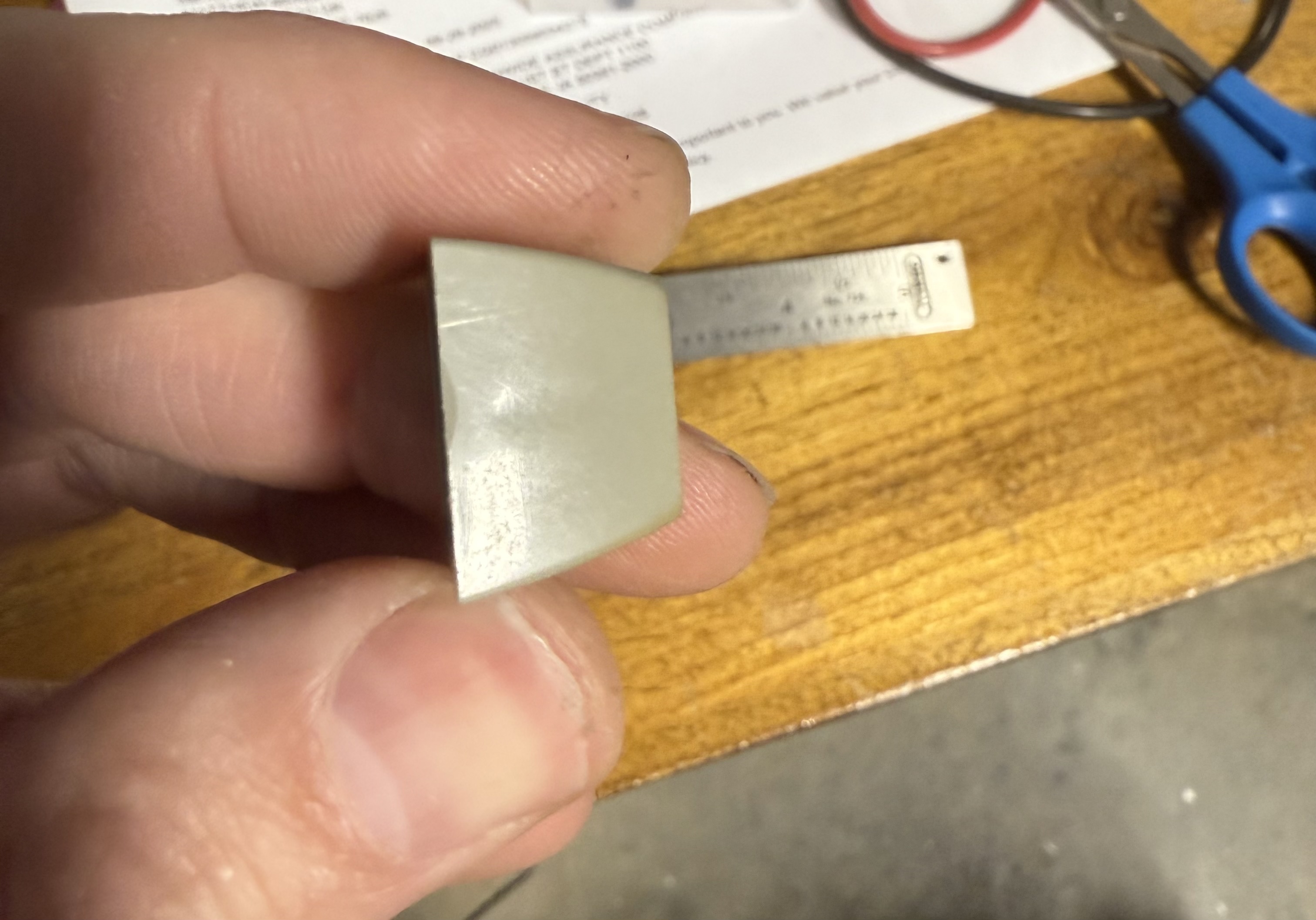

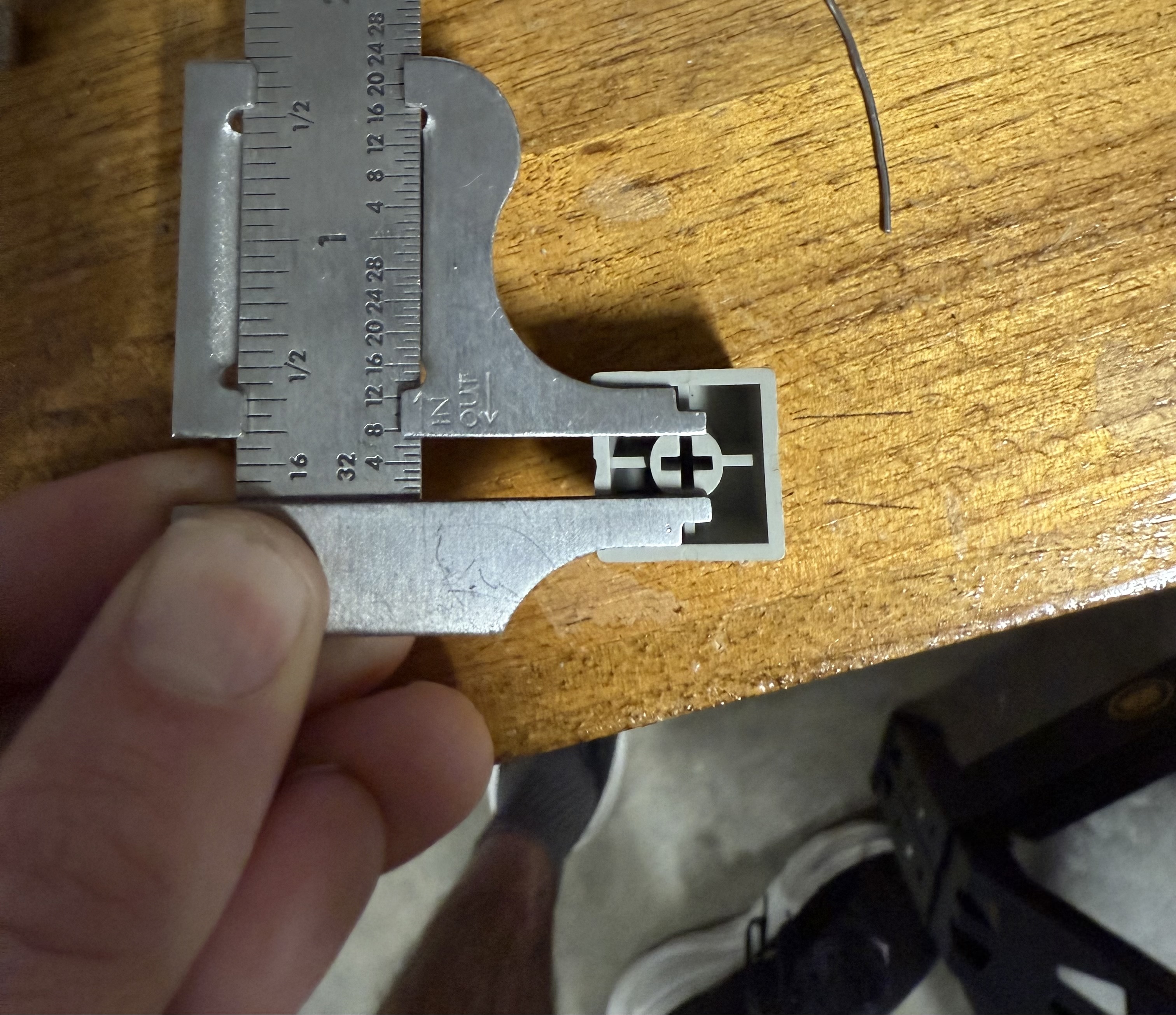

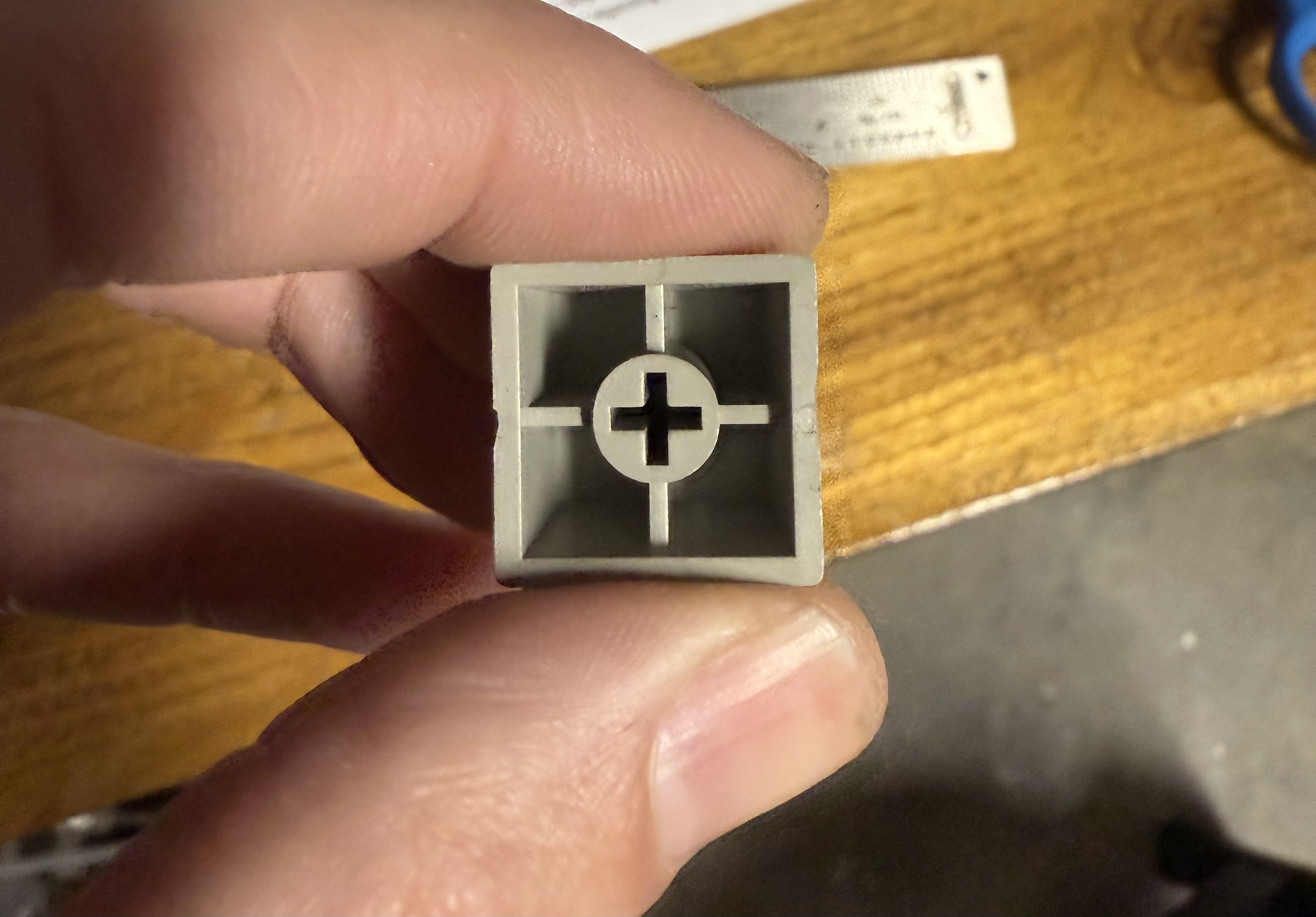

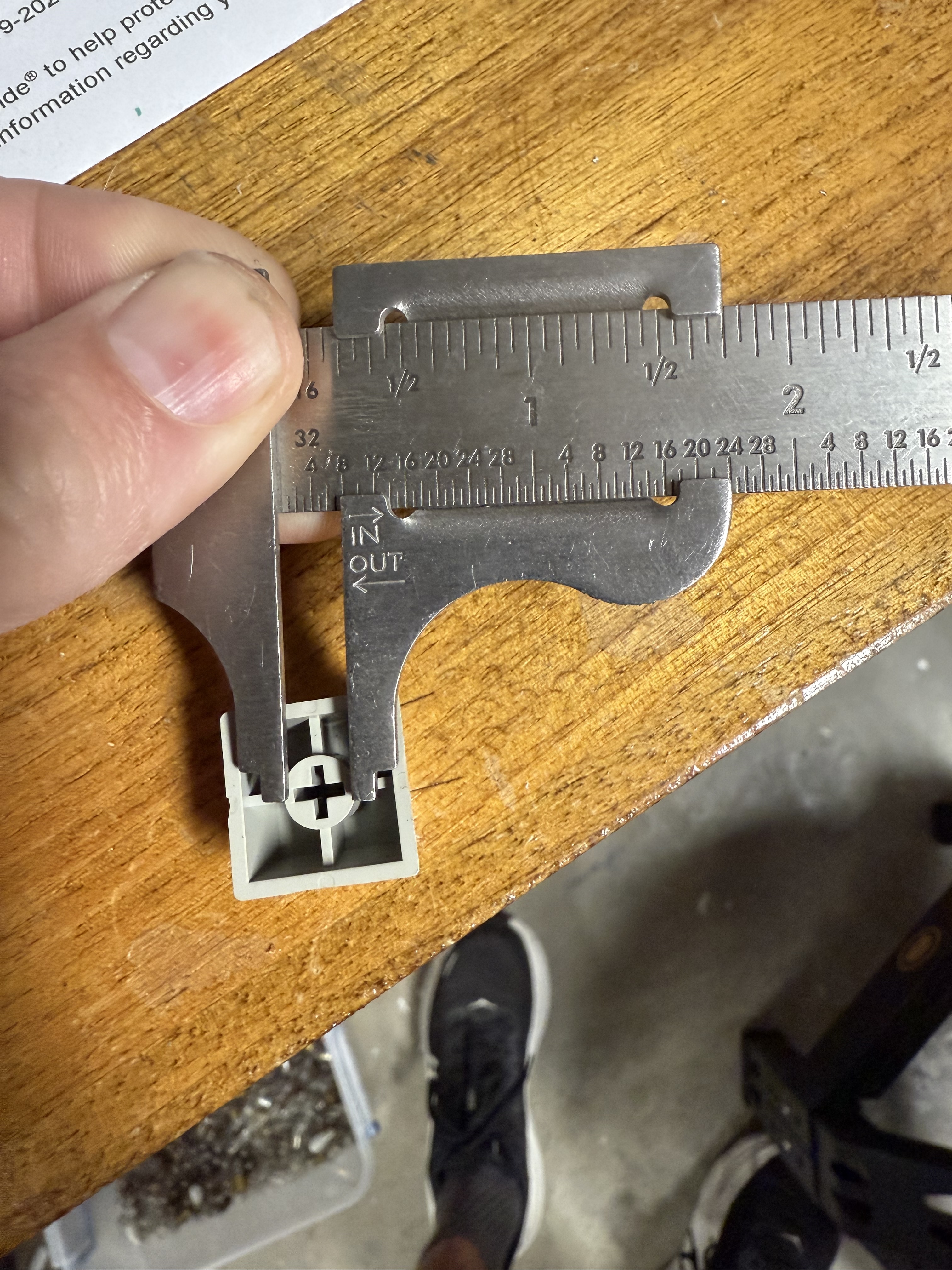

Hope you guys can help me because I am having a terrible time identifying this keycap for 3 needed replacements. This was on a Gottlieb pinball playfield simulator and used for the switch matrix input switches. Mine is missing 3 keycaps and I can't seem to figure out what style it is. It's like cherry with the crosshair, but larger at about 7mm.
Any help greatly appreciated.
Help Identifying this Keycap

Those are SMK re-legendable key caps. The clear cover is missing.
