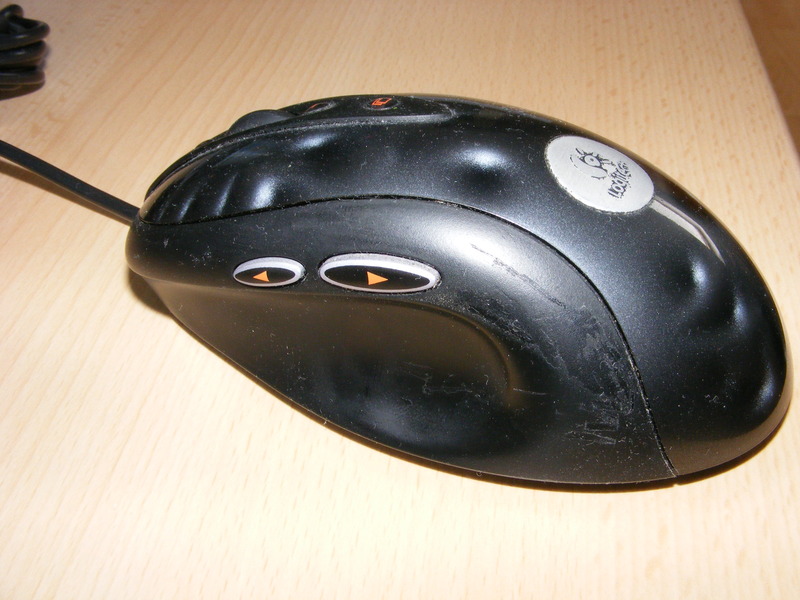

I've just painted my old Logitech MX518 completely black. I bougth the mouse in 2005 and used it till May 2012 on a daily basis.
The mouse was technical functioning like the first day, but it started to look horrible: The black soft-painting on the side started to go off and the painted metal with the Logitech logo lost its painting:
Logitech MX518
Logitech MX518

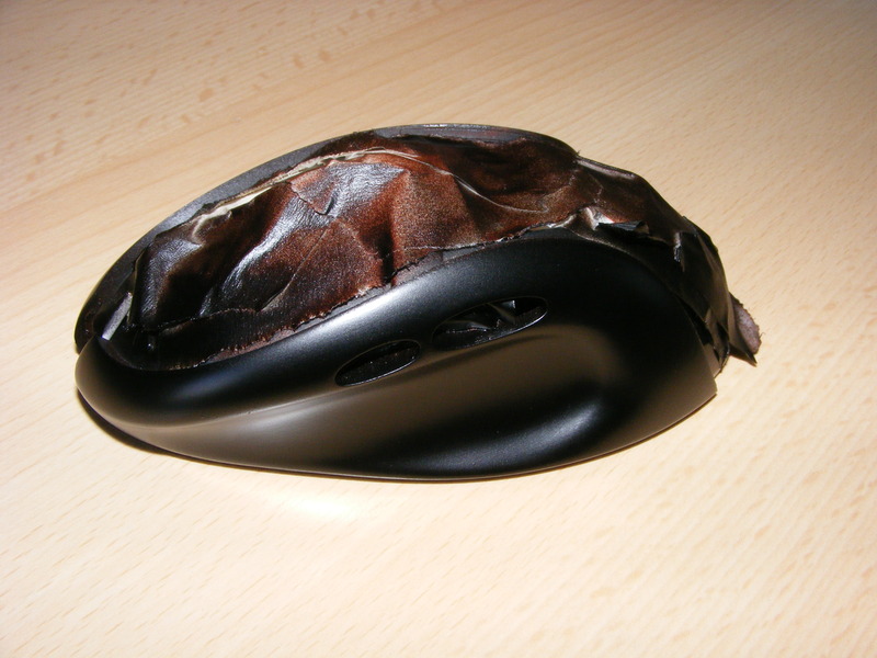

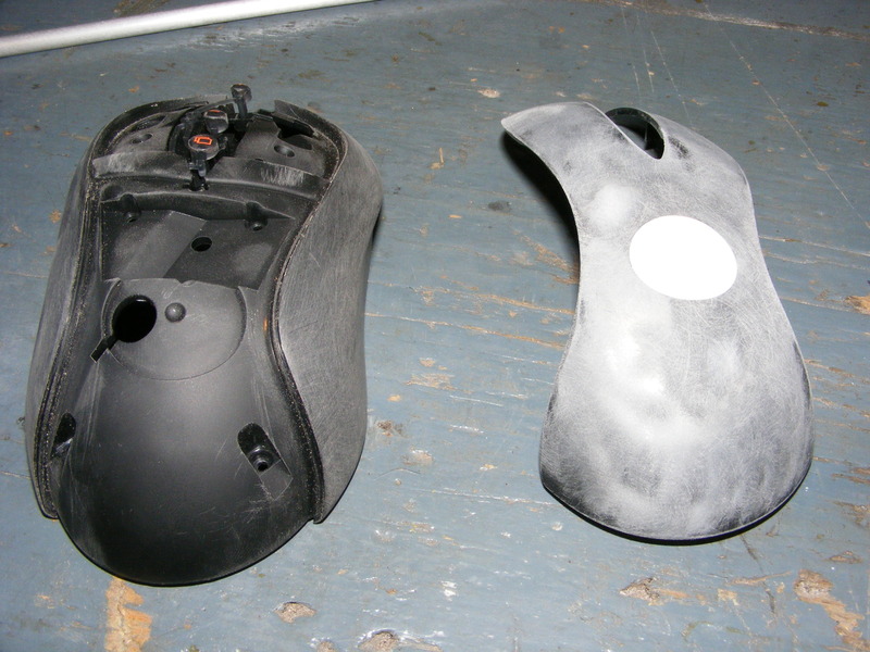

After disassembling the mouse I used some body filler (I don't know the exact English word, but it is normally used on cars if there's a big scratch or rust) to close the hole caused by the removed Logitech logo and removed the soft-painting with sandpaper:
Logitech MX518
Logitech MX518

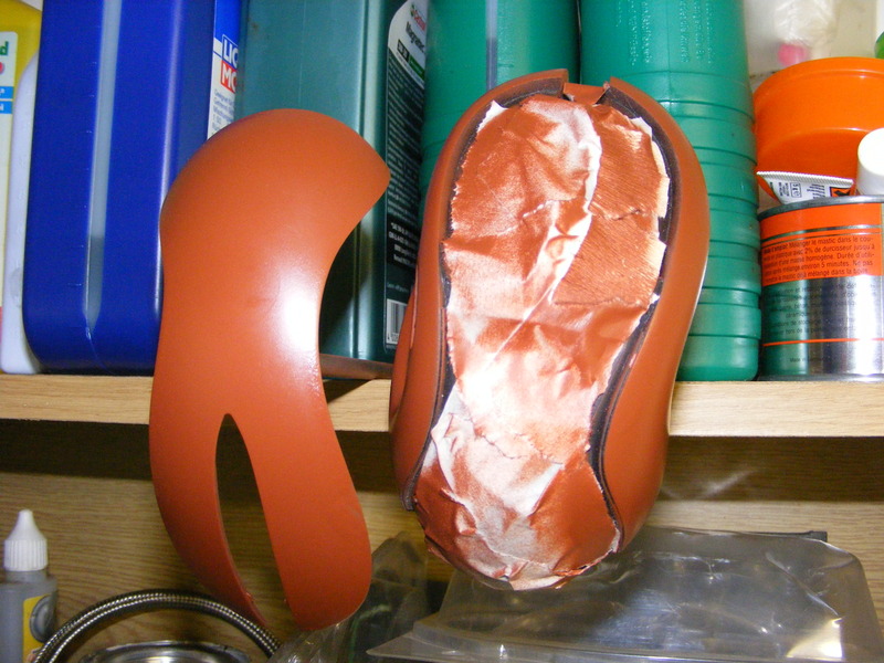

Then I painted it with primer and let it dry for a week:
Logitech MX518 Primer

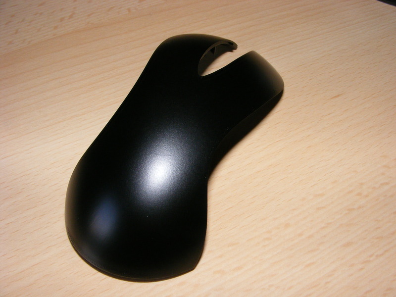

After that I applied two layers of black paint (Innotec Black BodyPaint). I waited one week to apply the second layer.
Logitech MX518 body painted
Logitech MX518 top painted

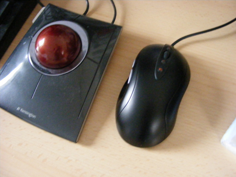

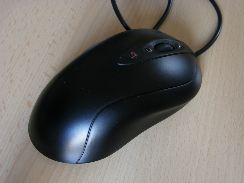

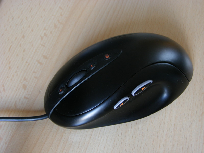

In the end I put all parts together again:
Logitech MX518 black side view
Logitech MX518 black top view
All in all the paint isn't that good as I would want it to be. Because it doesn't went that well especially on the edges where I didn't sanded assiduously. However I'm happy with the overall result. :-)
