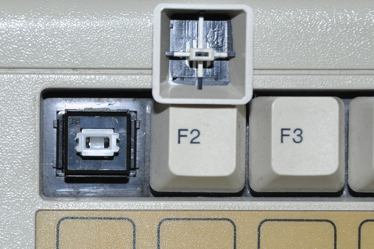

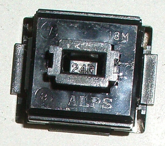

Icarium wrote:Care to share why you think it's a clone?
It looks like something is stamped in the slider. Alps never had that.
13 Oct 2012, 21:53
Yes they did:
Dell AT102W black complicated switch
Dell AT102W switch.jpg (78.18 KiB) Viewed 9409 times
Also, Fukka clones are reported to have had the Alps logo on, but mine certainly don't (TP3). They do have the same long side tabs as complicated switches – Fukkas look (nearly?) identical to complicated switches from the outside.
The switch in the OP is a Simplified Type II (e.g. XM) or a Type IV. They're the ones with the four small tabs. (I forget what Type III looked like — the pictures died along with the GH wiki, while I have Types I, II and IV myself.)
The only way to tell Type II from IV is to open the switch, and they're a real headache to reassemble (I'd be more tempted to take some better photos of the Type IV switch, but it was a real pain to get it back together last time, and the GH wiki had better photos at the time anyway ;-) Since people assume that four small tabs == XM, I don't know how many Type IV keyboards are mistaken for being Type II, or whether Type IV was just really rare.

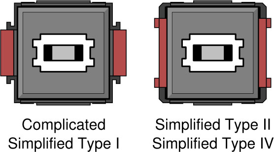

OK, here you go:
Alps recognition.png (21.03 KiB) Viewed 9308 times
Type II ("XM") and IV are completely identical from the outside — you have to open the switch to differentiate them. I don't have a complicated switch to hand to measure it in comparison to Type I, but I have no good reason to believe that they differ, and again, you have to open the switch to differentiate them.

Daniel Beardsmore wrote:
Yes they did:
Interesting, I have seen many an Alps board but none I had ever seen until now had anything printed in the slider.
If these are stamped on similfied, that might explain it. I have never owned a Fukka Alps board, I deal in mostly the original Alps stuff 80's-90s.
15 Oct 2012, 14:16
Type II and IV simplified both have a number stamped into the slider. The Dell AT101/102W (above) uses complicated black switches though, i.e. some complicated switches have numbers stamped on the slider as well.
My new theory is that Types II and IV are both Xiang Min ("XM") switches, and perhaps the Type IV came first, as XMs are current, and my old XT/AT board is Type IV. I'm considering renaming them XM wide leaf and XM narrow leaf. Matias confirms that Fukkas ARE real – Forward Electronics is what was Alps Taiwan. This is why I don't use "Fukka" unless I'm certain that they were made after this point in time. However, it may be the case that Alps only made one simplified design, and that's it. In which case, we'd have: Alps complicated, Alps simplified (includes Fukka), XM wide leaf, XM click leaf. Matias thinks Type III was similar to XM, so it could be another XM switch. Need to check archive.org copy of GH Alps wiki to check the photos.

✱✱✱ CORRECTIONS TO ALL OF THE ABOVE ✱✱✱
For anyone a) reading this page in the future (hi future people!) and b) actually reading this far down past all the misinformation above, this is the new recognition chart:
http://deskthority.net/wiki/Z_mount_recognition
