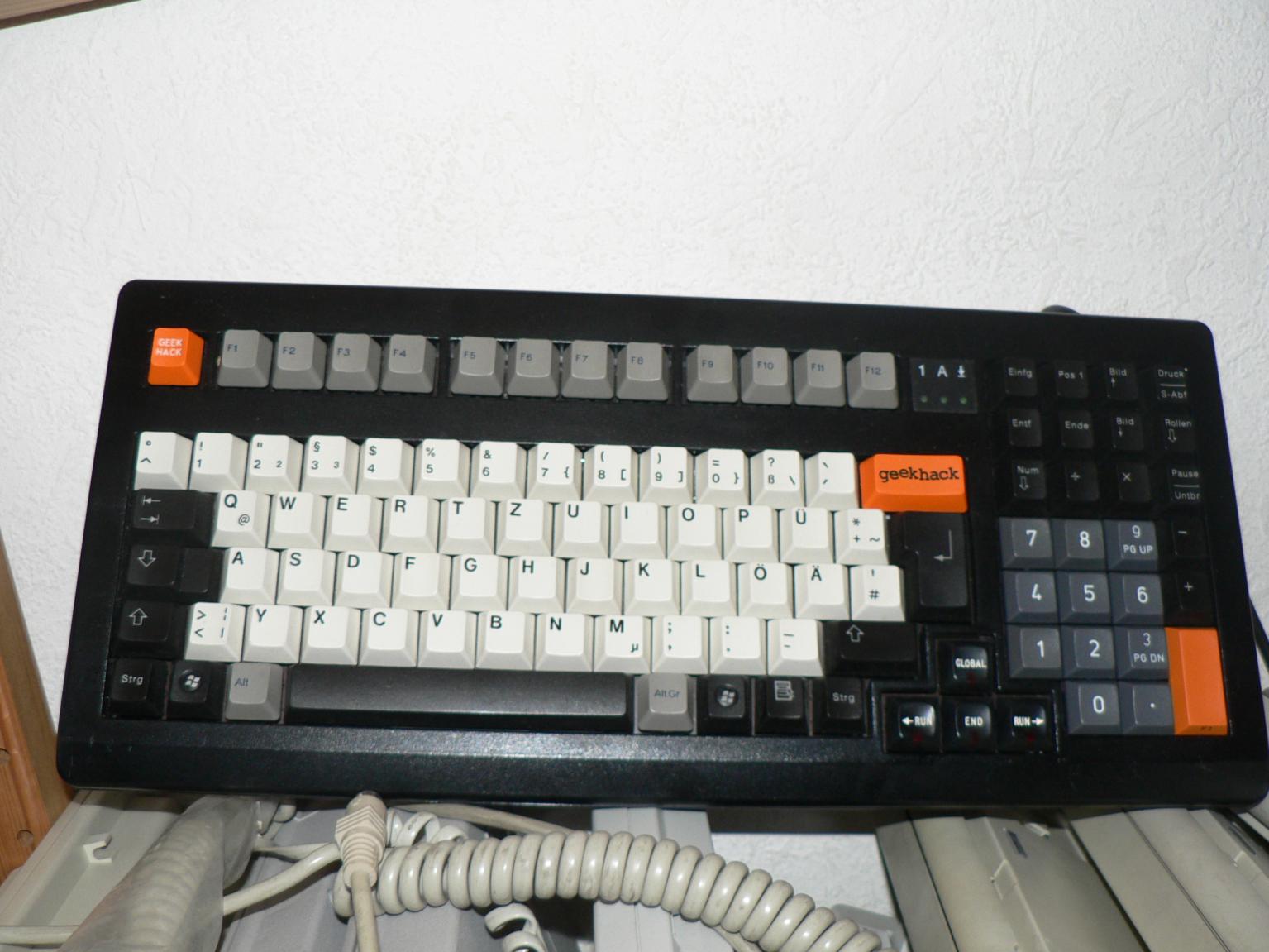

Have you considered a Cherry g80-1800? It is not really TKL, but still is rather compact with the compressed layout. Here is a pic of one of my boards:
There are ansi versions available, as well as versions in the classic cherry greys/beige coloration or pure white versions via Taobao. I am assuming you're american since you haven't made any comment on your location (hint: add it in your profile, it helps).
If you are actually from europe and are in need of an ISO layout 1800, I can help you out, I have several spare beige 1800s with doubleshots. Also, there is the g80-11802 (compaq) that uses MX Brown switches, which pop up on ebay regularly.
