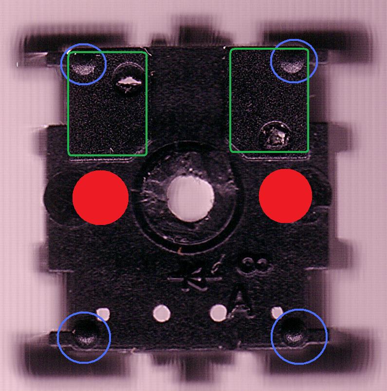

This is bottom view of Cherry MX switch lower housing.
Mine
Mine
Bottom 1.jpg (100.99 KiB) Viewed 10534 times
Red dots are the (very) first source of all keyboard noise.
Blue circles are legs of MX switches. Two of them are very short (in the poto upper two) and other two are relatively long (in the poto lower two).
Green squares are little bit higher bottom.
All other areas are real (they say) bottom.

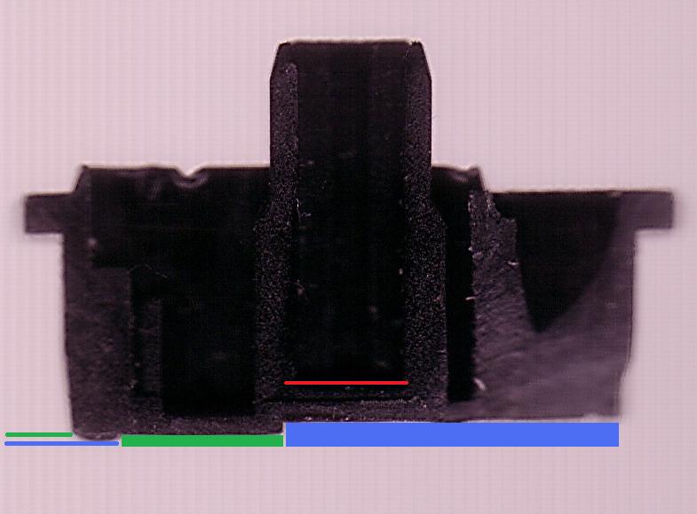

This is side view of Cherry MX switch lower housing.
Mine
Mine
Lower Housing Profile 1.jpg (41.73 KiB) Viewed 10534 times
Red line is the (very) first source of all keyboard noise.
Blue area is empty space between PCB. I consider it as a second noise source. It acts as a resonancer and amplifier.
Green area is relatively small. Exactly do the same role as blue one.
There are no other empty area.

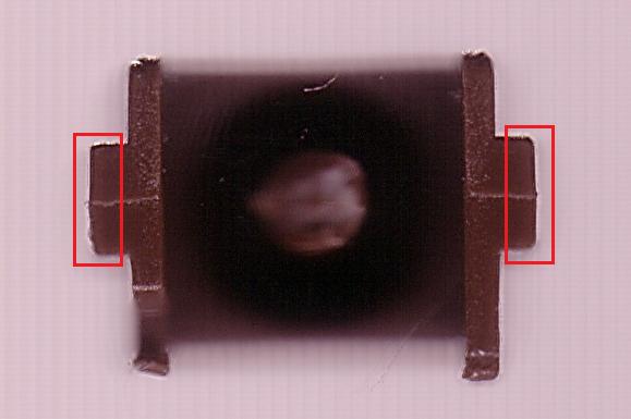

This is bottom view of Cherry MX slider.
Mine
Mine
Slider Bottom 1.jpg (20.08 KiB) Viewed 10534 times
Red squares are the (very) first source of all keyboard noise.
The other slider bottom areas are not contact with MX swithch lower housing bottom.

If you really want to kill unwanted noise, try to fill the blue gap (and green gap) between PCB first.
I recommend a thin (special shaped) tape/paper/sponge or some kind of composite material bubbles.
