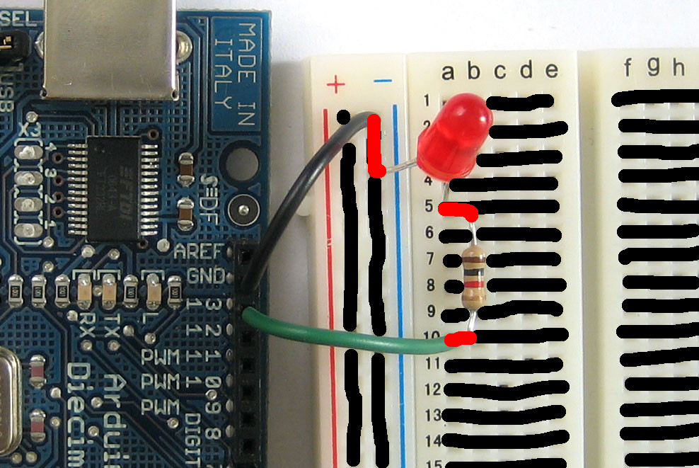

Can anyone point me to a good tutorial about breadboards. I'm wiring my arduino to them for projects and I'm understanding the code part but I can't get my head around why I'm putting the wires in the breadboard in certian places.
RC-1140
09 Dec 2012, 12:18
what do you need to know? Usually the connectors of a breadboard are connected horizontally, with maybe two lines of pins connected vertically. So you place VCC and GND on the two vertical ones, place the Arduino in the breadboard, and can access the pins of the Arduino on the connectors next to the Arduino pins.

I don't get why this is wired like this at all.
Apart from soldering, I'm very new to any electronics.
RC-1140
09 Dec 2012, 12:31
as I said, the + (VCC) and the - (GND) lines are connected vertically. The lines 1,2,3 and so on are connected horizontally. So 1a-1e are connected, 2a-2e are connected and so on.
You connected the GND Pin of the Arduino to the GND line of the breadboard. Then you connected the LED no the line 5. Also connected tho the line 5 is the resistor, which is connected to the line 10. Line 10 is then connected to the output pin of the Arduino.
RC-1140
09 Dec 2012, 22:41
Here's a small quick picture which shows which connectors are connected with each other. Red is the way you connected the parts with eachother:
