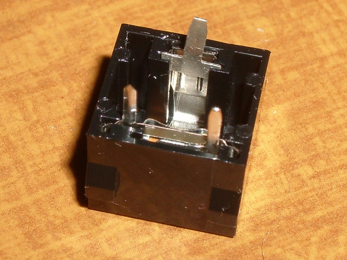

You can see from the photo on that page that these have three legs and two PCB mounting pins. (Nowhere does he say how you're supposed to put them into the Guitar Hero controller PCB that only has holes for the normal legs.)
The third leg goes into some dummy piece of metal:
Mystery Alps clone legs.jpg (180.14 KiB) Viewed 2417 times

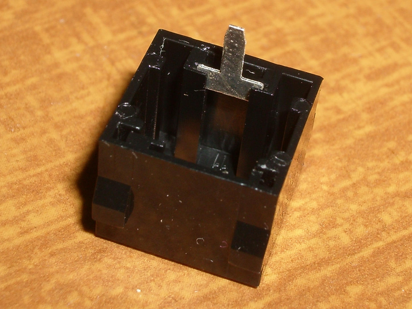

From what I can tell, it doesn't do anything:
Mystery Alps clone third leg.jpg (211.22 KiB) Viewed 2417 times

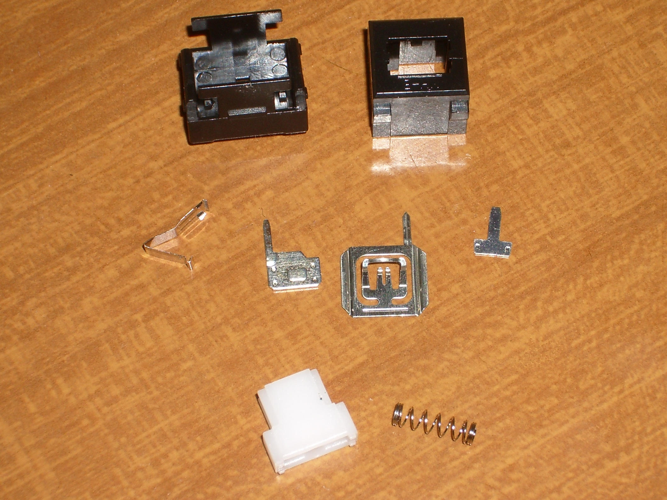

All the parts:
Mystery Alps clone parts.jpg (472.21 KiB) Viewed 2417 times
The numbering on the upper shell does not resemble Xiang Min KSB switches. The writing reads "YH-B", which looks to be a consistent marking of some kind. This turns up nothing.
The front contact plate is a very close match (but not exactly the same), but the rear contact plate is a derivative. Also, all the parts are bright silver colour, instead of a brass rear contact plate and a copper click leaf. Also, the click leaf is a different shape in several ways.
This is not a Taiwan Tai-Hao APC series switch (they're very distinct). It's likely not a Xiang Min KSB series switch either. If it was, they wouldn't deliberately sell one with fixing pins and the wrong number of legs.
Who makes it? Don't know. Hopefully the Guitar Hero Repair guys will say. Sadly, it doesn't match anything on Alps.tw's huge page, so it won't solve any of those regardless, although it may offer a lead to follow.
(Once I have a good idea of whether this is a real keyboard switch, I'll see if I can manage some proper photos for the wiki; the ones above are terrible. I also notice that the four tabs on the lower shell look to be far too small to support plate mounting, so this may indeed by meant solely for PCB mounting, and the vestigial tabs got left over.)
