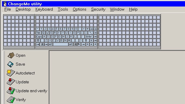

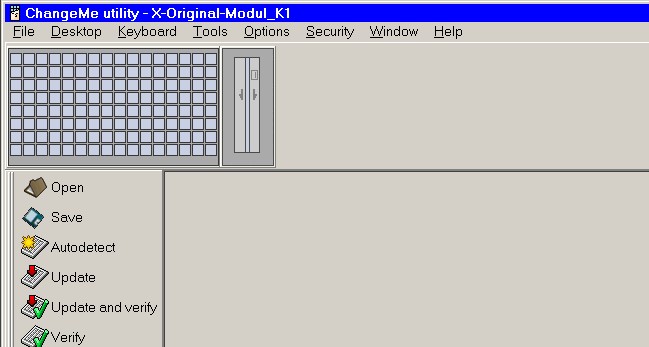

On their PCBs all units have 2 connectors (one on either side) for their internal connection ("Tipro Bus). Obviously the controller/program identifies what is connected where.
As a matter of fact, every time you open ChangeMe, it scans your keyboard and displays its actual physical configuration, for example:
or even:
Whenever you think it's not possible - Tipros do it :lol:
