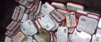

03 Aug 2013, 17:35
I've seen some nice projects done with them. But, nah, too squishy. I don't trust a box if I can't stand on it. Because sooner or later I will anyway.
