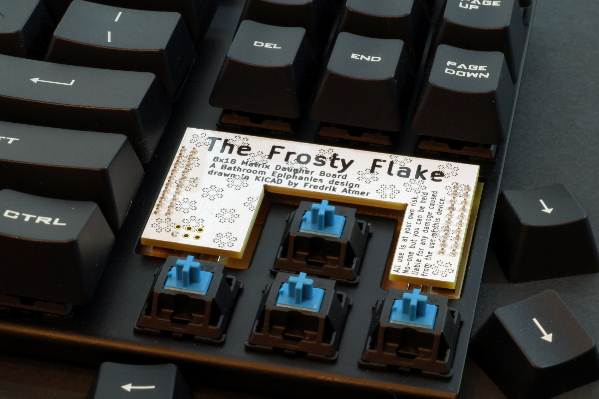

Just fyi, I believe bpiphany is working on a daughterboard for it already, or at least he intended to recently. I even belive someone sent him one for him to work on along with a rosewill I believe. I'd check up on that before continuing. If he stopped that, I fully support your endeavor.
bpiphany
22 Jun 2013, 19:16
It's going to be real on Monday I hope, if I didn't botch anything up... The matrix is already mapped out here in the wiki =)

bpiphany
24 Jun 2013, 22:59
It works! =D Only a few bugs that came out easily...
JBert
24 Jun 2013, 23:35
Heh, I love that design.
