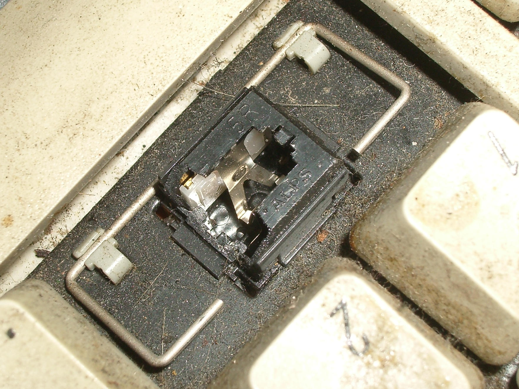

A while back I encountered some photos of white Alps switches in a Focus FK-2001 which had distorted logos and scrawled handwritten mould numbering. I happened to encounter another couple of example last night, in an FK-9000 and a SIIG Suntouch K101 (rebranded Chicony KB-5181). The one constant is that there are no photos of the internals.
I just got my package from Ascaii today, and in it is a junk Macintosh white Alps keyboard with these same switches. One of them got smashed open, revealing the genuine Alps internals. (It also has a [wiki]Futaba lock[/wiki] switch, which I'll be desoldering for my collection.)
So, the dodgy white Alps switches appear to be real. I cannot explain the cheap and nasty moulds, but the insides are indeed genuine. The Far East is happy to make counterfeit Durex condoms disguised as the genuine article, but this appears to nullify the only alleged example of a counterfeit switch, i.e. one that illegally bears the branding of another manufacturer. I do not know of any other instance where any switch has been suspected to be counterfeit.

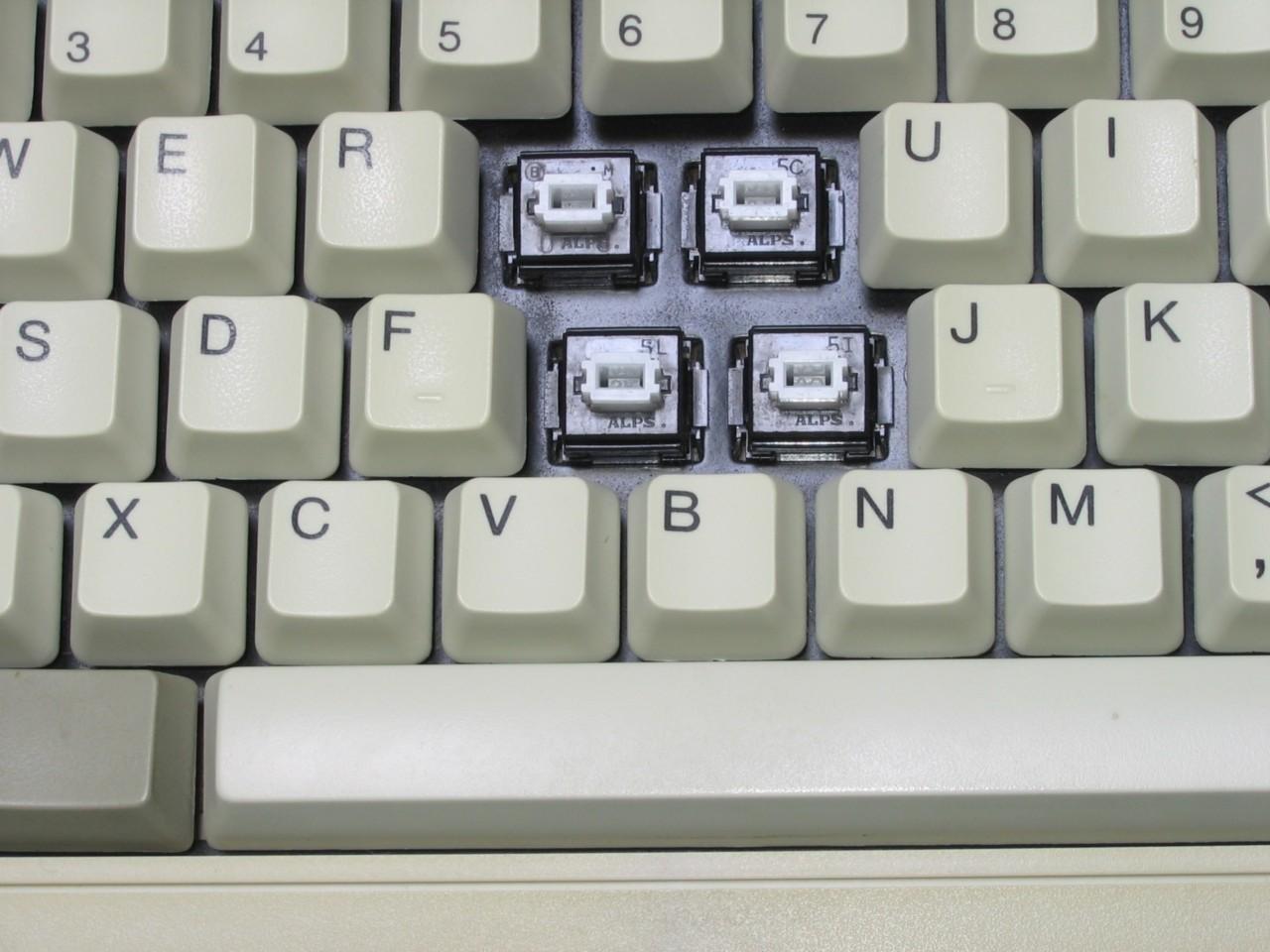

The dodgy white Alps switches aren't misshapen — the "ALPS" branding is distorted, and the mould numbering is haphazard and in some cases looks like spidery handwriting. Here's an example from the SIIG Suntouch K101 (Chicony KB-5181):
Photo stolen from some guy on geekhack who's since disappeared
No photo of mine, thanks to flat camera battery. (Everything's still at the office, where there are nicer-looking tables and a bit more light.)
I don't know what went wrong at Alps, only that the internals are real, and the switches feel perfectly normal. It was a question of whether it was more likely that someone counterfeited the branding (shell fakes do exist), or whether Alps churned out miserable-looking switches, when their moulding is otherwise immaculate.
It looks like, for whatever reason, Alps just made some unconvincing-looking switches.

Photo:
Alps white complicated with cheap-looking moulds.jpg (454.13 KiB) Viewed 1677 times
For whatever reason, Alps did make some odd-looking switches. You can see the switchplate inside. (Not sure how the switch got broken — the broken piece was in the box as well!)
