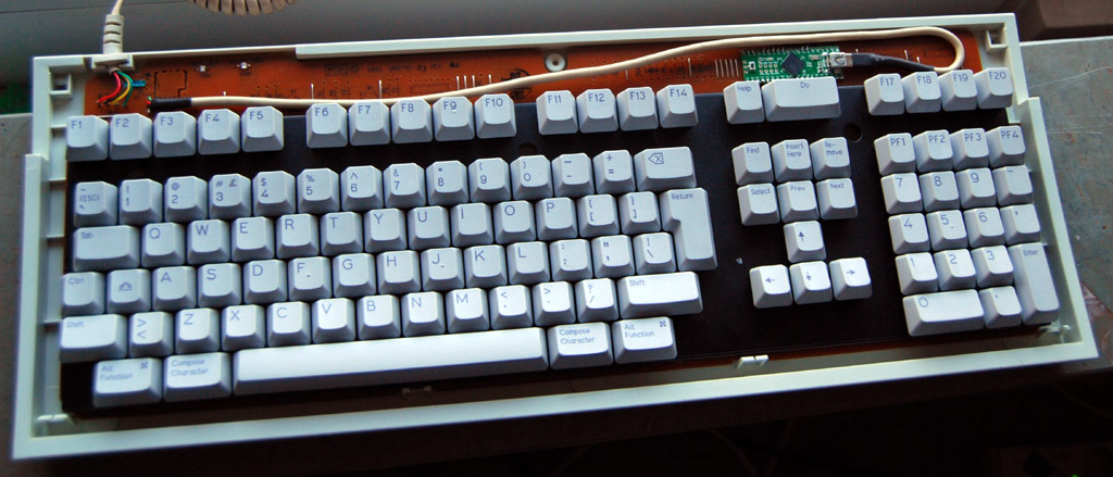

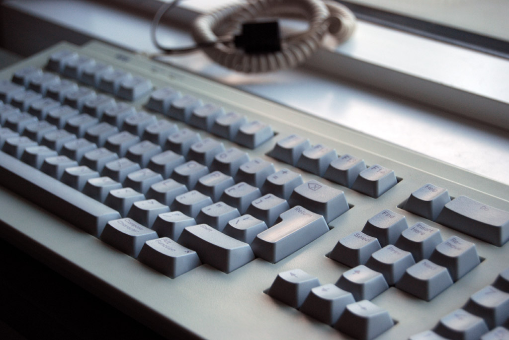

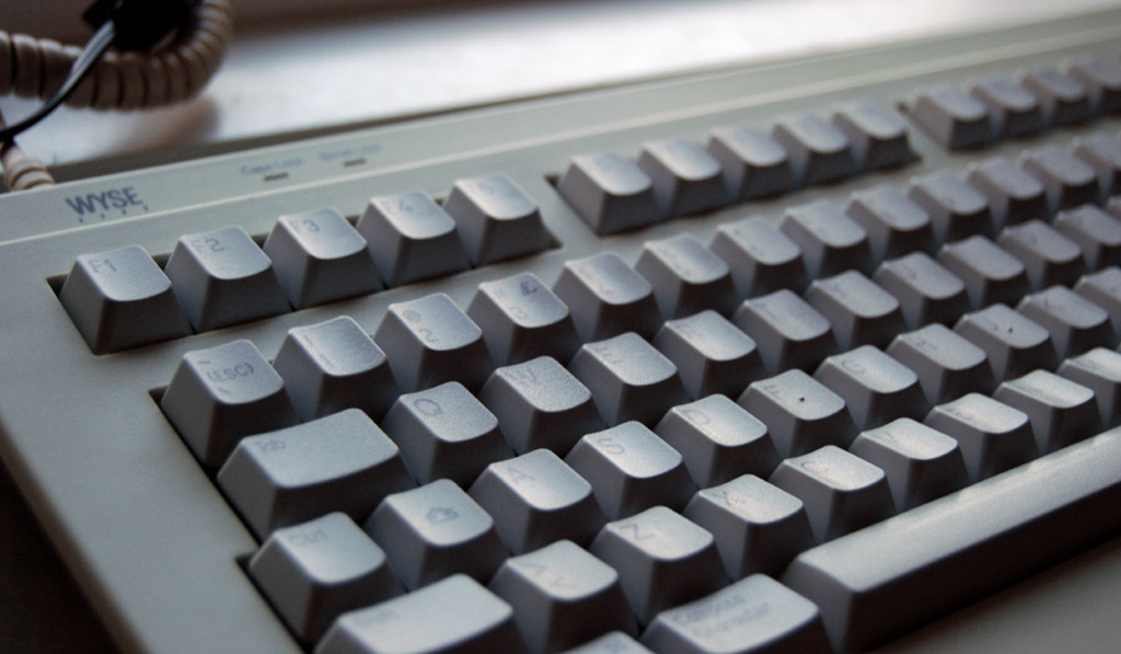

Just finished modding this old WYSE board I bought from Half-Saint.
The keys have been retrobrighted (that stuff is awesome) and the switches have been replaced with old blue cherries. The controller is a Teensy++ 2.0 with dmw's HH firmware. Full macro programmability ftw!

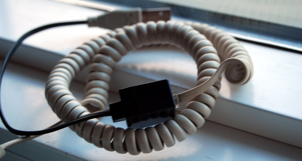

Thought the RJ11-plug looked kinda cool, so decided to keep it. :)

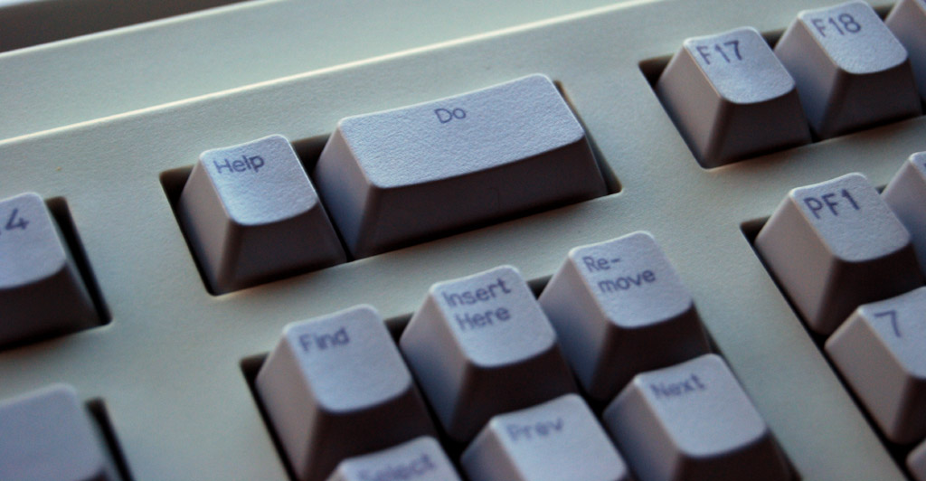

I think it's a pretty nice board, no NKRO though, and the matrix is actually kind of limiting. But it's got a 'Do' button, which totally makes up for these shortcomings.

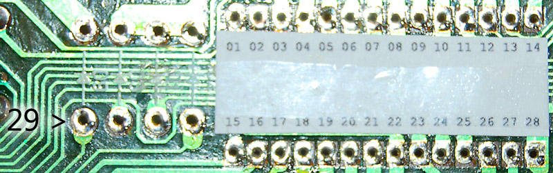

Here's the matrix in case anyone is interested.
        1       2       10      11      12      13      14      15      16      17      18      19      20      29 (D9)
21      F7      F6      F12     F11     F10     F9      F8      F13     F5      F4      F3      F2      F1
22              LShift  D       F       S       A       RShift  G       Space   :;      |\      "'      Return  F17
23      Ctr             O       I       U       CompL           Lock    Q       E       W       R       Tab     F14
24      P       H       3       2       1       ~       Remove  CompR   +=      -_      0       9       8       F18
25      BSP     T       M       B       N       AltL    4       Insert  V       X       C       Z       <>      F19
26      {[      J       n9      n8      Prev    <,      5       AltR    n7      PF4     PF3     PF2     PF1     Help
27      }]      K       n3      Next    n-      >.      6       Y       n2      n1      n6      n5      n4      Do
28      Right   L       Find    nEnter  n+      ?/      7       Select  Left    Down    Up      n,      n0      F20
[/size]

I think there are three jumpers on the backside of the controller socket, one from D9 (29 in pic) to 5 or 6, and two from 18-19 somewhere (the Teensy had GND and REF there I think) to 7 and 8 but no other tweaks were necessary.
