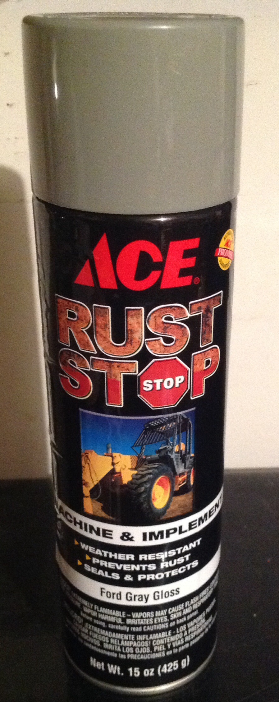

Go back to ace and get this paint, "ACE Rust Stop - Machine and Implement - Ford Gray Gloss". It is a near perfect match for the industrial grey. It's not "silver" or "metallic" like almost all the gray paint I've found, it has the same tone as the industrial M, just not as "olive".
