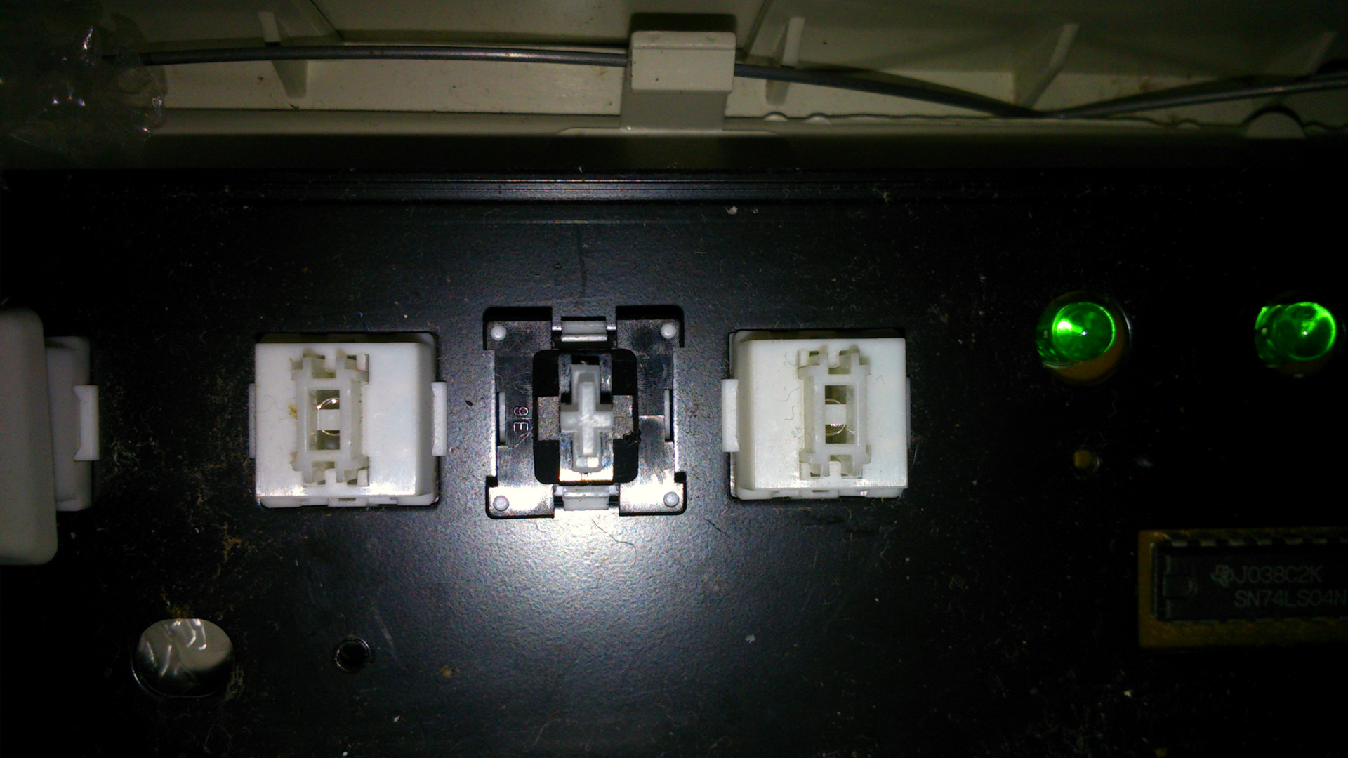

One variant of the Amiga 1000 keyboard seems to have the same switch as the AEKII, but with a square Mitsumi mount hole in the middle of the H-shaped slider, and a black housing instead of white. The switch plate is blue, but so it is in the lock variant of the "Alps clone".
There are a couple of great images of the A1000 switch in this thread on Geekhack, which you can compare with this image of AEKII lock switch innards.
There are also images in this thread on Amibay, of which this image does not require login.
Regarding this, I think that we can conclude that the switch variants can be categorized as the same.

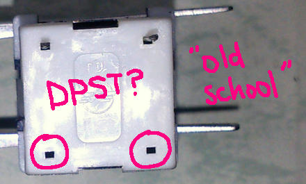

1) Holes which appear to support DPST:
Old school -- possible support for DPST.jpg (24.44 KiB) Viewed 6998 times
Some Tai-Hao APC series switches have "reversible" lower shells, and I thought it was just done to ease manufacturing, by allowing the parts to be placed either way around. Maybe Tai-Hao once sold DPST switches too. DPST isn't all that common, but Cherry made them.

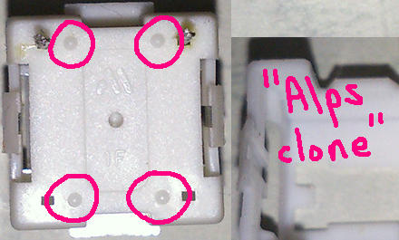

2) The old-school switches didn't have the little bumps that keep the switch away from the PCB (or whatever it is that they do):
''Alps clone'' PCB separator bumps.jpg (27.03 KiB) Viewed 6998 times
Does that affect the PCB-to-plate distance, or were the old switches slightly taller?

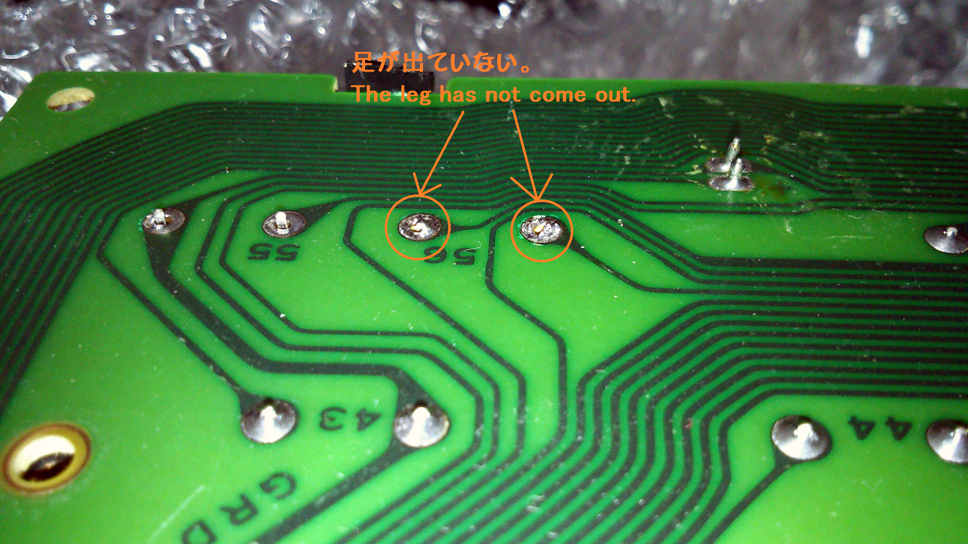

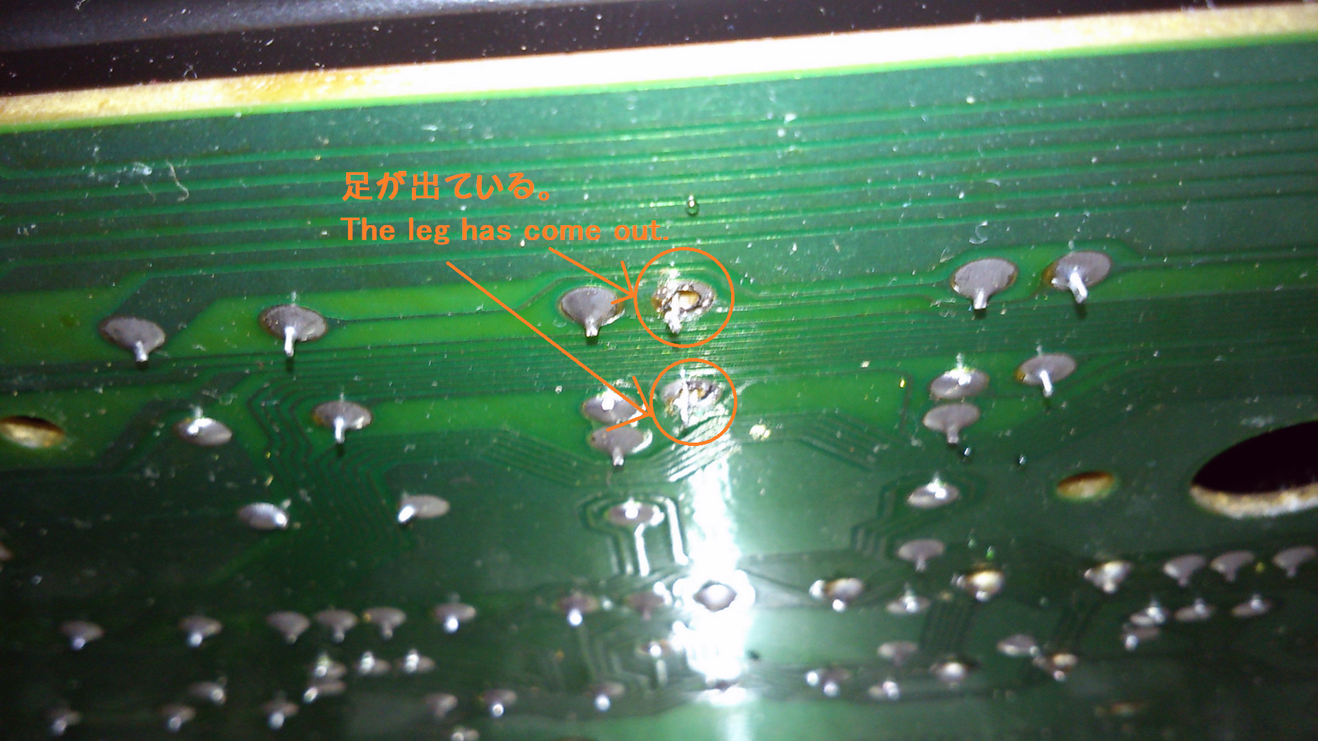

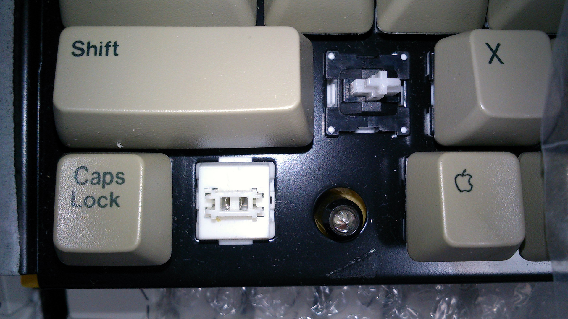

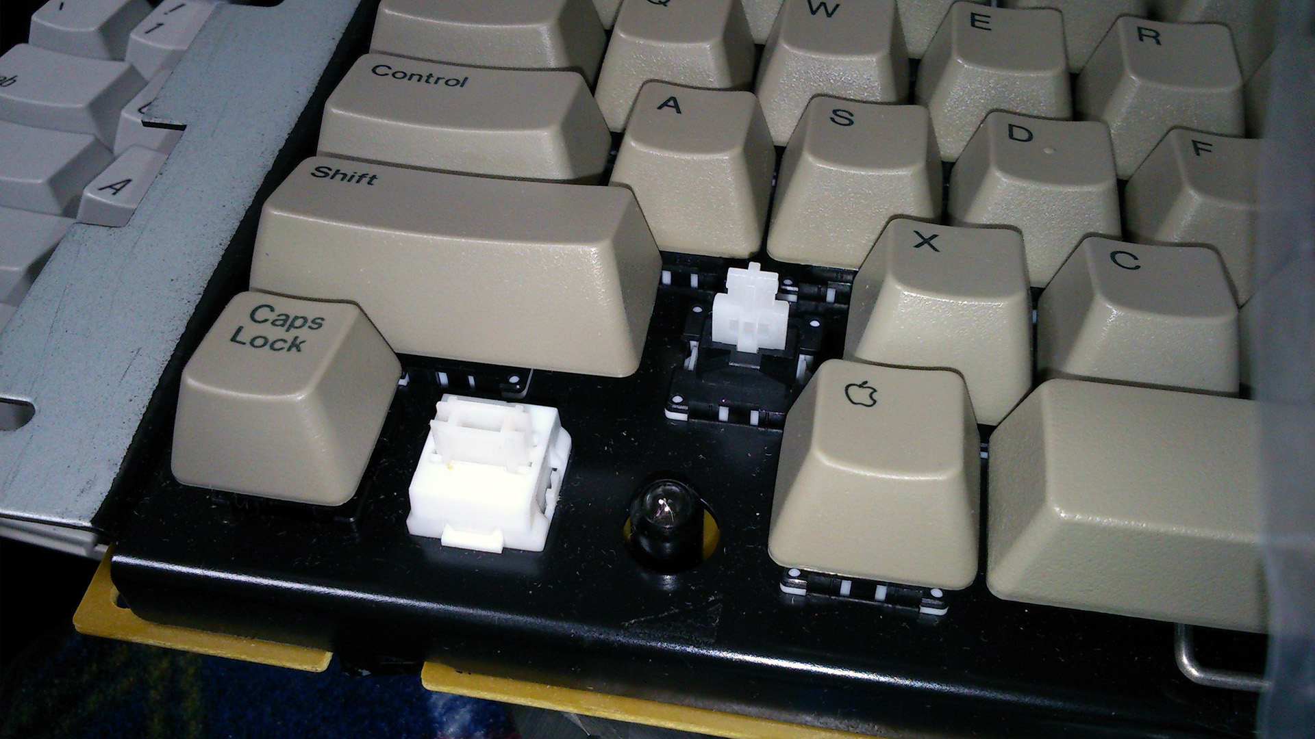

rzwv
03 Apr 2014, 18:44
Switches were actually exchanged.
TDK-T12V→M3501
The switch was expensive and was not fixed to the plate. The leg used as a point of contact has come out.
M3501→TDK-T12V
The switch was low and was fixed to the plate. However, the leg used as a point of contact did not come out.
http://kbd.rzw.jp/mitsumi_/apple_tdk-t1 ... DK-T12V_25
03 Apr 2014, 20:03
Ah, so the PCB-to-plate distance is different between the two switches.
