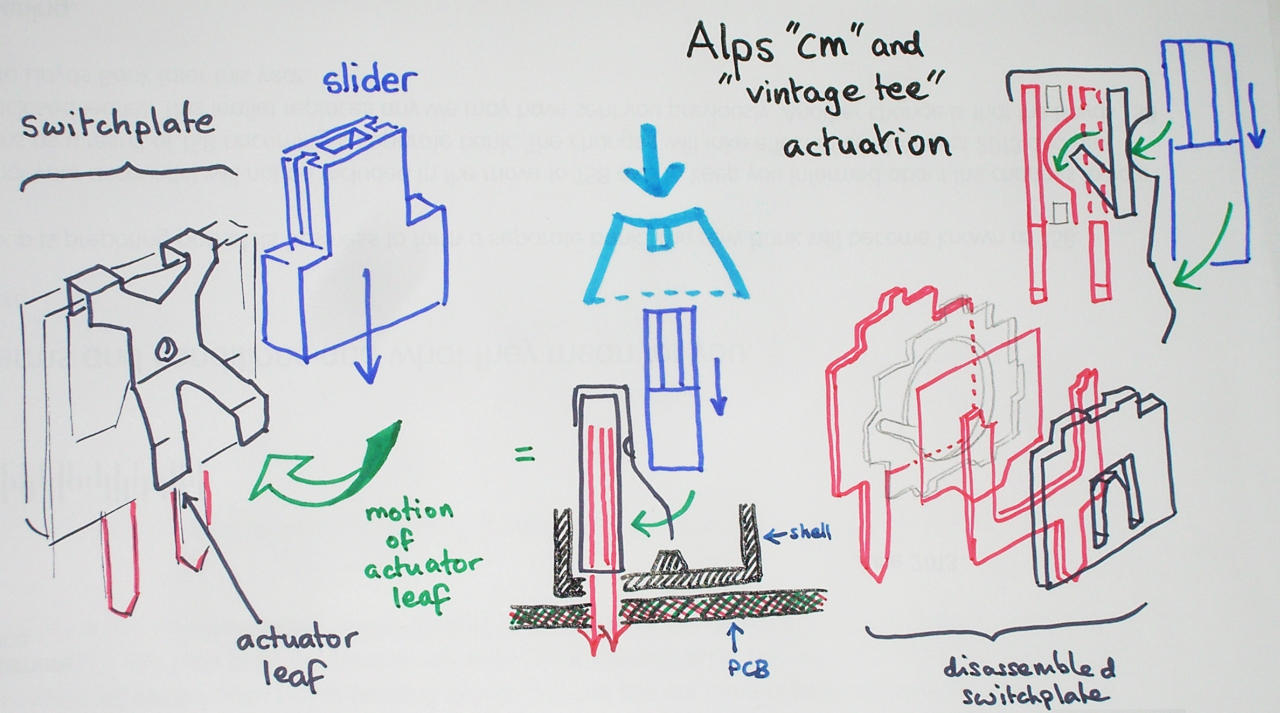

Here's a very brief sketch to illustrate the complex electrical switch inside Alps "CM" and Alps vintage tee switches:
Dodgy Alps sketch.jpg (163.84 KiB) Viewed 5387 times
From left to right:
• [wiki]Switchplate[/wiki] and slider, with the actuator leaf
• The slider presses on the protruding part of the actuator leaf, bending it inwards; a nub in the centre presses against the switchplate itself
• Exploded view of the switchplate (not accurate; I couldn't be bothered to find the exact order of the parts, but it's close enough for this) — a metal membrane sits in between two metal terminals, with a plastic spacer between the solid metal backplate and the plastic frontplate
• As the slider presses down on the actuator leaf, the nub on the leaf bends in a flap on the frontplate, and that bends the metal membrane inwards against the metal backplate, connecting the terminals
It's one of the most complex mechanical switching assemblies ever made, hence the term "complicated" Alps. Strictly speaking, "complicated" applies to both "CM" switches and to [wiki]Alps vintage tee mount[/wiki], which both use identical switchplates, but there's no "simplified" vintage tee switch. The other switch noted for this kind of design, which is even more complex, is the [wiki]Futaba complicated linear[/wiki], totalling 16 components to the switch.

As "that guy", I endorse this sketch. Makes more sense than well labelled (but not annotated) photos of switch innards.
(Or do I mean vice versa? Words with arrows pointing to the picture = good!)

That's a great explanation, thanks for the effort put into drawing it!
From the drawing, if somehow the slider would press "later" (or gradually) on the leaf, it still looks like the actuation would take place later. I am speculating, as i don't know about different alps (or clones), but if either the slider would be "thinner" at the base, or the leaf longer, this would contribute to the delay. Ideally, one would find such different pieces in another switch type, and just swap them with the similar parts in the blue alps.

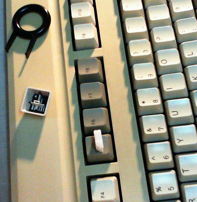

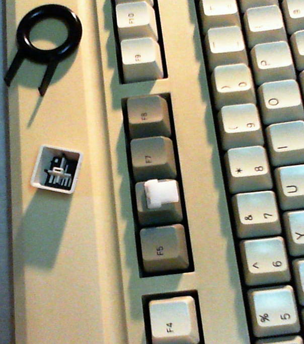

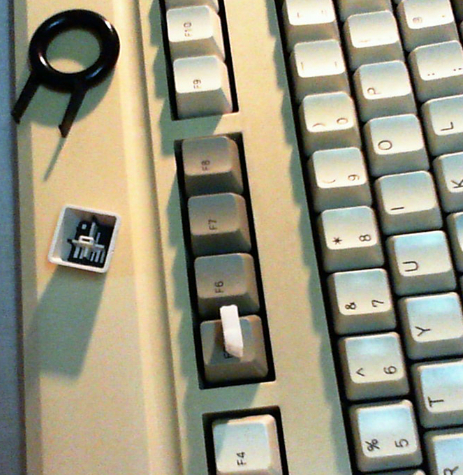

UPDATE: STEP 01 ~~~~~~~~~ Enhancing ... white alps ~~~~~~~~~~~~~~
So, before starting to waste a perfectly blue alps equipped keyboard, i decided to take things slowly, and use a disposable one which has white alps. Therefore - the first experiment was to take out the slider of a white alps switch, and file/polish it with sandpaper, taking out approximately 1 mm from the lower side, which is pushing the actuator leaf. Here are some atrocious potato pics, still better than nothing:
And the first opinions:
I might try to sand *even* more from that lower side (i may try sanding both sides too), but for now, i can only say this: it seems to have a little longer travel before it actuates ( <--- my first goal), and it's also easier to press (you know, that feeling that it doesn't want to get pushed, it went away). Yay! :)
The sound pitch is now a tiny bit higher, and it is, if i can say so, "opened", compared to the default one.
But, i have 1. to see how does it feel for an entire keyboard (the one equipped with the whites, at first) and 2. to be careful - or find a reliable method - to sand all sliders as equal as possible. Or maybe i can find another slider (from a different alps switch) with a shorter "fat" portion.
If anyone finds it easy to give it a try (for one switch/slider), just test it - and give us a second opinion, to exterminate any placebo insects may fly around.
So, preliminary results - satisfactory! Quite satisfactory i might say :D

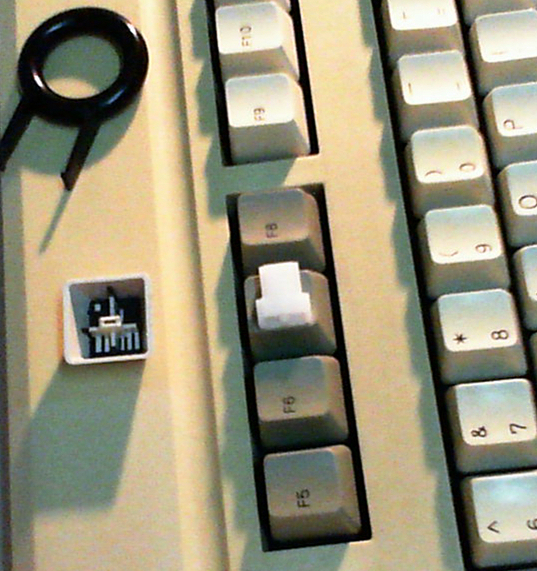

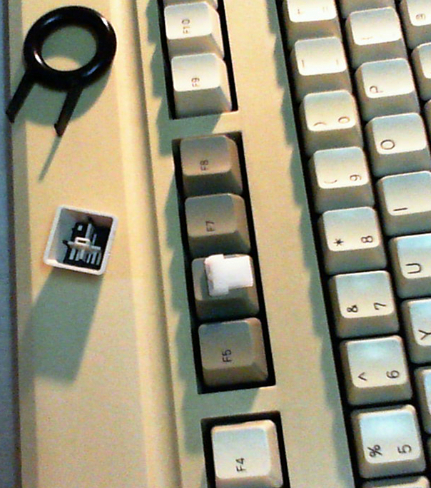

The update's update:
I forgot only one thing ... to test the key. The bad news was - if i file/sand/polish the slider only on one side, like in the above pictures, it will not push correctly/enough the actuator leaf every time. The GOOD news is - after i polished the slider on both sides (so the 'fat' lower side of the slider is shorter), the key also works perfectly well!
SOME MORE TESTS:
I bit the bullet and tested it on the blue alps keyboard, on such a switch. So i modded (shortened the base of) the blue slider, and tested it. It works, with the following observation: because the actuating resistance comes later, and you have some actual initial travel till that point, it is even easier to push the switch. So i replaced the spring with one from an white alps switch, and it feels 'better' (for me at least). It would also depend of the actual amount of slider base removed, in this case i exaggerated a little (~2mm), 1 mm should be enough.
So in the end, either i'll mod the white alps switch based keyboard, as i really like how the 'new' switch acts, or, for the blue version, i will also swap the springs with some stronger ones. Or, perhaps if i file/sand only 1mm of the slider base, i could also keep the default spring ...
TL;DR - White alps: shorten (file/sand) slider base, uniformly, 1mm. => Longer travel until actuation point, easy to press.
