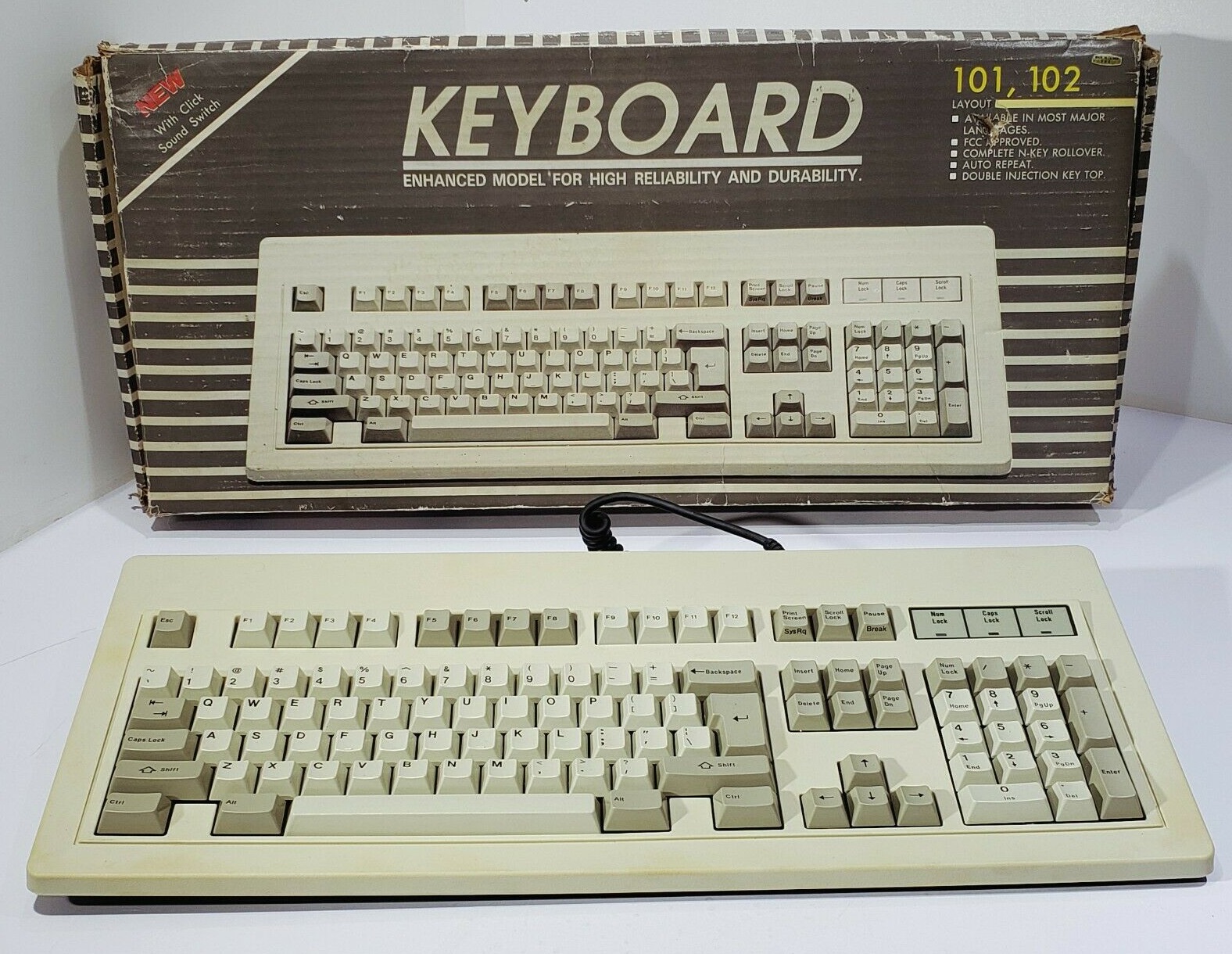

This was a keyboard find by a DT member, Parak. Something I originally identified as foam'n'foil, but didn't realize it was clicky too!!
Unfortunately I don't know which Kaypro model this keyboard was for, just that it could be, at the earliest, the Kaypro 386 Keyboard.

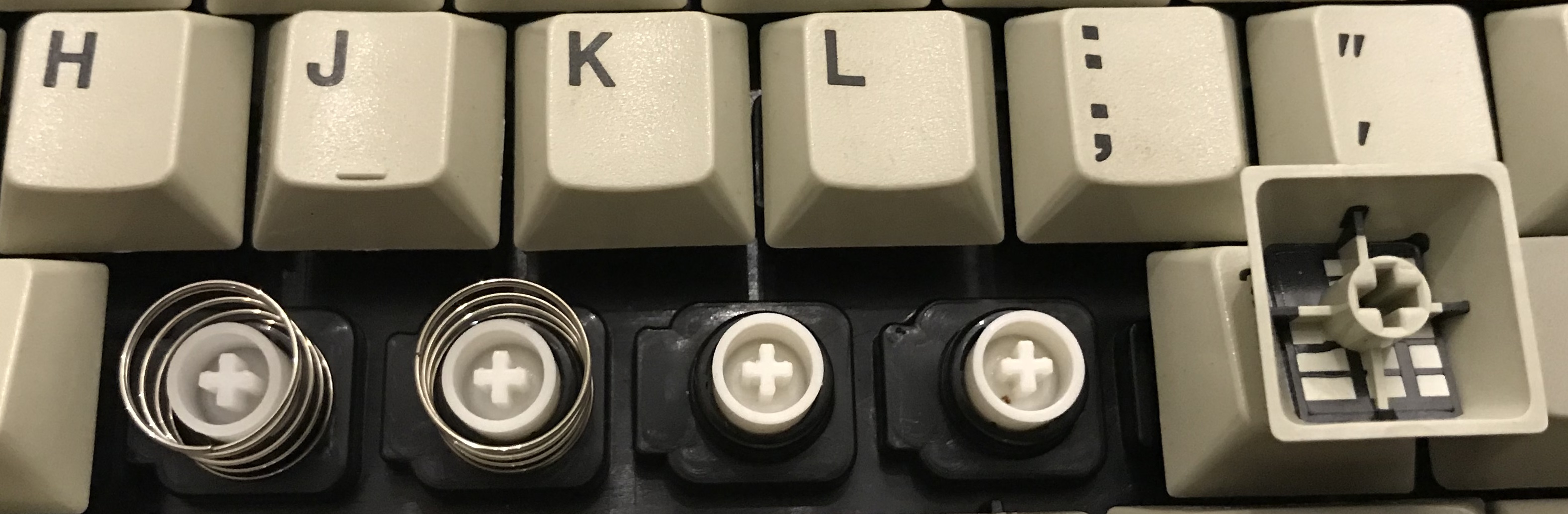

In terms of being Foam'n'Foil, the switch is pretty standard. I haven't yet gone and compared all the known capacitive sensing PCBs yet (something that needs to be done before I/or someone else) can start on categorizing the Foam'n'Foil switches.
What is interesting here, is that it has an Alps-like click leaf in each of the switches!

An ALPS-esque click leaf, MX Compatible Caps, and Capacitive Foam and Foil. all of my wat.

I picked this one up a while back and realized this board is exactly the same as Haata's minus the Kaypro 386 branding.
Definitely a unique and uncommon switch design. Foam and foil the way it should have been. Now I just need to modify these switches with Topre springs to make this a truly Frankenstein switch with it's "ALPS-esque click leaf, MX Compatible Caps, and Capacitive Foam and Foil".
